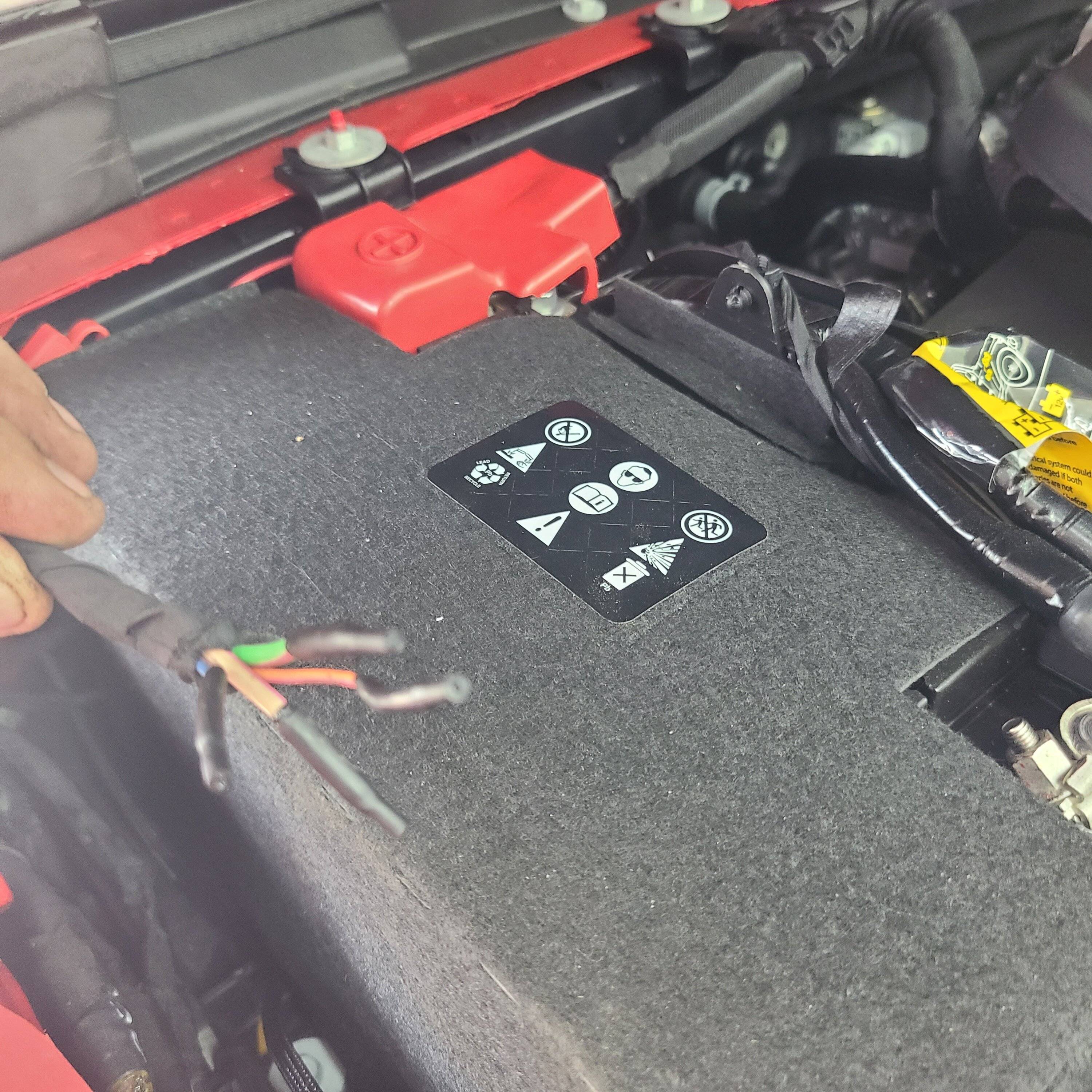

Found mine. Question is, are the wires under the glove box the same wires as what's in the engine bay? Or a completely different set?
Effectively the same…it goes to the same relays/fuses. Factory installed options will also have a 12v and ACC lead under the glove box as well.

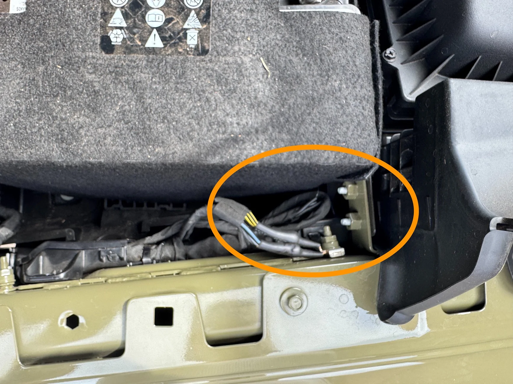

Same, just a spliced set going to each position.

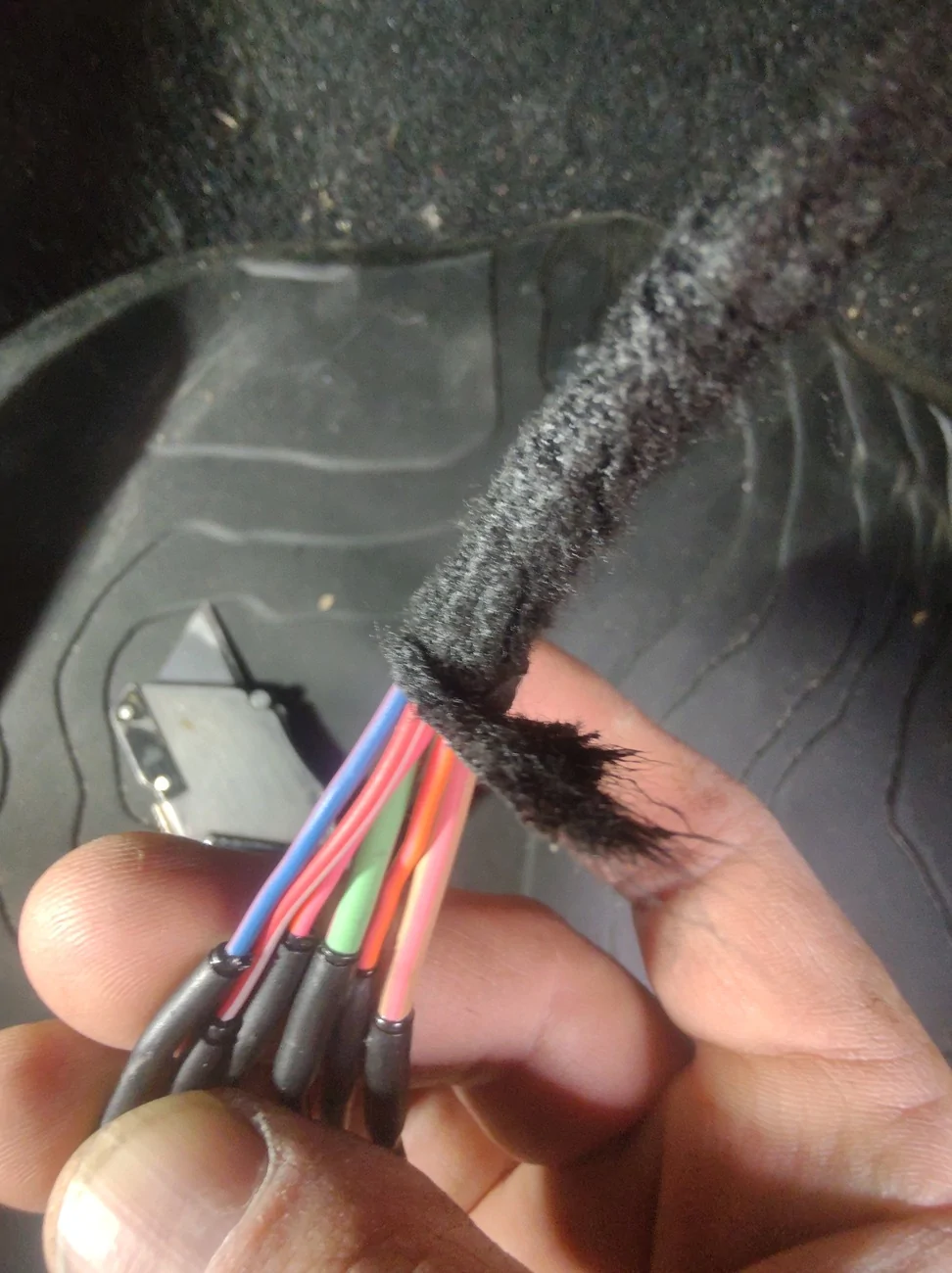

Found mine under the passenger side. Question is why do I have 6 wires for 4 switches? Yet engine bay has 4 wires for 4 switches.

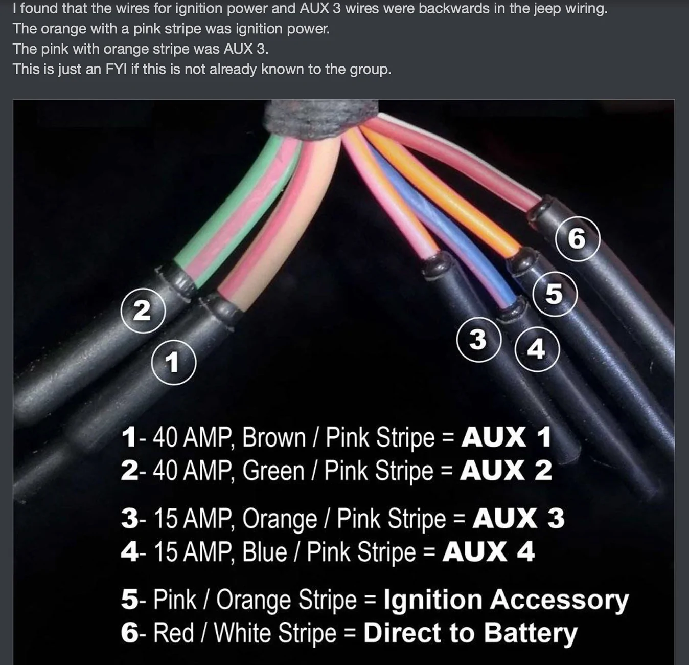

Here ya go. Some have the IGN and AUX 3 switched.
Jeep Gladiator Aux switch wire location AUX Wire Colorcodes

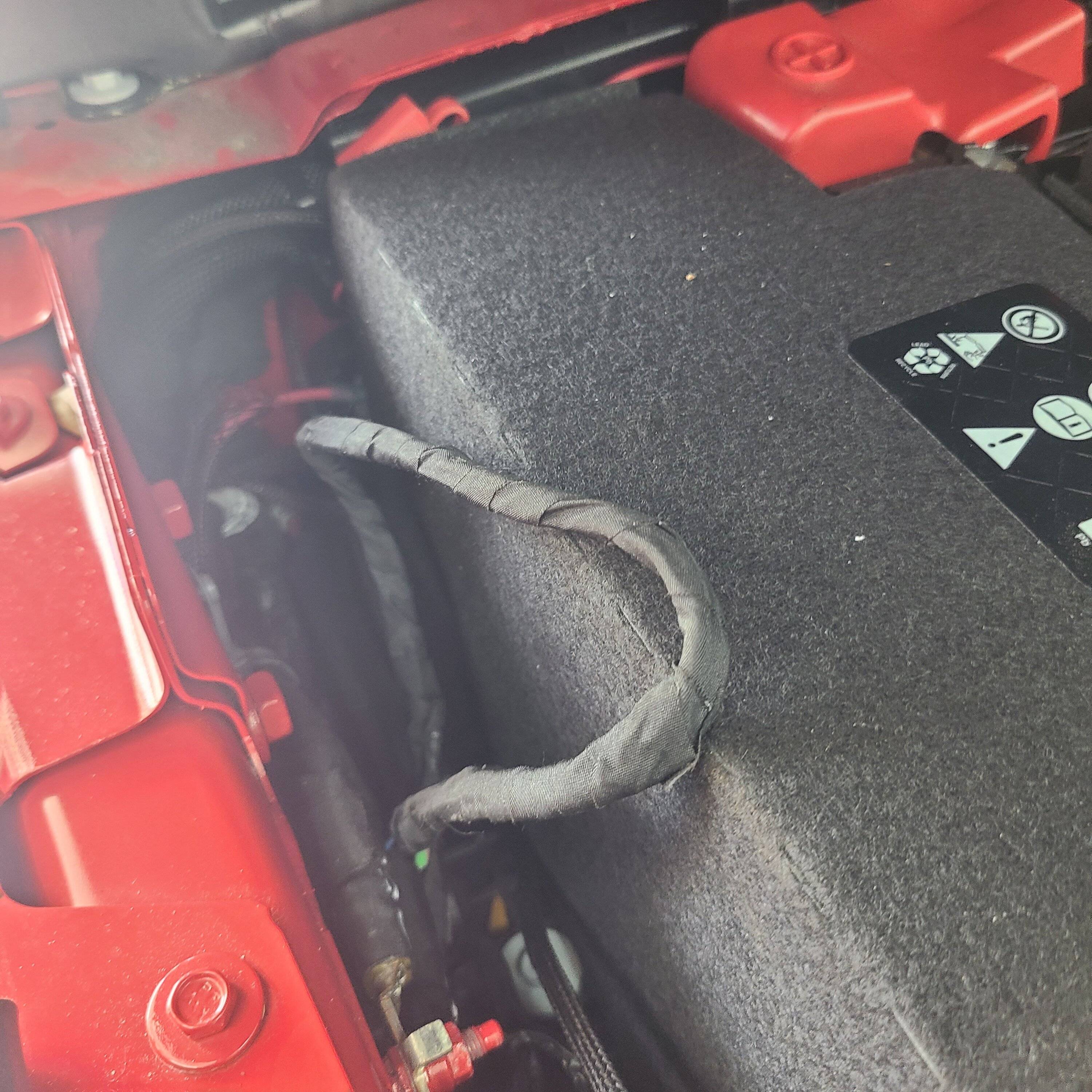

Just found my underhood aux switch wires here, folded back below the ground lug - farther forward than I thought they'd be.
Jeep Gladiator Aux switch wire location IMG_2510
