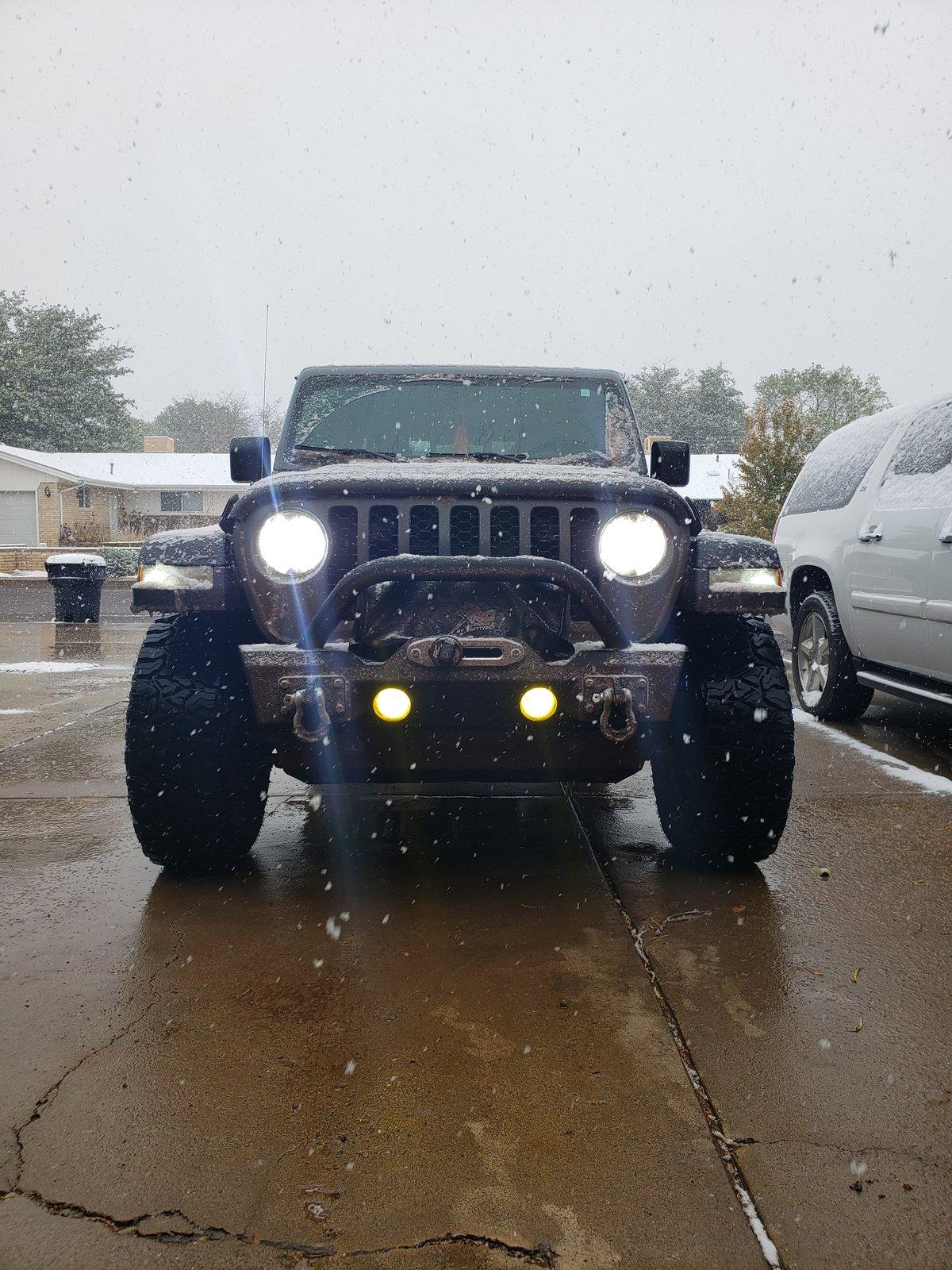

I installed these today off those links and they fit.
The headlight bulb has a built in heat sink so you kind of have to stuff the plugs in the housing to get the dust cover back on but they work nicely

I just did this upgrade; it was the best $90.00 I've spent. I felt the stock lights were terrible, and the LEDs made a tremendous difference. The hardest part for me was removing the airbox, it took a substantial amount of force to pull out.

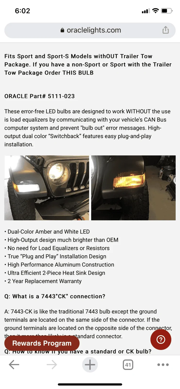

I’m confused. I have a sport s without max tow. For the drl/turn lights there is only one bulb, which is orange. There isn’t a second bulb. Maybe I didn’t have drl lights before?
Chinman
Corey
Mar 19, 2020
84
133
49091
Gladiator sport s
A little more research and I see now that non-max tow don’t have drl in the fender.
Even if I found a bulb my system would still use the headlights as drl so it would be a bit redundant.
that said would the Oracle lights work? Has anyone tried them?
