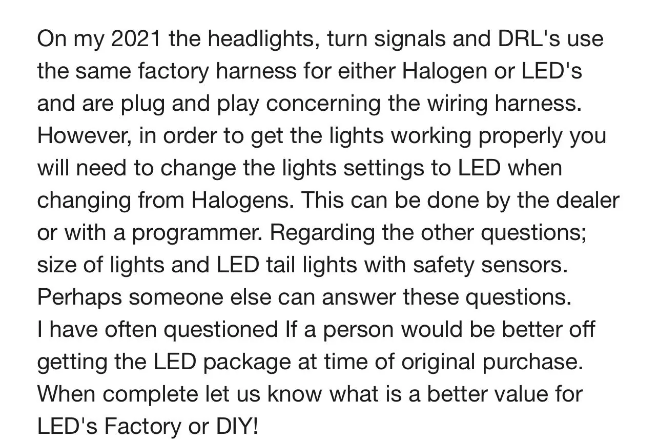

I think you are correct. I definitely didn’t have the 4th wire. I was able to buy the halo harness separately from MOPAR for less than it would have cost me to DIY it. Kind of a pain to install but it works perfectly. I am really happy with the performance of all the OEM LED forward lighting.

Trying to figure out what all I need. I have the Safety Group so already have rears.
Mojave - so I have the Rubicon fenders with the right DRL piece - just need the LEDS right? Seems like I can just swap in the fogs ( plastic bumper ), the DRLs, and the headlights - flash and done? I have the 4 wires.

Sounds like you are on the right track. The fog lights are a direct swap. If you are going the OEM route, make sure you get the harness with the LED DRL/turn signal units. The halogen harness that runs inside the flares is not a direct plug in. You’ll need to pull the fender liners to rerun that wiring.

Should have ordered. Also adding the OEM front camera, proximity, and aux switches. Got my work cut out.

I have the Oracle Oculus LED headlights on my 21 Gladiator 80th Anniversary. It did not have factory LED's. However, the harness does have the fourth wire. Also, now I have the Tazer mini. Can I wire the Oracle Oculus Halo's directly to the fourth wire (halo wire) in the factory headlight connection then program halo's operate with Tazer? I would like to do away with the fuse tap. Thanks for the help.
We haven't tried this yet. As long as that wire has 12v and not 6v, should work in theory. Feel free to try and report back!

What was the Mopar part number for the harness?

Hopping in too. I just installed a set of JL take off mopar LEDS. Normal and auto work fine. High beams and halls do not. I assume I also need this harnesss to fix these issues in my Mojave?

That's the jumper wire. I was hoping you knew the part number for the 4th wire harness.
The jumper wire is the missing 4th wire and was all I needed to complete the installation. It’s pre-terminated so it can be added directly to the plugs at the headlights and the BCM in the passenger side footwell. You don’t need to replace the entire harness.

Based on my experience, If you lack the 4th wire you will need the harness listed above to get the halos to work. However, I don’t think it would impact the operation of the high beams.
You also need to “activate” the LED functionality using something like a Tazer or JScan module (I used JScan). I have read the activation took some folks a couple of tries before it “stuck.” I’d suggest double checking all the settings before doing anything more invasive.

Yeah I didn’t check the wires. I did a bunch of lurking and it appears most late year 21 and 22s have the proper wiring already and it needs to be activated by taser etc.

i just got my 22 JL Sport S. Very interested in switching out to Oracles with the halos. Not sure if it was answered yet, but I’m wondering if you need the fuse tap if the 4th wire is already in place? Is there a harness that will do the 4th wire join for you? Those oracles come with the halo wire separate as I understand it and it would need to tap into whatever is already used as DRLs?
