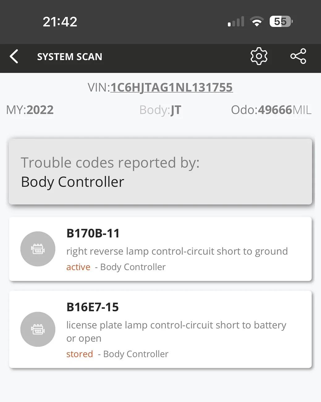

Alright so I wired this all up and this is the issue I’m getting. All I did was remove the relay from the circuit. The reverse light comes on but then blinks twice then goes off completely. Not too sure exactly what the issue is. I’m wondering if either a wire isn’t connected properly or if the extra lights are pulling too much and the BCM isn’t liking it.

So I did some testing and unplugged one of the rear led lights and now it’s working as intended. So I’m assuming that both of my lights are too much for the BCM to handle and sets a soft code. No to figure out why the 2 to 1 diode setup I’ve got isn’t letting the factory aux switch control the lights.
