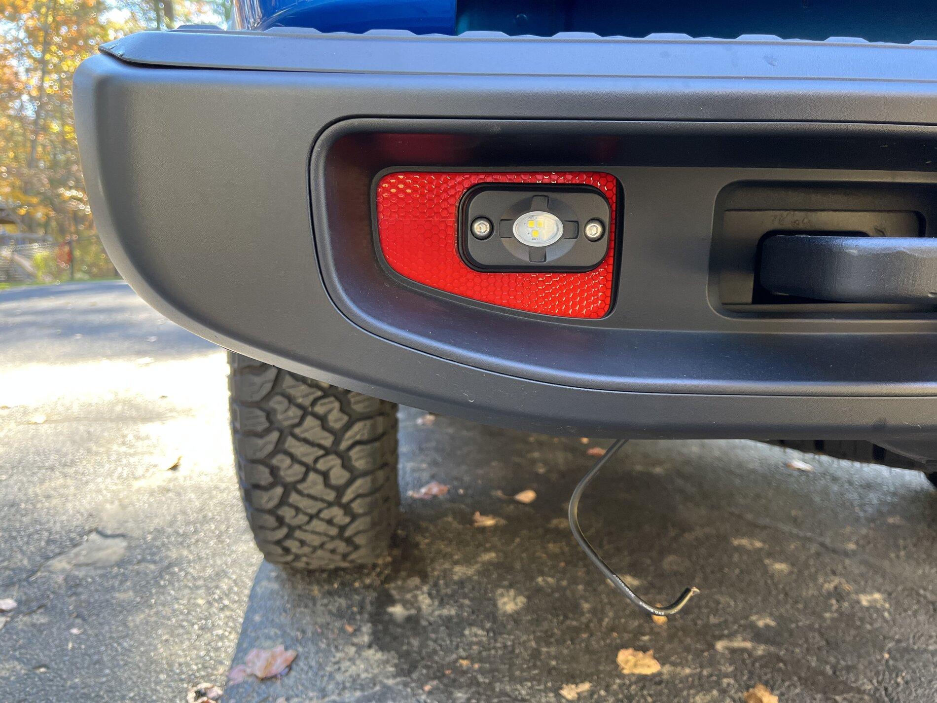

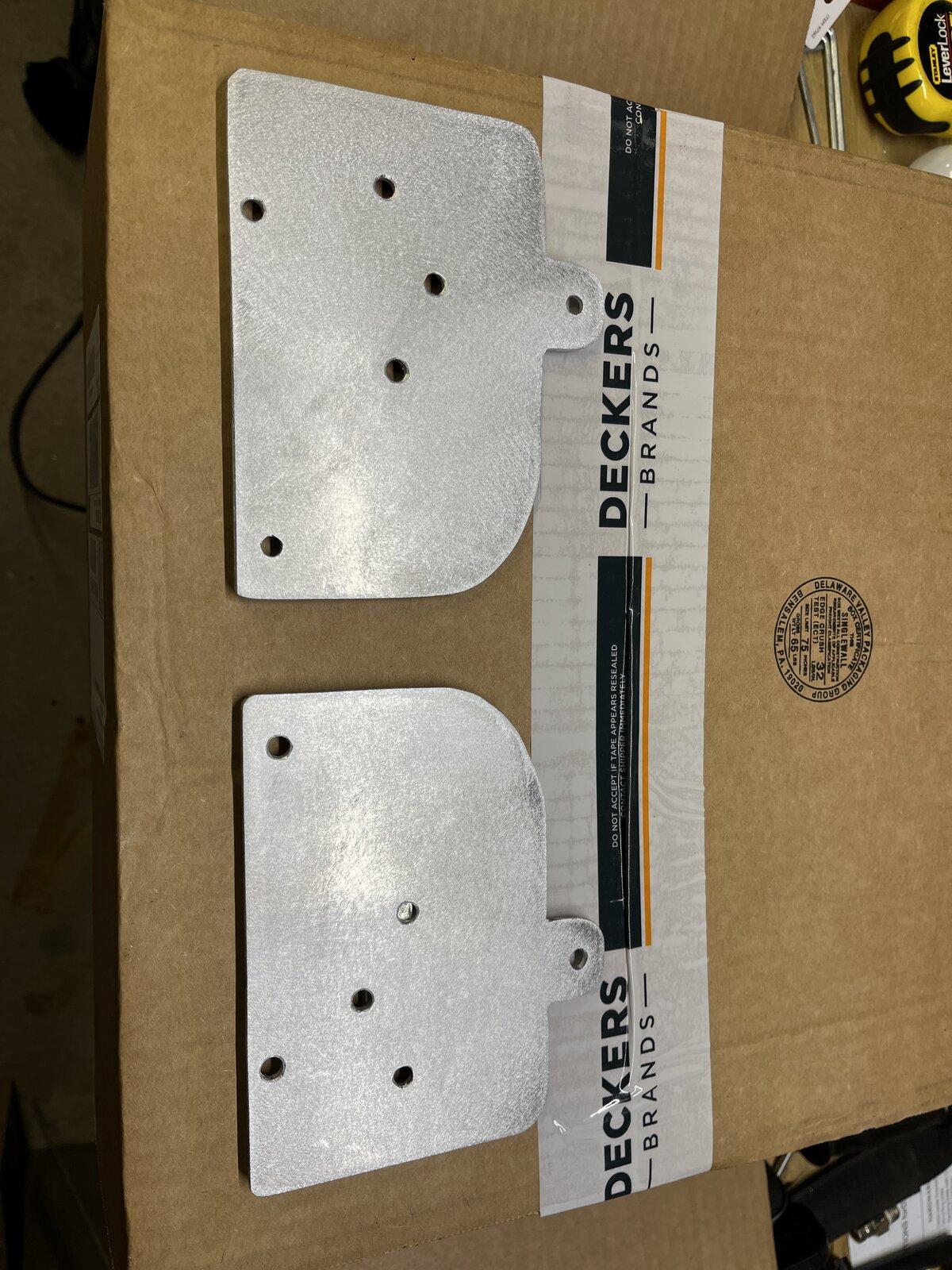

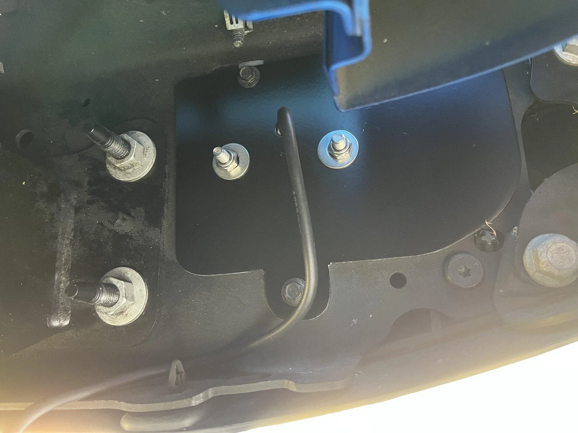

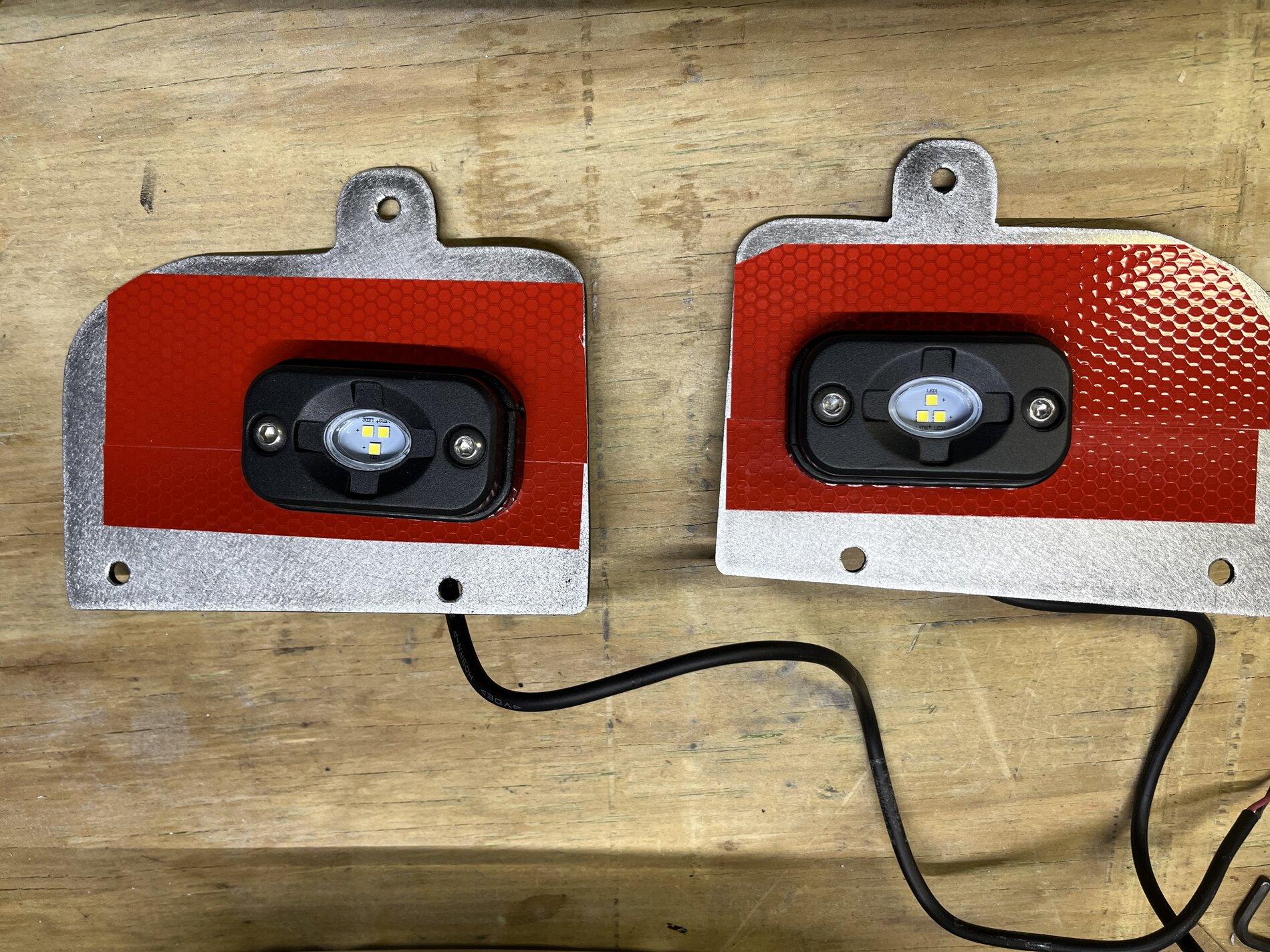

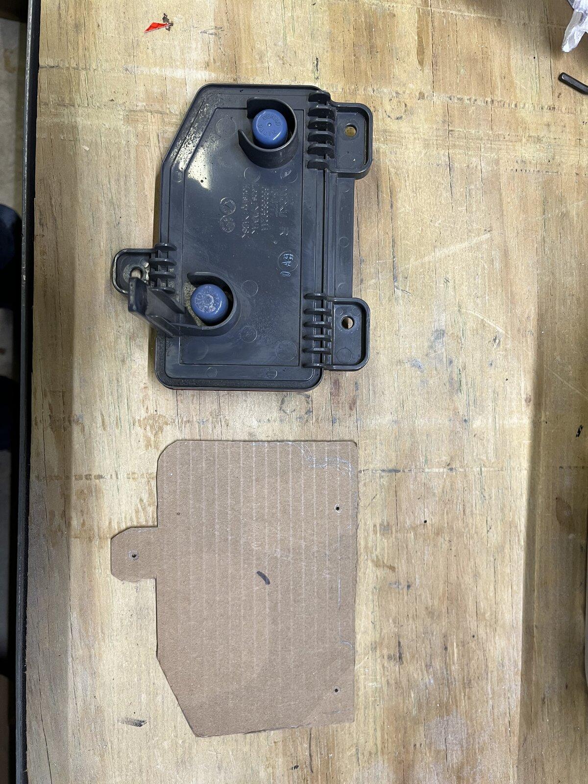

Made some plates to replace the bumper reflectors and mount some small led utility lights. Made a cardboard template, cut plates from .125 aluminum with a jig saw, painted the back black, covered the part that would show through the bumper with reflective safety tape. Mounted the small utility lights over the tape. Pleased. with the look, will wire them to one of the aux switches and post pictures of the light output.

WOW!!! That looks sharp! Nice work.

Creative - and ended up lookin' good - and better reflector area than some others.

Couldn't you have done the same thing but used the stock reflectors?
Considered it but the stock reflectors are multi layered, red lens with the reflector quarter inch or so behind it. Not sure I could drill them without them breaking apart.

Ah gotcha. Well, either way, yours is very well executed and looks good

Yeah, what he said - and if yours ever get dull, damaged, whatever, you can easily refresh 'em.
