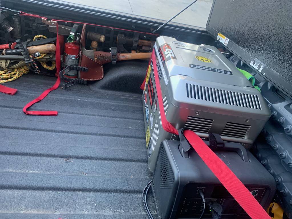

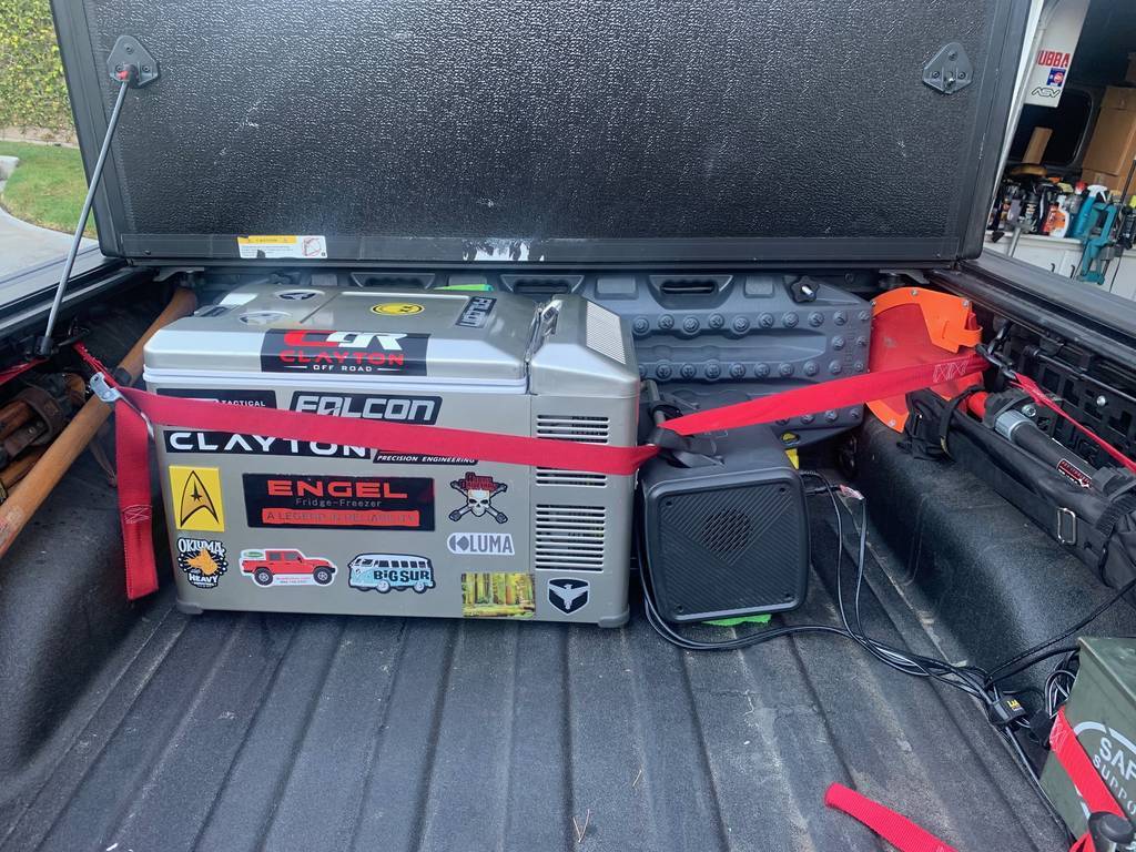

Hook up both the AC and DC to your fridge from the AC bed outlet and DC from your power station -- and passthru is never used. You need an octopus on your bed outlet, one for the fridge and one to charge the power station. The fridge will automatically switch from AC to DC when the AC switches off. Almost all the fridges work that way now. Mine works that way, and it has been running in my bed 24/7 for 1.5 years.
Note: My setup below pulls 230 watts when the truck is running. 30 watts for the fridge and 200 watts to charge the Bluetti power station.

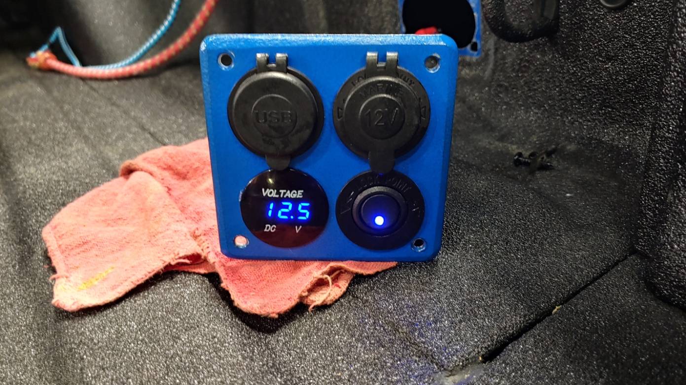

And that's why I put a 12v outlet back there and skipped the 110v thing. No use converting 12 to 110 then back to 12 again at the device.
This is EXACTLY what I'm looking to do. Would love your advice. I have the switch, outlets and voltmeter combo, same as you. How did you wire it up? Straight to battery with in line fuse or fusetap in the fusebox, or something else? Not sure if I want "always on" and rely on that switch, or fusetap fuse52 so it's powered with ACC on only.
Also the square "plug" was unfortunately left on when I got bedliner added. How hard is it going to be to get that out?
40,442
53,859
I used a new blade in a stanley box cutter type knife and scored around the plastic plate inside the box.
Then from the side looking up I found the back side of that blank plate, worked the tabs a bit to make sure they were not stuck, and pushed around the perimeter of that blank from the back side. It's easy to access up behind the right rear tire, between outer fender and side of the box. It popped out.
The square plate the outlets and switch and such comes with space those pieces out a bit far so I made a plastic plate to put them closer together so I'd not have to trim so much out of the side of the box (I figured if I trade the truck in the future, I could pop this out and put the blank back in)
As far as wiring, I ran the wires to power it all along the right frame rail, along the factory wiring.
I have it powered via one of my aux switches so it's fused in that manner - and I programmed the aux switch to work with the engine off - battery power.
You can use any switch you want, but I had the aux switches and figured I'd use one of them for that since I don't have a lot of other stuff like other lighting and all.
I see I messed up on the edge of my plate a bit but once installed, it's hard to tell.
I painted it with a texture paint I use to retexture parts before painting so it would not be smooth finish back there with the bed liner.
I'd need to get pictures of the wiring behind this panel but after several months, including gravel roads, snow and rain and salt, it still is clean up in there.
