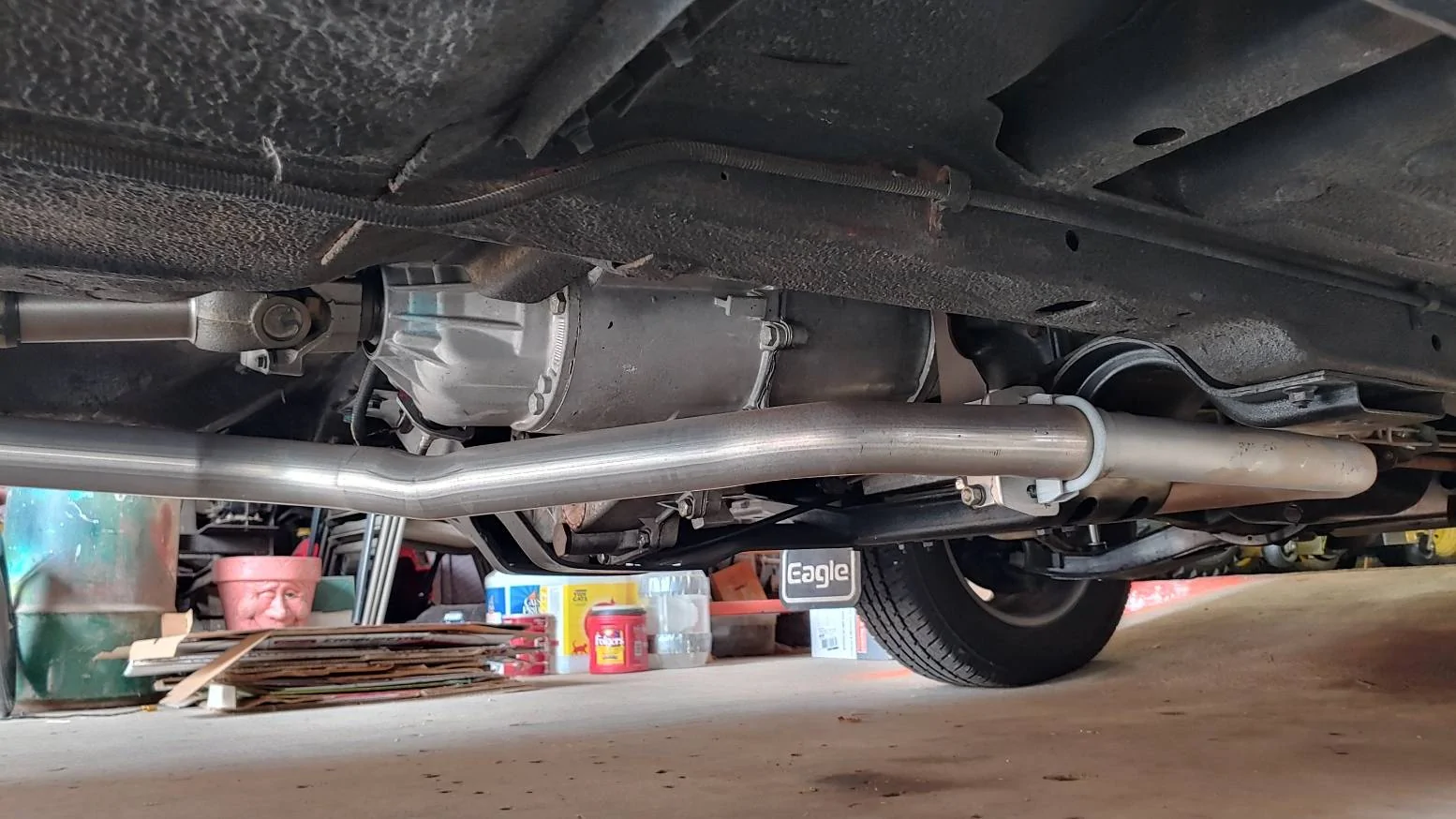

You assume the TC sits level, he alluded to the fact it is canted towards the rear, so the front is already coming out above centerline, so there is a difference.
250
40,614
54,289
Don't even begin to tell me what I assume. You think this is my first foray into 4x4s or transfer cases or drivetrains?
Holy cow - where did you get that i "assume" the transfer case sits level?
And that's really only a variable because the lift and distance from t-case front yoke to front pinion yoke will impact the angle of the shaft coming forward out of the transfer case.
Still doesn't matter - same rules apply.
Only the exact numbers will vary based on the vehicle and the lift and the length of the shaft.
I never assumed anything at all. I know the whole drivetrain typically sits lower in the rear - no engine or transmission or transfer case sits level with the chassis. All tilt downward toward the rear.
I've worked on enough drivetrains to realize all of that LOL.
Why in the hell would a guy who started with cars and trucks, including 4x4s decades ago, assume the transfer case sits level when I have yet to see one that does.
Damn, I must have a busted mount or something, the rear of my transfer case is sagging!
Shit, the front is tipped up, all the fluid is going to run to the back!
Jeep Gladiator Bad Vibration after Front Driveshaft Install 20210912_103042_HDR
Come on, man, give me some credit!
Everything I said applies, and that video actually reinforces what I was saying, it doesn't contradict it in any way at all.
