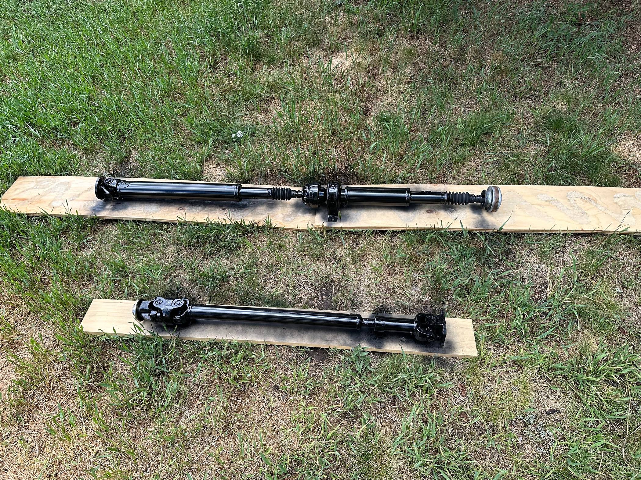

These are mine. The jointed one with cv at the t case and 1350 at the cv is my Dana spicer performance rear, rated for stock to a 6” lift. It’s been amazing, and yes, my rear pinion is adjusted to around 1 degree.
The front double cardan 1350 was made locally by a driveline shop for $400. I have yet to install it. I’ve had it since last August. Oops. I do expect to need to adjust the front pinion to a compromise angle, getting the best caster/pinion angle combination. If it doesn’t handle well at high speeds, it’ll get pulled. I admit, I very much like my stock front shaft from a smooth operation standpoint. I have 4hi auto, so my front driveshaft sometimes rotates at 65-70mph. It needs to be smooth. I’ll take smooth over strong in the front.

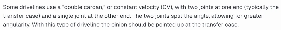

Here is Spicer’s page showing all their performance JT drive shafts. I find it interesting that their fronts are built exactly like others. Single on pinion end, double at the t case.
https://spicerparts.com/parts/drive...performance-driveshafts-for-jeep-gladiator-jt
Double on the transfer case end (or even using a CV at that end) is necessary because of the upward tilt of the front output of the transfer case putting that joint area at a fairly extreme angle..
The stock JT sees almost no angle at the front joint - the shaft and pinion are fairly well lined up so a single joint works perfectly well there from the factory with stock caster and height.
The issue MAY present itself - not a given, but possible - when the caster is increased, tilting the pinion downward combined with a high lift, taking that shaft higher up, the two changes combining to put that front single joint into iffy territory. might work - might vibrate, depending on lift, caster (angle of pinion) size of the joint used............
Also, as a rule of thumb, if you double the operating angle you cut the lifespan of the U-joint in half.
