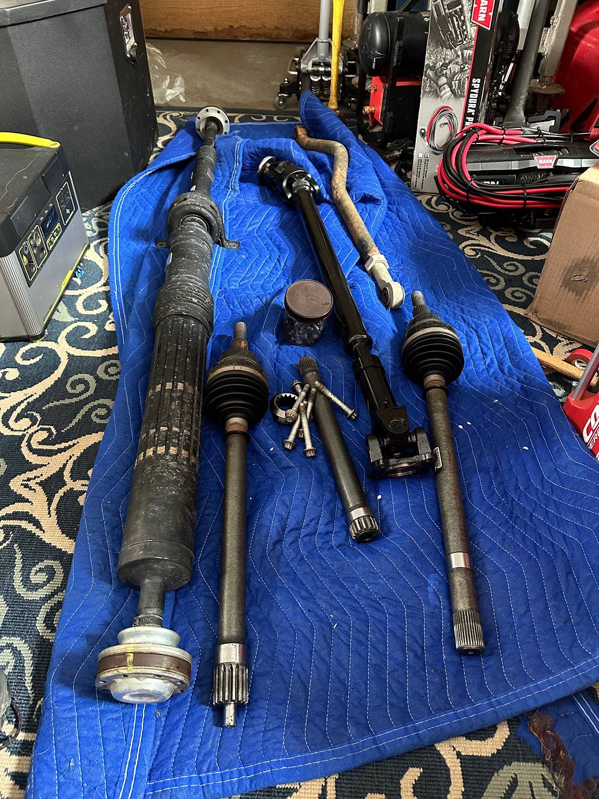

Here’s a pic of them:They are from Rock Krawler:
RKKRK07430 - Driver
RKKRK07431 - Passenger
Passenger is just .5” thicker, but otherwise interchangeable. I had to do a PO through @Northridge4x4 as one of them wasn’t listed.
