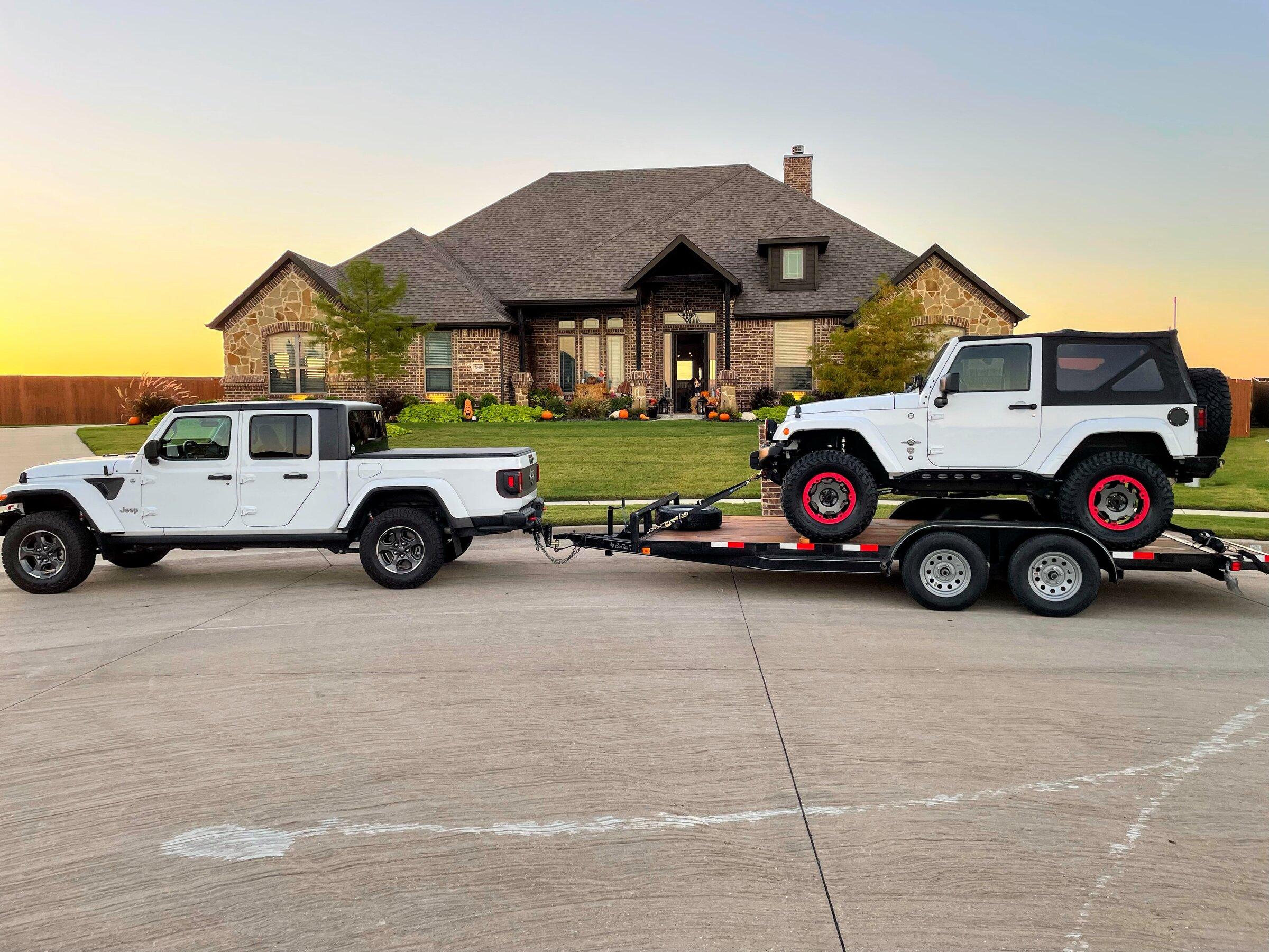

That’s looks good for me. I put something like that under my Dodge. They have held up good.
Michael@WeGo4WhlLow
Michael
Jul 6, 2020
43
126
Ovilla TX.
2020 Gladiator Overland
Area Director
Love the Firestone Bags!!! They work great for me, I run 40-42 PSI and the Gladiator actually ride better!!! Redarc trailer control, 4.88 gears and a well-balanced trailer. Install is super easy, suck all the air out of the bags, put the cap and use zip ties to fold over. I have done few that way with no problems at all. Enjoy....

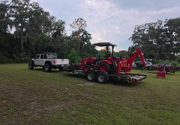

I pull trailers all the time. I have four of them and then I have a boat. Been doing it since 2019 and 212K miles with my JT.
For four years, I've had the Airlift HD bags for the Ram 1500 on my Gladiator. They're a little bit longer in case you decide on a lift. But, because they're HD, they're a little bit stronger. But they also ride a little bit stiffer as well. https://www.airliftcompany.com/shop/60818HD
Last year, I changed over to the Airlift Loadlifter Air Spring. They help with more weight. When aired up they work good, but you can't leave them aired up for everyday use. They're stiff with no weight or when not pulling any weight. https://www.airliftcompany.com/shop/57415
Either option is a good choice. And if you ever decide to do a little harder wheeling, you still can.

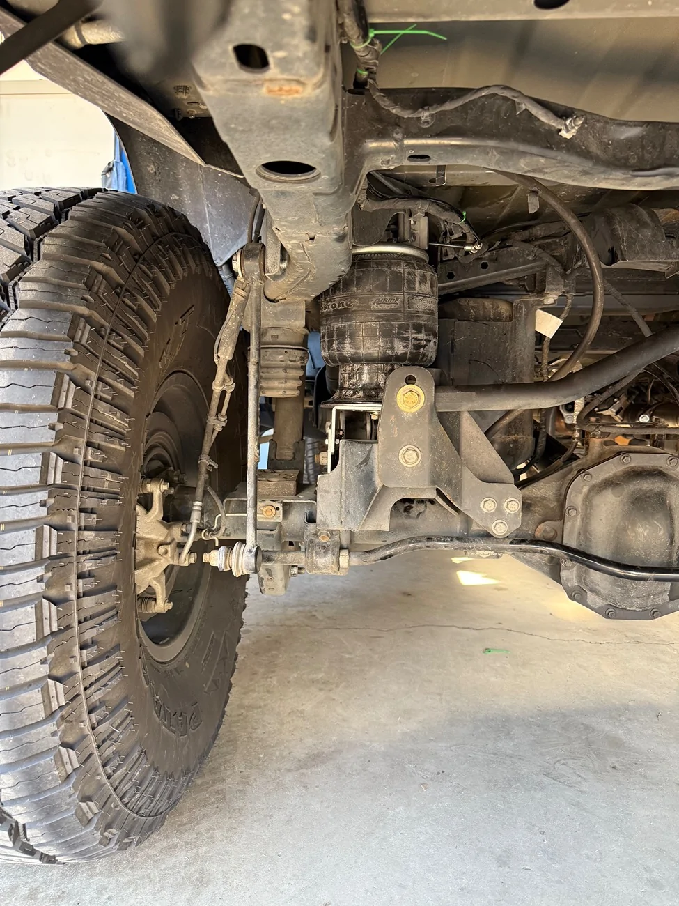

I'm surprised that nobody has mentioned the Timber Grove Air Springs made for the Gladiator.
19'-UP JEEP Gladiator Rear ASAM 2nd Gen Air Spring Kit (SQ6466100) — Timber Grove Enterprises, LLC
Timbren was an option when I got the airlift springs. The only reason that I didn't go with Timbren is because it mounts to the axles. The airlift springs sit in a cup. I can deflate the bags and still rock crawl like they aren't even there. They work perfect with my 3.5" lift because my lift my bump stop plate is removed which means the bags don't touch when deflated and it maintains the normal, stiff as hell, lift kit ride.🤣🤣 I have air springs on my Ram as well and they mount to the axles. Nothing wrong with that setup at all as it seems like timbren has a great product. But, because of my uses, I just didn't want that type of mounting setup for my jeep. That's only the situation for MY jeep. If not for that, I would've went with Timbren.
