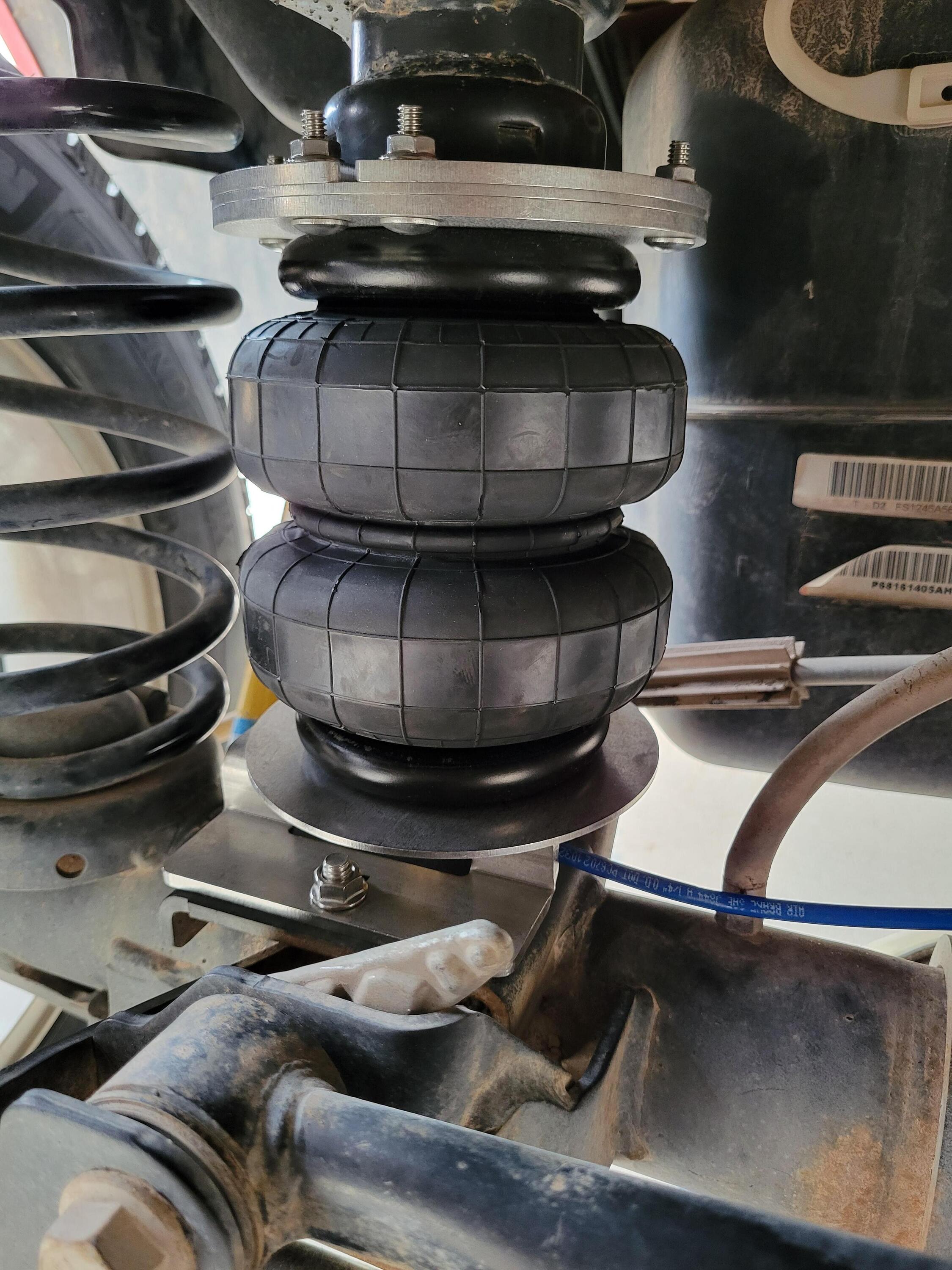

I have the Timber Grove CRM Coil Replacement Mount
https://timbergroveenterprises.com/shop/19-up-jeep-gladiator-s-4-lift-crm-axle-mounts-sq4331060
Controlled with the Airlift Wireless Air dual bag controller and the wireless air tank upgrade. Allows me to keep the ride height I want for any weight load.

Yes I’m happy with them. The fit is great and I love having the ability to adjust for different weights in the bed and when towing a trailer. No saggy rear. The bags that he provides have 8.9” of travel from fully collapsed to fully extended so not for guys looking for max articulation. These bags have an internal bump stop, Firestone also sells a matching bag w/o internal bump stops which would give 9.6 max travel but they’re spendy so I decided to run the provided bags
Thanks. I talked to Steve again today. Kinda confirmed what you said, however all the bags he uses have internal bumps. Safety feature in case the bags have no air, to protect the bag from sitting on itself.
I’m going to take more measurements this weekend, articulating and full droop. See if it will work with 12” travel shocks. It’s close.
I currently have 12” coil overs mounted in the factory shock location. Rides great with or without the trailer. Factory rack without the trailer. Trailer connected, drops 2/3”. Night time driving, I’m blinding everyone.
My concern is moving the weight carrying from outside the frame to inside the frame. Think I’ll loose a lot of side to side stability.
