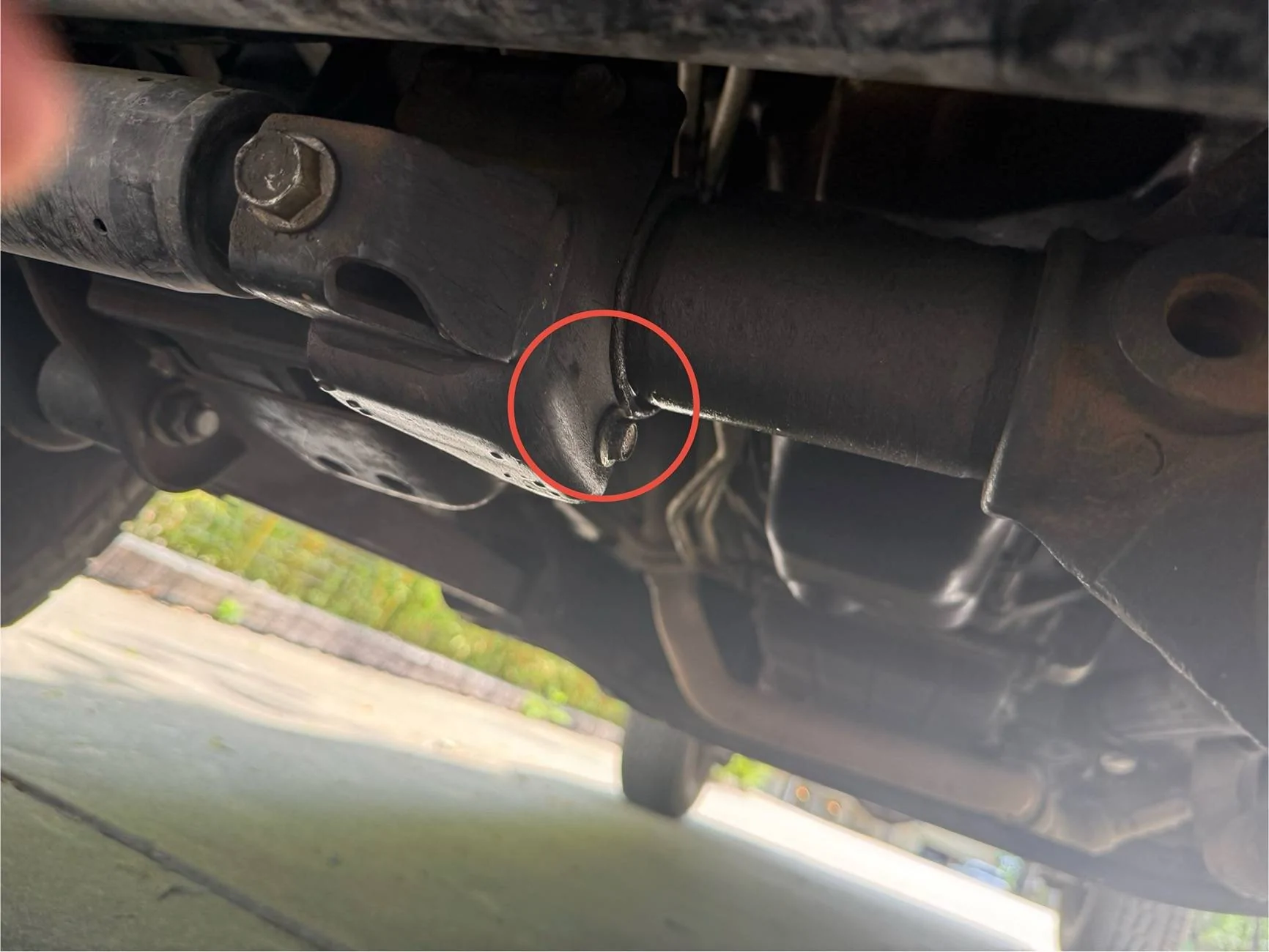

I ended up calling the Jeep dealership directly, just to ask what the diagnosis was and what parts were ordered. This was bad of me, apparently. It escalated a bit, and now there is an email chain so Carmax can send me information directly.
Anyway, they are either replacing or resealing the oil pan and replacing the differential assembly. Both Jeep and Carmax are going to check the axle to see if the entire thing needs to be replaced, but the differential is on order because supposedly it is backordered for 45 days at minimum. because of supply line issues.

My bingo card had the Front Axle Disconnect (FAD) on it since it's engaged when you use 4H/L and it's on the right side of the axle.

Yeah that’s what I thought too, which is why I sort wanted them to actually explain it to me.
But differential makes sense.

I called Customer Service at Jeep and they gave me the part and order number. They are replacing the whole front axle, not just the front differential.
I am not sure if something changed or there was a miscommunication.

I talked to the dealership when I picked up my stuff. It was aways the plan to replace front axle. It was just being called the diff assembly at times and maybe the CarMax guy didn’t know that meant the whole front axle, because why wouldn’t he tell me when I kept asking if they would also check the rest of axle? Sigh .
Jeep also said they checked the frame and everything is straight.

I just wanted to give an update. It took almost two months. But I have my Jeep back. It has a whole new front axle and I now have an extended warranty through Mopar.
It seems okay, except for the steering wheel is crooked now. So I have an appointment at the dealership for an alignment.
