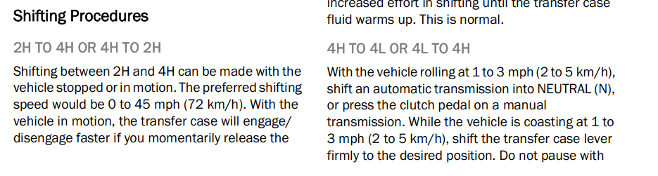

I'm pretty sure I had to pull more than 35lbs of force to get her into 4H and then 4L for the first time. Judging from my days lifting dumbbells, it felt more like 40-50lbs of jerking er back. Granted, I did this while in Neutral but the manual says to do it while you're in Drive and up to 40mph. For 4L, it says to shift into neutral and go from 4H to 4L while rolling 1-2mph.

I'll add in that i read about how stiff the system can be from the factory, with 15 miles on mine it was STIFF 30lbs doesn't seem like nearly enough. Also once you hit 4low be prepared for just as much effort to get back out. The advice in the manual to try and skip neutral is also good. If you pause in neutral it's going to take some effort again. If it breaks that's what the warrenty is for.

I tried both stopped and slow roll , will not budge . Pulling hard enough to move it ( 30 lbs of aft force ) .
Try this - at 5mph lift off the throttle as you pull the lever. *edit* - don't hesistate on the shift, the rotating assemblies lose momentum and you'll get a grindy noise, if you don't get it, go back to 2Hi and start again. It needs not just a hard pull but a quick one, you won't break it, it's a truck.
Gear changes whether a MT or transfer case, are always smoother when you release the load. Same principle behind a quick shift on a motorcycle, when you blip off the throttle you unload the transmission allowing a clutch less shift that's as smooth as can be.
Ten shifts or so and some brief driving in 4L will loosen it up. It will never get 'easy' but that's part of the charm vs cheesy push button.
