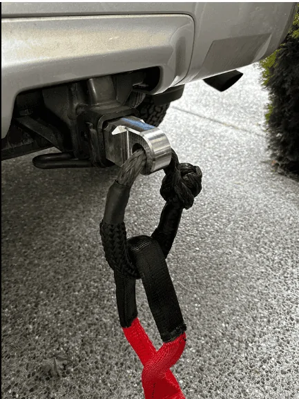

I have a feeling one of the two is off in numbers. Factor 55 has a pretty low WLL - and a really high breaking number. That's an odd spread, IMO. I bet the spread is smaller in reality. I think the two are actually closer in numbers. Not picking on the Factor 55 - quality stuff, but I think their WLL is conservative and i can't see their breaking at almost double what the other's breaking number is.
I've found other pictures that make that radius look a lot more close to the same in other places, but even if not - it's a simple fix......... or don't use a soft shackle. It's pretty easy to smoothly radius aluminum.
Factor 55 -
Here's the less expensive unit - awfully close...........

My hitch block is steel, and I’ve had it for years. It’s not rounded or rated for soft shackles, but I also rarely use it since the recovery ring on my hitch skid is. I keep the block in the Jeep for the other car. If they have a receiver, I just use it with a clevice. But usually the stuck vehicle has no recovery points. I put the soft shackle through a couple wheel spokes in this case, and had the pullee in neutral. I’ve wrapped a strap around A arms, axles, and used the puller’s thread in recovery ring if it’s a straight pull. In almost all cases, I need two soft shackles and one strap or rope. If I’ve got easy access and time, I use the winch, it that doesn’t apply to your wife’s JL.
Factor 55 definitely uses conservative numbers. Personally I appreciate that. They have a solid background though. In my previous research for looking for my own items I found Factor 55 to be one of the 3 or 4 companies that use a similar safety net for their rigging equipment as professional straps, shackle, etc that are used in heavy construction/repair industry. Safe-Xtract is another one that not many people know about, but they dont offer what I personally wanted to have. I can't recall what the safety net is but something like 4.5 times seems to be in my mind. I could be totally off on that, can't really remember.
In those pictures you posted, something to seriously consider is the angling of the rounded edges of those holes. You already mentioned it too which I expected considering your knowledge base. The radius of the curve where the shackle would go through. Now, there are a lot of people who would say "hogwash that doesn't matter". But actually, it does. There are specifications for different rope manufacturers for what their product allows in terms of radius turn angles. Too sharp of a corner can ruin, or worse, rip and tear, both a composite/soft and steel line - not usually as big of a deal with hardened steel shackles. Usually it doesn't matter as much with just an attachment point, but, in that second picture of yours, I would not trust it. It 'probably' would be fine. But to me, fine is not good enough to trust in a recovery situation. I want to know darn sure that whatever items I have in my recovery bag are capable of handling 4 times the amount of what I realistically expect myself to be in. Which is why I have a rear winch in addition to the front winch.
It can actually be worse on some steel rope - because the outer strands are the outer strands throughout almost the entire "curve" around that radius.
Why that matters? The outer wires in the steel rope are being pulled while the wires against the radius, say a shackle, are being compressed. This puts almost all of the load on the outer wires in a steel rope. A 10,000 wire rope (just tossing a number out for kicks) is rated at a straight pull, all wires in the rope basically under the same tension. But make a bend around something and now the outer wires are taking most of the force while those in the inner layer of the curve are compressed, handling pretty much no load.
It's critical enough that makers of cable, or wire rope, publish charts of recommended wire rope size for each radius or pulley, for example.
It's similar for rope although a braided rope helps because the outside strand of the rope in one area becomes a side strand or strand against the shackle in another area, still, it leaves places where some of the strands of that rope are being pulled at a far higher force than those on the inside. Same thing applies - the forces of the pull are concentrated on strands on the outside.
Radius matters.
A bit less for braided synthetic than twisted rope or wire rope, but it still counts.
(the numbers are easy to find)

This caught my eye ( no pun intended ), for that very reason, and and it looks like almost any soft shackle would fit through that eyelet. It just looks like a 1-trick pony to me.
