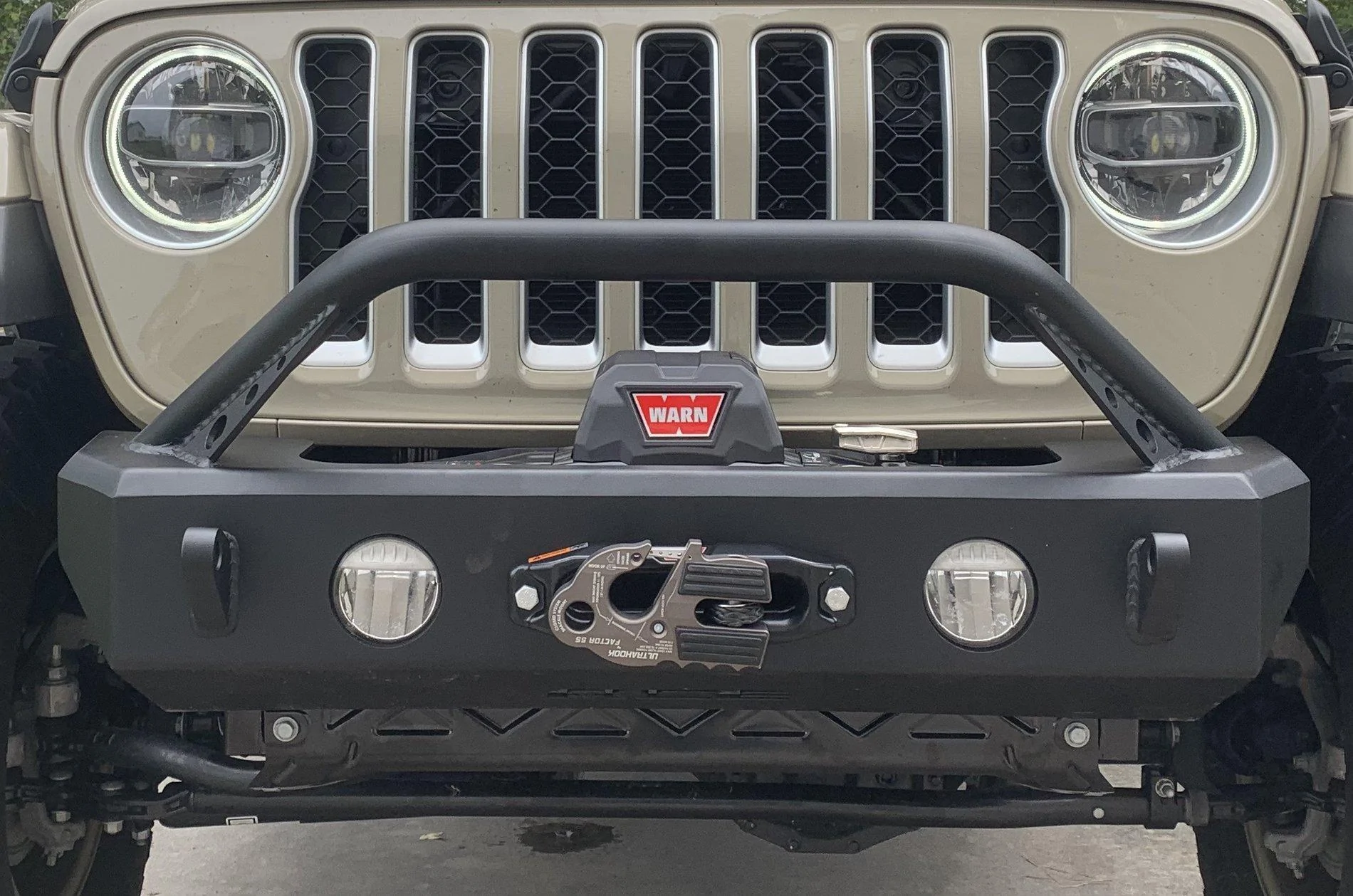

I went with the Warn VR EVO 12-s. It’s only been on the Jeep for two days, so I haven’t had a chance to use it yet.
So so clean! May I ask what lower skid plate you have covering the "horns" and sway bar motor? Thanks.

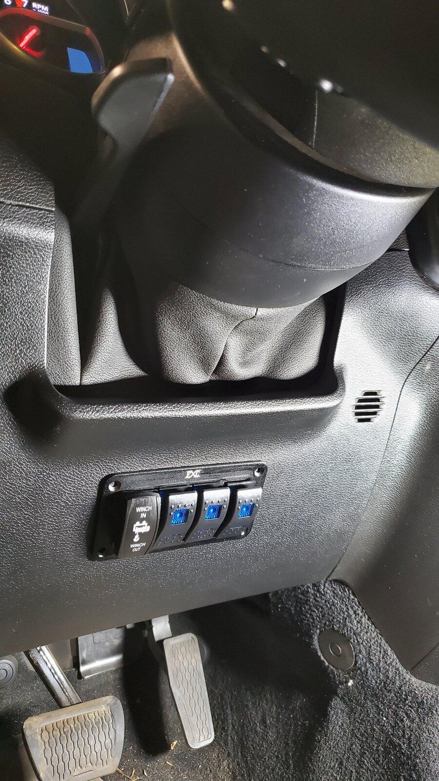

I wired my Aux switch to Warn power interrupter. So pressing Aux 3 for me makes winch live then I have a remote switch under my steering wheel to activate winch out or in.

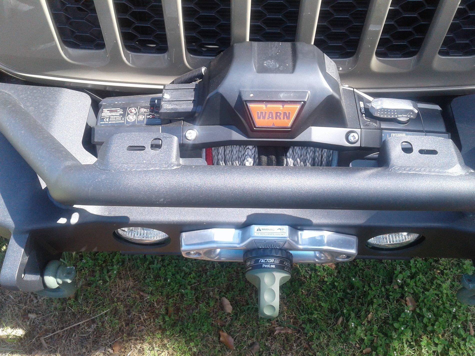

I did the classic Warn plate and VR10s with the stock steelie bumper. I like it, its clean, its somewhat light and well…. Its a Warn. Only dropped 1/4” on my front end. Adding my Mojave springs tomorrow, undecided if I will add my extra .5” spacer along with the 1” height the Mojave springs give. Im thinking 2-2.5” front with .75” is a good stance. Still some rake.

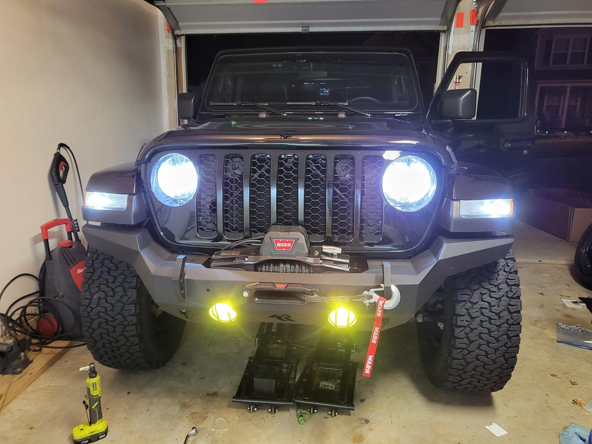

I ordered a VR EVO 10 and WARN mounting plate today for my Mojave and Mopar steel bumper, I did seriously consider the ZEON 10 but there was no stock with long wait times from vendors that I normally used, also reading about how tight of an install it can be made me switch for the EVO.

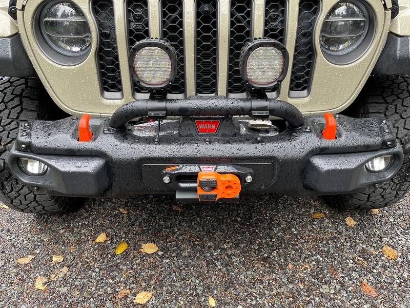

Installed the VR EVO 10-S yesterday:

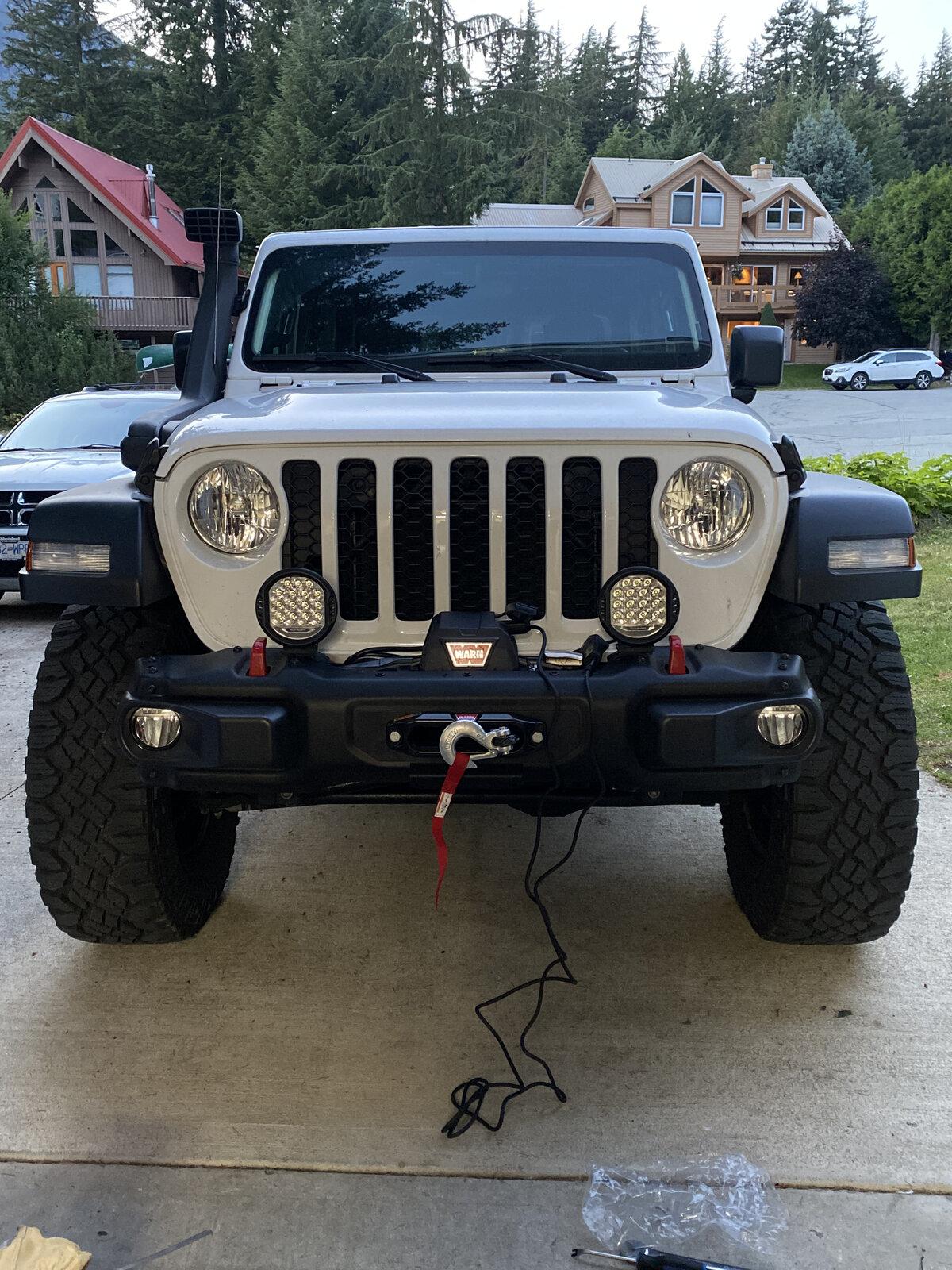

Installed my VR Evo 10-S on Friday! The wires are a bit messy to the control box. I didn't tidy them up at all. However, I did properly route the cables to the battery.
Jeep Gladiator What is the best winch for my Jeep Gladiator 2020? Winch installation and Warranty. 20211008_193935
I like how small and tidy that looks. Mine is basically sitting on top of my bumper. Post below yours.
