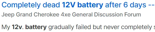

For those always blaming the small battery for the problems of the main - take a look at the dozens if not hundreds of 4xe owners griping about their 12v battery life.
there is no aux battery - their main batteries are lasting from 1 month to 2 years.
But then, like the JT with an engine as the only propulsion and an actual alternator, the 12v battery on those is only charged while the vehicle is alive or i "ready" mode. So it's pretty much the same charging profile as an alternator - do we have a combination of crap batteries and infrequent or shorter drives on that side as well?
If so, then we've proof that your main batter is destined to fail more frequently than you like, no matter if there's an aux battery or not - at least until you maintain the voltage or change to a better battery.
You can't blame any ESS or aux battery for the many battery threads out there among 4xe owners.

Again - this refers to the 12v battery -
Jeep Gladiator Battery Charging/Tender Question 1697558911686
Face it, you are going to have battery issues with a Jeep - aux or no aux unless you swap to a non- Jeep branded battery.
Those snips above are just a handful of what's out there where people are griping about the Jeep 12v batteries and those I posted don't even have an aux battery!
