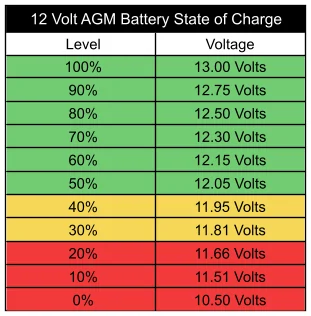

What ever happened to the good ol' days when if you measured 12V on your battery, you were in tall cotton...
It's just not the case. This shows charged voltage, the resting voltage overnight on 100% health would be in the 12.7-12.8v range.
Jeep Gladiator Aux Battery is OK, what else could cause "Start/Stop not Ready, Battery Charging? 1711994138533-zr
So at 12.5, you've lost some health, but it's still a usable battery. Add to that some drain when it's hooked up, and you're likely down to 12.3 or so real-world. ESS is very sensitive to voltage to protect itself from non-starts, so it might not be happy with it, and disable itself out of caution.
If he fully charged the battery and it only showed 12.7 volts, there was no surface charge - which right away says - "hmmmmm" to me.
But if it starts at 12.7 then just over-night with NO cable attached at all, both posts totally bare, not even the IBS connected, positive cable off, the whole bit, bare battery and it drops to 12.5 over-night, it's not a good battery. An AGM, for that matter, any L/A battery should hold the charge for those few hours. Even my Eagle battery likely still shows the proper 12.6 volts and that's sitting for a few days.
So going from 12.7 to 12.5 just in a few hours indicates an issue. It's either not actually fully charging due to some problem (charger or battery), or has a problem otherwise.
I'd right away consider that as a bad battery or one on the way out.
No AGM battery should drop like that with zero load on it.
