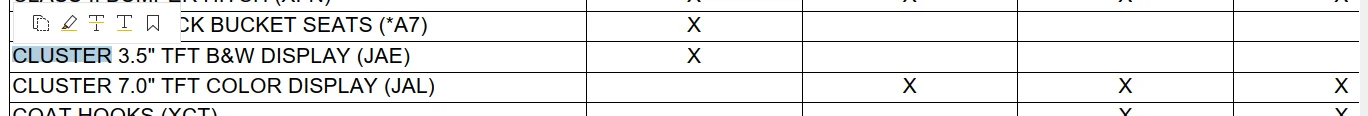

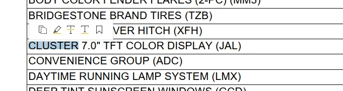

Jeep Gladiator Info center not working, Start Stop not working,  Could it be the Aux. battery? 1674662894423
The base Sport with nothing fancy has the small black and white cluster.
Jeep Gladiator Info center not working, Start Stop not working,  Could it be the Aux. battery? 1674662961966
