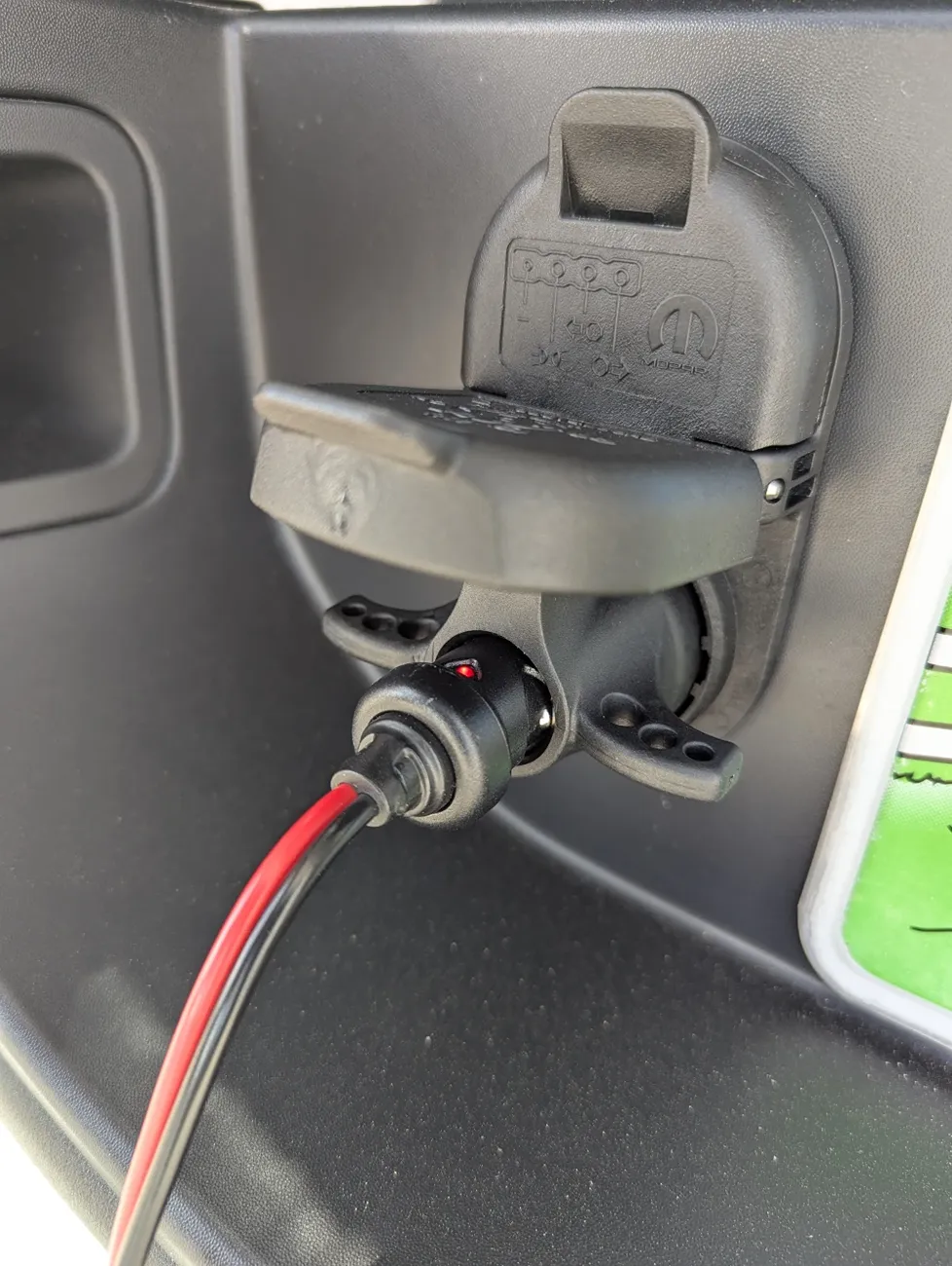

I never thought about this being an option. My Jeep often sits for weeks at a time. I have three battery tenders and just sold one of the classics. I bought the 10’ cord to plug it in next to the garage where I park it. It’s never not started but I’m sure it’s better for it

I have been using this setup for a long time. Case in point, I just changed the OEM battery on my 2020 JTR. This works for me. Here's the link to the 7-pin plug that I use.
https://www.amazon.com/dp/B06XKNKHG9?ref=ppx_yo2ov_dt_b_fed_asin_title&th=1
Just wire your trickle charger to the junction box and you are good to go.
When I plug it into the truck, I make sure that the 7-pin plug does not latch when I plug it in. Don't have to worry about ripping it off the wall if I do forget to unplug.

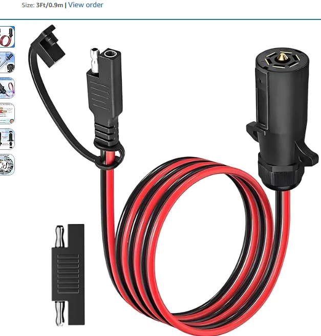

Will this gizmo from the place of big wimmins do it all?
Amazon.com: Pjerjzn 7 Pin Trailer Plug to SAE Connector Adapter - Heavy Duty 10AWG 7 Pin Trailer Cables 1/2/3ft Waterproof Trailer Plug Adapter for RV, Truck, Marine 12V Devices (1Pack, 2ft) : Automotive
That should work. It looks almost identical to the one I purchased and used last week.
Adding this - https://www.amazon.com/Werks-Gruppe-ChargeSafe-Disconnect-WG-MCA-002/dp/B0CV3DLFRX - would eliminate all the worry about driving off with the charger still connected.

Thanks for the guidance folks, mine came today, plugged in, and the OVERLORD has not caught fire ..............YET!
