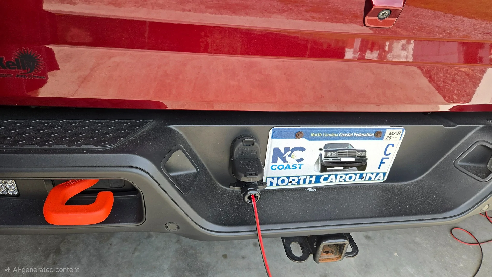

I stumbled across this post on reddit last night and ive never seen or heard about this.
This user plugs a battery tender into his hitch plug. maybe it would benefit some members here if it works.
Can someone explain this to me? Ive thought about it a few times and i cant make it make sense. Im unsure how a charge current goes though the hitch plug to charge a battery. i would not expect the wiring to be able to handle that load.

It does work. A few people here do that.
It's just a wire from the 7 pin connector to battery hot with a 30A fuse I believe.
You don't get crazy and fast charge 30 amps through it, lol. Folks are using trickle chargers / low amp chargers through that plug.

Using this on the Gladiator since 2021 and a Grand Cherokee diesel from 2018. No problems. Don't have the GC anymore (HPFP failure and rear main seal leak) and the Gladiator is still on the original batteries. If its in the garage, its plugged in.
Bonus is that the 7-pin outlet gives you a 12vdc power port at the rear bumper which is always powered.

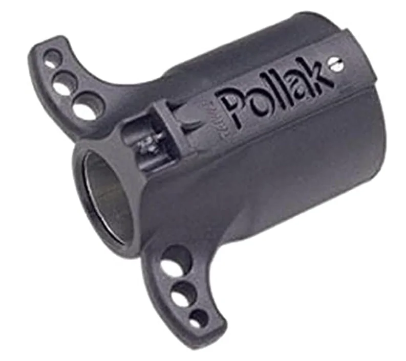

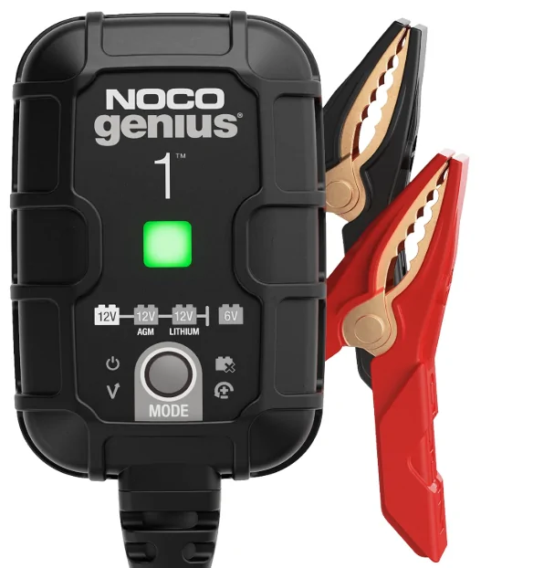

I travel a lot for work, often gone for long durations. I have been using these with great success:
https://www.amazon.com/dp/B002UC8U7G?ref_=ppx_hzsearch_conn_dt_b_fed_asin_title_1
https://www.amazon.com/dp/B07W46BX31?ref_=ppx_hzsearch_conn_dt_b_fed_asin_title_13&th=1
Jeep Gladiator Battery tender hookup to 7pin hitch plug 1769527457326-0f
https://www.amazon.com/dp/B004LWWNI0?ref_=ppx_hzsearch_conn_dt_b_fed_asin_title_13
Jeep Gladiator Battery tender hookup to 7pin hitch plug 1769527427362-i5
Jeep Gladiator Battery tender hookup to 7pin hitch plug 1769527499611-ef

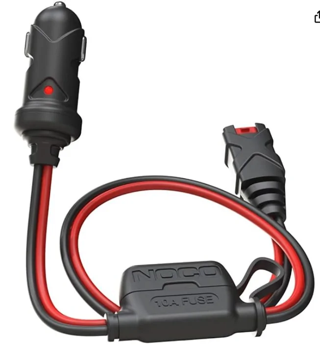

Got these delivered 11 days ago. Works well for my situation. Been too cold last few days but garage will be heated next year (charger says don't use below -4F, i don't want to risk it)
ELFCULB 7 Way Trailer Plug to SAE... https://www.amazon.com/dp/B0D1R1CQF1?ref=ppx_pop_mob_ap_share
NOCO GENIUS2: 2A 6V/12V Smart... https://www.amazon.com/dp/B07W6B987F?ref=ppx_pop_mob_ap_share
NOCO GC009 X-Connect SAE Adapter... https://www.amazon.com/dp/B005DUMADC?ref=ppx_pop_mob_ap_share
Be certain the polarity is correct!
