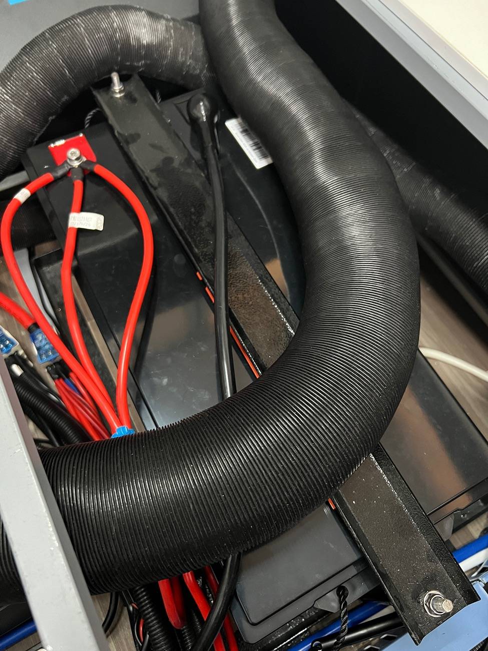

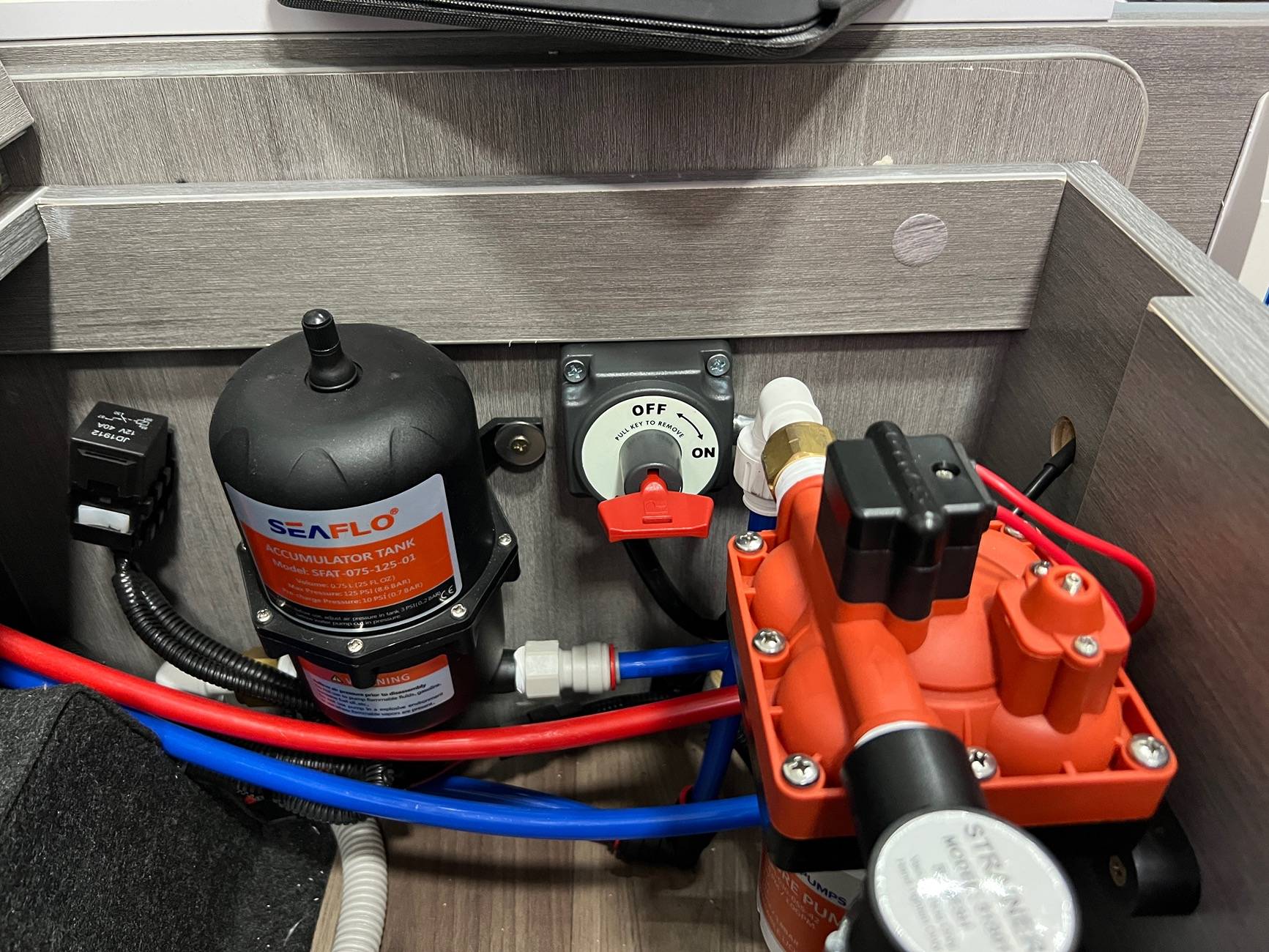

Ok update and against the grain I went negative.
No reason other than the way the factory lines laid out it made most sense.
Programed a custom charge profile and all set.
This was in my trailer replaced the 3 100 amp hr amg with a 300 amp hr lithium.
Added a cut off switch to isolate 100% when in storage.

Going against the grain on a 12 volt negative ground system is not really a great idea, you received good advice. Everything in your camper is negative ground, the frame any metal part of lights, and just about everything your positive cable might touch including the bracket holding the batteries down. The battery is isolated though.

Going against the grain on a 12 volt negative ground system is not really a great idea, you received good advice. Everything in your camper is negative ground, the frame any metal part of lights, and just about everything your positive cable might touch including the bracket holding the batteries down. The battery is isolated though…..Jack
If the battery negative is isolated those negative grounds don't exist. You could bolt the positive lead from the battery to the chassis and nothing would happen... until you ground the chassis to the battery.
If it's isolated from everything with a charge, yes. That's the reason you go positive: they all route back. Negatives don't, so you can introduce a ground through something else holding charge without knowing it. Might not be likely, but it's the reason you go positive.
Same reason that if you had an old British car that used positive chassis electronics, you'd put the shutoff on the negative side.
