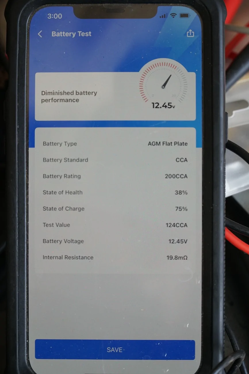

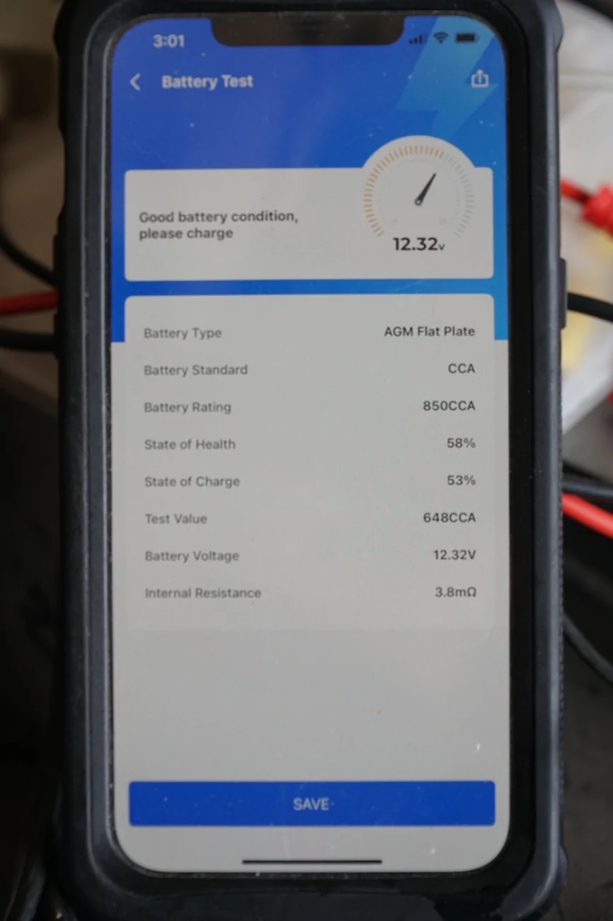

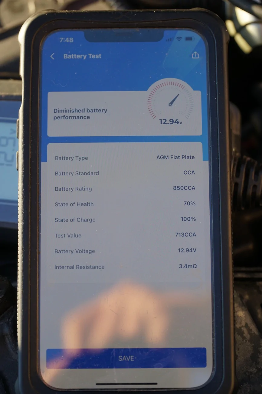

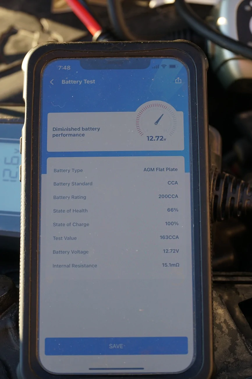

Jeep sitting for a week, 3-year-old batteries. Top is main, next is aux. I will charge both and rerun the test.

The TB6000 is a battery tester and charger. I purchased it three years ago when I replaced my batteries. At that time, both batteries had a health status and state of charge in the high 90 percent range.

After charging batteries together.

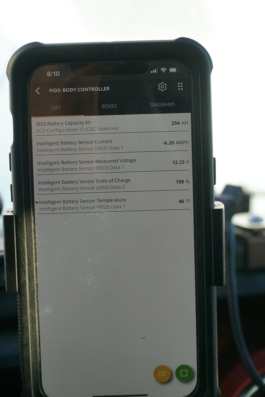

No question, looking at the correlation of IBS data and external battery test.

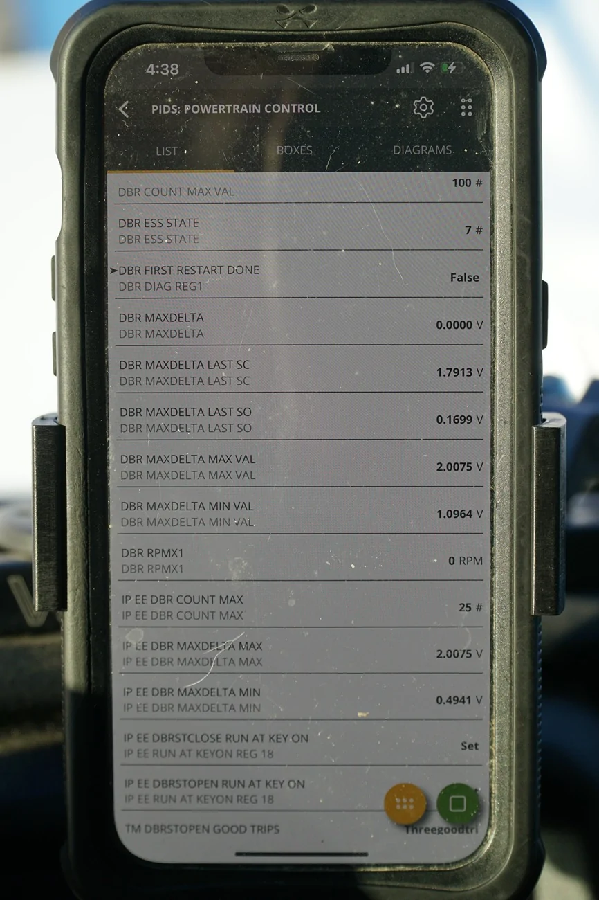

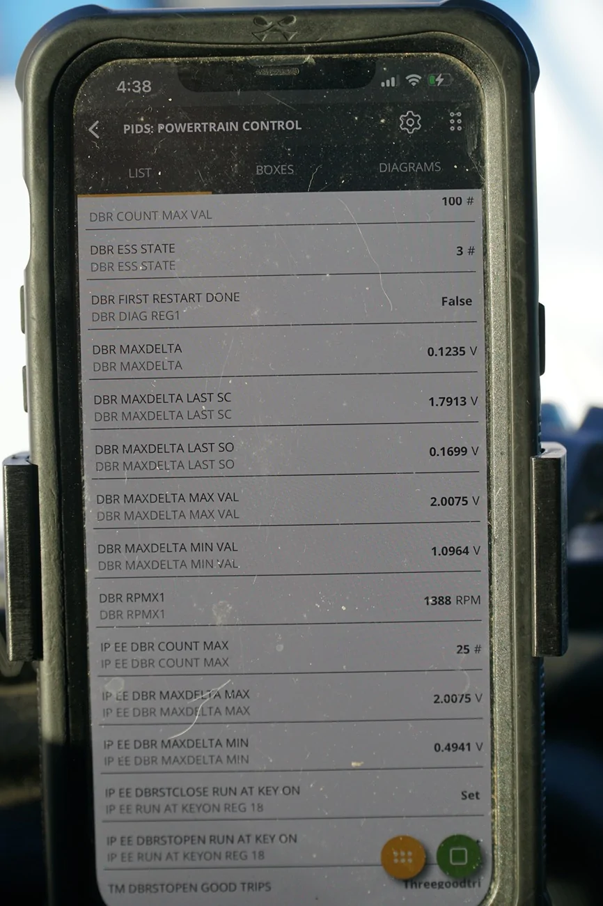

I think the min/max numbers are from the Jeep doing the battery test. Top is key in run, next is running. DBR-dual battery relay. This is JSCAN
Jeep Gladiator Battery test and charge with TB6000 DSC09495
Jeep Gladiator Battery test and charge with TB6000 DSC09496
40,496
54,002
Time to reset IBS and let it relearn. They do lose accuracy with time.................. there's drift involved with their wide tolerance range.

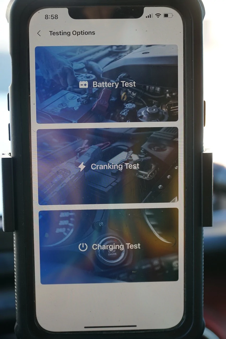

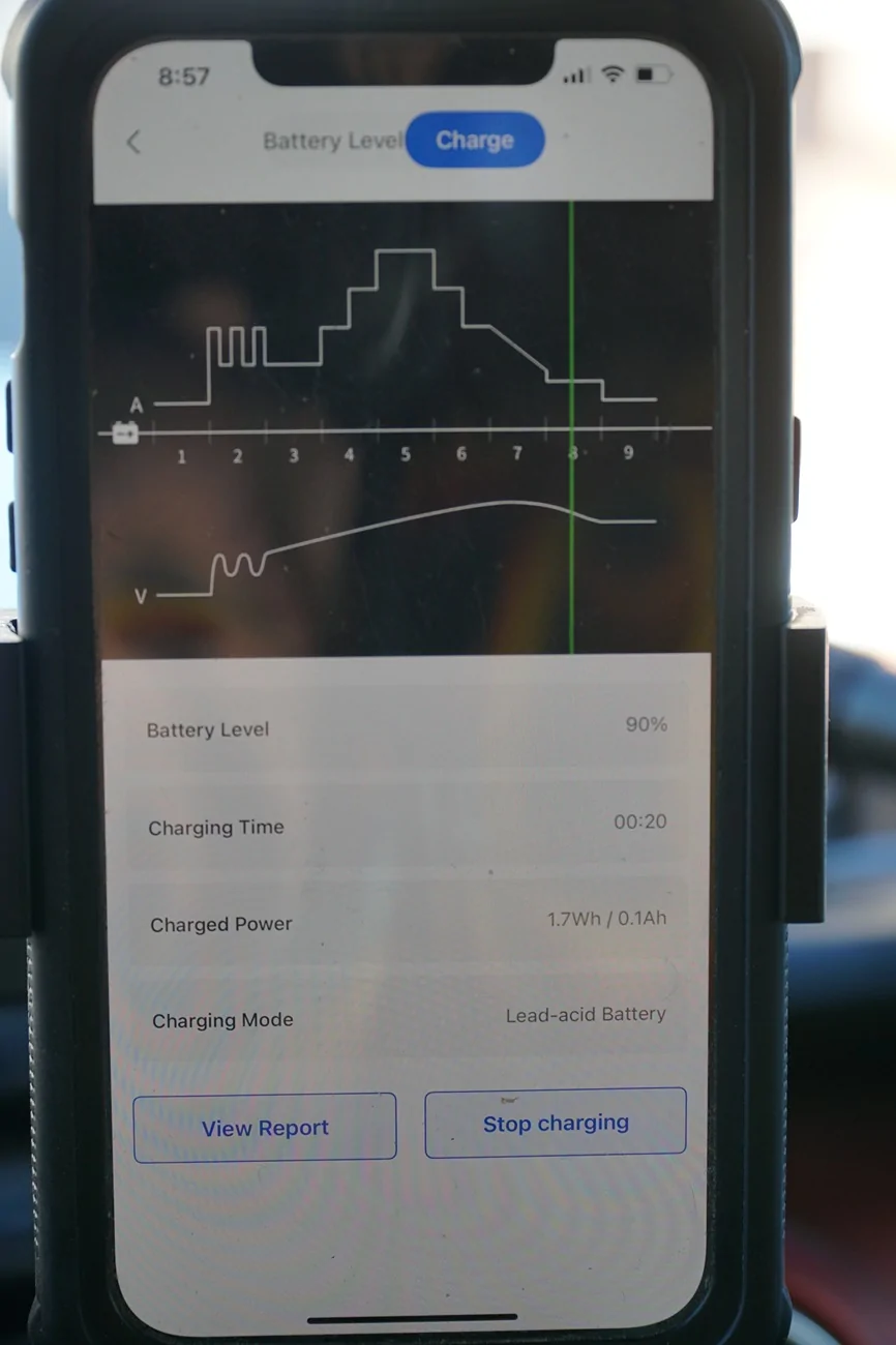

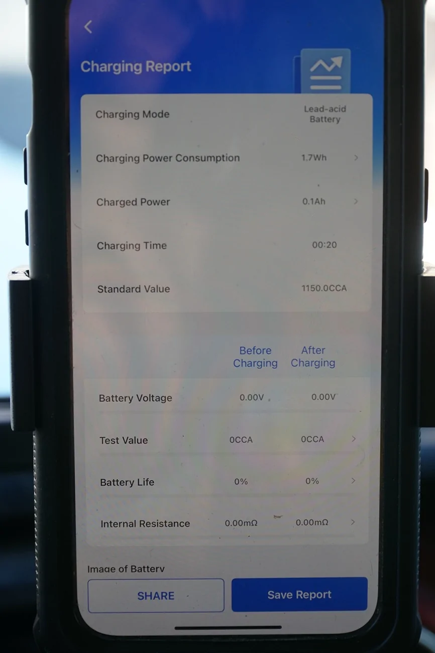

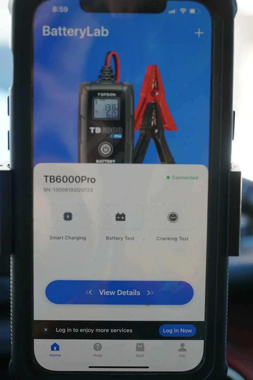

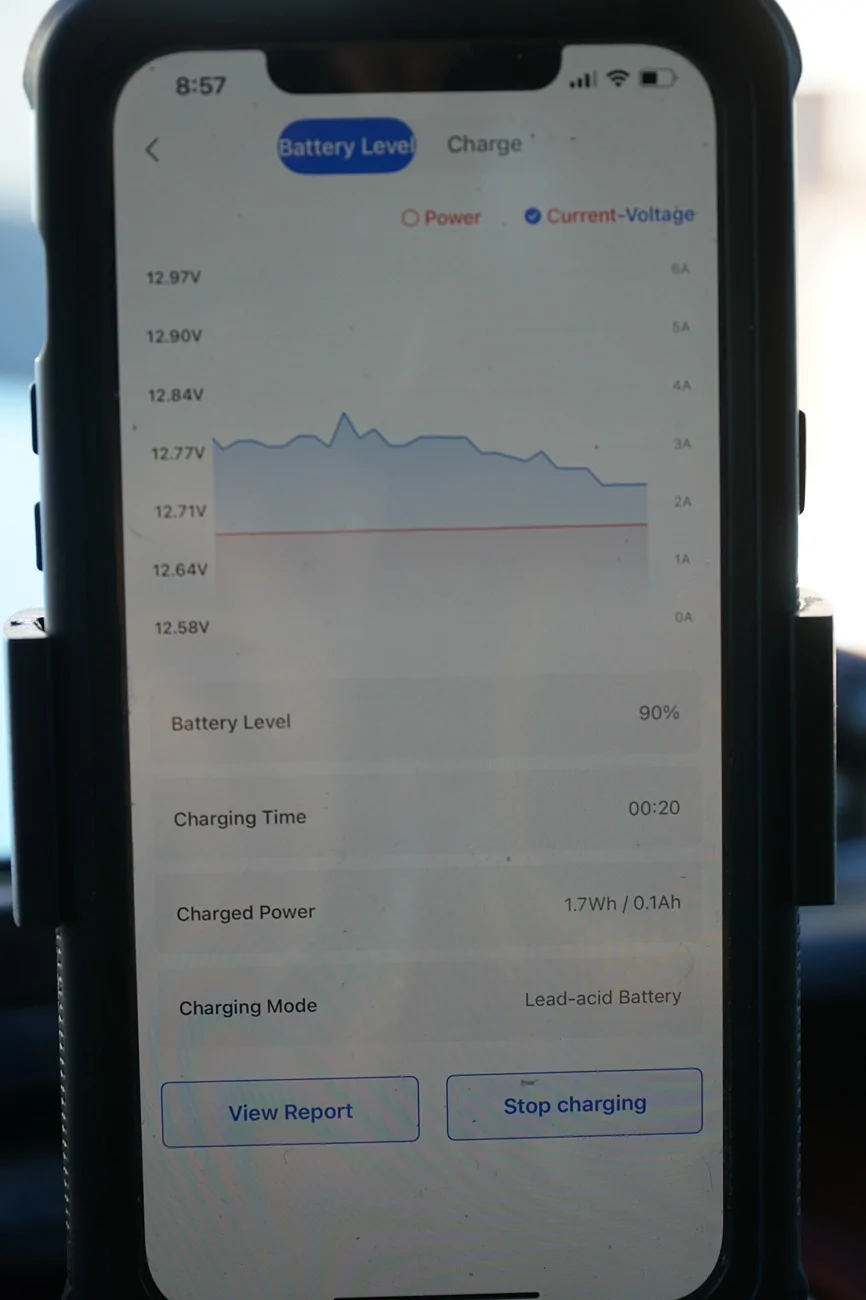

Battery lab for TB6000, test and charge batteries. Has log of charging history and test data. The log and data are on the phone by date and time. Shows charging progress and voltage current graph.

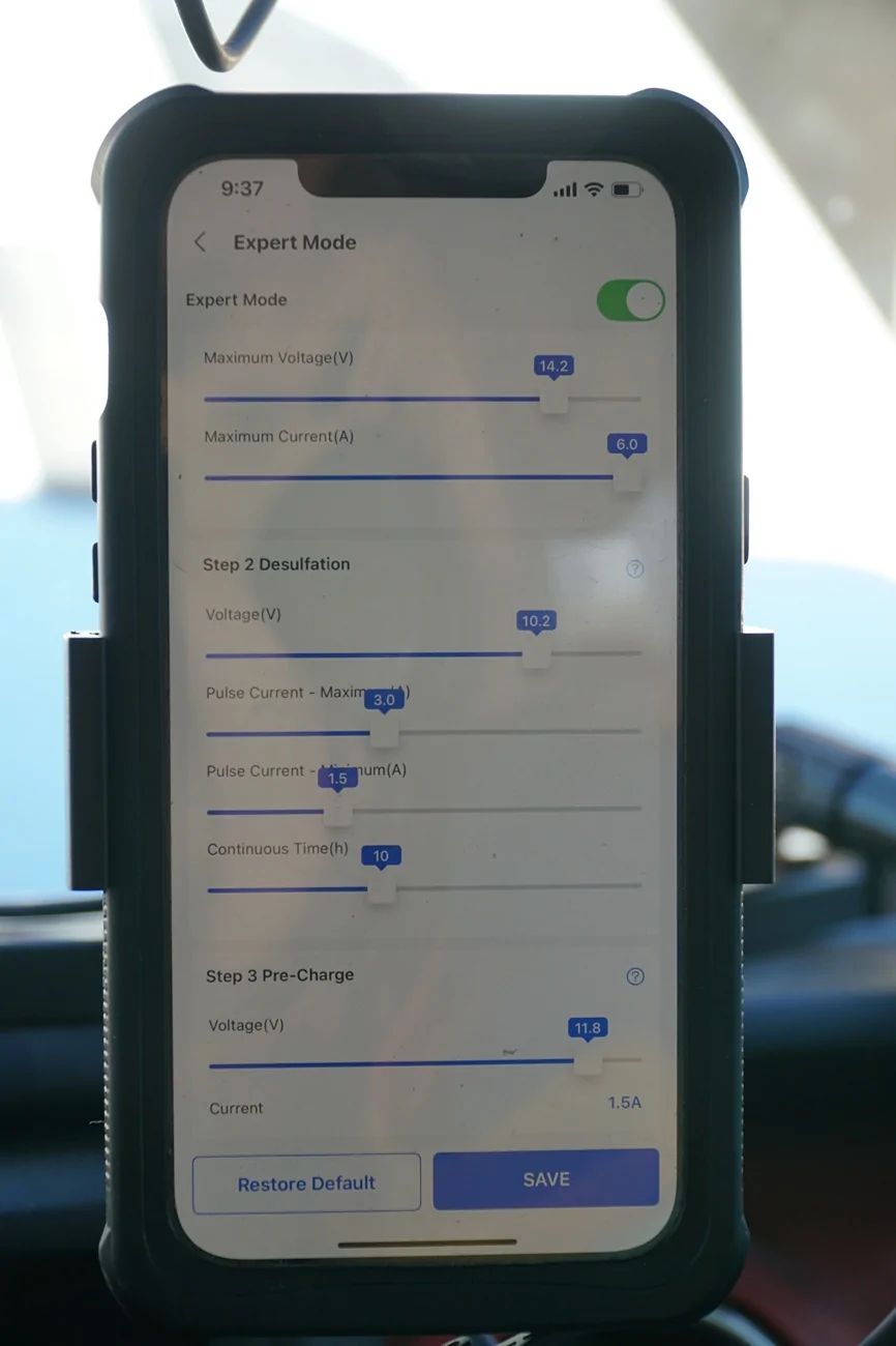

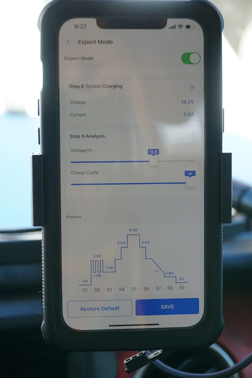

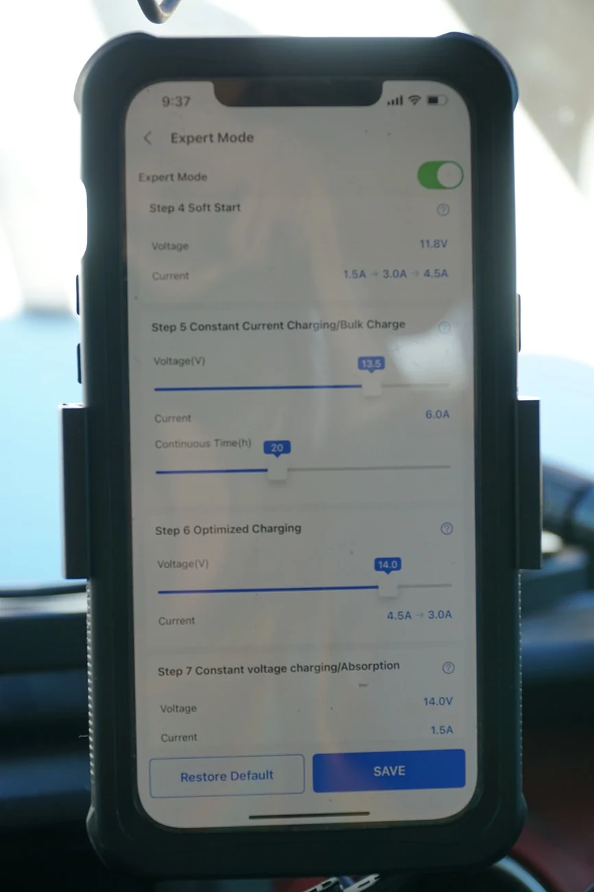

Has lots of fun for $60. Manual control of battery charging.
