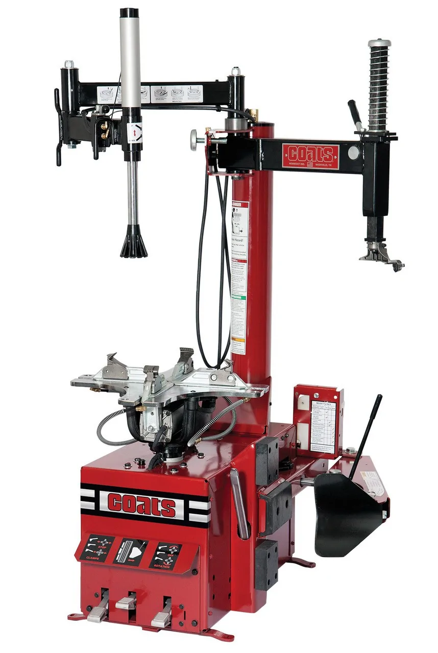

don't tempt me, that is just down the road from me.
If I had a bigger garage I might have already driven down there. If you zoom in on the picture it shows that it is Coats 30-30. I think both gas stations I worked at way back in the day had Coats 40-40As.
Go get that shit. But I wouldn’t pay more than $900 after what I was quoted earlier today.
Ya, that seems pretty high to me. Plus, I'd try to hold out for one of this style...
Jeep Gladiator Beadlock Education 1785818240895-6z
Not necessarily that particular one, but that style. Will cost more, but so much easier to use

Your glutton for punishment.
Agreed.
https://www.bestbuyautoequipment.co...wheel-clamp-tire-changer-w-double-arm-assist/
https://www.bestbuyautoequipment.com/wheel-service-alignment/talyn-plus-2-wheel-balancer/
I’m not doing this right now, but to be able to mount and balance 42’s for this dollar amount is really not too bad.

That looks pretty decent. Looks like it can clamp inside and outside, that's nice to have.
But wait, no road force balancer??? Haha.
That’s why I like you psychos. Comments like that make me smile.
It's not worth it, I don't do enough car tires to pay for it. I have a manual harbor freight changer I use several times a year for motorcycle tires and one off car tires as needed
This is what I use, mostly the stand with my spoons. I have it bolted to the concrete floor.
https://www.harborfreight.com/manual-tire-changer-58731.html
I dig it. I’ll report back soon after I try out the manual tools I bought. Breaking stubborn beads might involve the tiny tractor. We’ll see. :)
The bead buster should work fine, just remember to remove the valve in stem first before you break the bead.
Makes sense. Thanks.
I laugh, only because I know firsthand what will happen if you don't. 🤣
Let's just say, watch your ears.
