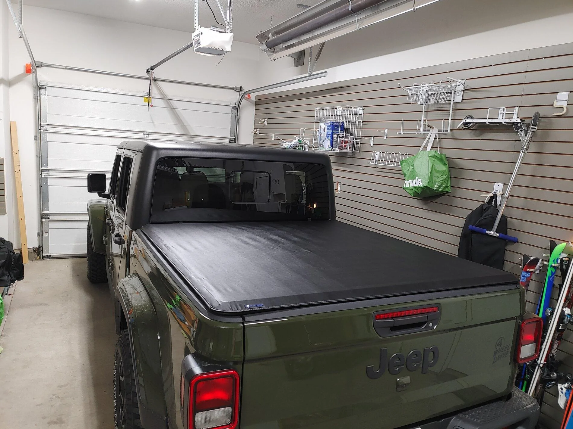

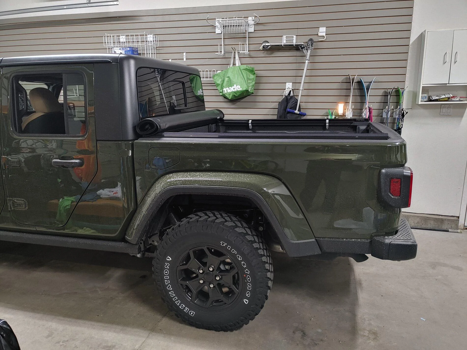

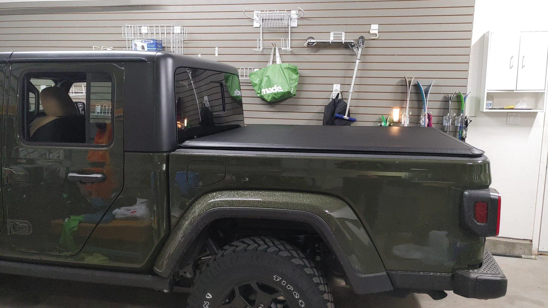

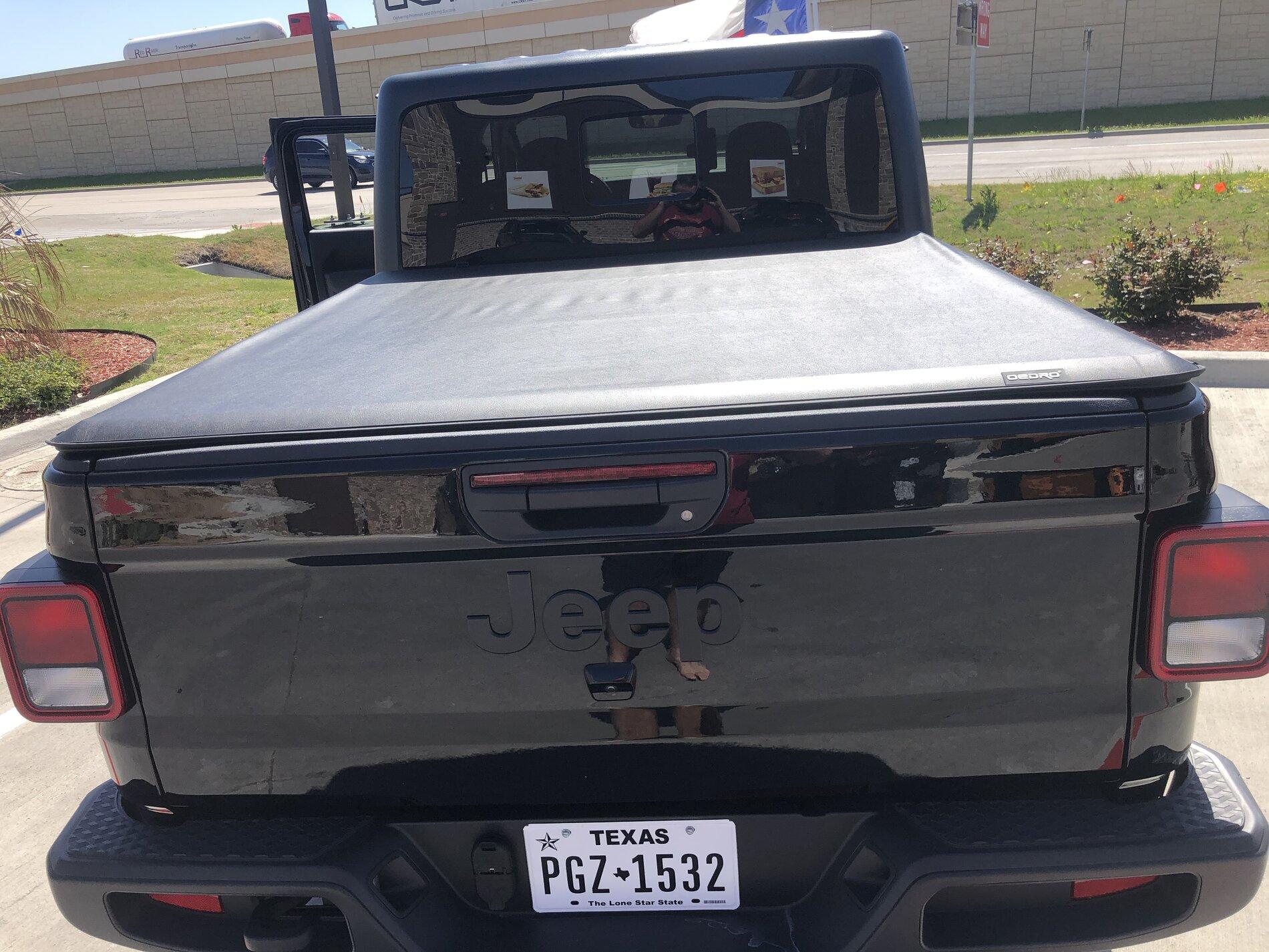

Got the Tyger tonneau on my Sarge Willys this morning. Very satisfied with the purchase. I'm thankful this forum exists as it's pointed me in the right direction on a few purchases and saved me some money!

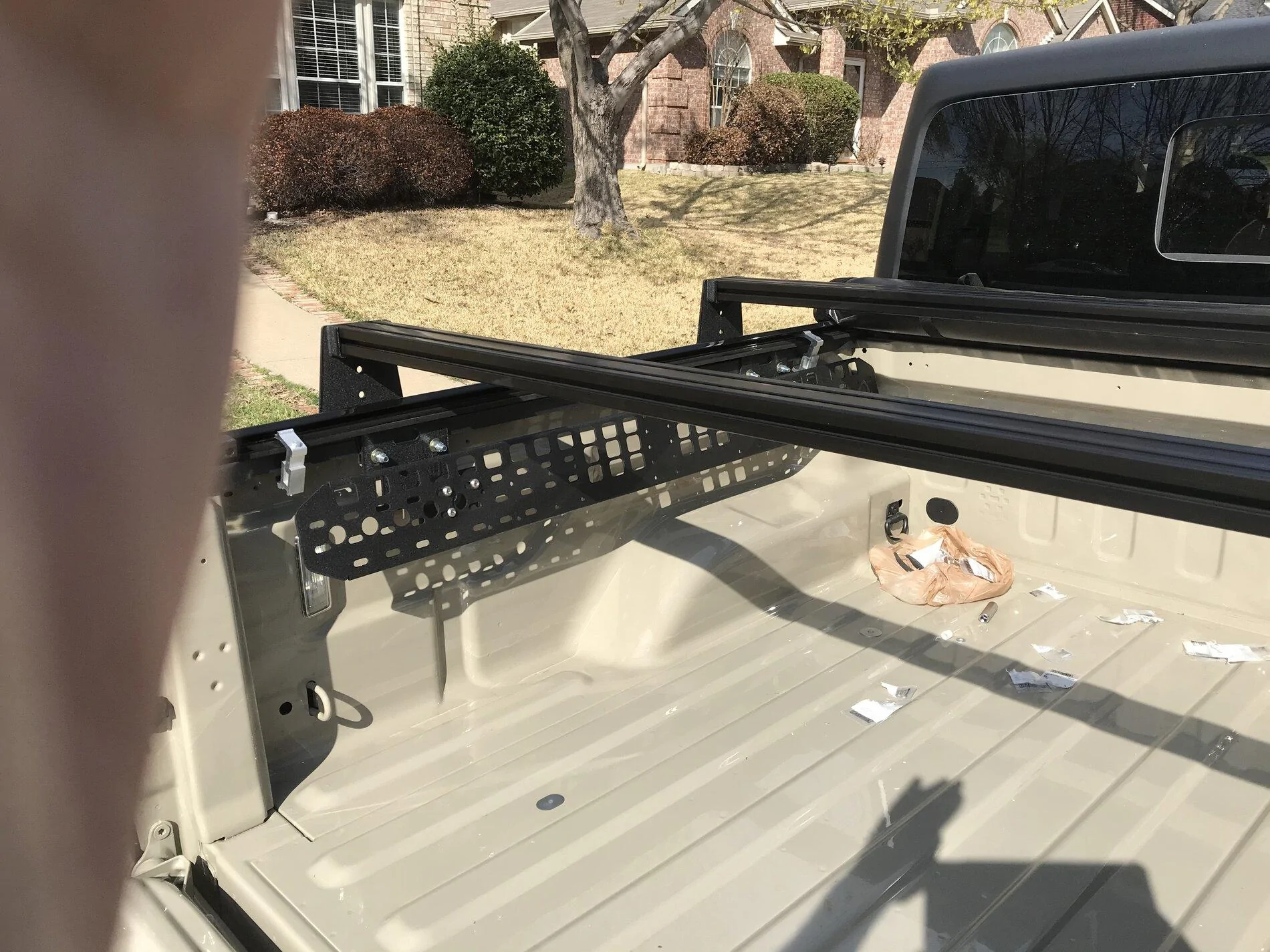

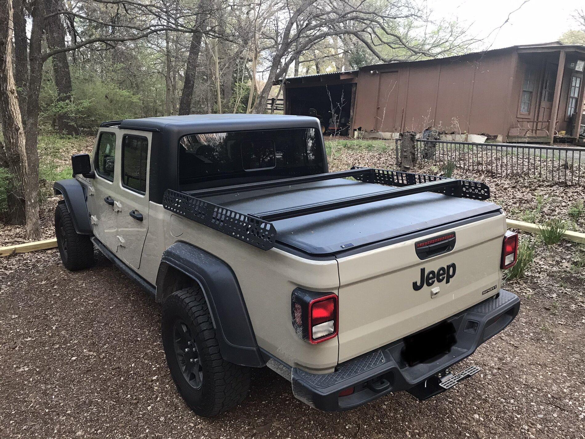

Yes, the tonneau cover rails went over the Bills Bar brackets. The tonneau cover rails won’t sit flush with the bed rails unless you notch out the padding where they cover the brackets, but that was super easy with a utility knife. Don’t need to be pretty since nobody can see it.
What I did was clamp it all together for a while and let the brackets create an impression on the padding. Then just take of the tonneau cover rails and notch out the padding. Perfect fit. Of course, make sure your brackets are where you want them... measure twice, cut once.

... and here’s a shot of what it looks like from the inside. Ignore the molle panel. I’m just testing different configurations.

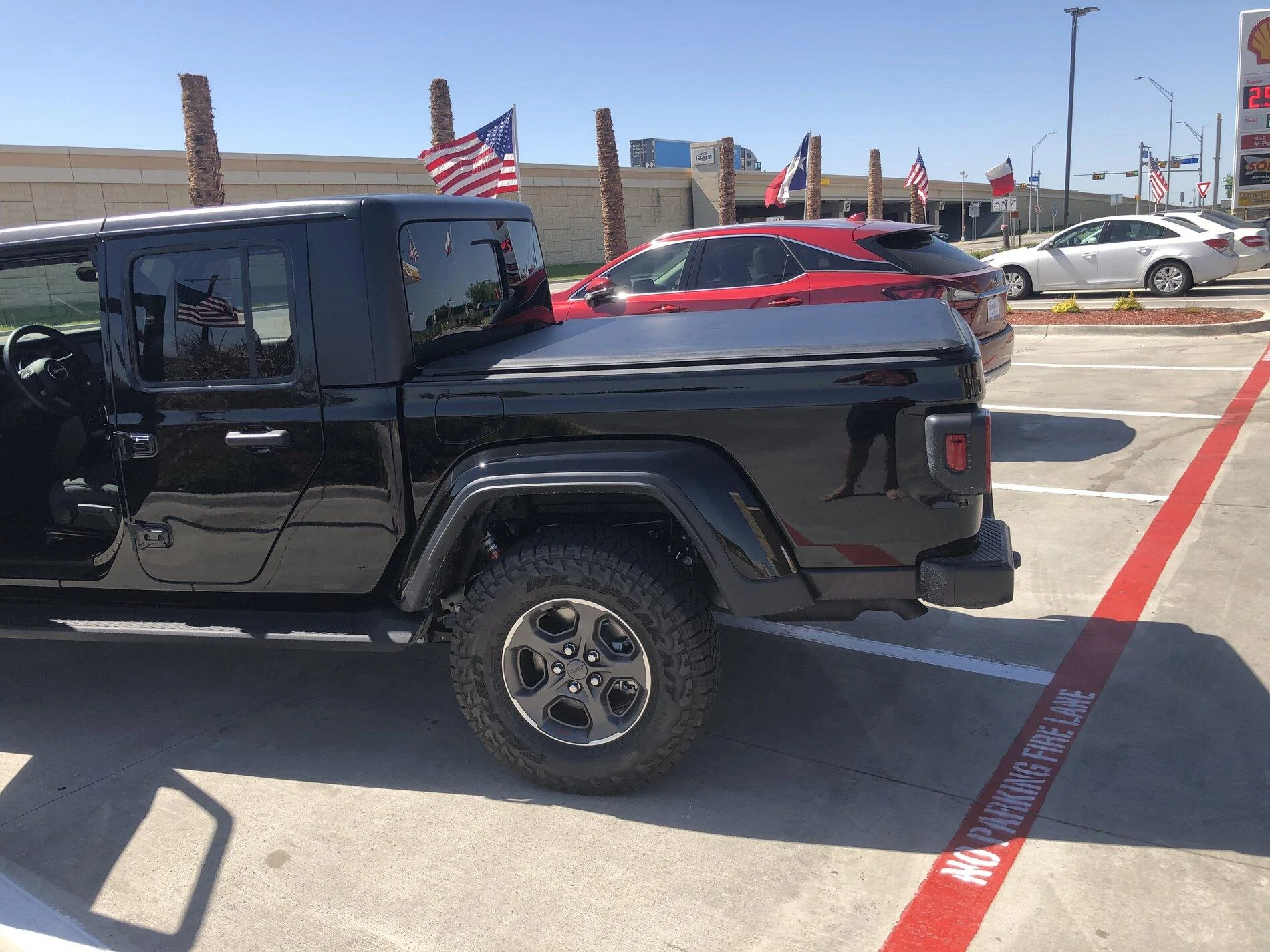

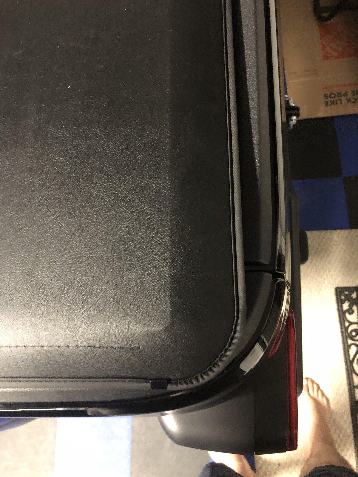

I picked up on OEDRO cover off of eBay for $150. Overall please especially with the costs - the back corners could flow a little better with the bed corners but for the price...

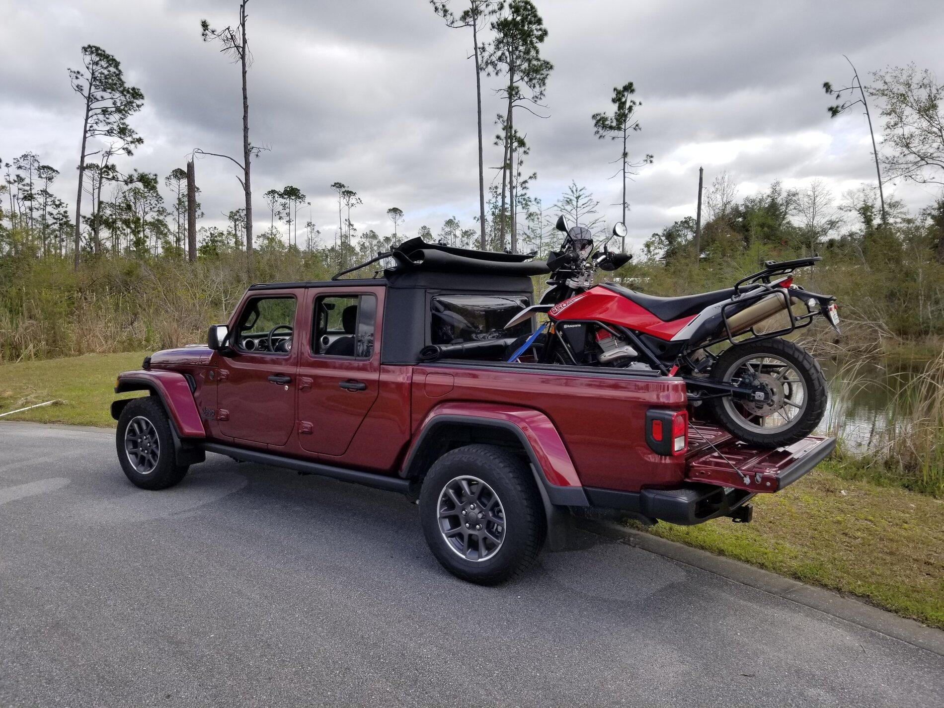

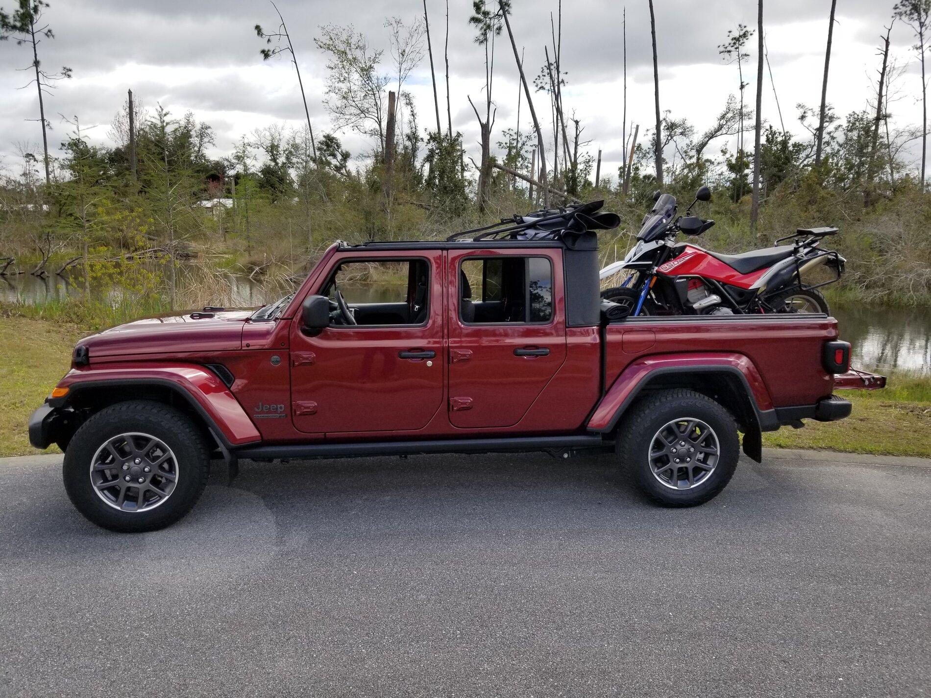

Does anyone use this or another roll up cover with a soft top? I feel like the rolled tonneau might rub and scratch the plastic soft top rear window.
I had a roll up on my Tacoma and much prefer it to a trifold, but my rolled up Tacoma cover rested against the rear window which seems like a no go with the soft top
Its close but doesn't rub the window.
Mine is the OEDRO for the Colorado.

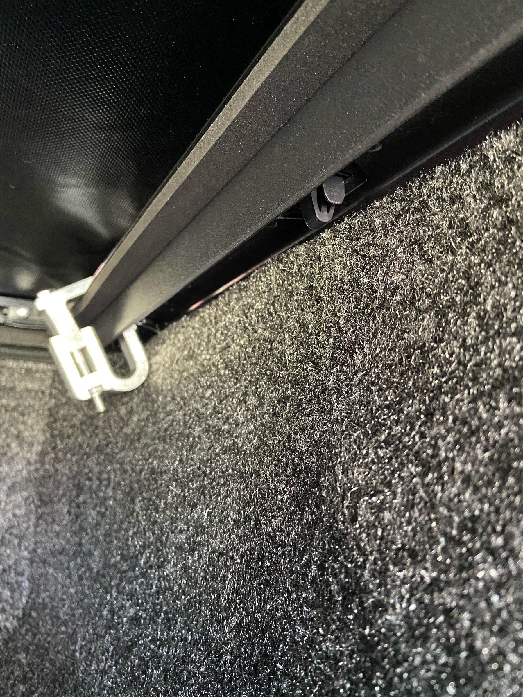

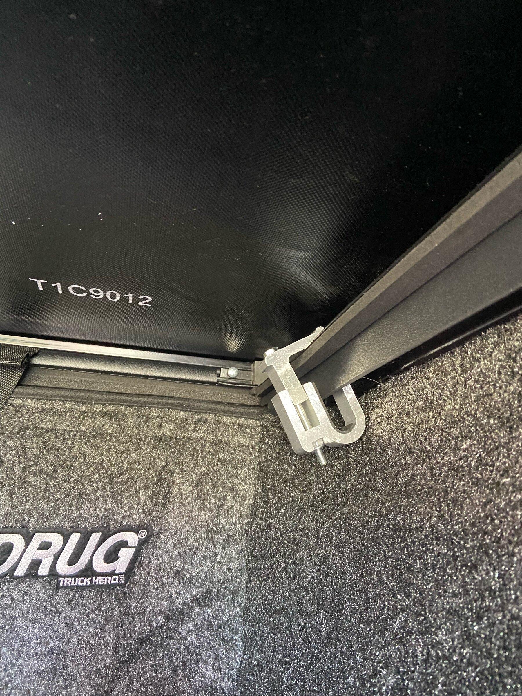

Anyone have rail fit issues with the MaxMate cover? It seems like it's just not wide enough. The rails stick over about an inch on either side, causing the brackets to kinda of tilt in ever so slightly.
I bought the tyger roll up and had the same issue. I did not like that at all and ended up returning it. Thought there was something wrong with the one i was sent.
Those clamps don’t look like they’re snapped all the way in on top per the video. I believe that’s where your tilt is coming from.
Was this ever resolved?
looks like mine and I have the Tyger tonneau... no issues going on 3 years
Do your clamps have the tilt or did they snap in all the way on the top?
