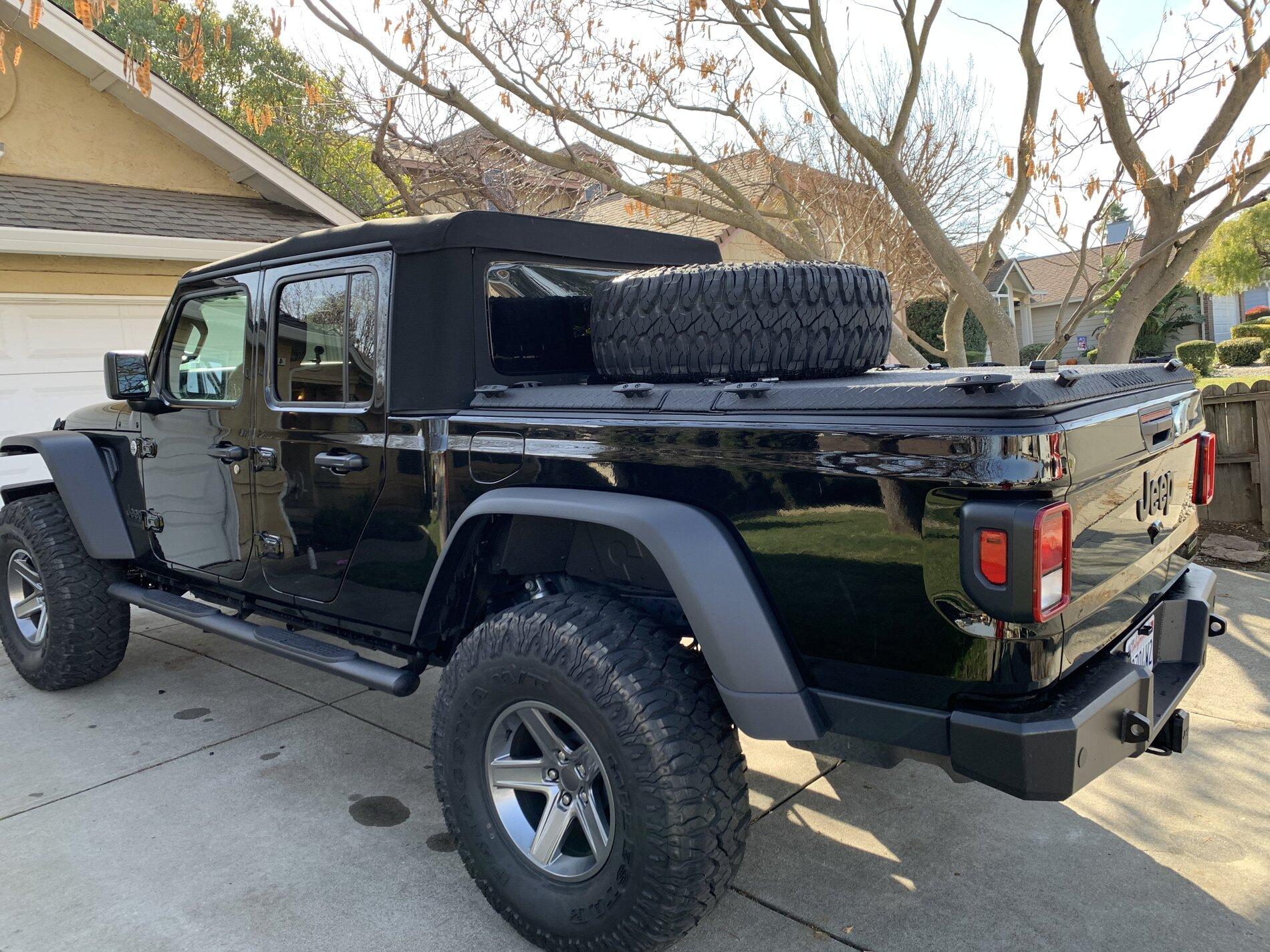

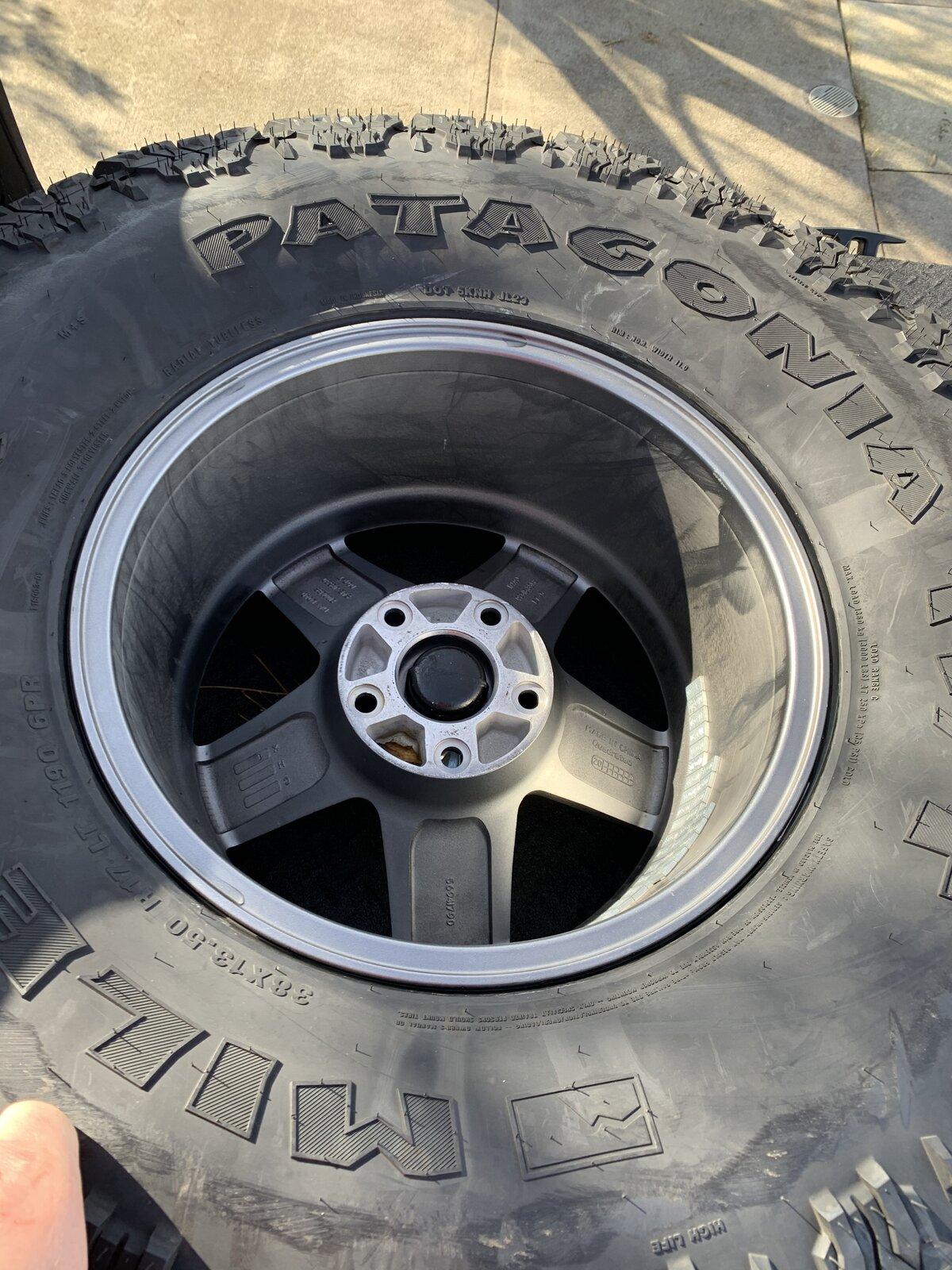

I mounted my 38x13.5/R17 spare on top of my Diamondback HD box cover. It is rated for 1600 pounds so it supports spare with no problem. It is mounted on the forward opening and doesn’t interfere with rear opening. I mounted it with a custom fabricated single point mount made from steel gas line fittings and a very large high strength bolt. It pulls downward evenly on inner wheel lip. No one can steal tire, the nut is on the inside and can’t be accessed unless tailgate is unlocked.

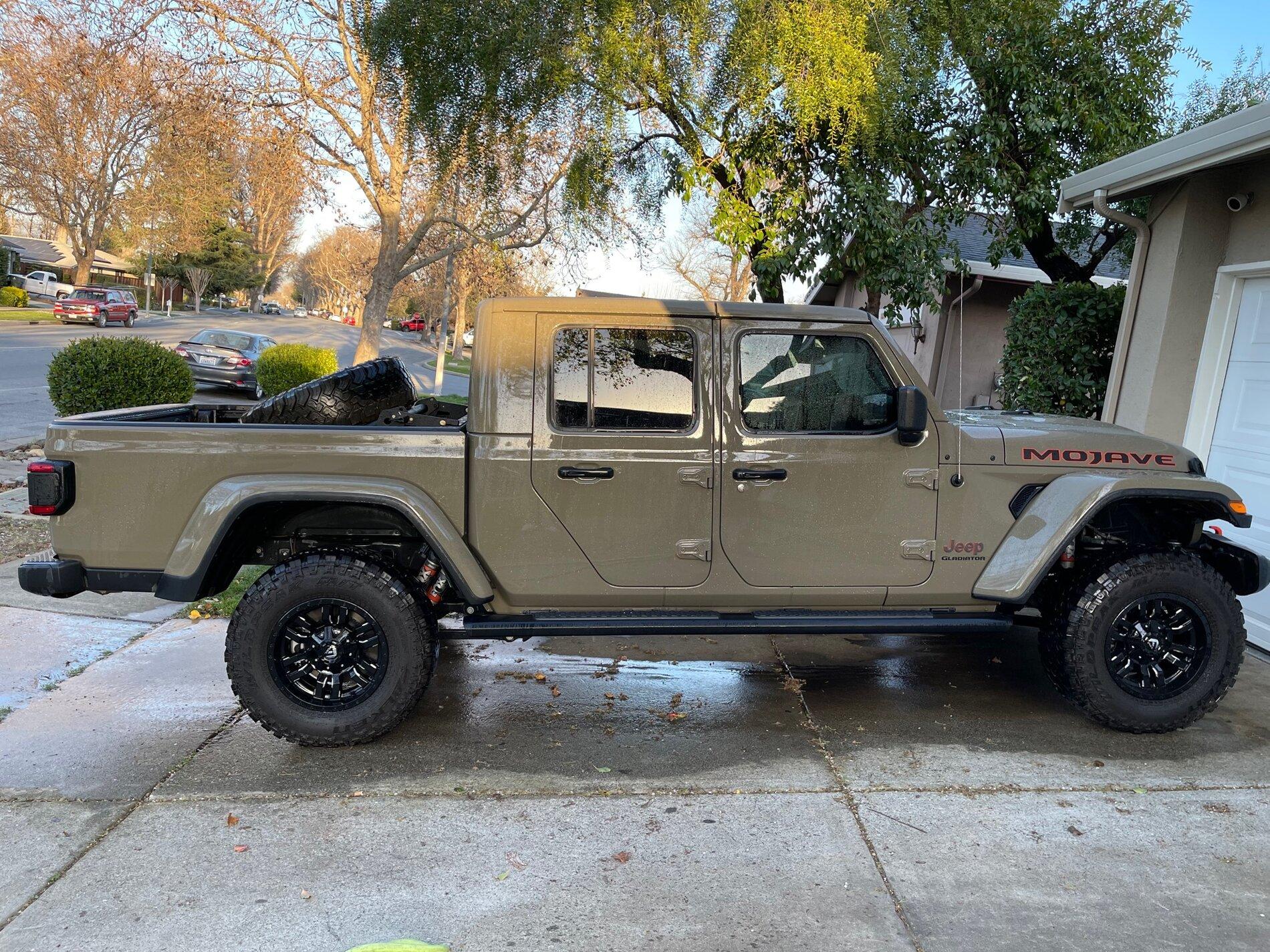

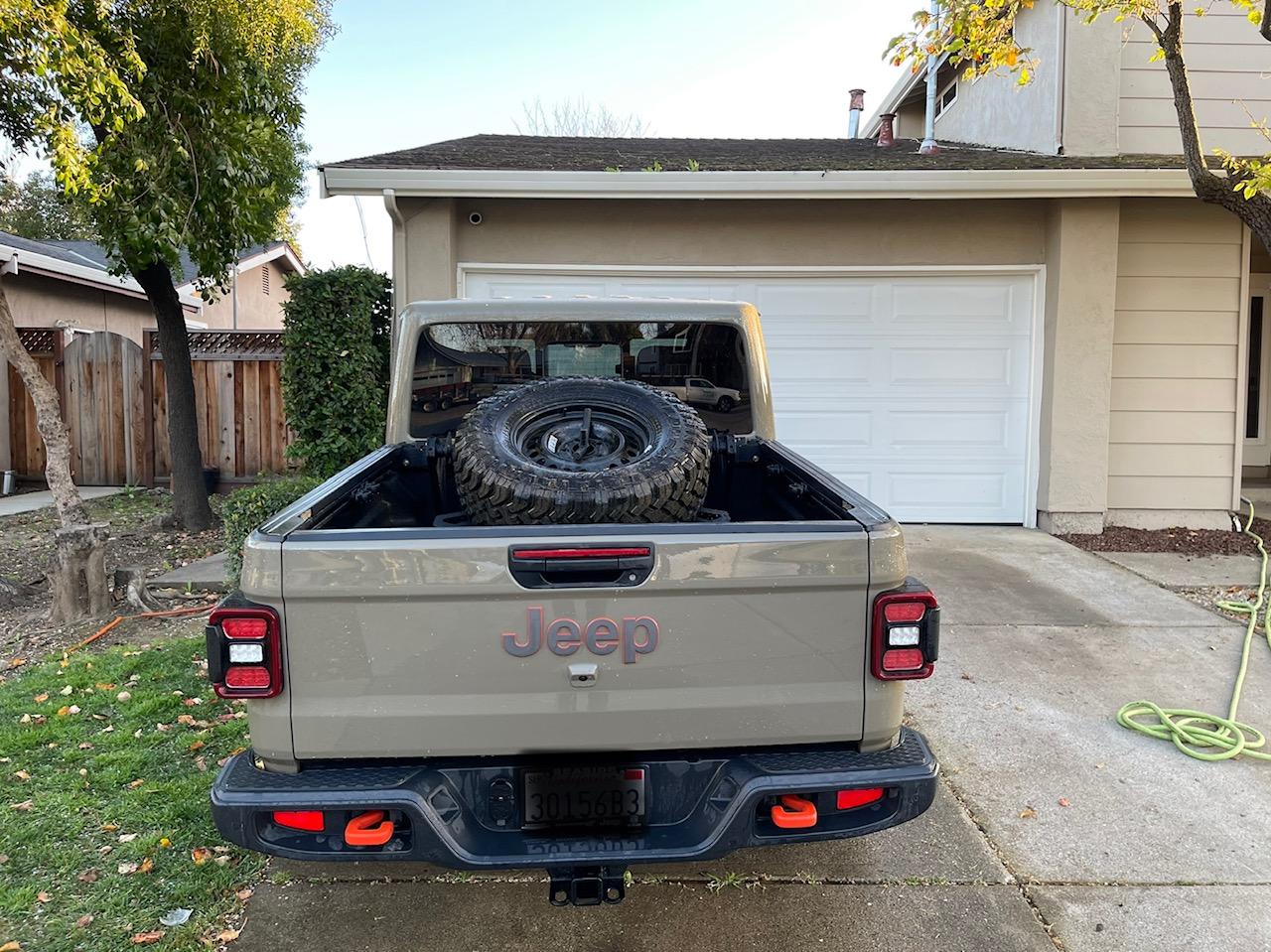

Shipping was good and it does block some of your view but not much. I like it so far... Looking to add some kind of security to lock the tire to the mount.

How much work would it be to remove the carrier if you had a large load to carry?

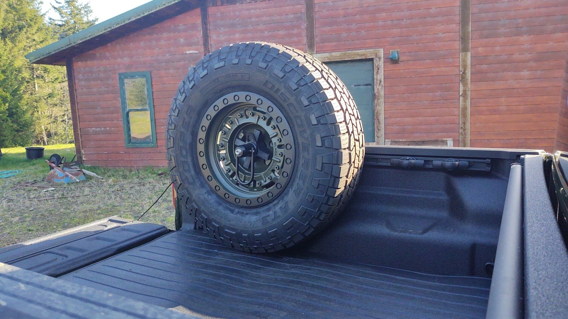

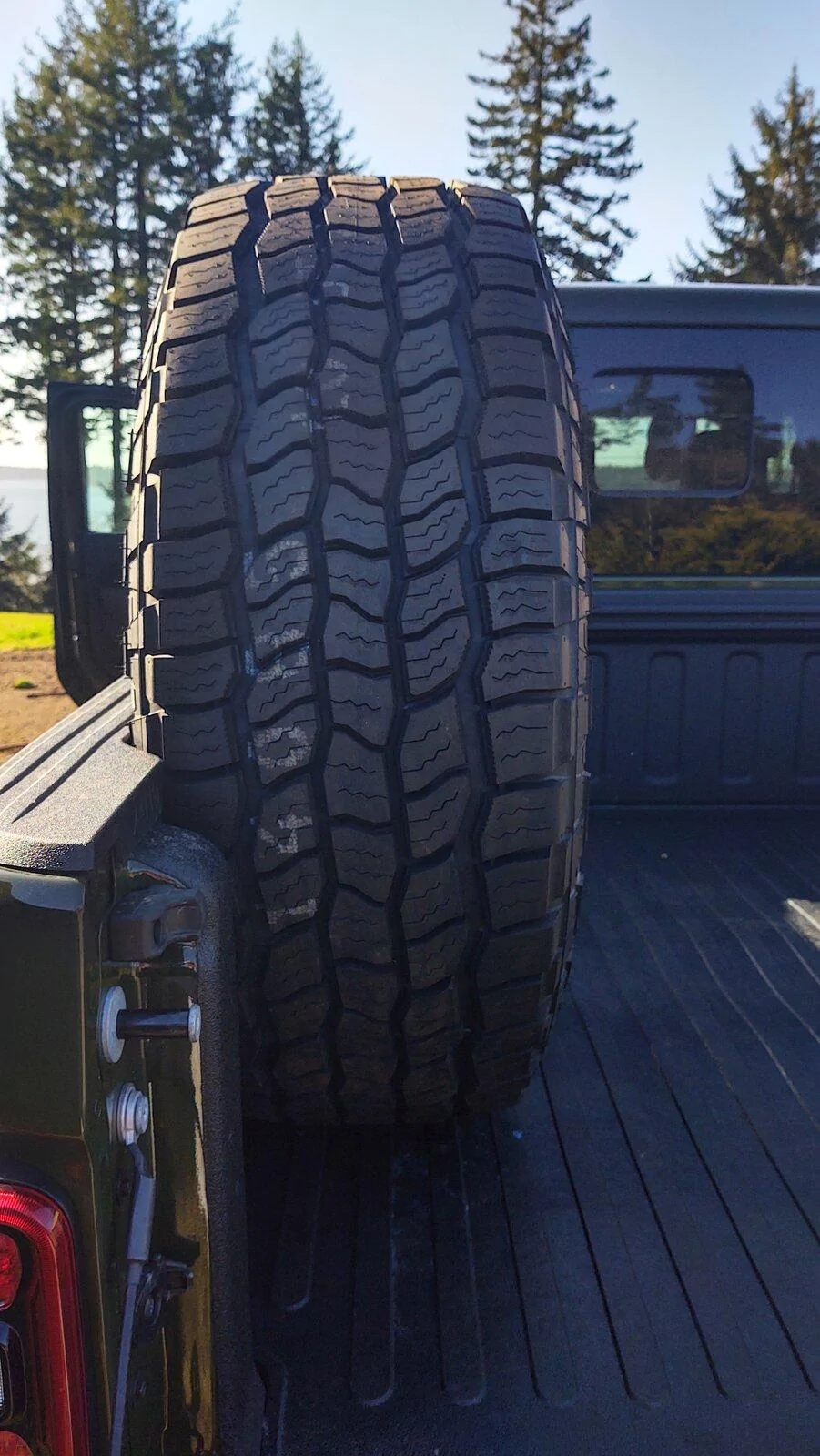

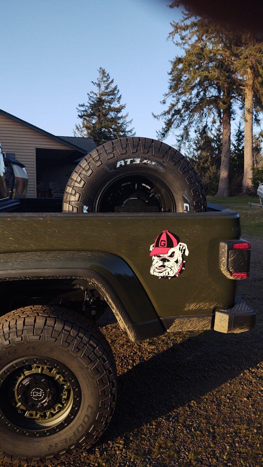

I have the Wilco and it's not great. Frankly, it's garbage for the price.
edit
wrote a bunch but it was a rant... just know that the mounting isn't great, there's a ton of leverage on the rail that results in a lot of bouncing, and I'm afraid of the long-term impact on the rail system without the hacky solution I have planned to secure the tire better.
/edit
AEV has the right idea but it's heavy AF. I think someone could fab their own and do a much better job because a lot of the weight has to do with being stable at several different heights.
Are you talking about the Wilco bed rail side mount-I ask as I just ordered one and would like to know what are the problems/ It is expensive for what it seems but I do want the bed mount. IT works Fantastic and I have to ask size of tires and wheels and have you checked adjustment. Mine is solid with NO bounce at All.

This system allows for you to lift the tire to store items under. But to fully disassemble, probably under an hour.
Yeah the bed rail mount. Since the threaded rod is above where the mount connects to the bed rail, there is significant leverage on the rail. Ideally, it would mount below the rail and gravity pulling on the tire would hold it in place. Instead, it's very easy to get the tire to bounce just by pushing on the top of the tire toward the cab or outside of the bed.
It can be fixed with a little fabrication but frankly, at that price, it's not acceptable to me. Decent concept, but I got a quote to have a local fab shop make something a million times better at a lower price using boxed tube that mounts to rail and the bed floor. Will probably go that route at some point in the future but until then, I have to keep the bottom strapped to minimize the bouncing.

I like this a lot - but where do you store your stuff that otherwise goes in the bed?
surprisingly, I can still store a fair amount of stuff in the bed and in the cab.
