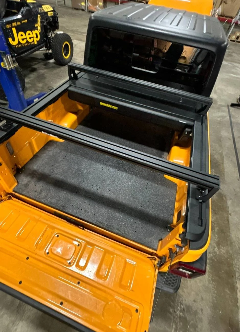

Thats not what im using this for but the piece in the bottom of the bed is keyed with T nuts at specific positions and tying a spare down under a tonneau with it would be easy
What is that bed panel????

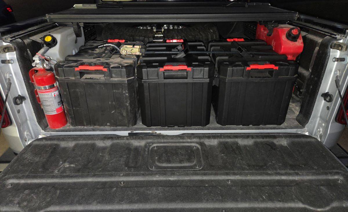

Well...I was hoping that maybe, just maybe I could shoe-horn that 38 in where the stock spare goes. It's a nogo for sure, unless I wanted to maybe completely deflate it and wedge it up in there.
I've got to figure out the organization in the bed with my recover gear and toolboxes before I start drilling mounts into the bed.

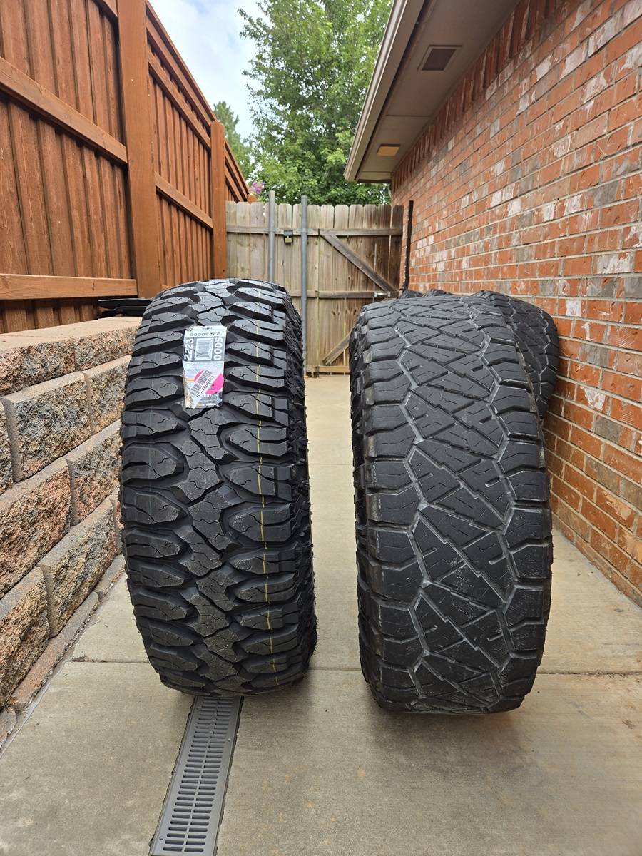

I was kind of hoping the size would be close enough, but it ain't happening. I was already running 37's, so the heat shield is already gone and I've got a high-clearance rear track bar already.
Here's a pic of the size difference. Granted the 37 is rolled slightly closer to the camera, but using the level/tape measure, the difference was just a touch over an inch.

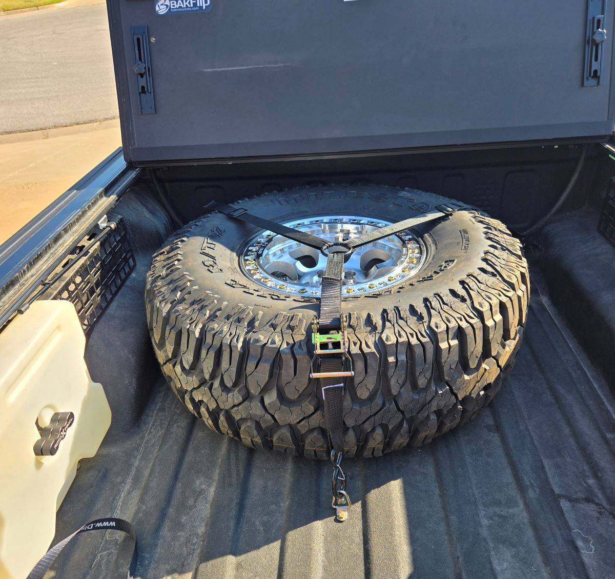

I got the Y-Strap off off Amazon and just used a stainless steel tie down from a Farm Supply store. It's rated for 1200lbs, so it should be good. I tried to get one as slim as possible and mounted it in the lower ribs of the bed, so if I haul something flat, it shouldn't stick up too much. I was the same and wasn't keen on drilling holes, but couldn't come up with a solid solution.
Be aware to get the correct tie down angle, the tie down bolt holes landed right where there is a structural rib on the bottom side of the bed. I had to position the tie down where one bolt is outside of the rib, and one is inside. There are holes in the rib big enough to get a small break-over bar and socket up in there. Another option would have been to move the tie down point rearward several inches, but then my Harbor Freight boxes wouldn't fit.
