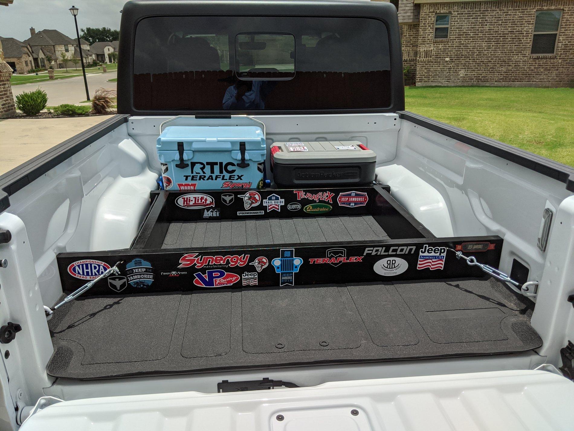

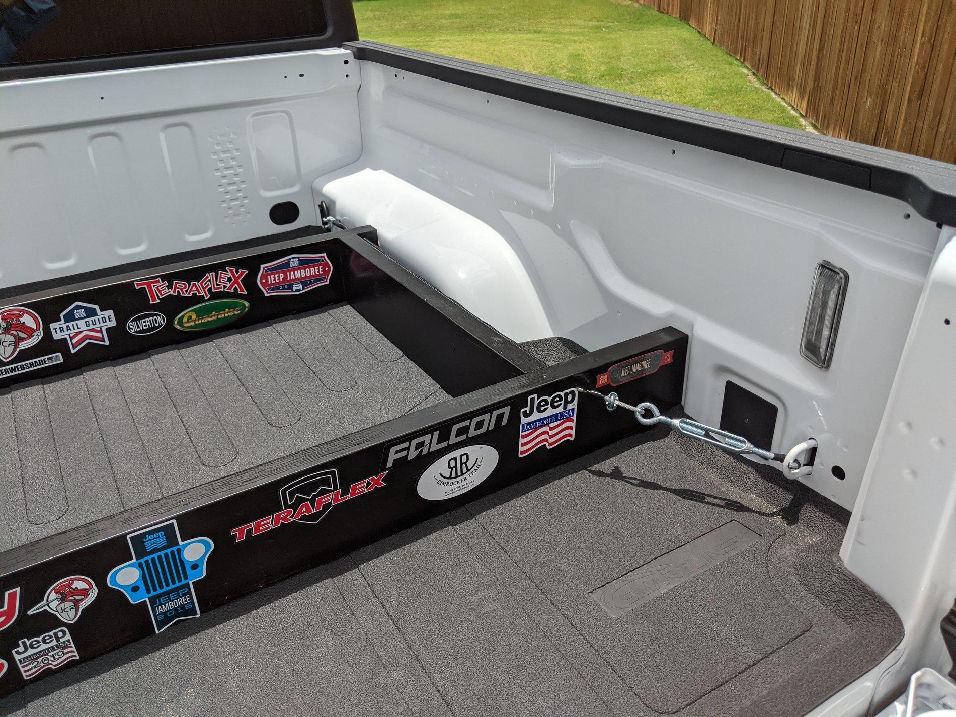

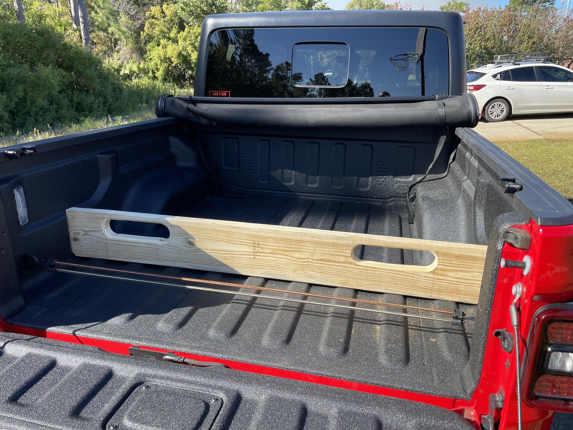

I was able to get mine build and even had enough to make a 2nd set.

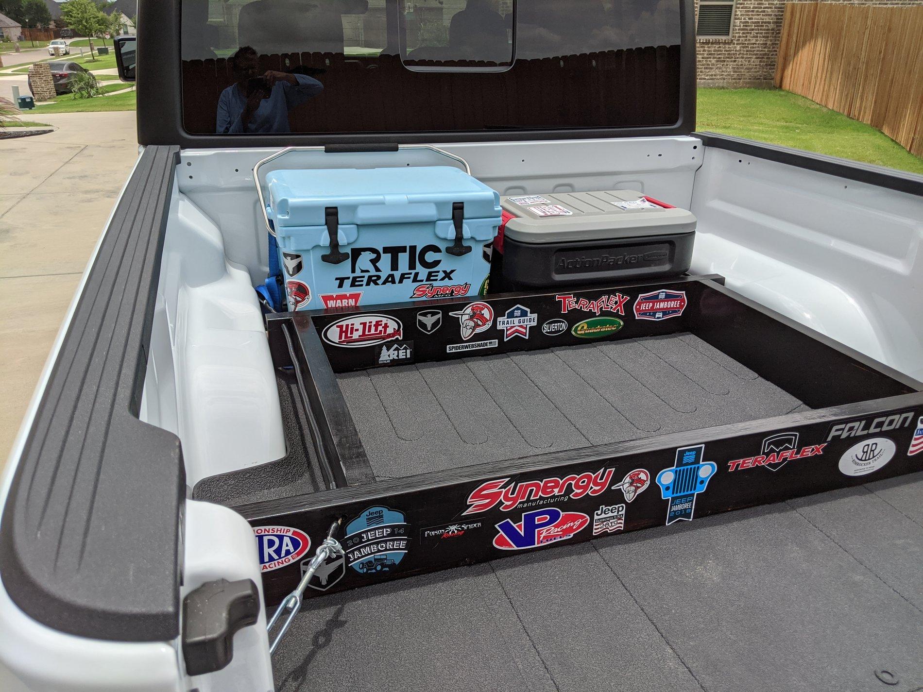

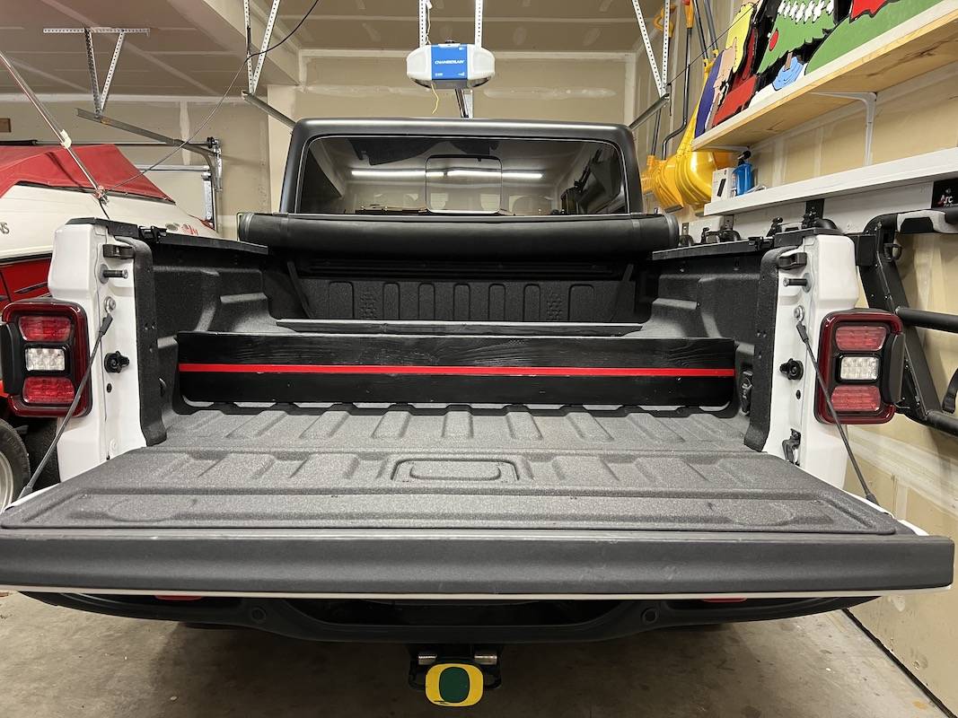

My DIY bed divider... Stickers gave me 1/2 inch of lift!!! LOL... Just covered the bad staining job!!
I just came in here to search for ideas and this is the best I've seen. Awesome Job! We have a tandem bike I'm trying to strap in with the tailgate down but keep our stuff in the bed while heading to the beach and I can make it work with a similar idea to this. Thanks for sharing this!

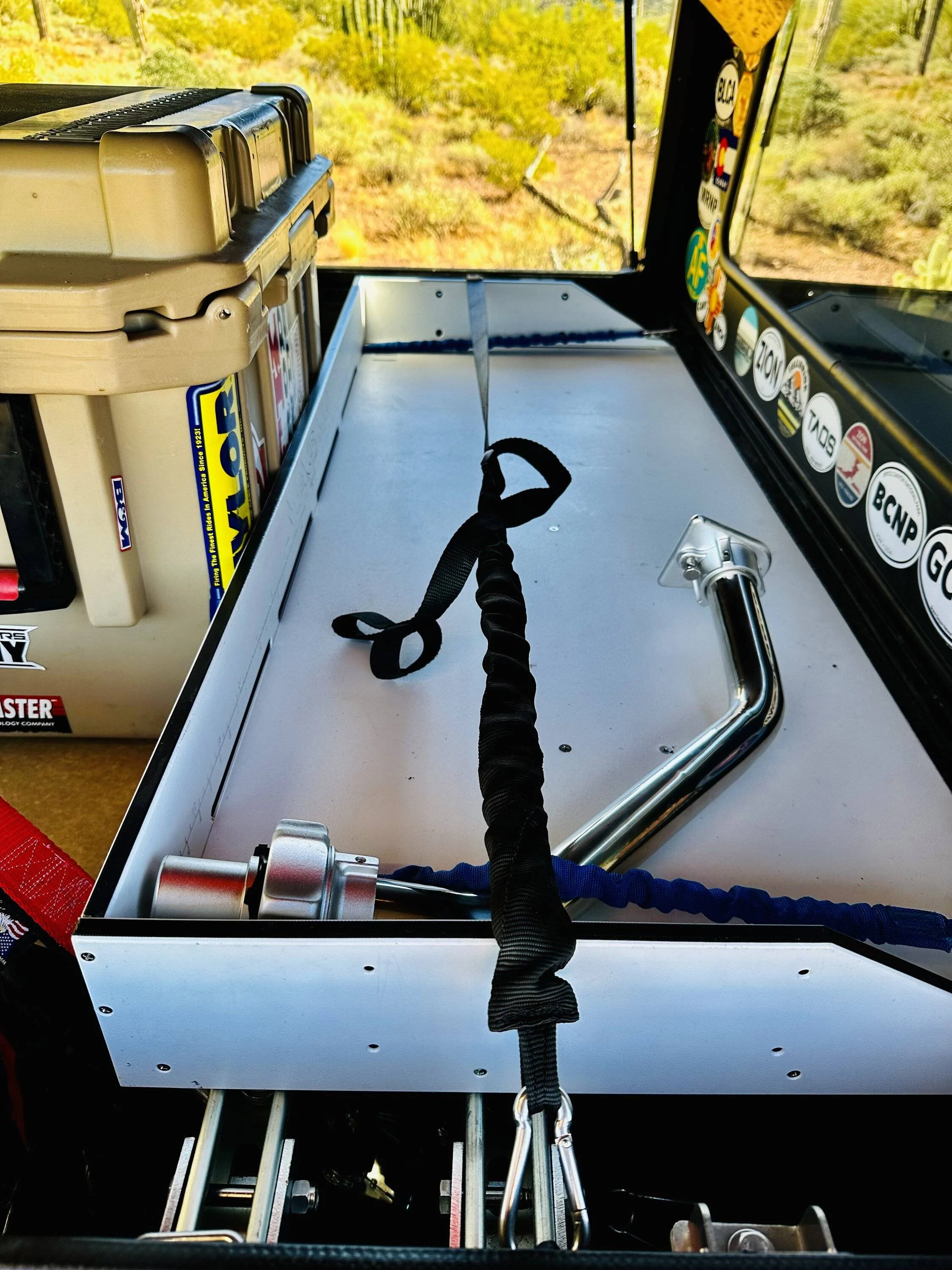

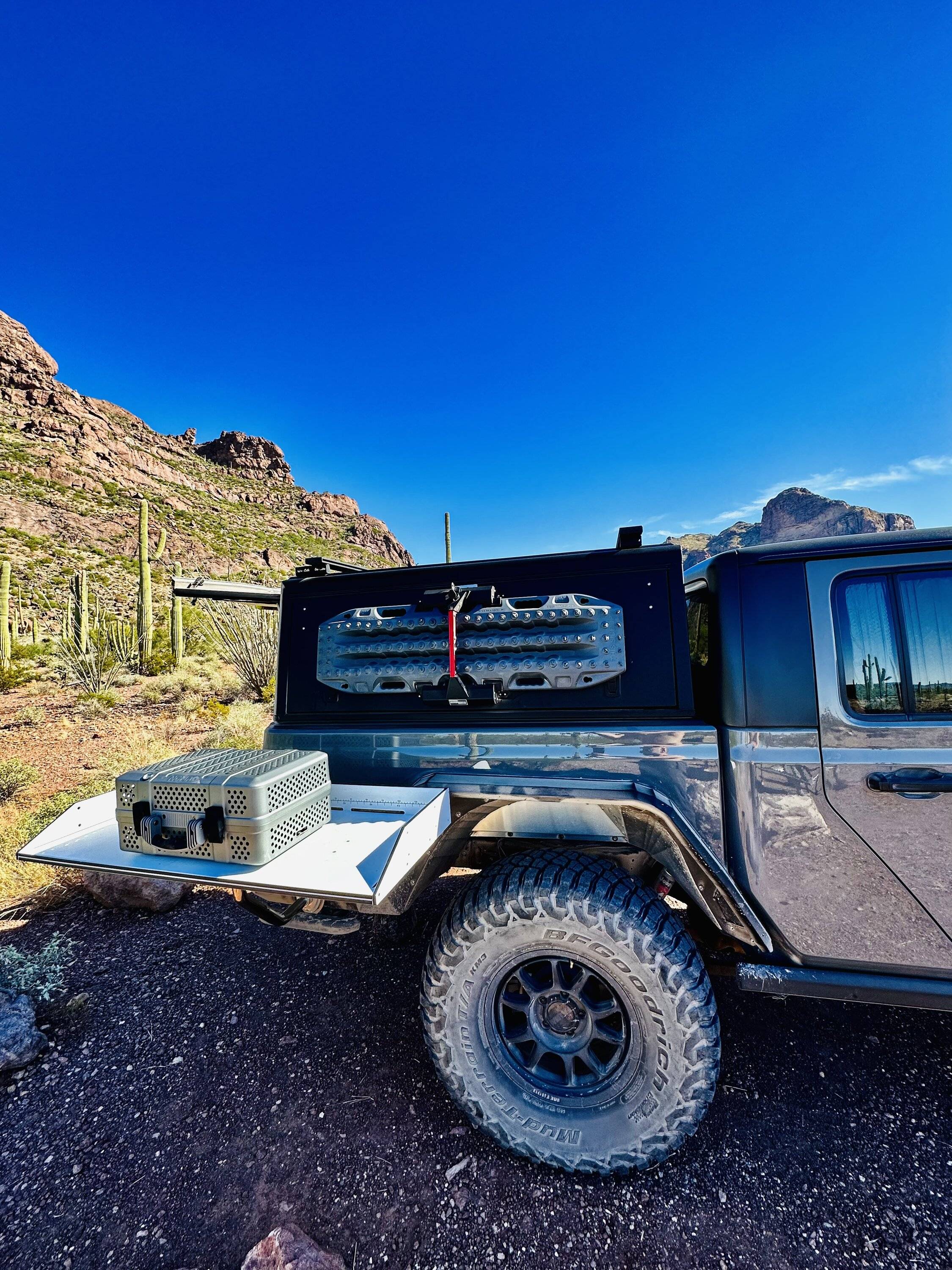

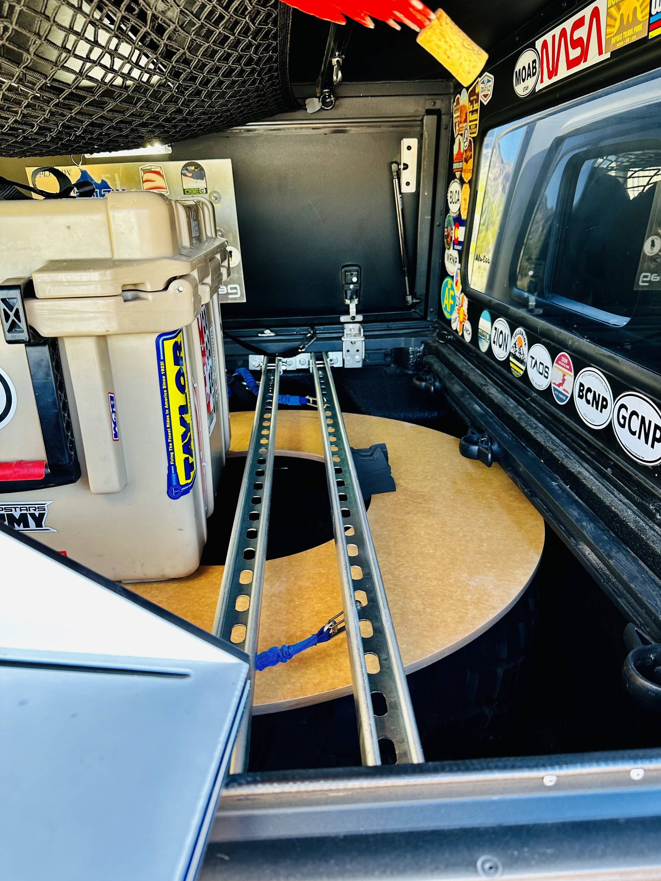

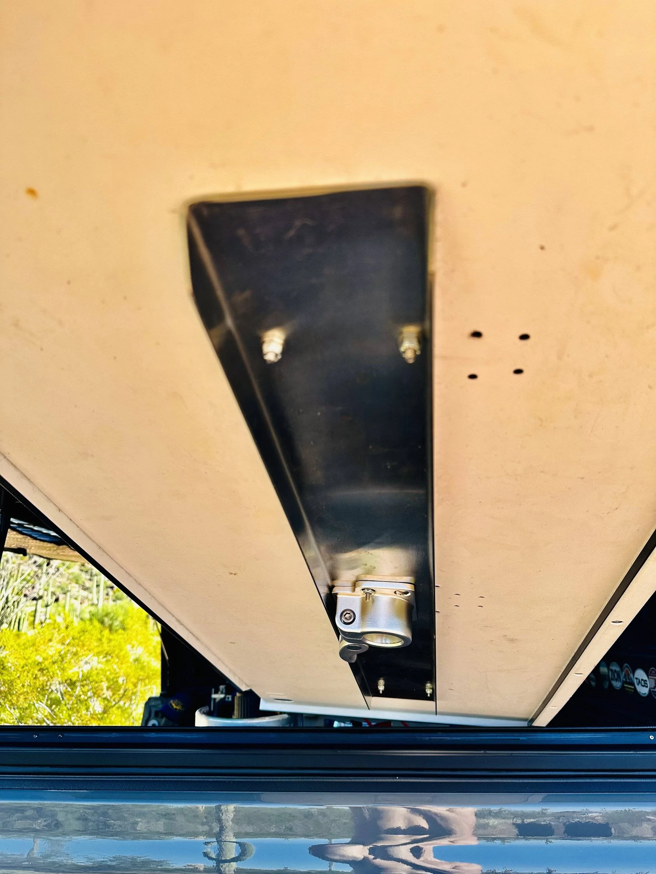

I used some channel, brackets, and bolts attached into factory bed rail. Designed to hold cook top table/shelf in transit. Latching points at bottom of channel using eye bolts. Have a third channel I considered building a divider down from with stainless for rear but so far set-up working.

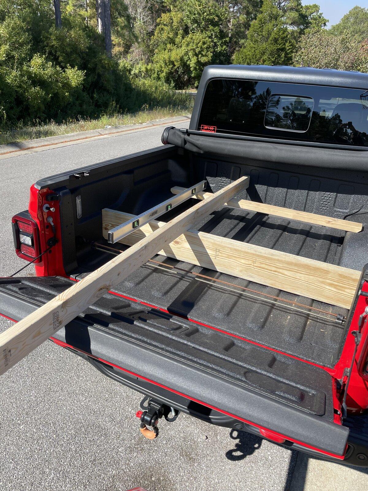

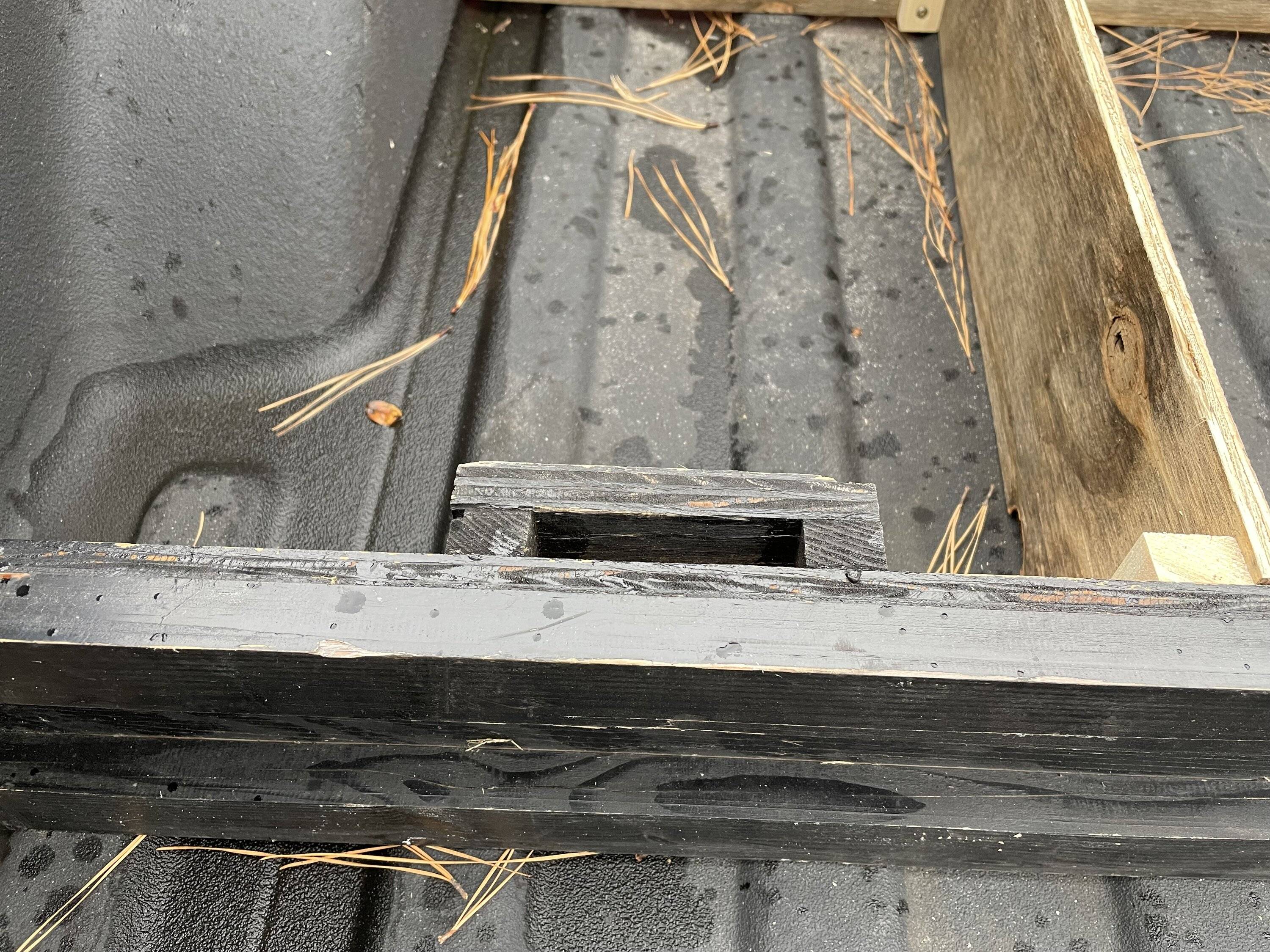

Nothing all that special, use a couple 2x6 boards painted black, took off about 1/4"+ off of each and sandwiched 1/2" strip with some red paint, few 3/8" dowels 4" screws and good to go. Cut and painted a 2x4 up front for hauling plywood, but mostly this is just a divider to keep stuff from rolling to the front of the bed.

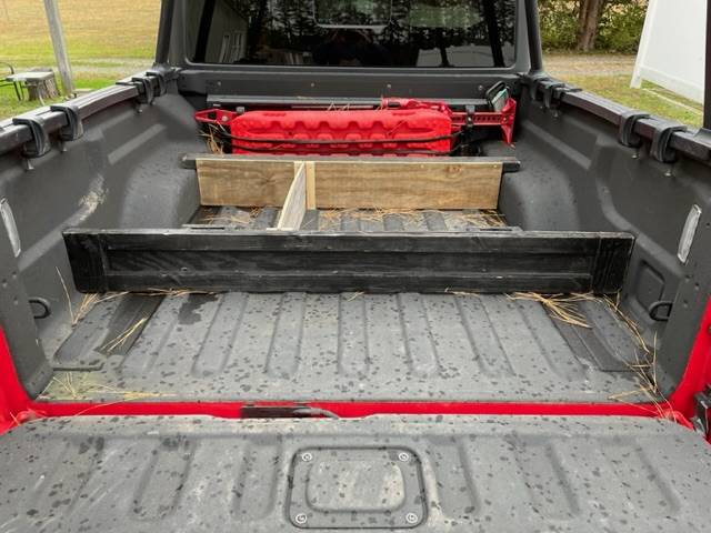

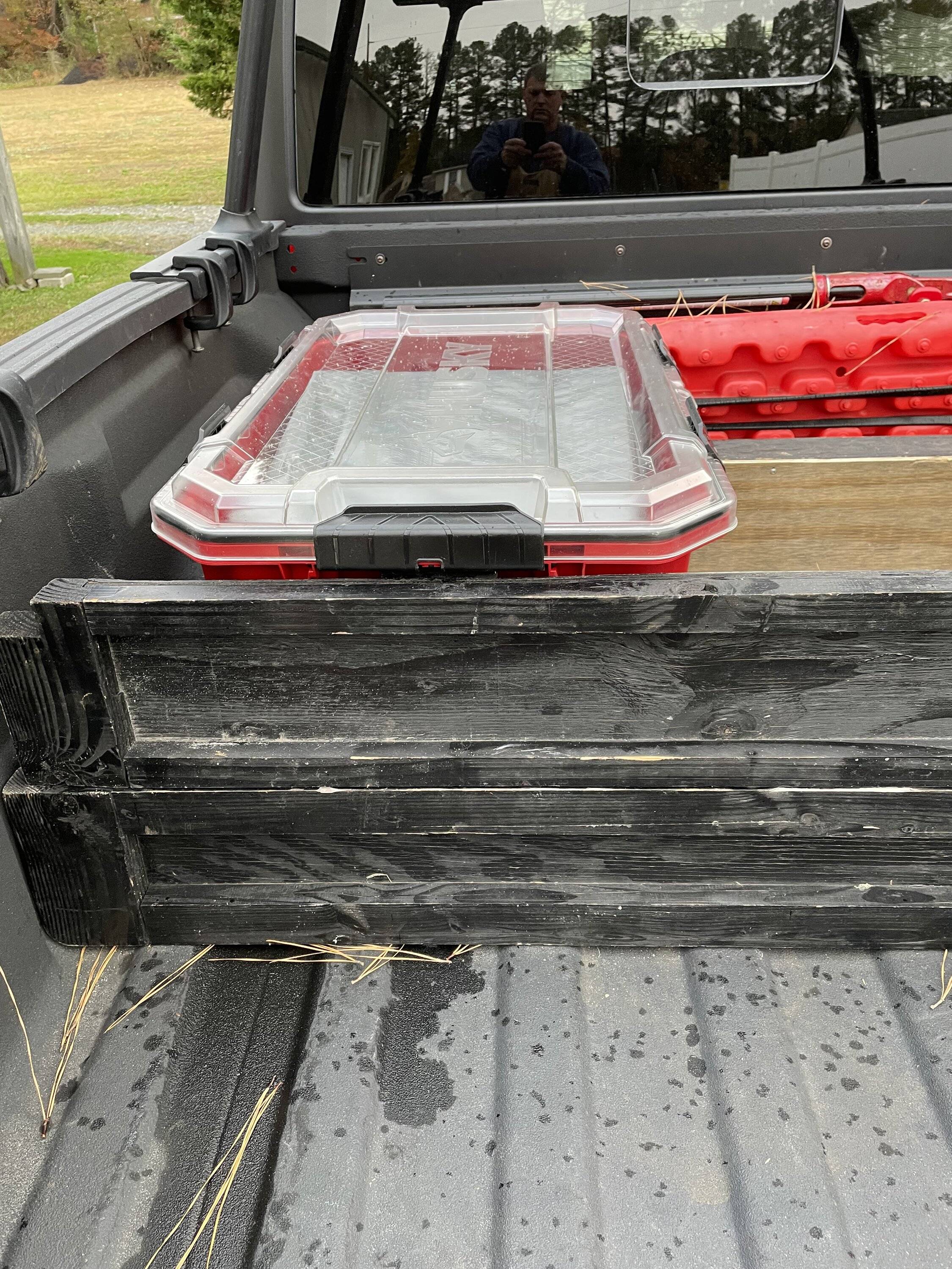

I made a two part rear divider out of plywood edged with 1x2 materials. A Husky 20 gallon container will fit between to rear and middle rail. The stake pocket fits the notch in the Husky container and keeps the container from moving around

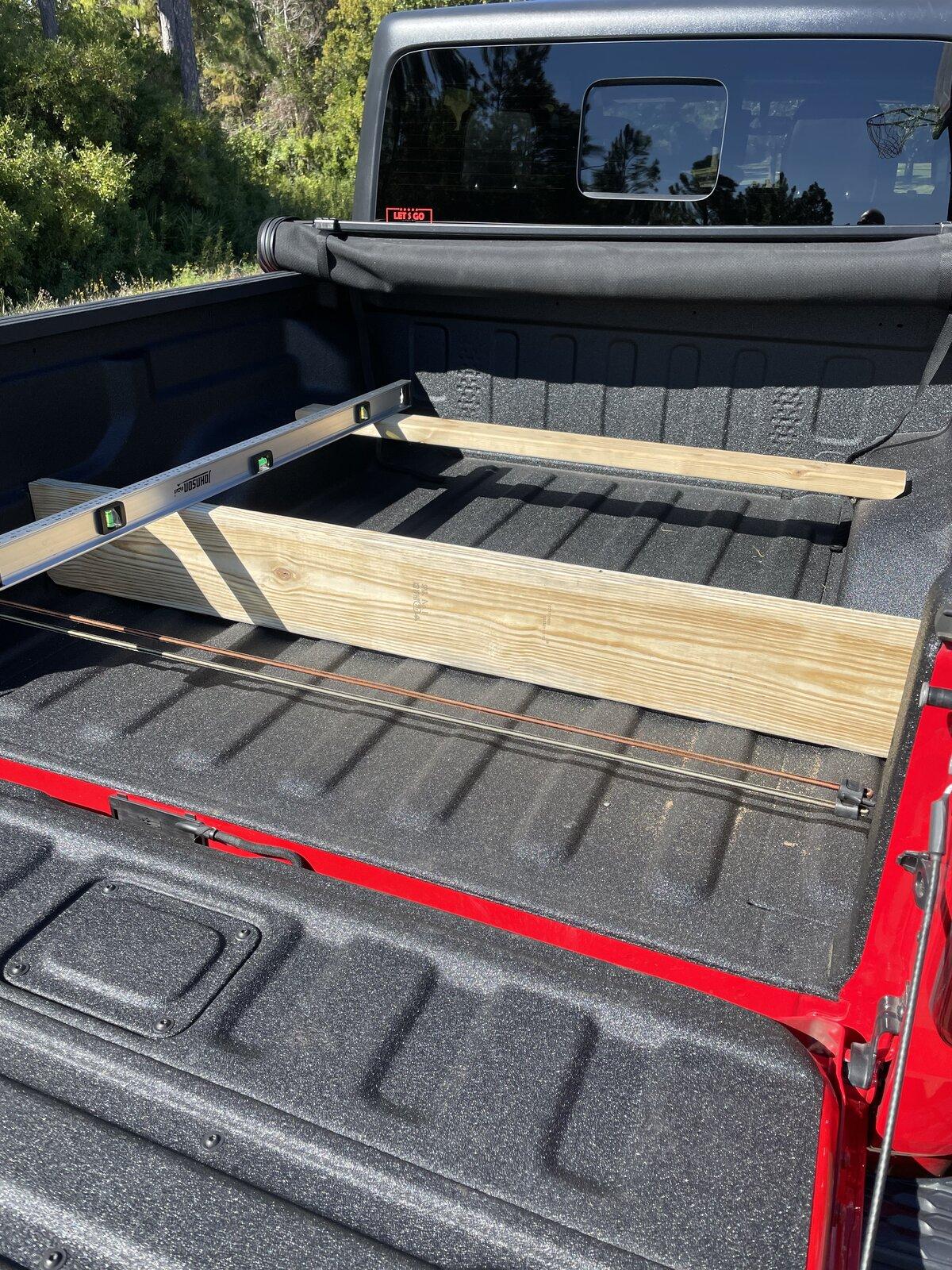

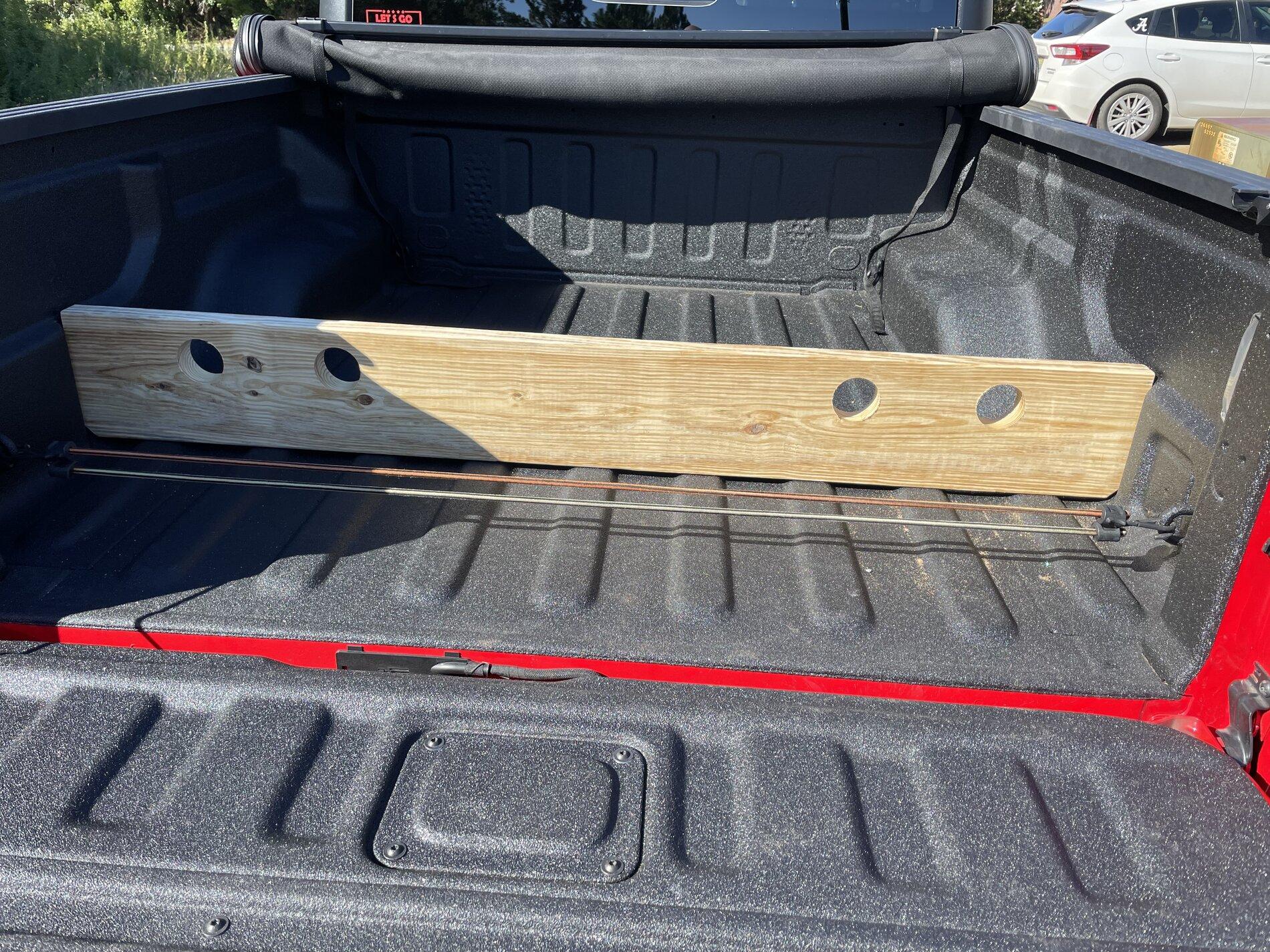

I FINALLY cut the board for the back of the Gladiator. The 57 and 5/8” length was perfect. So far I just did the length cut and the 45 degree cuts on the board. Still need to cut the slots and round the edges with the router. The cedar board is lighter and it smells great!

I had to cut mine to 57 and 1/2", the spray in bedliner must have been laid on pretty thick...
