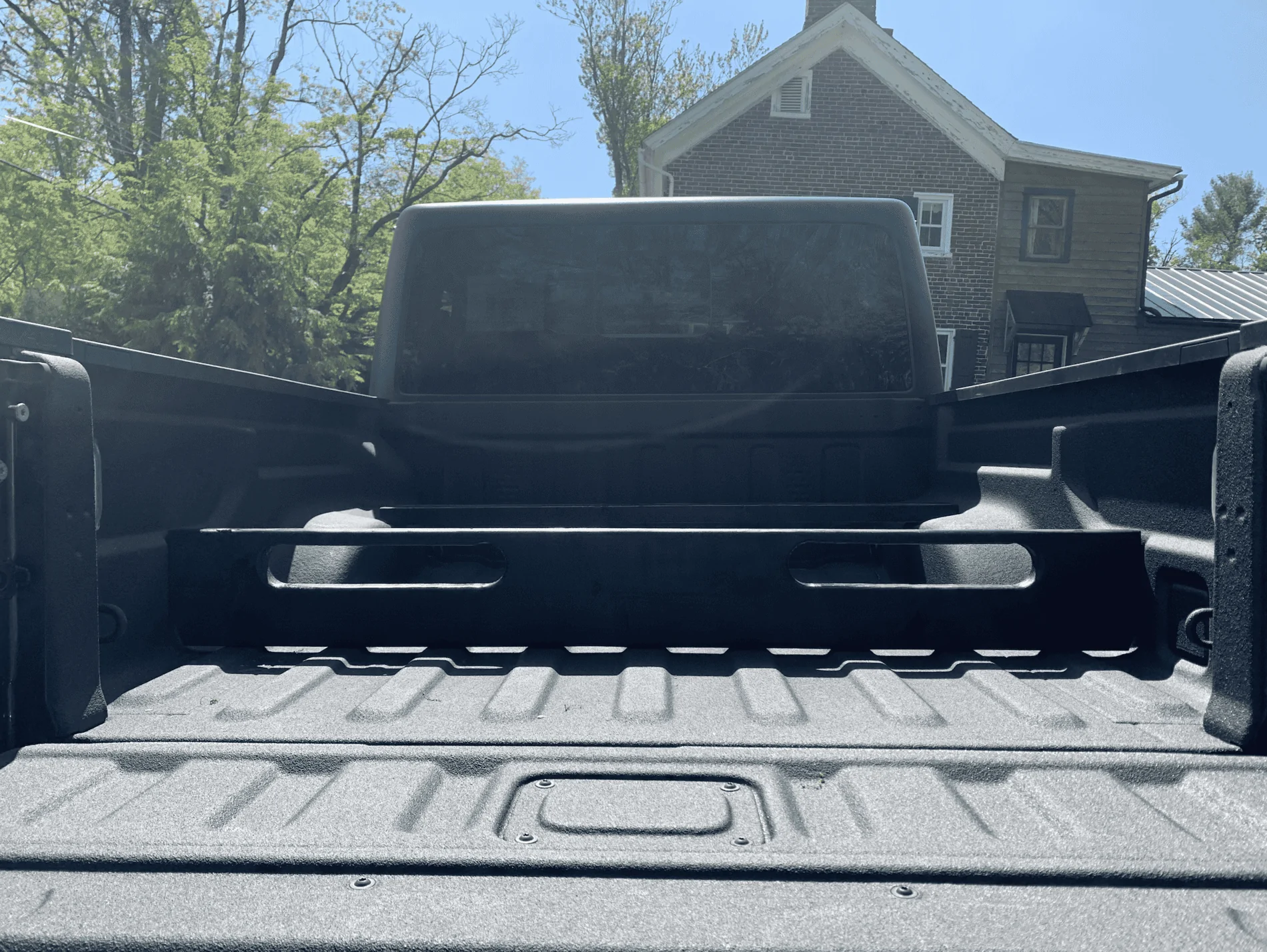

No. I’m thinking a 2” x 12” board divider to mount things to, like a molle panel, but made of wood. I’m also wondering if E track end sockets would help in some way. I can’t wait until my Gladiator comes in next week so I can do some actual experimenting.

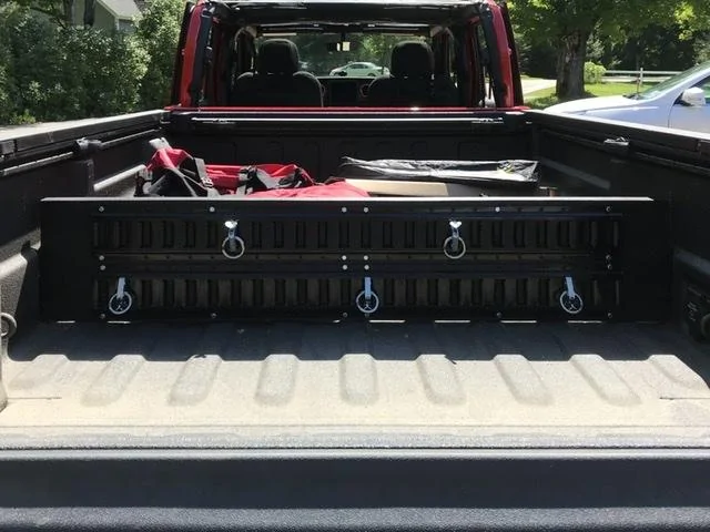

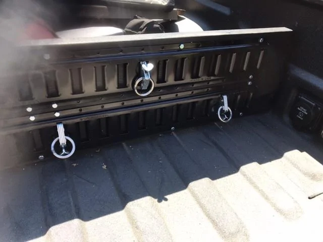

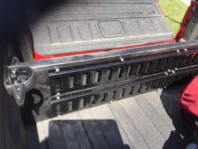

I ordered an E-Track system that I’m going to bolt to the 2’x12’. System rails, and anchors clips came to $72. 2’x12’ will run me about $15. $10 for can of bed spray and I have a system for tie downs for less than $100.

This is my DIY bed divider system. It cost under $100 and is SOLID. Right now, I will use it to help tie down 2 kayaks and separate groceries in the back portion of the bed. Before I use it for off road/overland, I’ll have to pad the top gap with padding (movers’ furniture gliders cut to size) covered with Gorilla tape. Then it won’t move at all. The 2"x 12" does indeed fit with a little bit of sanding for the bottom indent - Enzo, I think you owe me that beer!
The hooks (I have 5 more to install on the inside) and e-tracks are rated for 500lbs. However, I think the 1/4" bolts that are holding the rails would be closer to 200-250lbs. Either way - plenty strong for what I need!

@ADK Tiro How long is your 2"x12"? It looks snug.

I had to cut it to size. I can’t remember the measurements, but something like 53". I bought an 8’ plank and had them cut it to 60". Then I cut it down. Then I had to sand the bottom corners. That still left a gap in the top, but I bought furniture slide material and Gorilla tape to fix that. It is very snug!

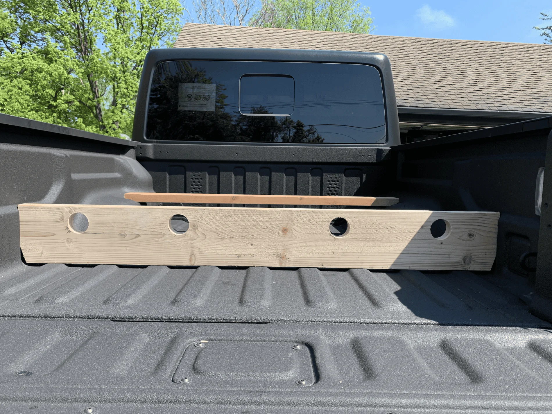

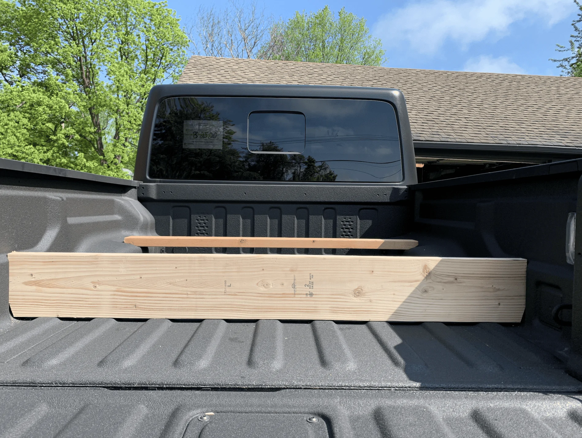

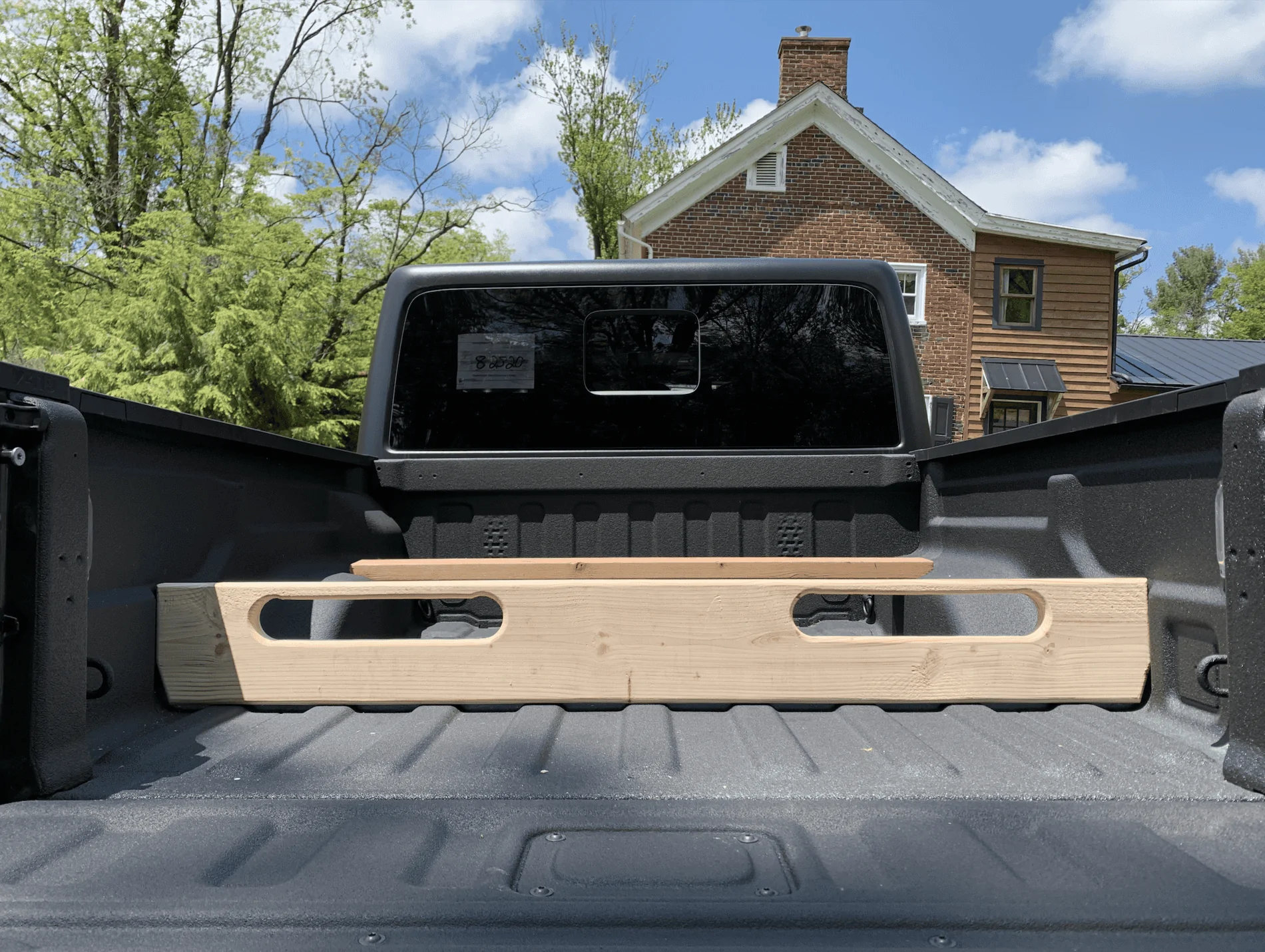

Made this bed partition/grocery holder/plywood-drywall holder in between zoom meetings today (it was at lunch time! in case my boss asks - he owns a JL).
Owner's Manual call for 2 2x4's but why go that route when you can use a 2x8 and trim 1/4" off of it.
I may add holes and slots for bungee cords to tie smaller things down after figuring out what I use and need the most (only got the truck yesterday).
If anybody wants to take some of the guessing game out, see below for measurements.
Cut one 2x8 at 57 5/8" in length. Cut the bottom corner (3/4" in, at 45 degrees - that'll allow the piece (and weight on top) to rest on the bottom of the bed, not the rounded corners.
Then the handles were made with a 2 ½” hole saw and a jig saw.
I then rounded everything over with a router and gave it all a quick sanding before painting.
For carrying sheet materials, you'll also need a 2x4 cut at 50" long. Laying flat, you will need to trim the corners coming in contact with the bed for the same reasons we cut them in the other piece.
This took me 45 min from start to finish (I even made a second set for a friend). I didn't use treated lumber as this is a quick fix for now and my bed cover is arriving later this week. It’ll do the job for now until I come up with a nicer and better design.

I'm doing the math in my head and I'm trying to figure out your comment about the 2x8 board. If you stack two 2x4s, the height should 7" (right?). Shaving a 1/4" off a 2x8 would yield a height of 7 1/4" (I think?). Realizing 1/4" of an inch isn't a big deal when stacking sheets of plywood, did you find 7 1/4" was better than 7"?
