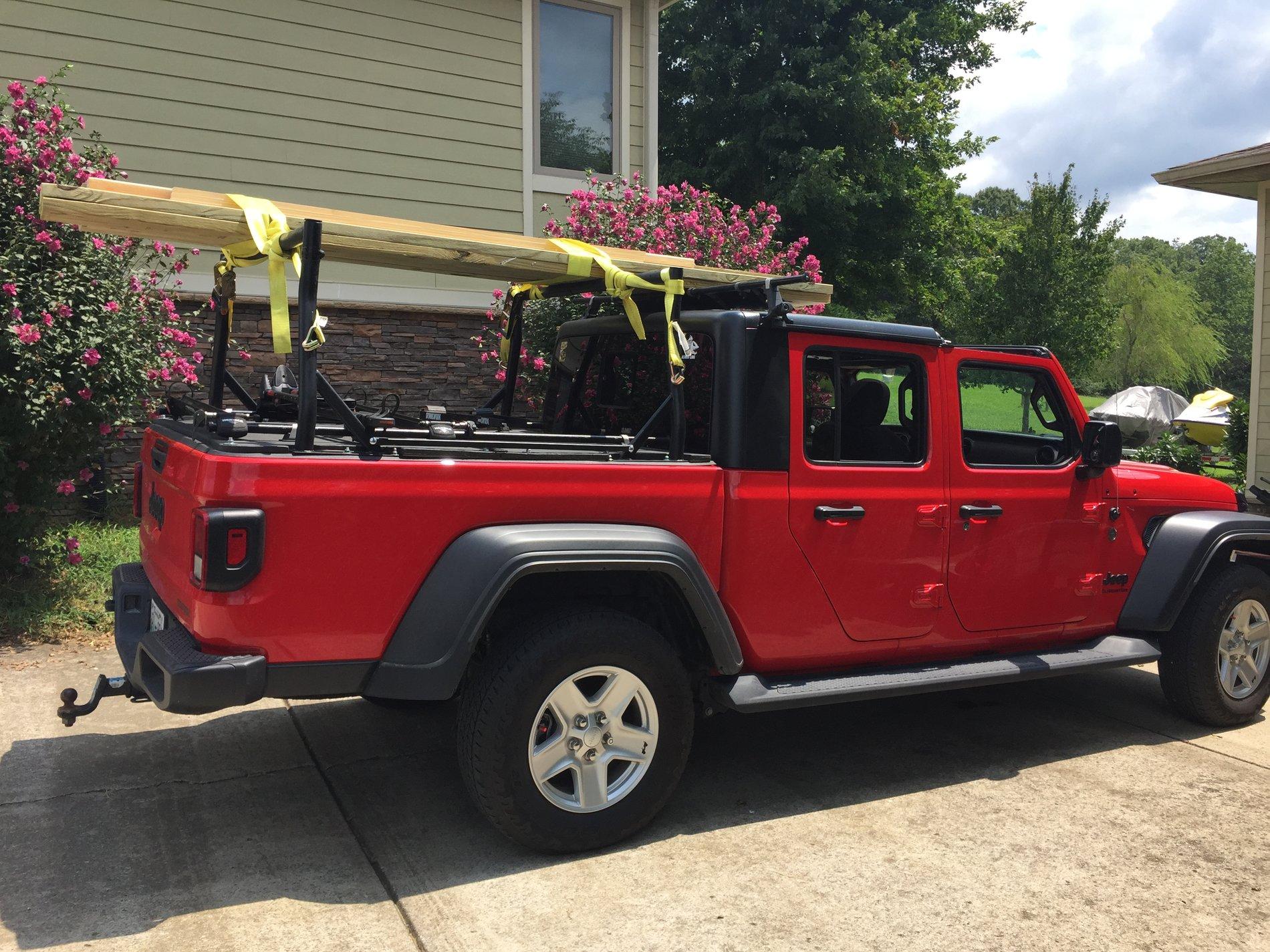

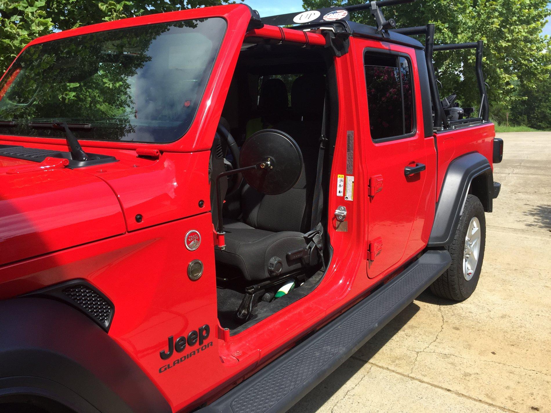

I have these crossbars https://www.kbvoodoo.com/shop/jeep-gladiator-aluminum-hi-rise-crossbars-for-use-with-tonneau-covers that works with the factory soft tonneau cover. They make one for the hard folding cover too. The company has other racks and attachments. I use the brackets and made a ladder rack out of 2x4s bolted to the bracket. It's not pretty but works well.
The soft tonneu cover does lock. That is to say you need to open the tailgate to release the cover and the tailgate locks. But it is just a fabric cover. The folding hard cover worls the same.

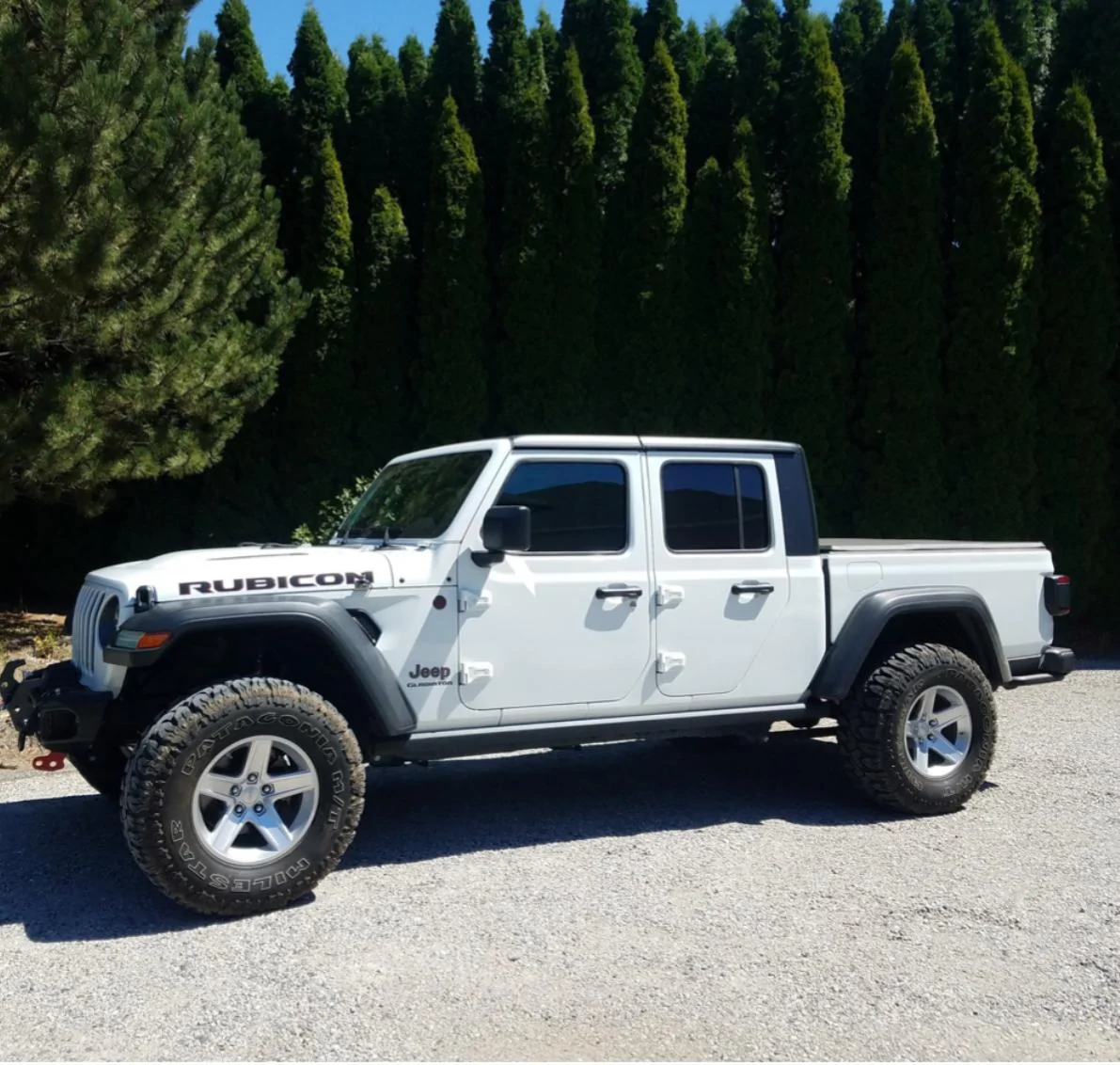

I'm running 285/70R17 BFG KO2's (C load) on stock rims w/no lift. Tires measure out at just over 32.5" in height. They fill the wheel wells nicely. No drag on acceleration. Tires weigh about 51 lbs, if I recall. They are within tolerance for the 7.5" stock rim width. I have steel aftermarket bumpers and wouldn't want a bigger tire w/out a lift, which is a whole other rabbit hole...

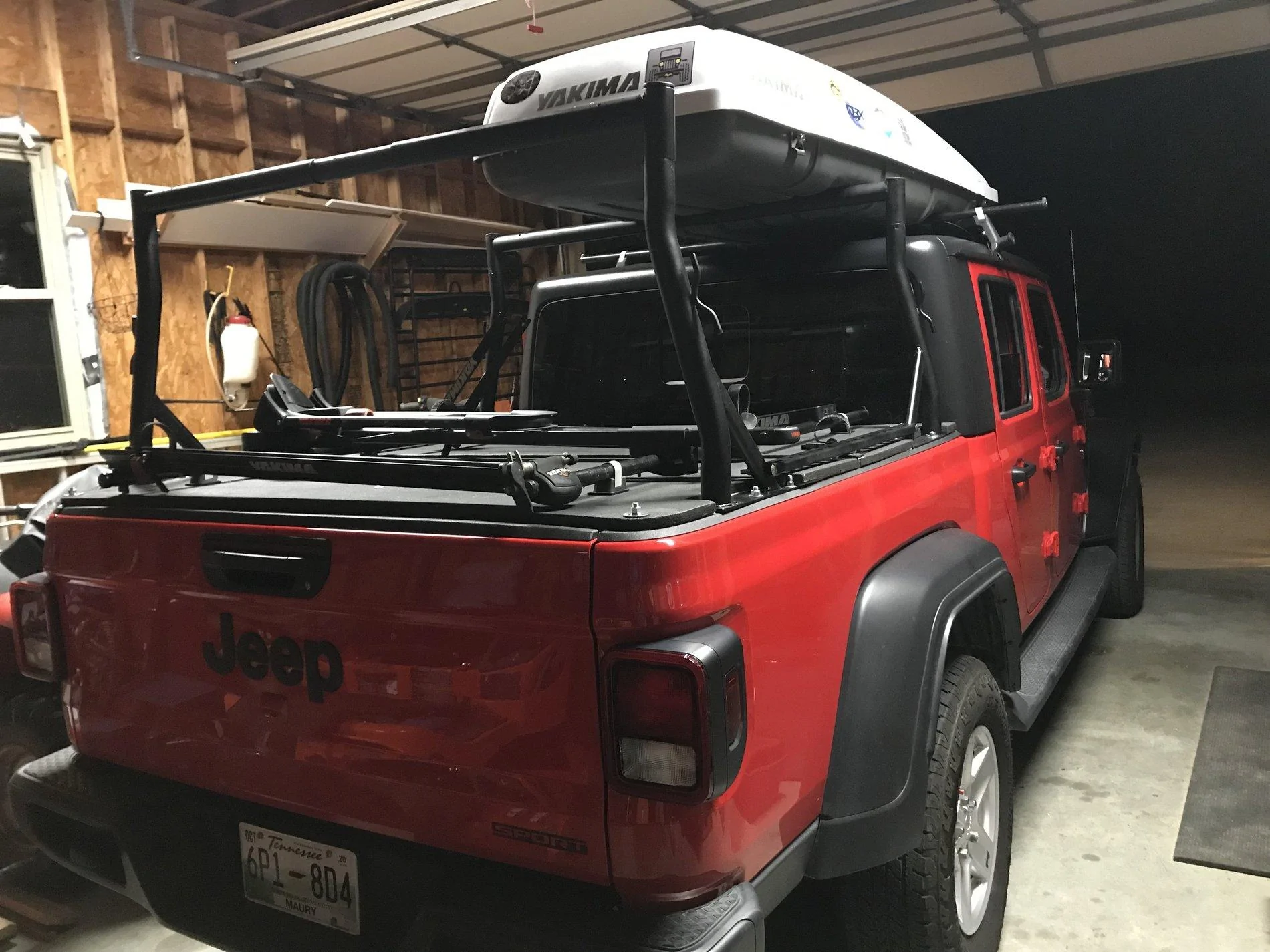

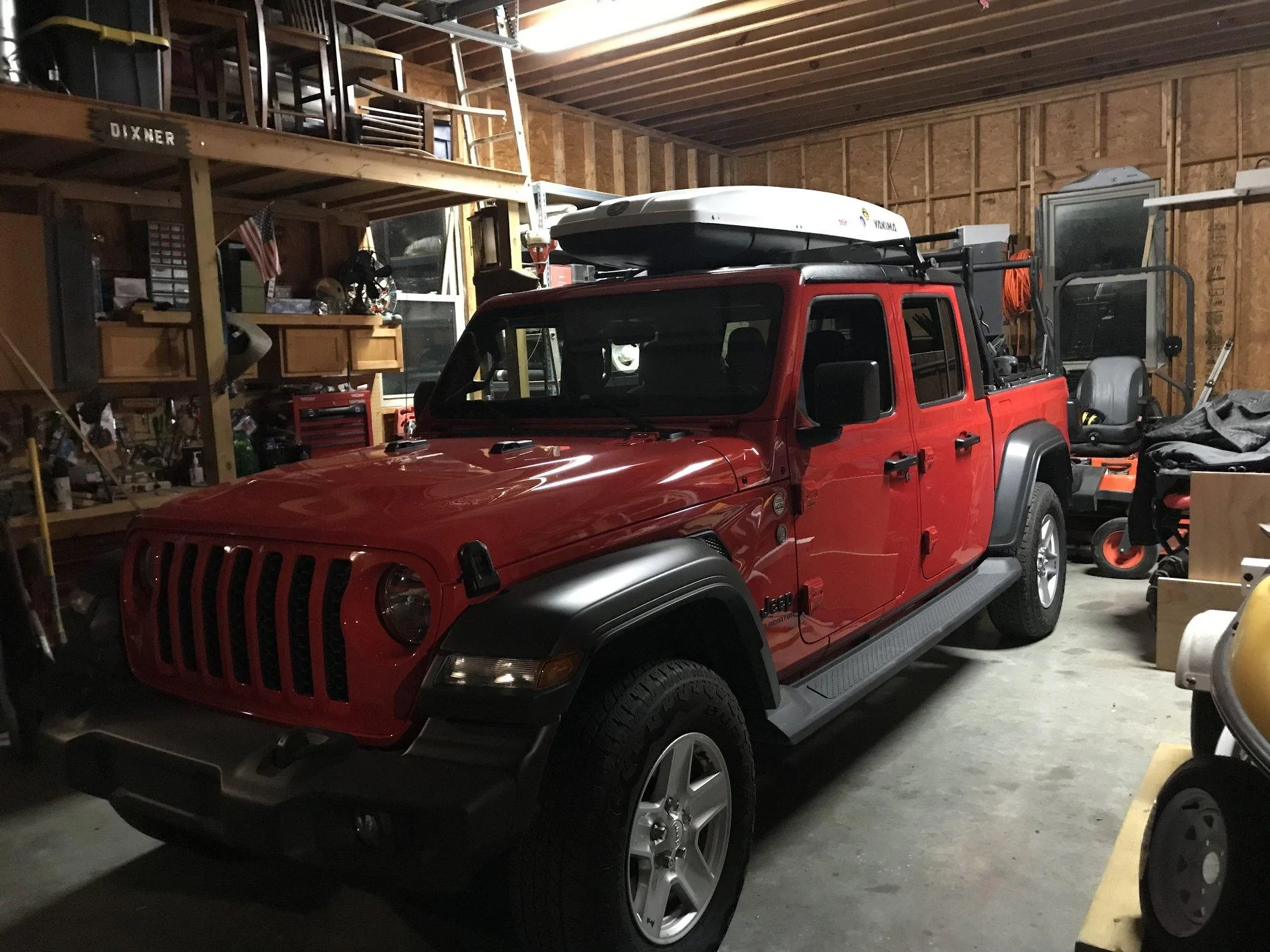

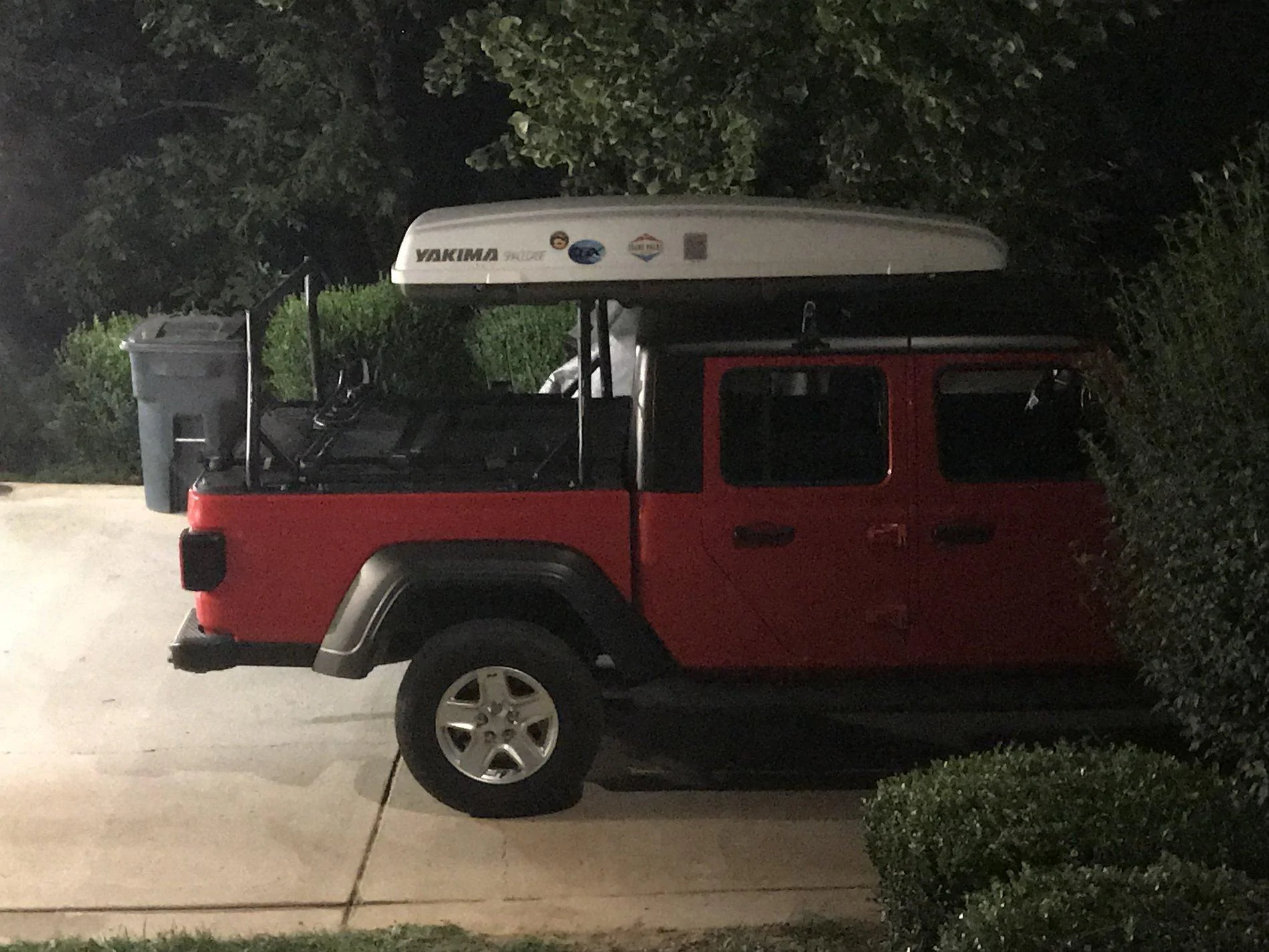

If you have a bed rack you can use a load bar or bars and gutter mounts (like Yakima) on the hard top. This will enable you to carry longer loads, move the bar or bars to the rear of hard top if you want to take freedom panels off (lots of wind noise if you leave bar close to removed freedom panels, slide back bar to stop noise from bar). You can also take the bars off when you don’t need them.
I am experimenting with different configurations, I need to carry my expensive mountain bikes in a safer place than high on the bars of a bed rack or on a trailer hitch mounted bike rack. I decided the bed space was more usable with a fixed cover and drawers and a just above roof level bed rack (i had a cheap ladder rack i cut down to the same height as the hard top mounted Yakima load bars).

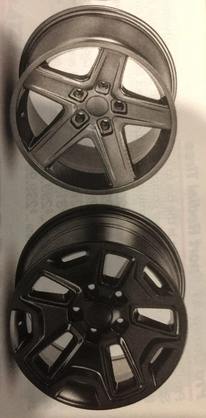

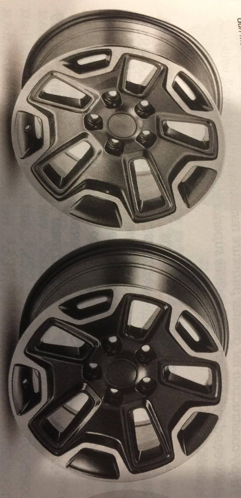

One more thing with the wheels, if you like the stock wheels there are aftermarket (at quadratec) Rubicon reproduction wheels that have a 5.2” offset (stock I think is 6+) and an 8.5” width $159.00/wheel. There is also a stock looking Sport S reproduction wheel (I like the stock silverJeep wheel look as well) with a 4.75 back spacing (won’t need wheel spacers for narrow axles) and in a 17x9” wheel (perfect) for $149.00/wheel in the same silver finish.
