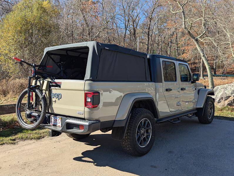

I'm pretty sure it would fit if you take the front wheel off and mount the fork to the floor or low on the bed walls. I have the Bestop Supertop for Truck 2 and use a tailgate pad and let the front wheel hang off the back. But there's plenty of vertical space from base of the rear tire to the top of the seat, so I would think it would fit as long as it wasn't too long for the 5 ft. bed (thinking of DH bikes with slack headset angle).
Jeep Gladiator Bed Topper / Cap; Hauling mountain bikes inside 1739372505754-d3

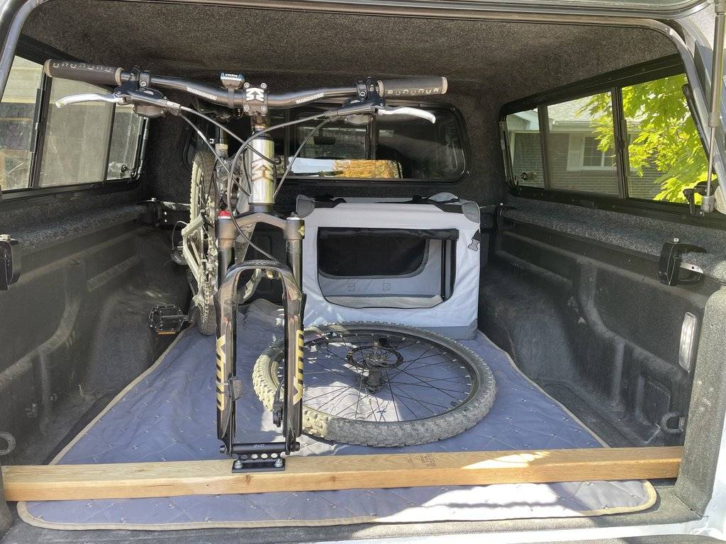

This was my setup with the ARE CX topper. 26" tires and medium frame fit at an angle with a few inches to spare between the handle bars and rear topper window. It would be tight with a larger bike.
Jeep Gladiator Bed Topper / Cap; Hauling mountain bikes inside bike

Many Thx. This is exactly what I needed to better visualize the fitment.
Numbers work, but seeing something similar always adds a layer confidence to move forward with a topper. Even the cheap ones can be a $2500 mistake.
