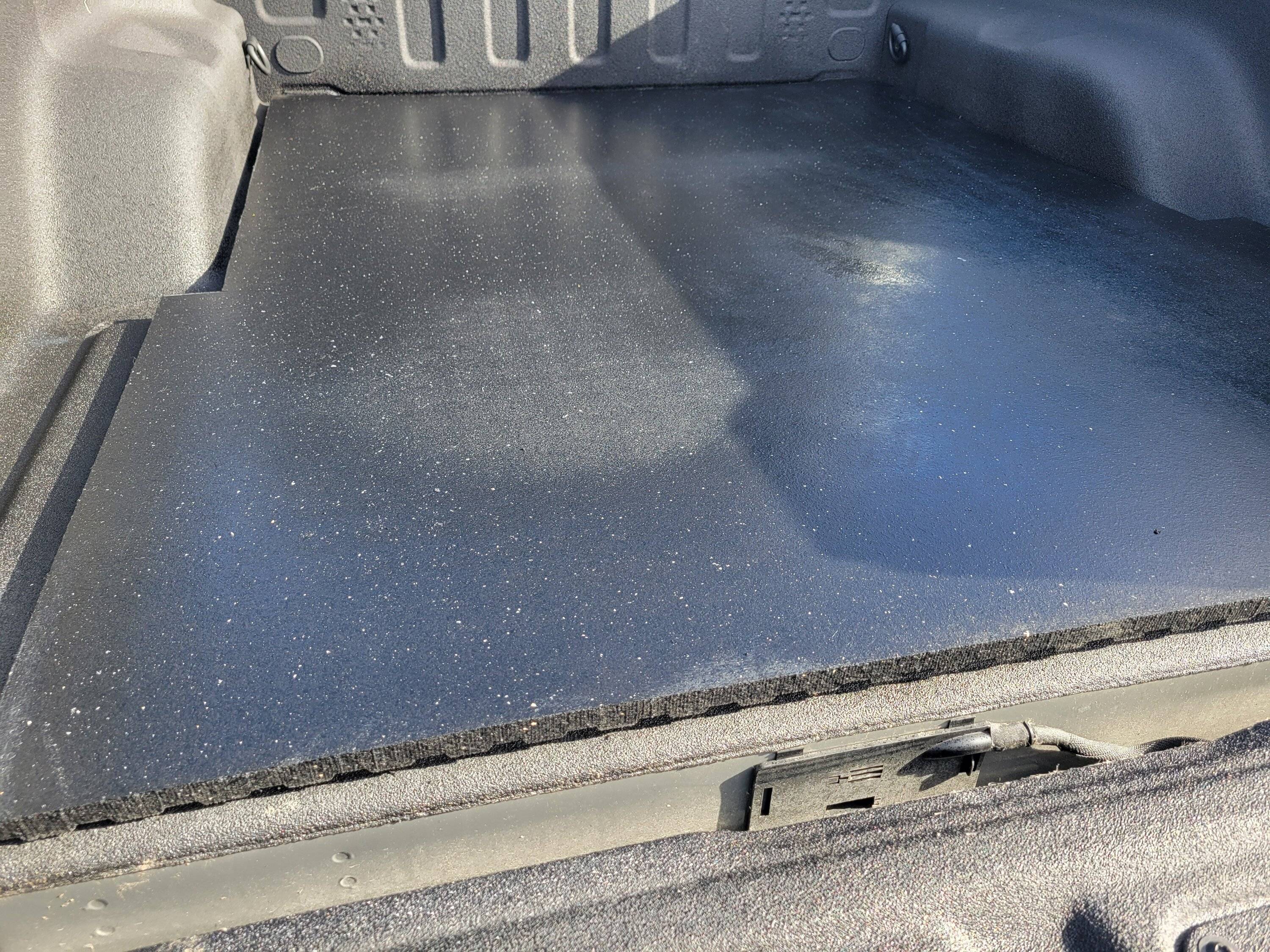

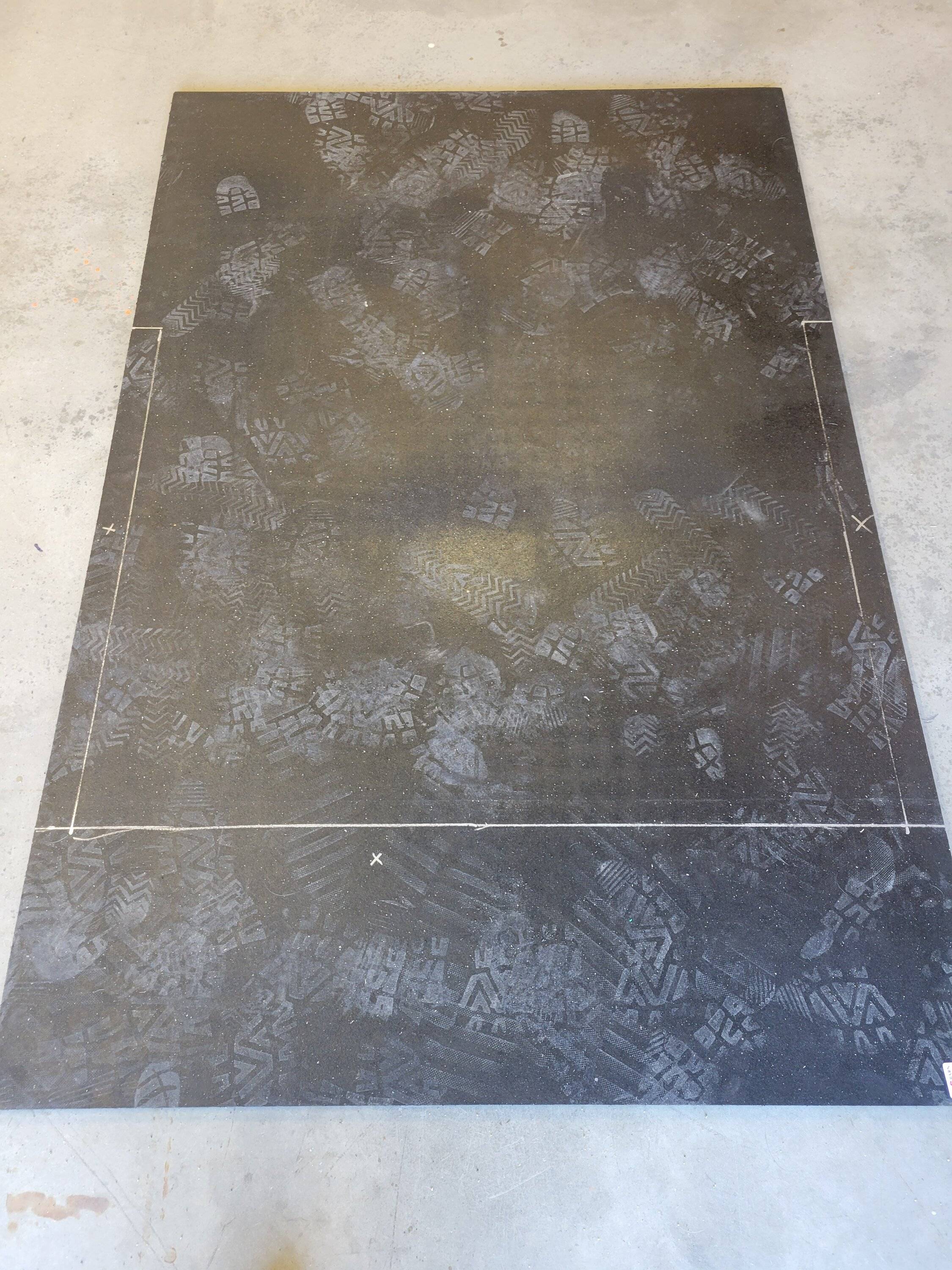

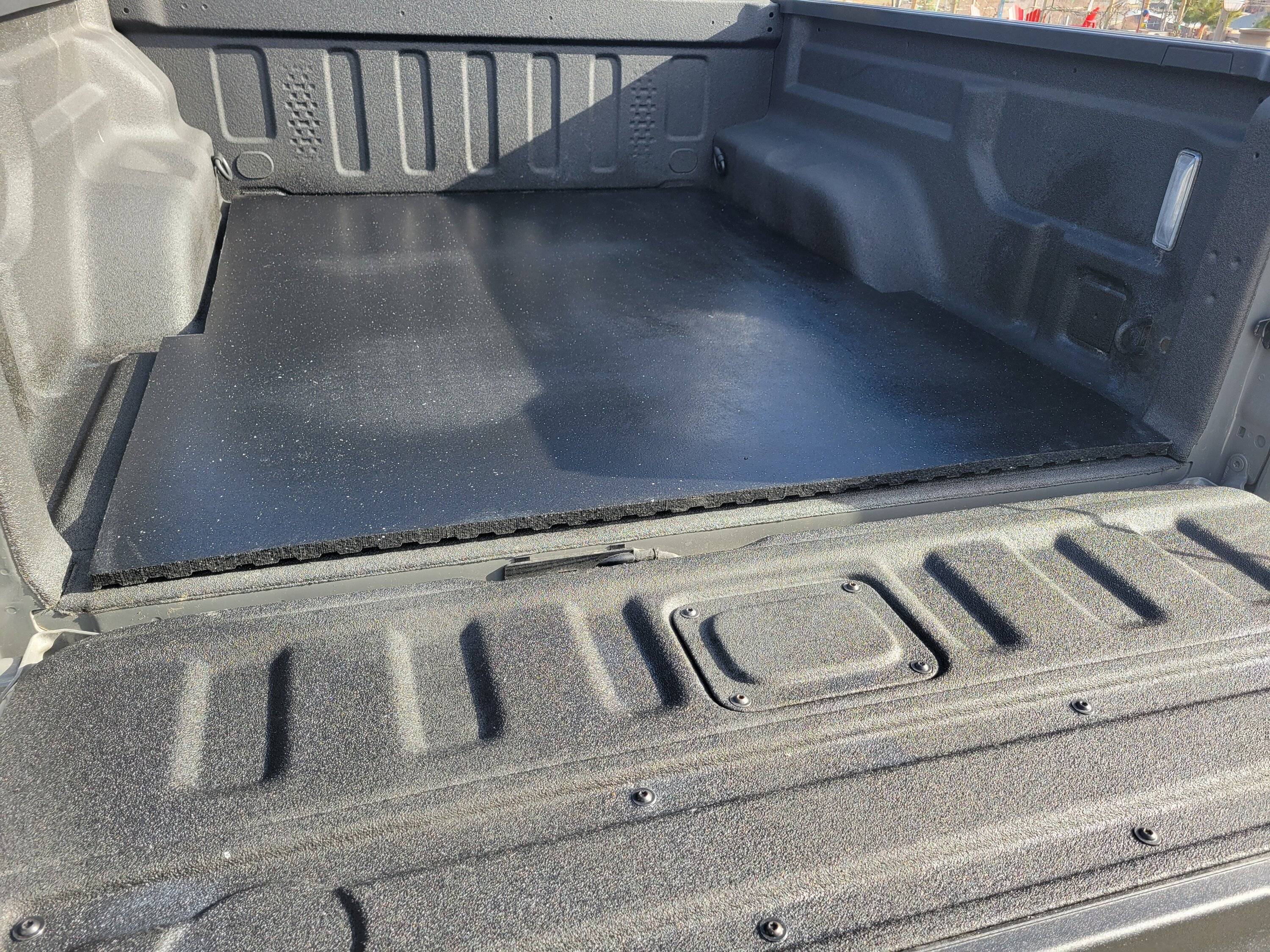

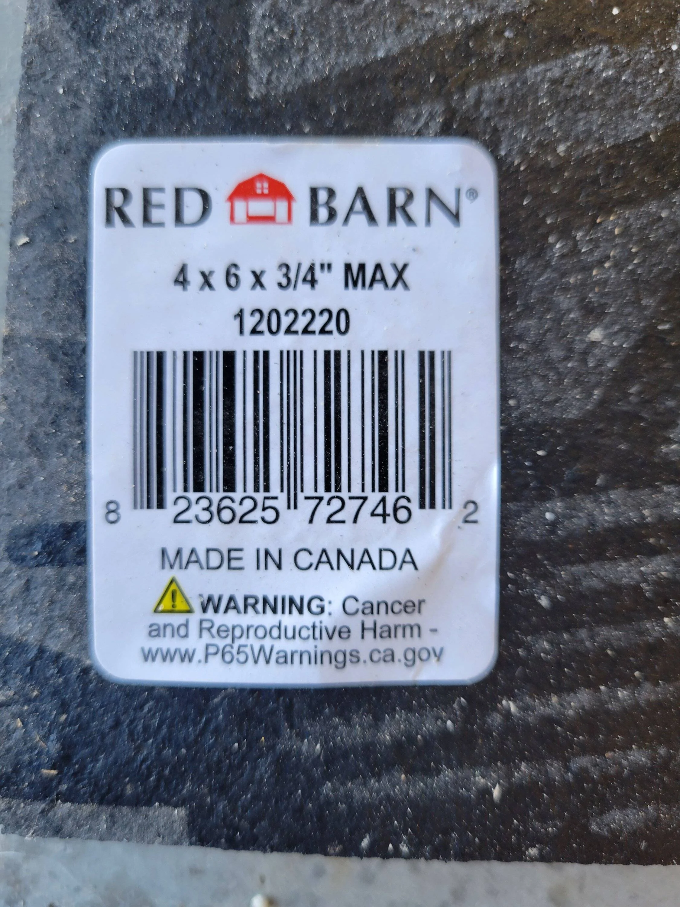

My new 2023 Glad came with factory spray liner which is nice. I ordered a highly rated bed mat that came shipped tightly rolled and would not lay flat even with weights on corners for days. Opted to return and try a DIY solution. Bought a 4x6 horse stall mat at a farm and ranch store. Trimmed to fit and it works great and best of all , it costs just $50. It is 3/4 inches thick and has one side with raised dots so water can drain underneath. Used a circular saw to cut the rubber. "I love the smell of burning rubber in the morning"
Jeep Gladiator Bedliner or bed mat? Bedmat made from horse stall mat $50
Jeep Gladiator Bedliner or bed mat? 4x6 trimmed to fit Gladiator bed
Jeep Gladiator Bedliner or bed mat? Bed mat in Gladiator
Jeep Gladiator Bedliner or bed mat? Red Barn mat SKU at Tractor Supply

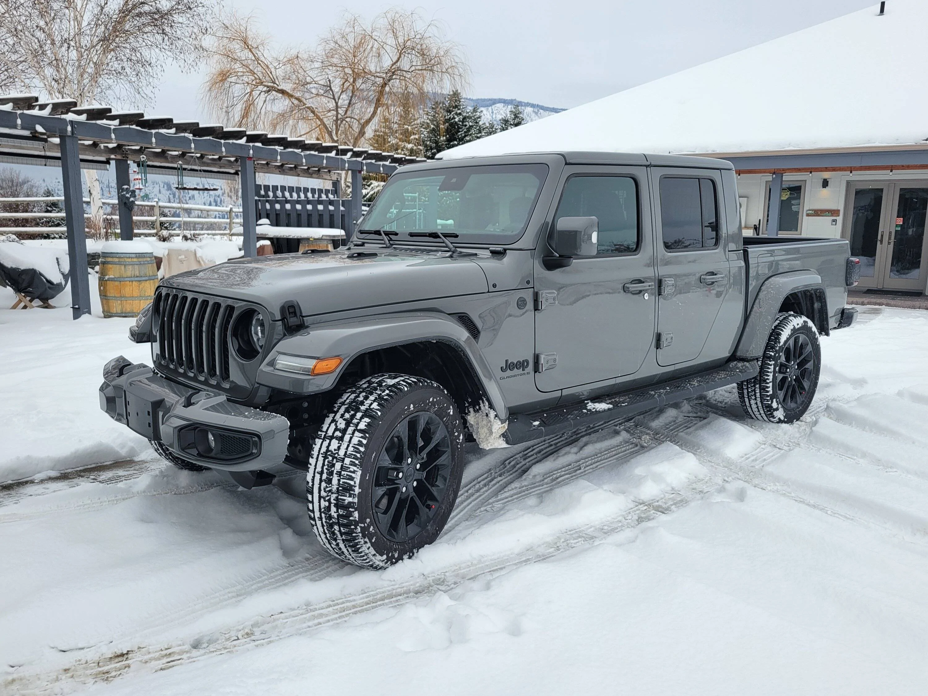

Jeep Gladiator Bedliner or bed mat? Gladiator in snow 1-19-2024

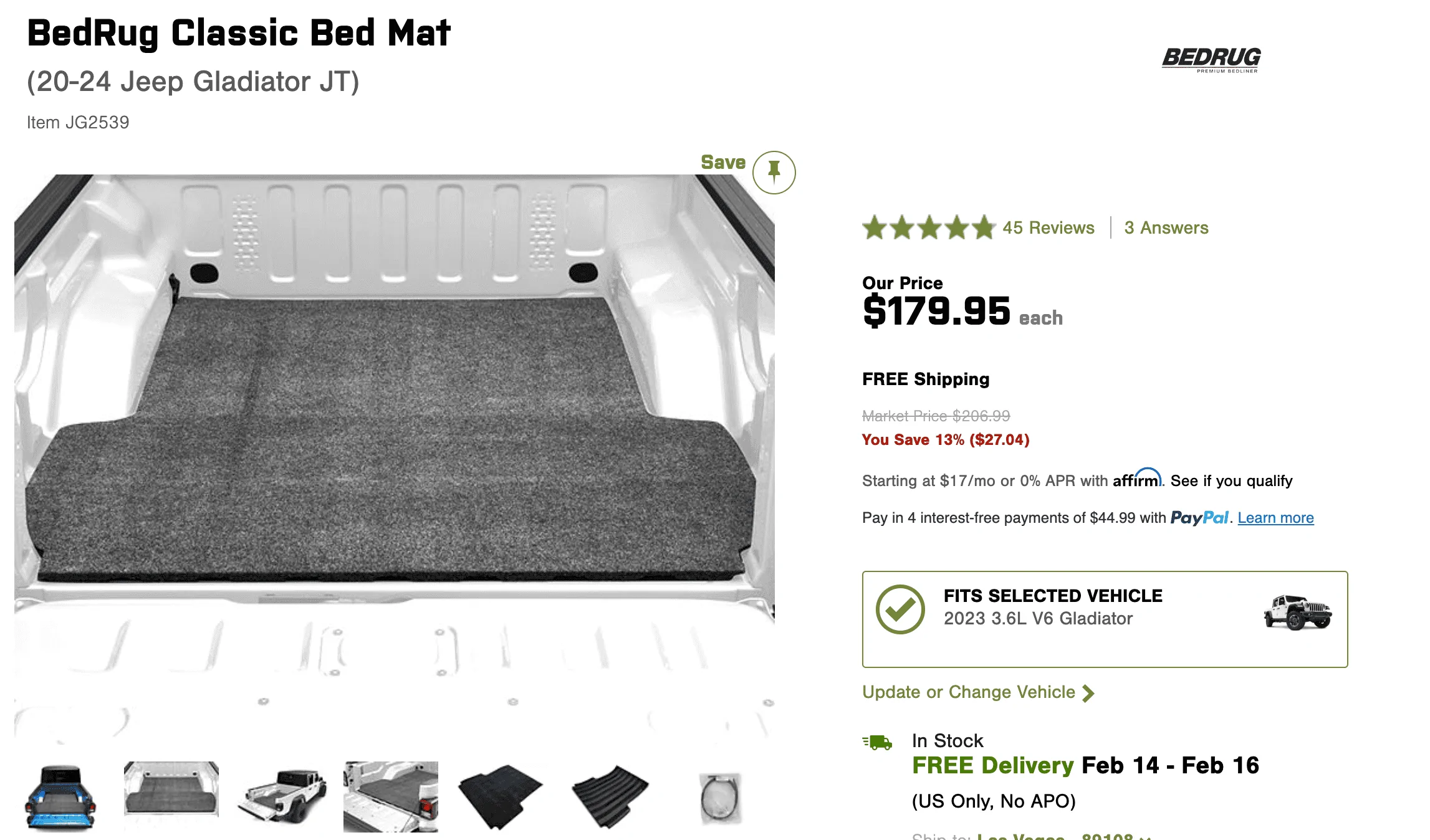

Think about all that added weight from either or both. Full bed rug, minimal weight added, washable and padded. CCC Weight comes at a premium in these things.
Nice. Did you have to stick it with Velcro or double sided tape? Or is it heavy enough that it won't fly off the bed?

The stall mat won't be going anywhere as it weighs around 46lbs. Yes it adds some weight to the truck which alters the VWR but it also benefits in snow travel. Thanks for asking .
