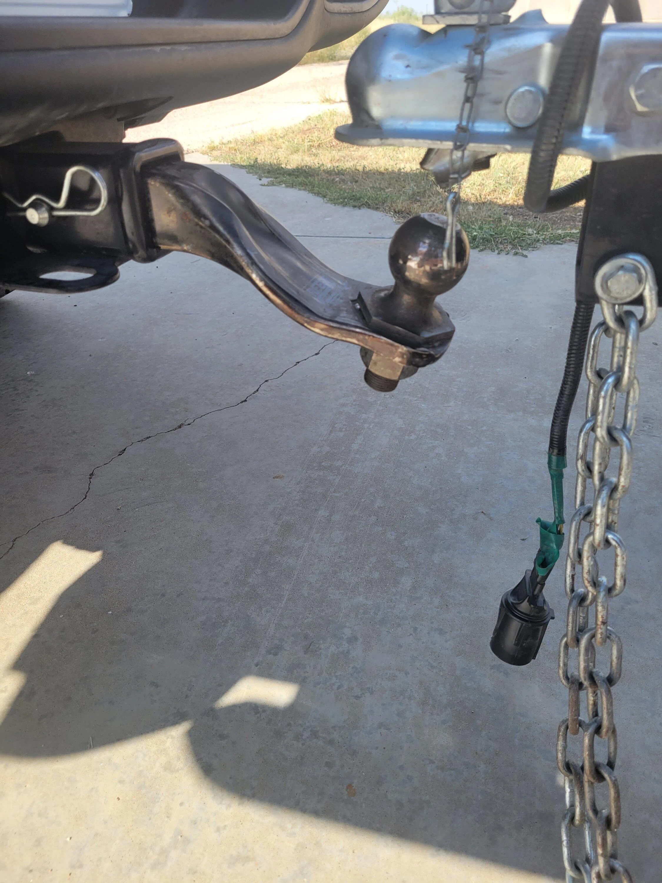

Can high strength steel be welded?
When high strength, quenched and tempered steels are welded, the heat from the arc can alter the temper on the material. For this reason, it is recommended to weld the material in the annealed condition whenever possible. Proper preheat and post-weld heat treatment are essential to minimize cracking risks.
Meaning that you have to anneal the frame before welding on it. Then heat treating to bring it back to it's original strength.
I know, I know........people have been welding on the frame for a while. Are they welding engineers? Most likely not. Can they weld? Yes. Does it mean they are doing it right? No. Are they doing a preheat of the weld area? What temp are they bringing the weld area up to? Some HSS, you have to bring it up to 700F before welding. Post weld, are they wrapping the weld area with a heat blanket to slow cool? Cool the weld area too quick will lead to cracking of weld. And the weld may pull out of the parent metal. Heating treating. You have the rate up the heating in steps to the desired temp. Depending on material, the temps could be around 1,400F. Depending on thickness, is how long you hold it there. Then you rate down the temp in steps until room temp. Some HSS, you have to go straight from welding to heat treating. You can't leave the material cool at all.

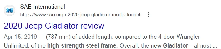

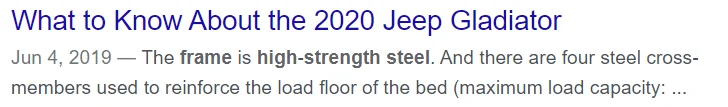

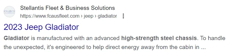

I've brought up the welding bit in earlier threads on this because these frames do have HSS - it's in the Jeep marketing information.
Somewhere I have a chart from FCA showing how the HSS (high strength steel) frame saved xxx weight and added strength with less material.
