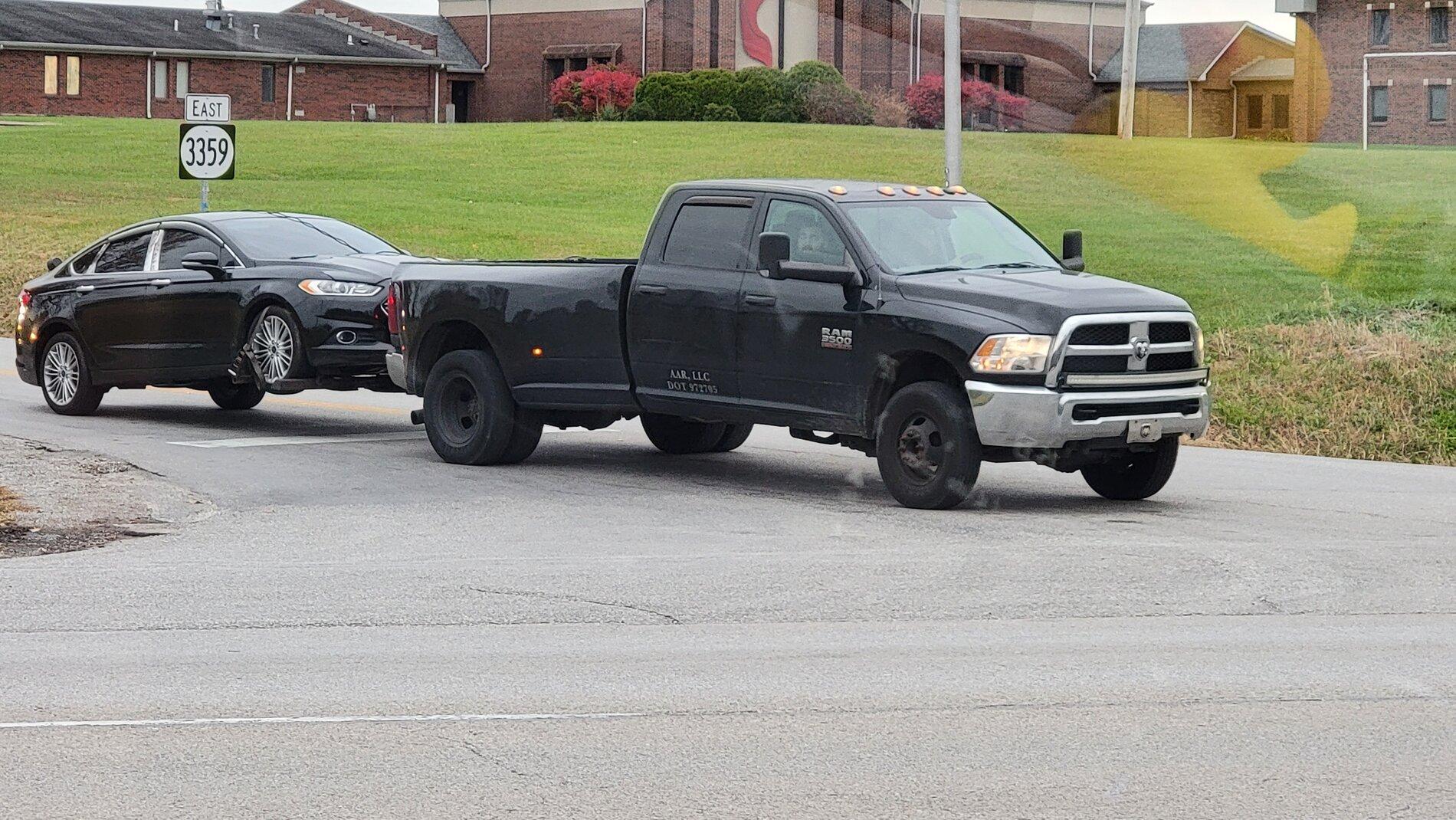

Funny that I saw this today. One ton Ram 3500 dually. Probably has 3,500 to 4,000 lbs. of payload capacity. Yet the frame folded from carrying 1,700ish lbs of car on the hitch.
ANY truck is vulnerable to shock loading.
