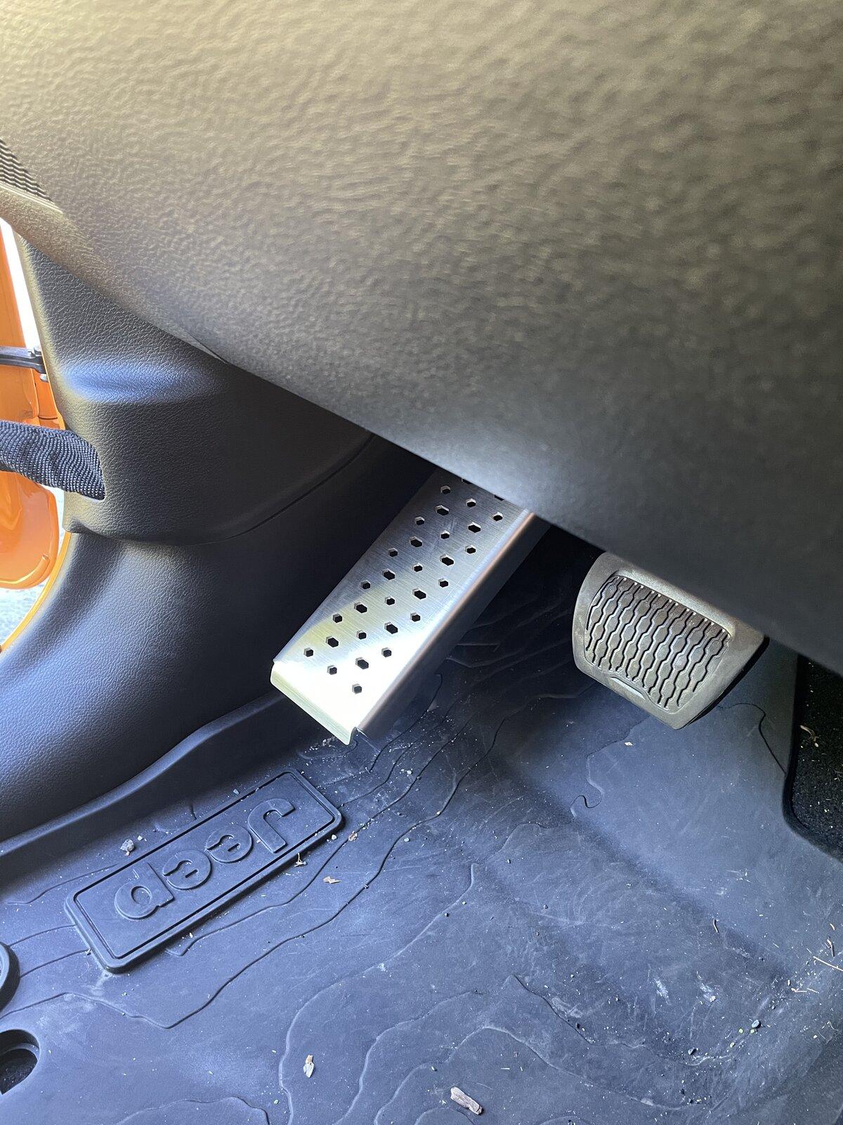

I bought the Hooke dead pedal and installed it today. Maybe it's just me, but the location is way off where a dead pedal should be- too far forward and too flat of an angle. I cut about 4" off the bracket and redrilled the hole a bit to the right, to bring the pedal closer to the side of the footwell. A little tweaking of the angles and now it sits pretty well on the same plane as the gas pedal
