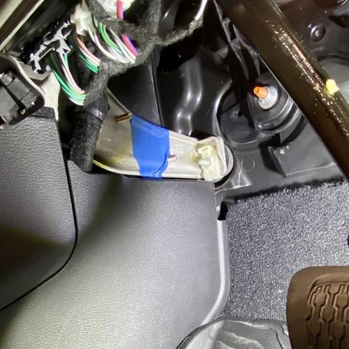

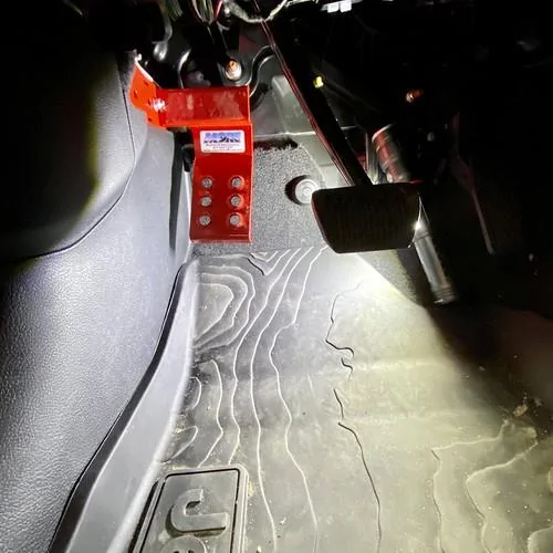

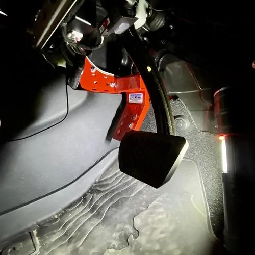

Installed the M.O.R.E dead pedal - wasn't to awful bad - "AJ-NJ" had some good tips - I took it a step more and added blue tape to temp hold the bracket in place - I can see where there are plenty of options to drop the bracket, nuts, washers etc. into/behind the kick panels - luck I was - and that didn't happen - thanks for all the tips etc. Since I am over 6' I installed the pedal in the furthest position from the driver - very comfortable (plus you get to "see" the nut to install on the bracket). The more bracket fits perfect in the factory holes so nothing to fuss with fit wise.
Very happy with the M.O.R.E Dead Pedal in the 2020 Gladiator.

Looks great !! :sun: Luv the RED too. The painters tape is a great idea. After a while you want even know it is there but if you think about it your foot will be resting on it...

I like the red too. Mine is black.
I also like the idea of the big sponge to hold the bracket. When I did mine I used an empty Poland spring bottle to hold it. That was going to be my suggestion.
I am not that tall so I put mine so it's closer to the driver's seat. If I could do it again I would probably use the middle adjustment. I dont plan on moving it now.

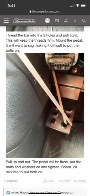

Don’t have it, but always though this trick would be helpful..

HaHa.... I love it! is that sticks or rubber bands? I got mine installed and it was a project made for a contortionist. It's not all that hard with the bar on the bolts but getting the torque on the wrench in such limited quarters was a pain. In the end, the the mount is solid but I guess I left a little slack in the pedal bolt because theirs a little play in it but theirs no way I'm taking that mother off again!
