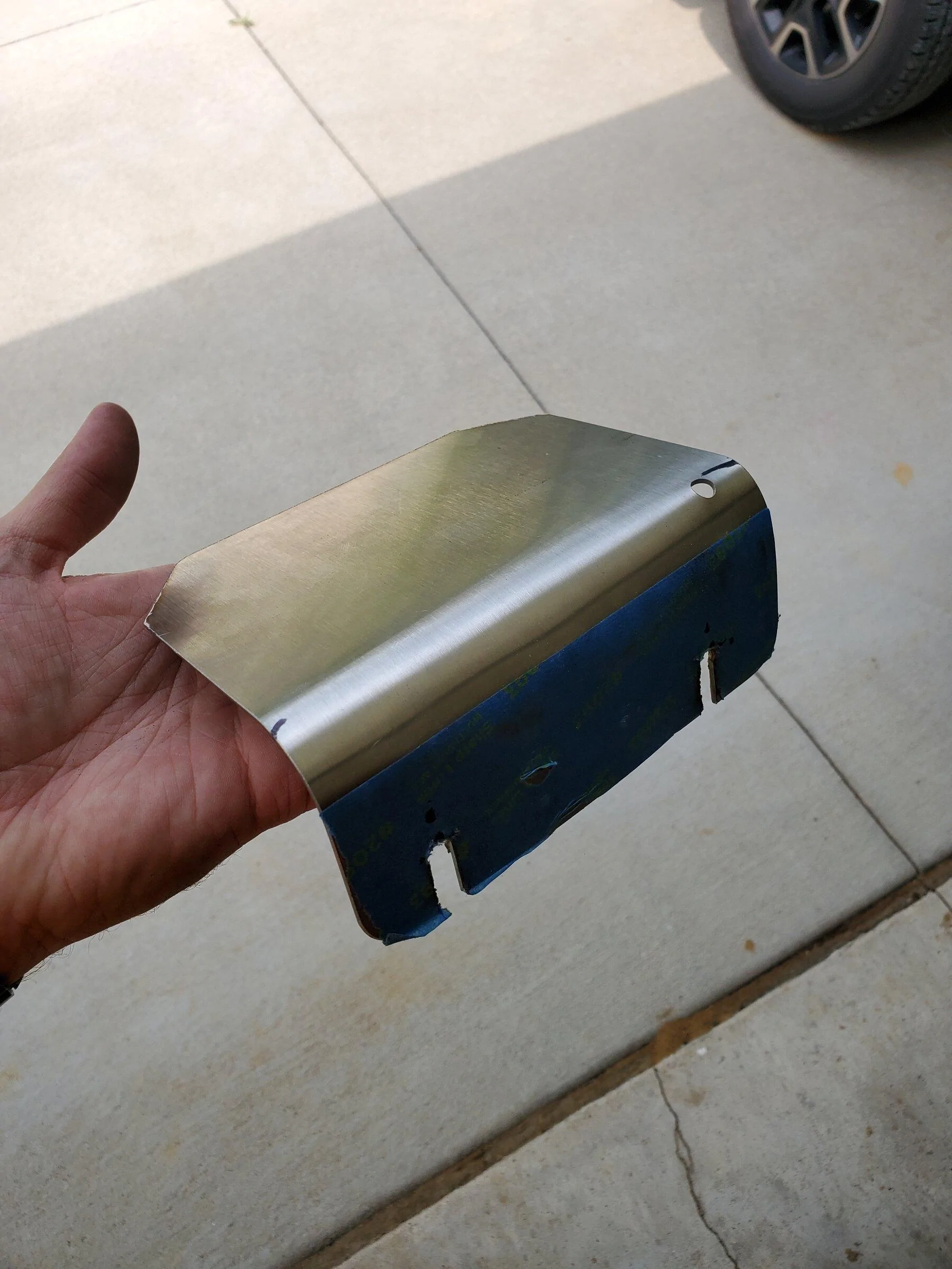

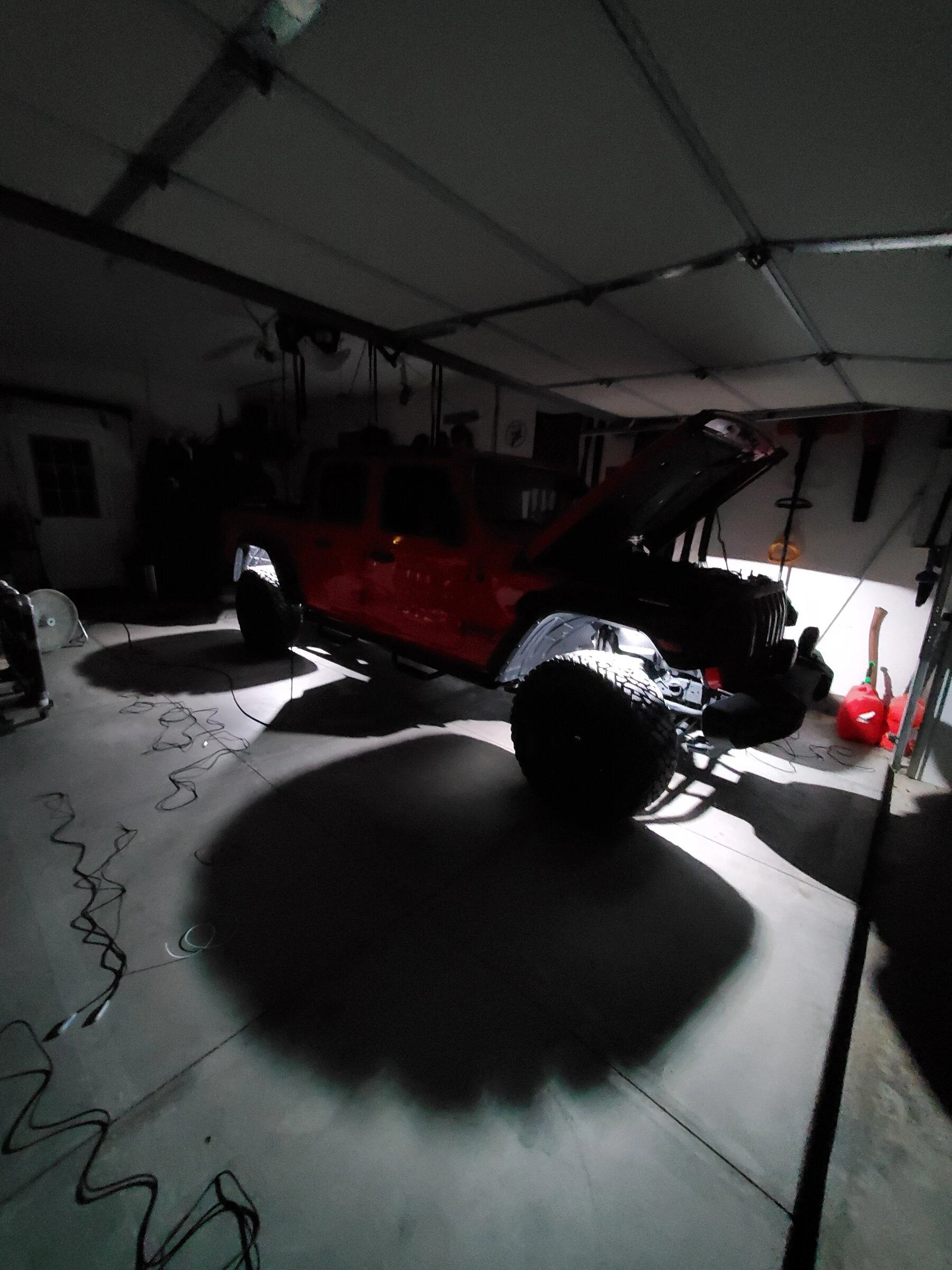

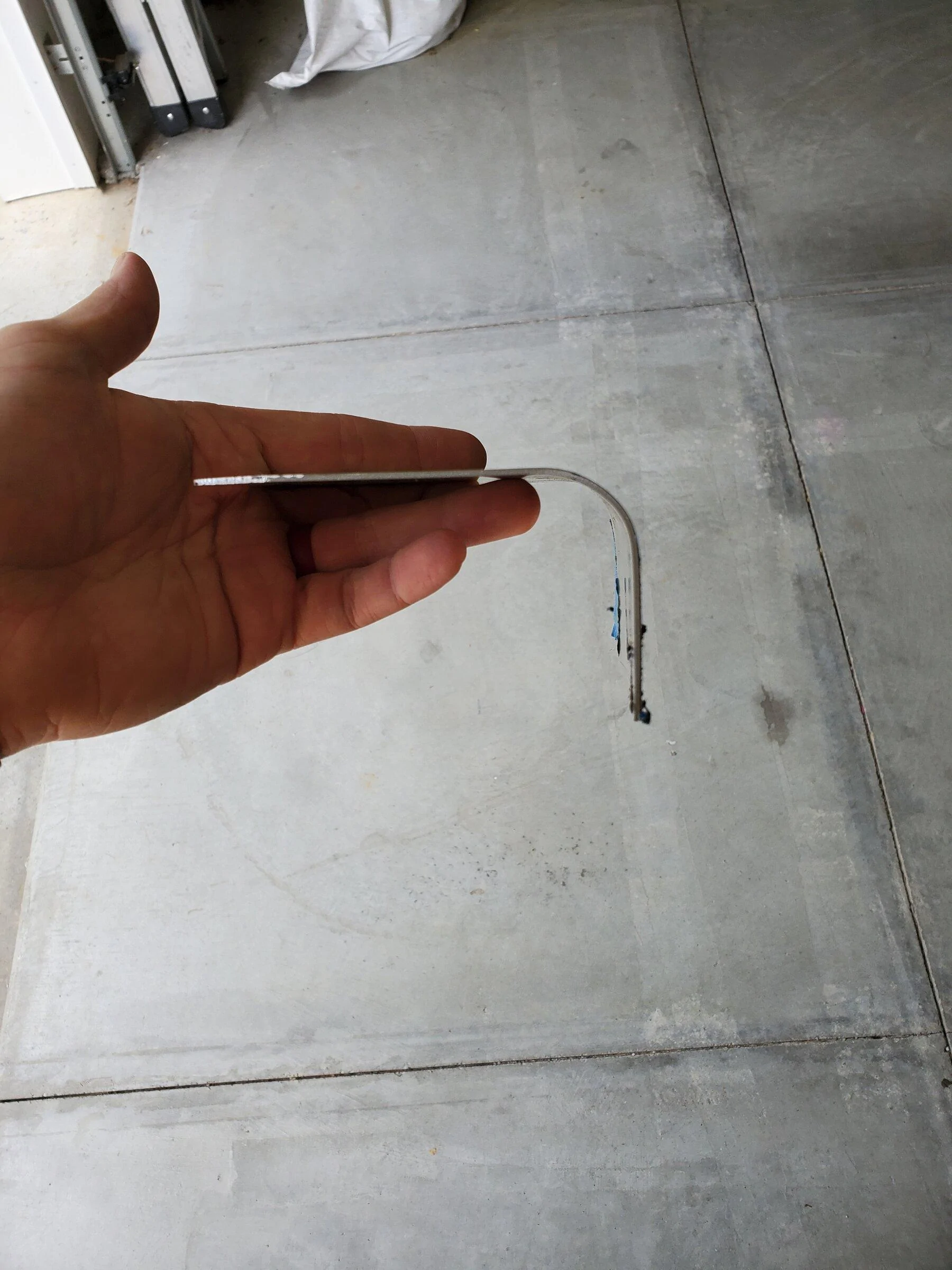

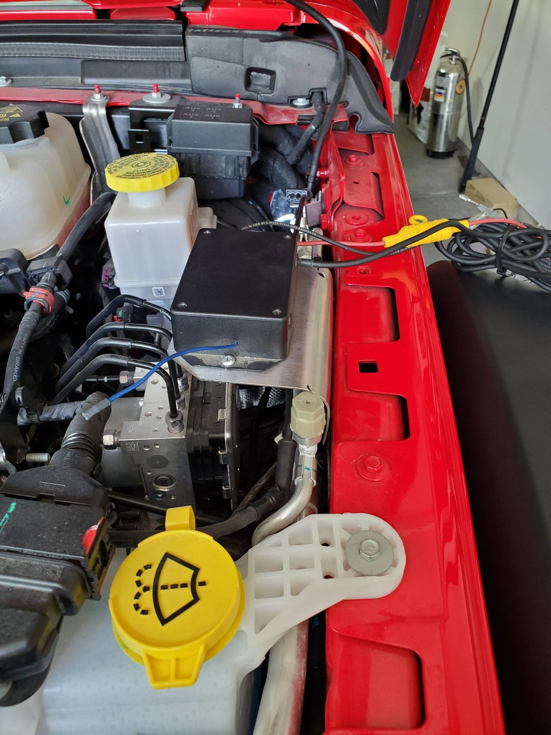

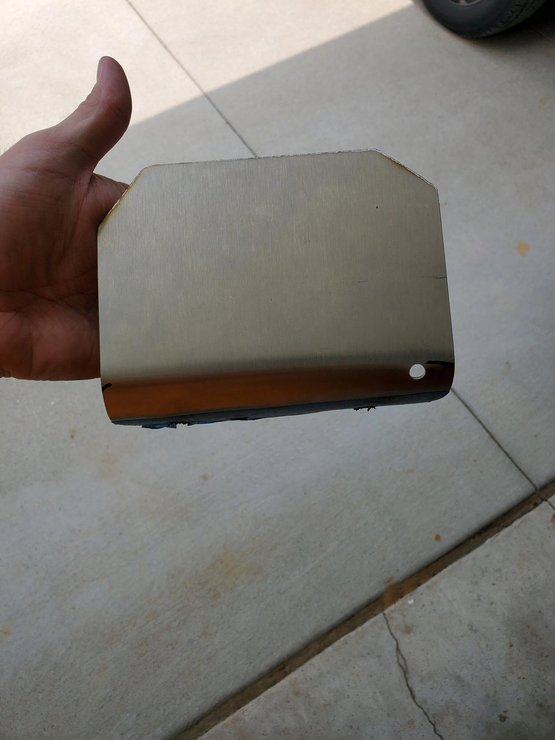

I currently have 4 LUX lights installed. I have the controller hooked up to the AUX switch. You turn on the AUX switch then open the app in your phone. They just released their own app and I have not used it yet but the app that I use works just fine. As for the mount I had a piece of Stainless laying around and with some CAD (Cardboard assisted design) I was able to make the bracket in the pictures. I used 2 nuts that were on studs coming from the fender support on the driver side fender. They were a pain to tighten but its a solid mounting point.

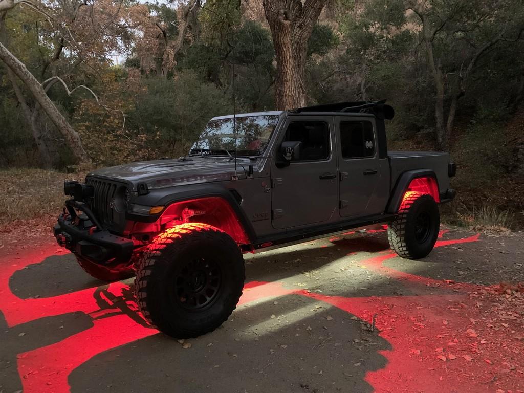

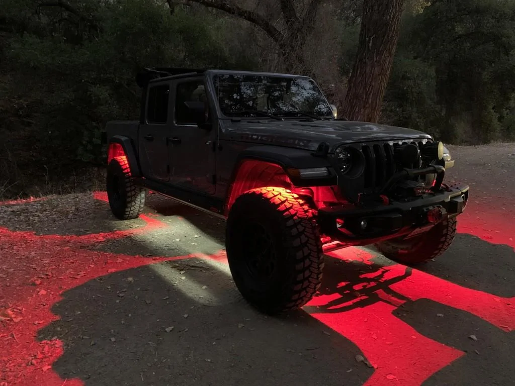

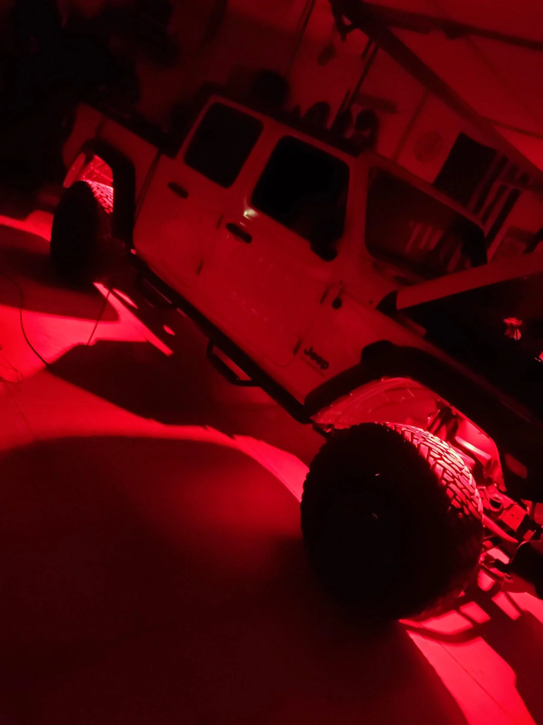

For Rock lights, I made my own kit. I only wanted bright red and white, so, no controller or kit... I needed bolt in red for the plastic inner fenders and white magnetic for the truck lower body & frame. I bought four 4WDKING Red LED Rock Lights (Amazon) and four white LUX MAX Magnetic LED Rock Lights. 4 red for the wheel wells and 4 white for between the wheel wells. My aux switches are all used, so, I used the two light switches on my Warn Platinum winch. I made my own wiring harnesses with waterproof connections and corrugated plastic automotive piping. The 4WDKING Red Rock lights on Amazon are super bright. I am very happy with them. The magnetic white Aux lights are super easy to install and have a nice diffused white color. Here are some pics. Overall, I am happy with the brightness.

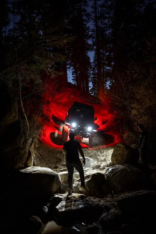

Here we are finishing the "Badge of Honor", Big Bear - Holcolm Creek Trail this past Saturday. This is the last obstacle and the pic of our rig is by Ron
