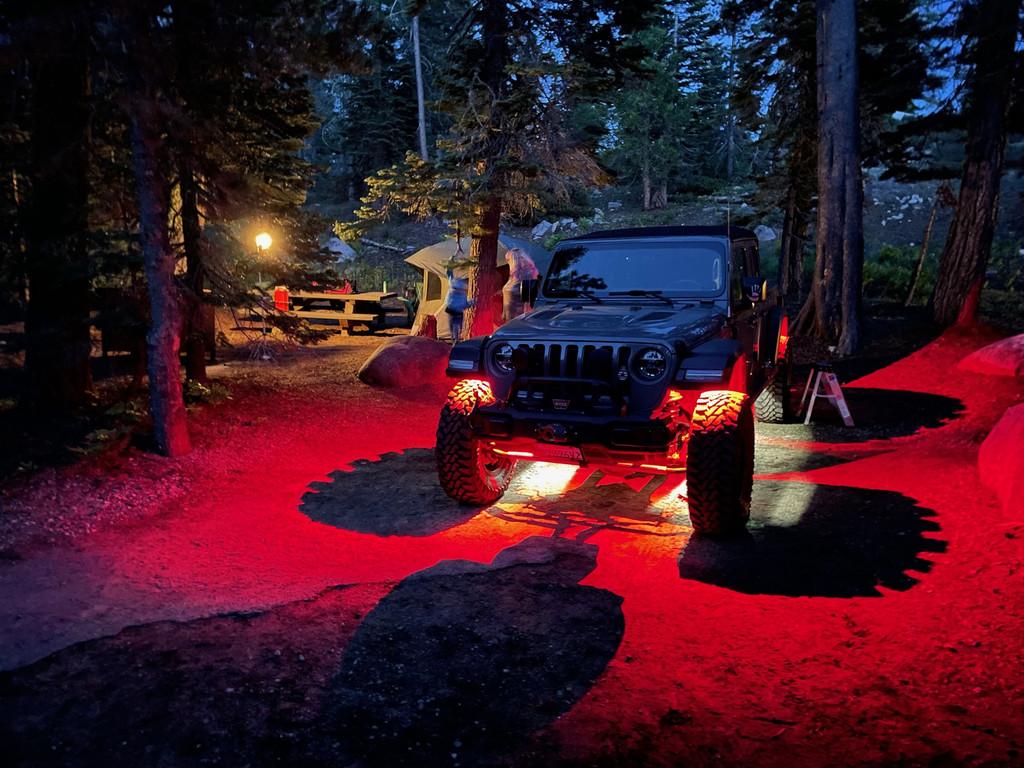

LUX Lighting systems hands down. I have the Max RGB system. I have 12 lights total. In the pictures I only have 4 installed. I have the other 8 sitting on my work bench waiting to be installed but currently in the process of trying to move so that got put on the back burner. They have full RGB capability with a pure white setting. These mount magnetically so if you are working on the trail and need to move one to redirect light then you can with no issue.

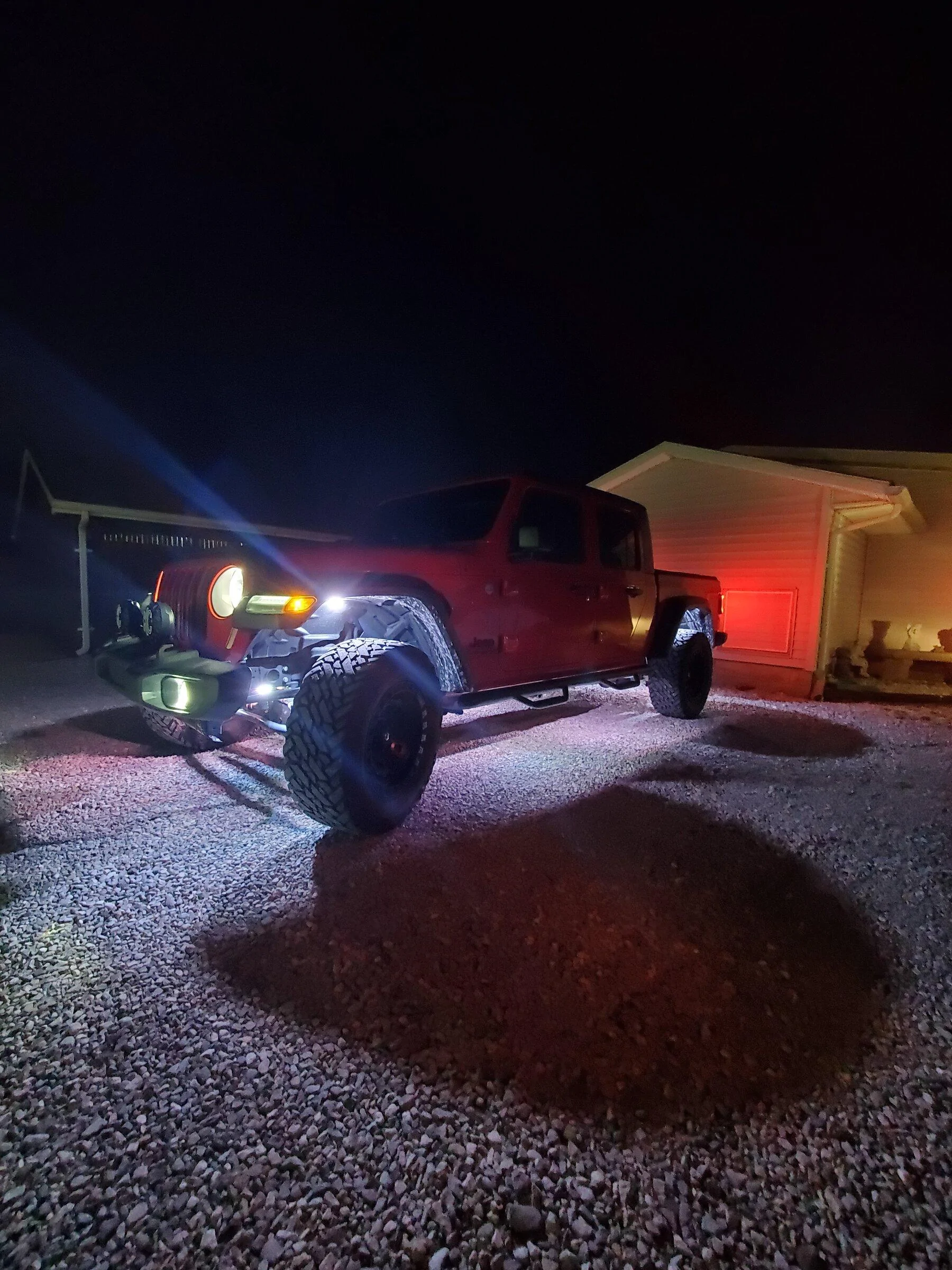

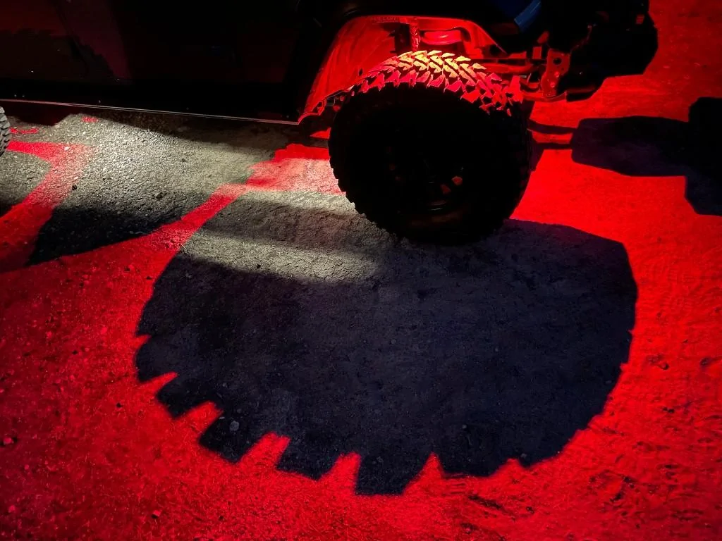

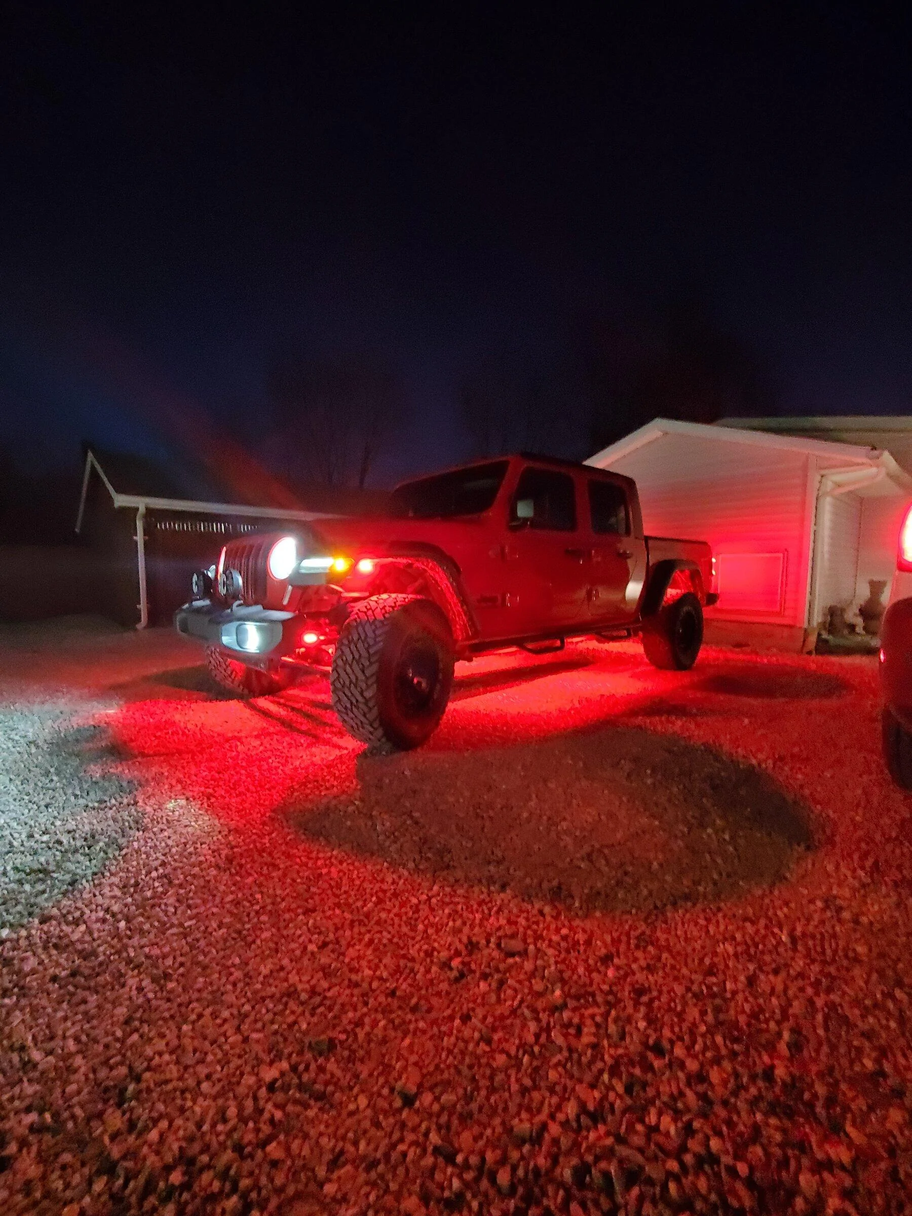

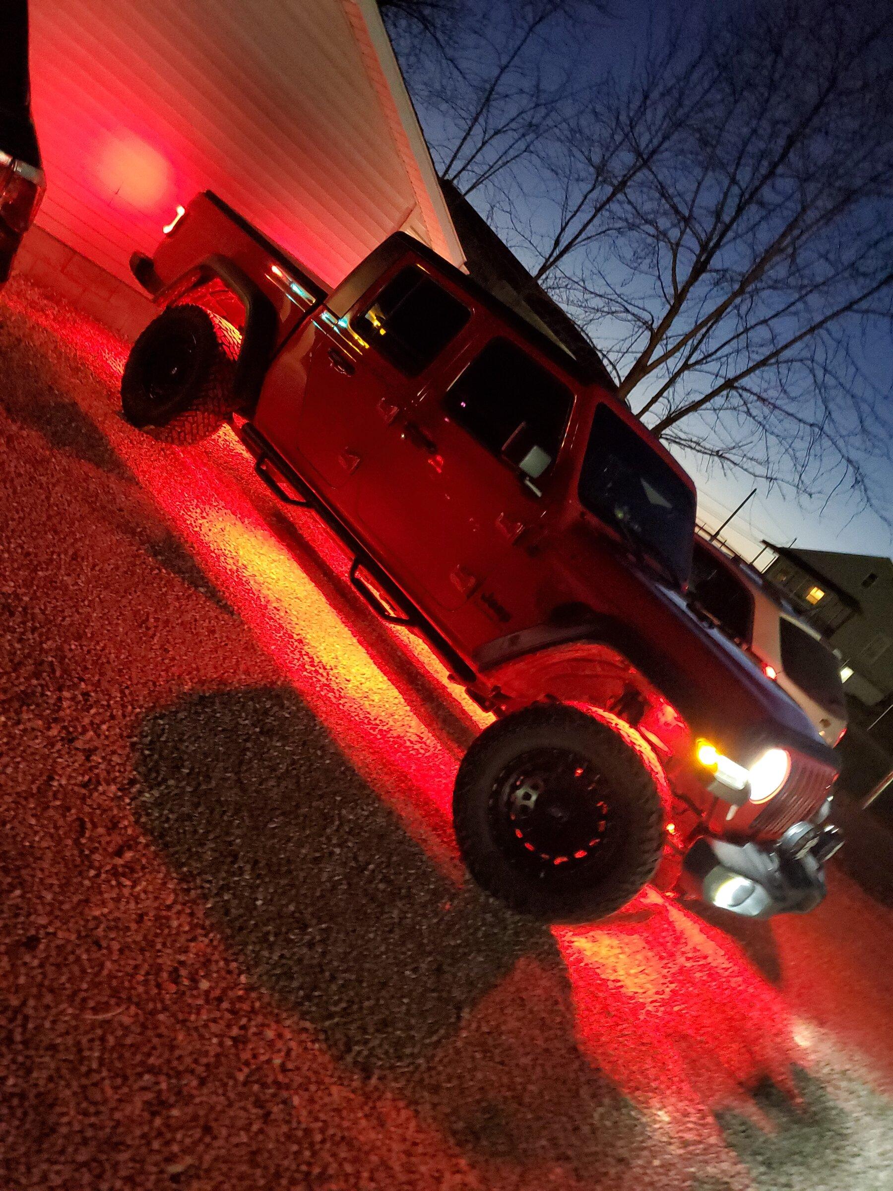

About to install these in mine - How did you secure the lights in the fender flare wells? From the pic it's hard to see, did you cut them?

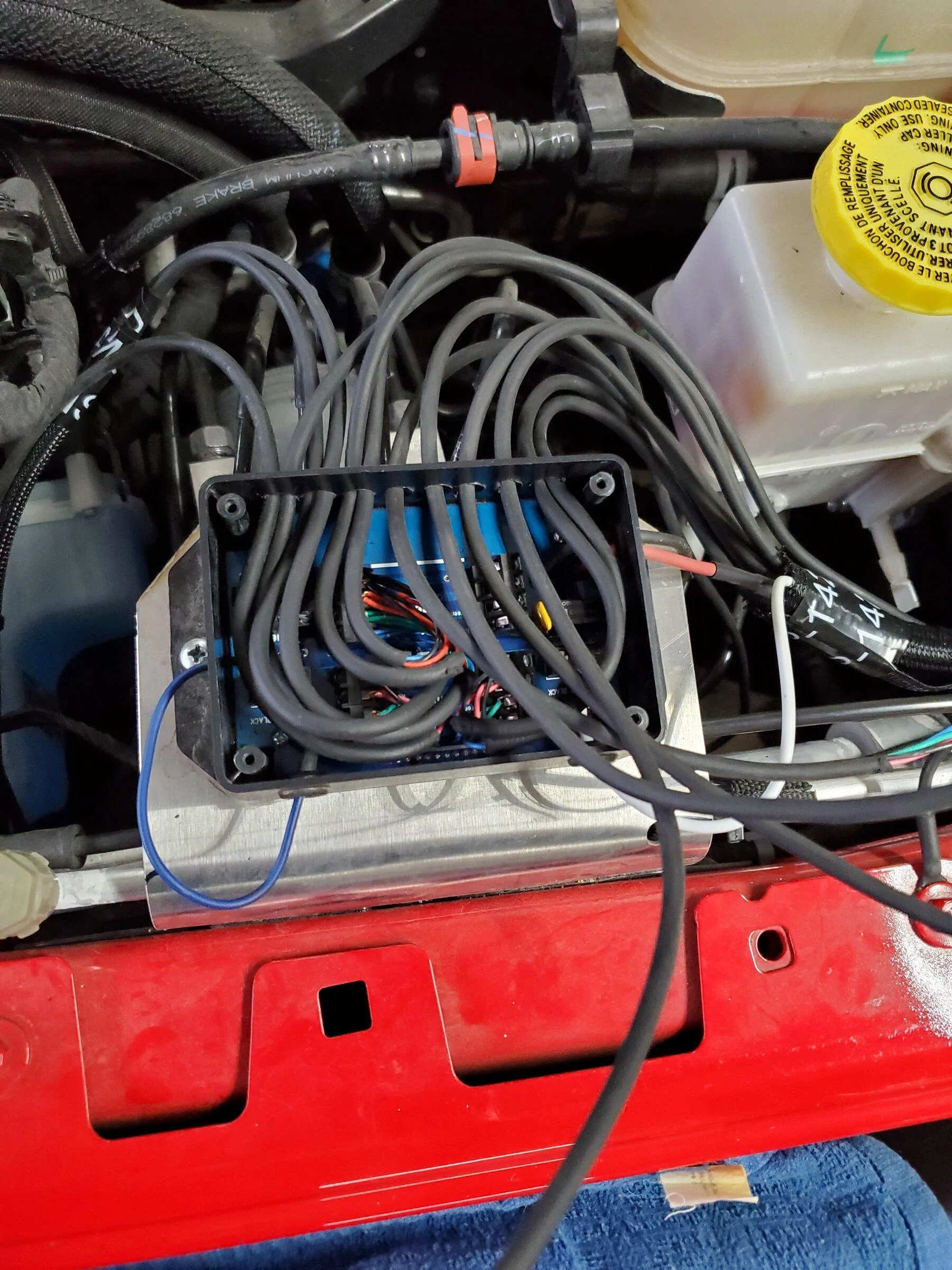

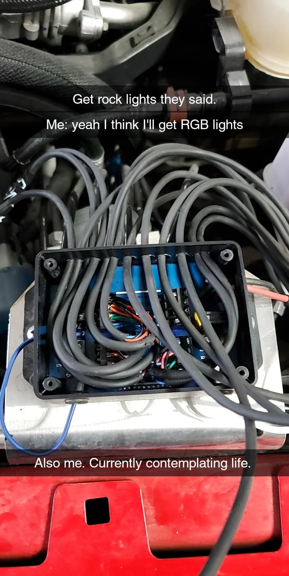

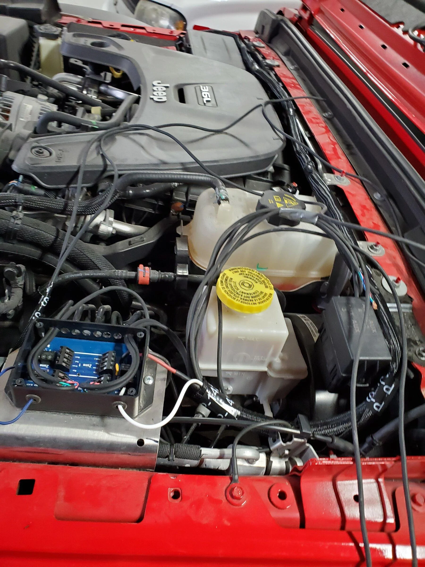

I got the mounting tabs from LUX Lighting just metal plates with holes and used plastic clips like what holds the inner fender to the outer flares. Finally got around to installing the other 8 lights as well so I have 12 total now.

That looks fantastic!

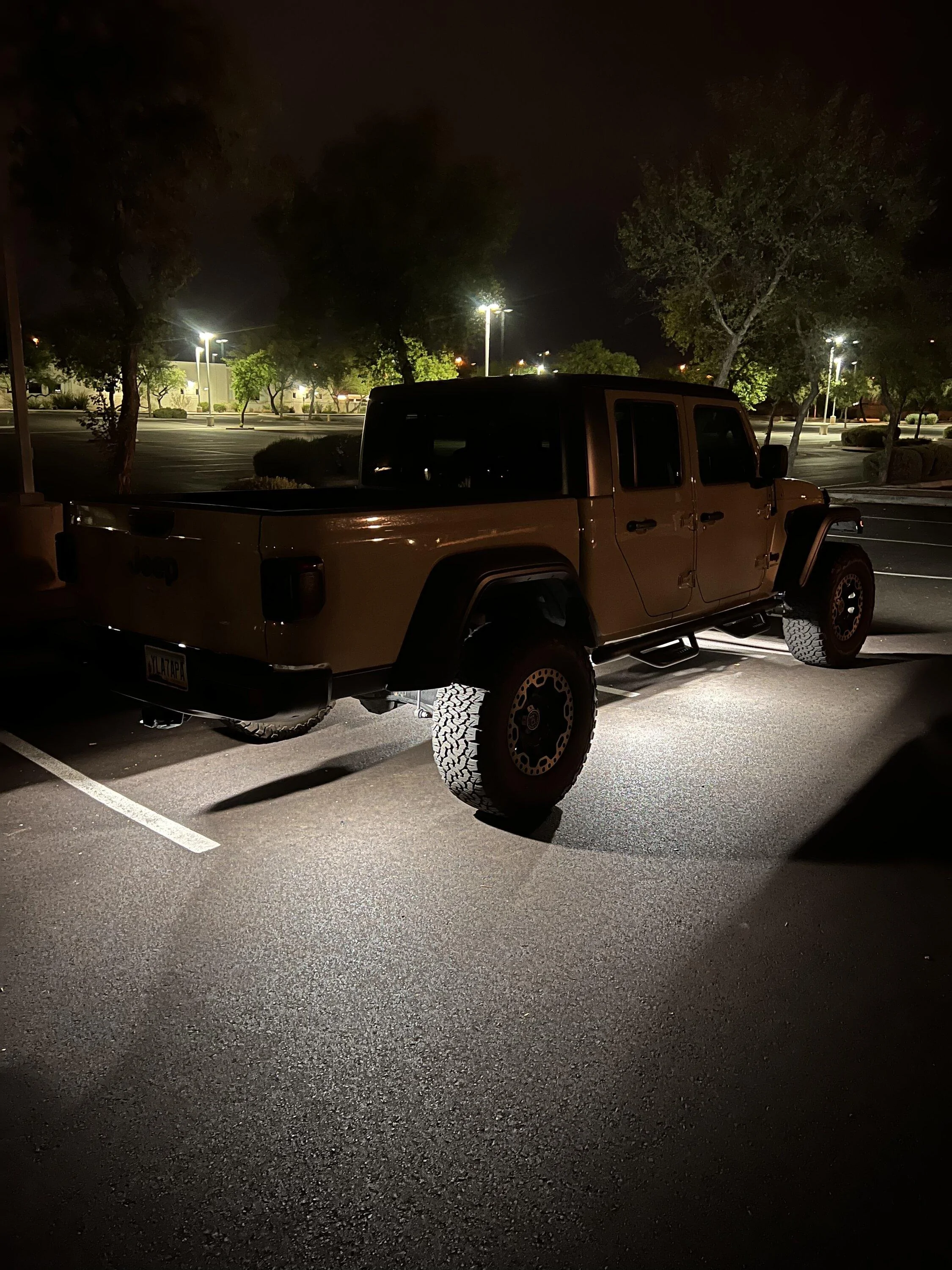

Just finished a 8 Max White Lux pack. The install was reasonably straightforward w/ aux switch. I wired through a diode to enable a power input from the courtesy light group. Most difficult part was passing wire through fire wall and working in passenger footwell to tap into courtesy power.

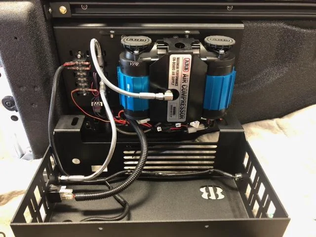

Thinking of doing the same. I removed the passenger bed light because it was blocked by my @813 Fabrication & Design Large Bed Side Compressor Enclosure and planned on using the wiring harness to connect to the courtesy lights. I would wire one zone to a switch in the enclosure for camping lights as well.

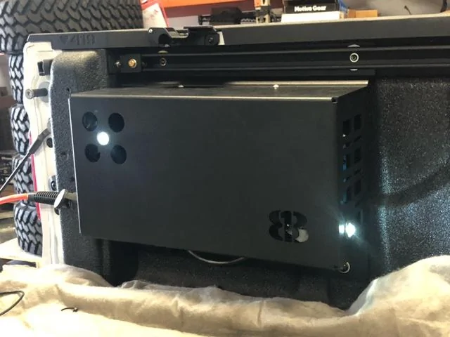

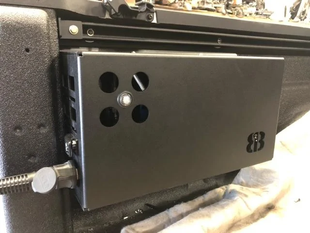

Check out what one of our Vendors did for a customer who wanted to keep the bed light. Pretty slick!

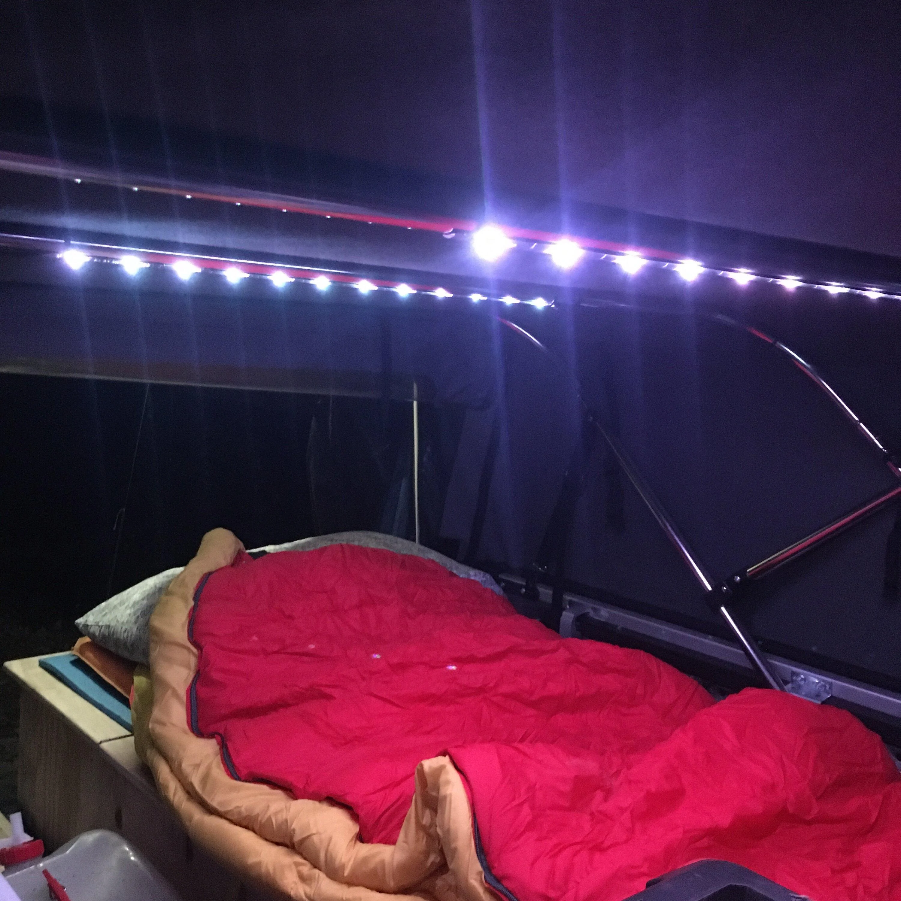

That is a good option. I used usb “tv” lights on my Softopper canopy and a switched usb outlet. When I want to remove the canopy I just unplug the lights.
