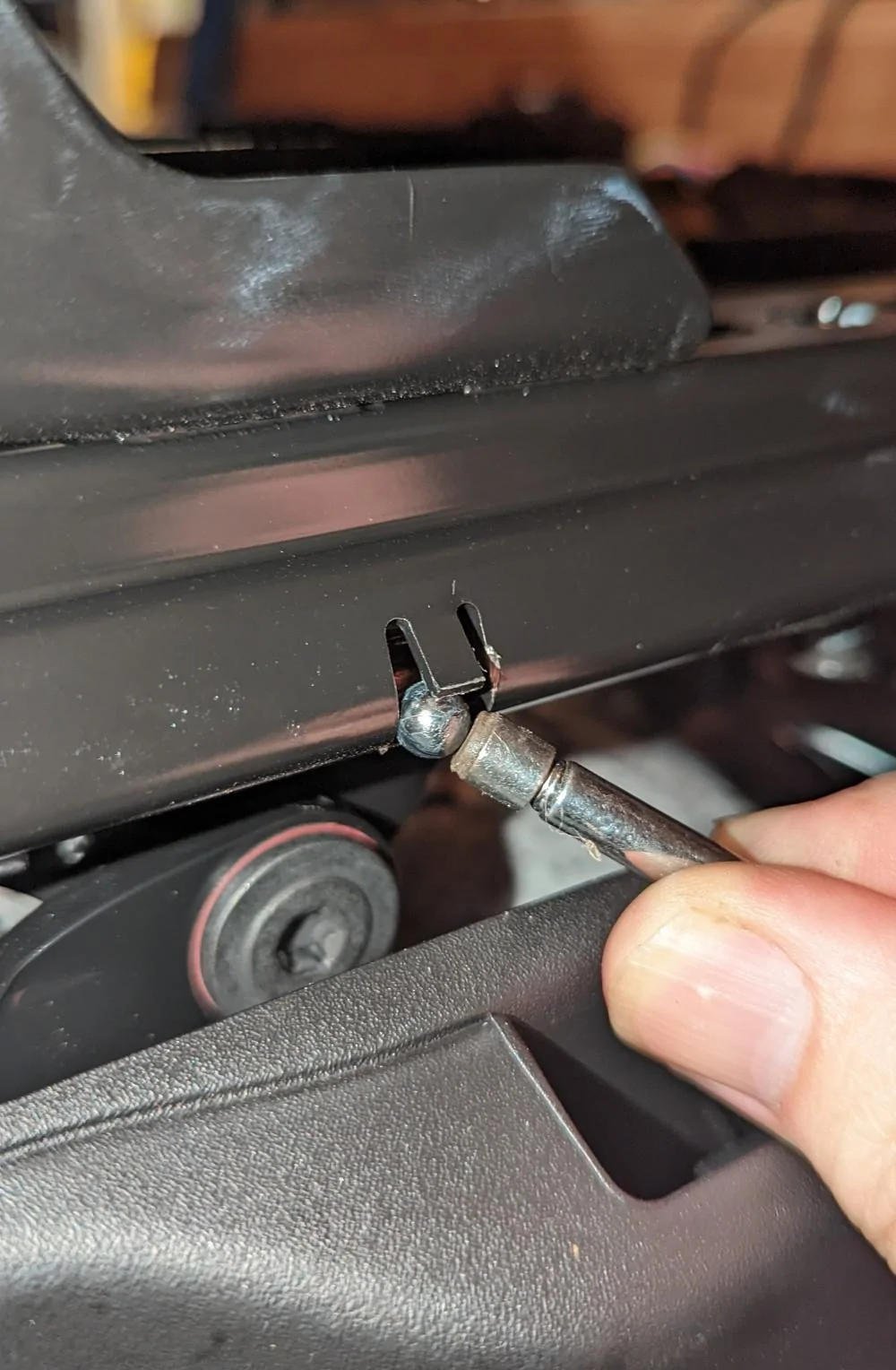

I did this today, but I only bent the 1st tab out of the way.
The balls came out there and the spacers just slid out the back.

Like Scmoken, I only bent the one tab per rail (two rails per seat).
-Also, I only removed one ball and one spacer per rail which let the seat go back an easy two inches more per side.
-Last tip: 3/8 inch drill bit was plenty for new holes (for the seat locating pins to drop into as you move the seat farther back.
