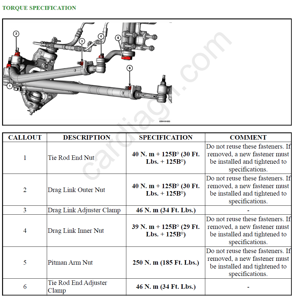

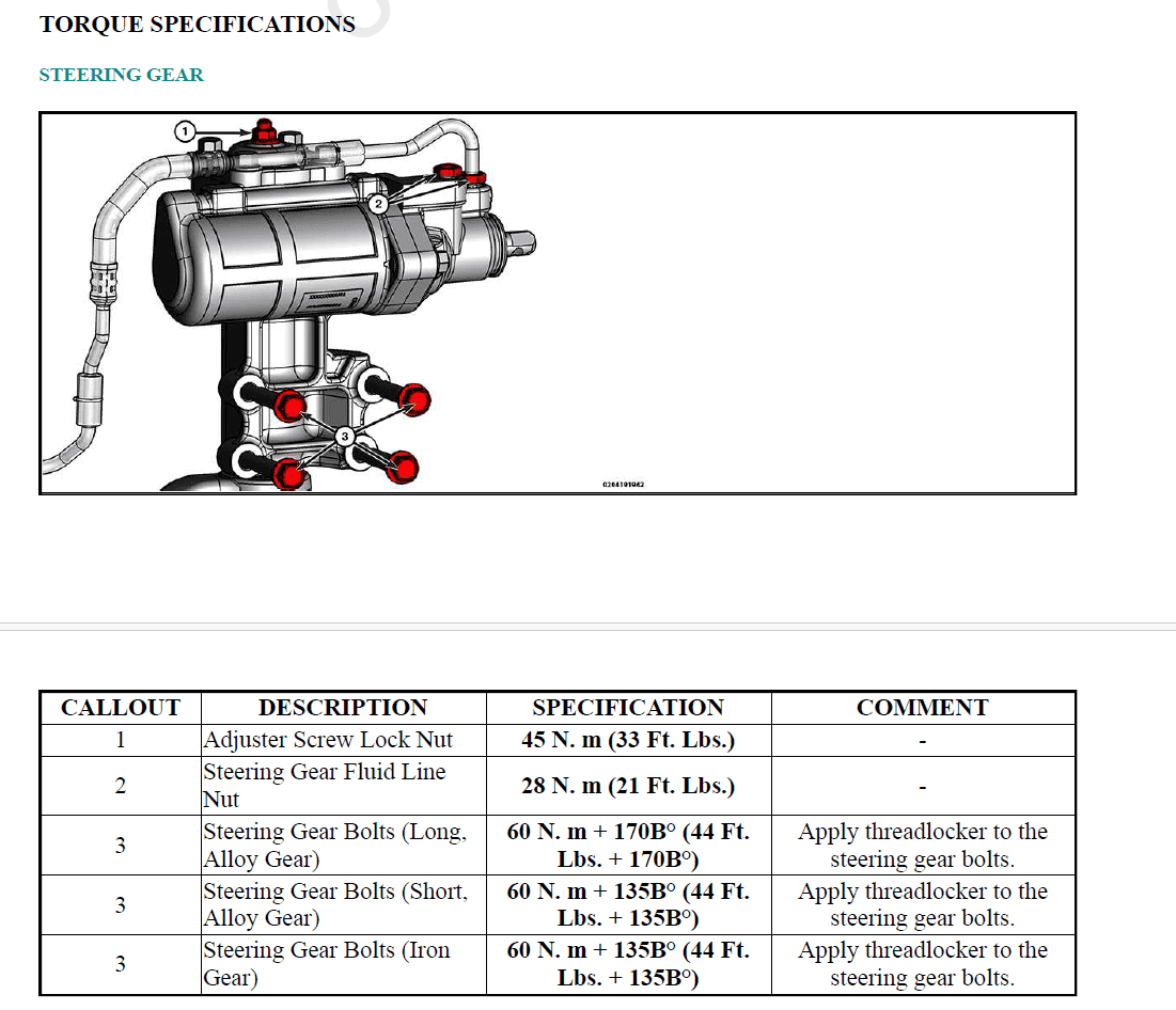

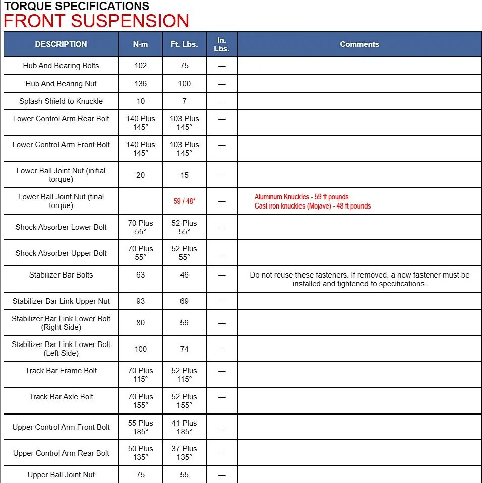

Key Points:
- Always tighten control arm bolts with wheels on the ground.
- It may be helpful to have a wife or a friend to help out by rocking the tire forwards or backwards to assist in aligning the control arm bolt holes to the mounts.
- Torque lower control arms bolts to 103 lb/ft PLUS 145 degrees.
- Go ahead and check your torques on everything else while you're at it.
