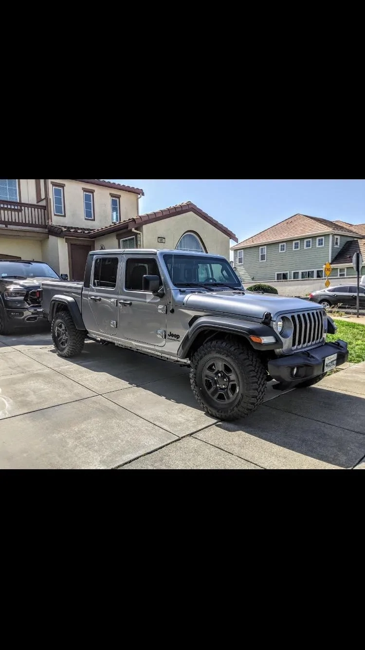

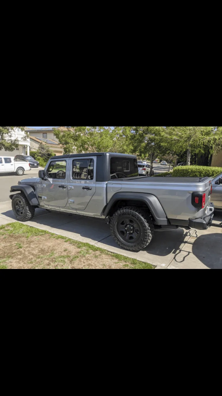

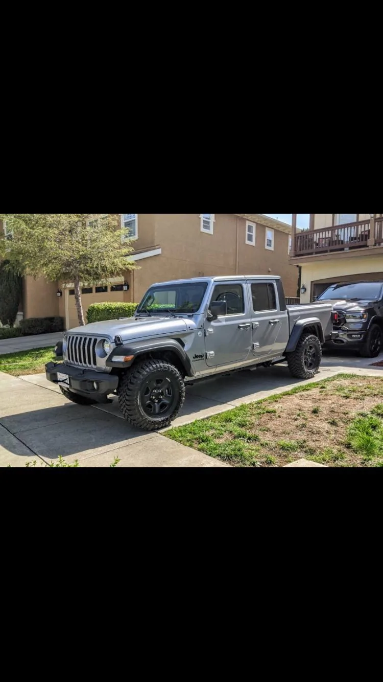

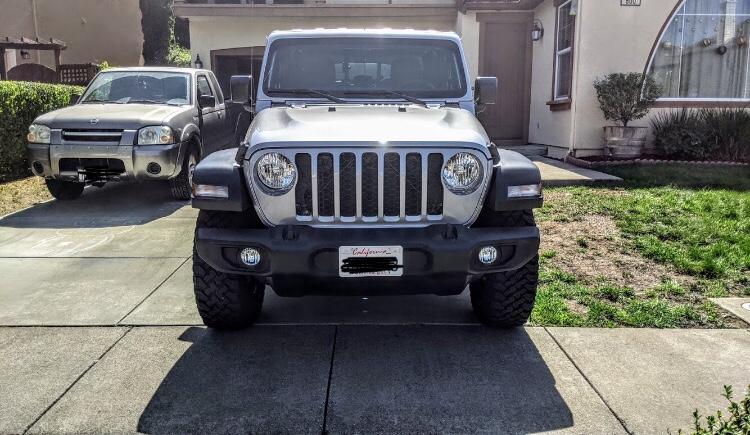

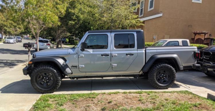

Jeep Gladiator Sport. No Max Tow. No Lift. No Spacer. Stock Black Steel Jeep Rims 17 x 7.5. Swapped tires with 285/70 Falken Wildpeak MT Q121. The Q 121 is bigger and beefier then original Falken Wildpeak MT Q116. Looks very aggressive and rides smooth! No rub! Fills in space! Took out air dams for more aggressive look!

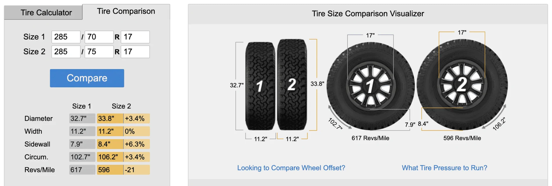

Anybody have any thoughts on 285/70/17 vs 285/75/17? I have a Sport S (not max tow).
Jeep Gladiator bigger tires on unlifted Sport S 1602529440557
I was debating between 33s and 35s for Trail Grapplers. 285/75/17 splits the difference at 33.8 or so and isn't quite as wide which I like. Just placed an order today with my dealer using Mopar's buy 3 get the 4th for $1 sale.
EDIT - And that's on a stock Base with a manual.
Please let me know how you like them. After reading thread after thread it seems like 35s aren't worth it with 3.73 gears so I'm hoping one of the above mentioned sizes doesn't turn the truck into a dog. I'm leaning towards 285/70, but I saw some pictures of 285/75 on a sport without a lift and without the air dams being removed, but I don't know if it rubbed or what.

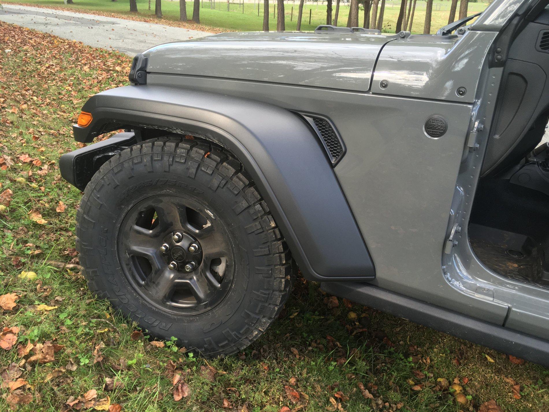

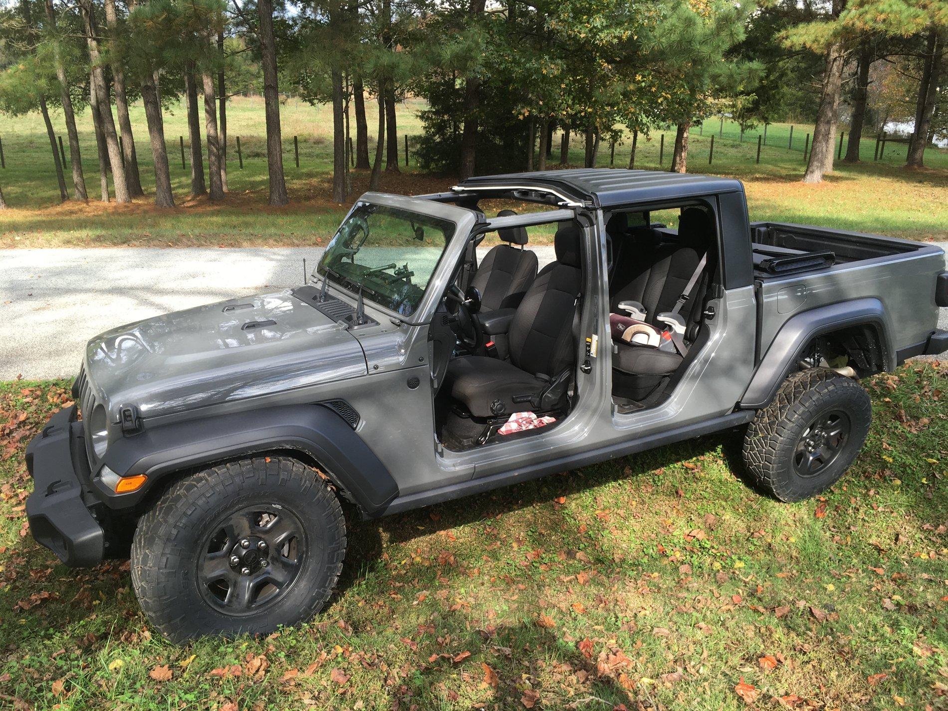

I finally had some time to drive a good bit with the new tires. Overall it's not bad - not as sluggish I thought it would be. It definitely lost a good bit of the pep but it's livable. I actually kind of like the feel of more 'weight' in the drive line. It does make shifts a bit smoother.

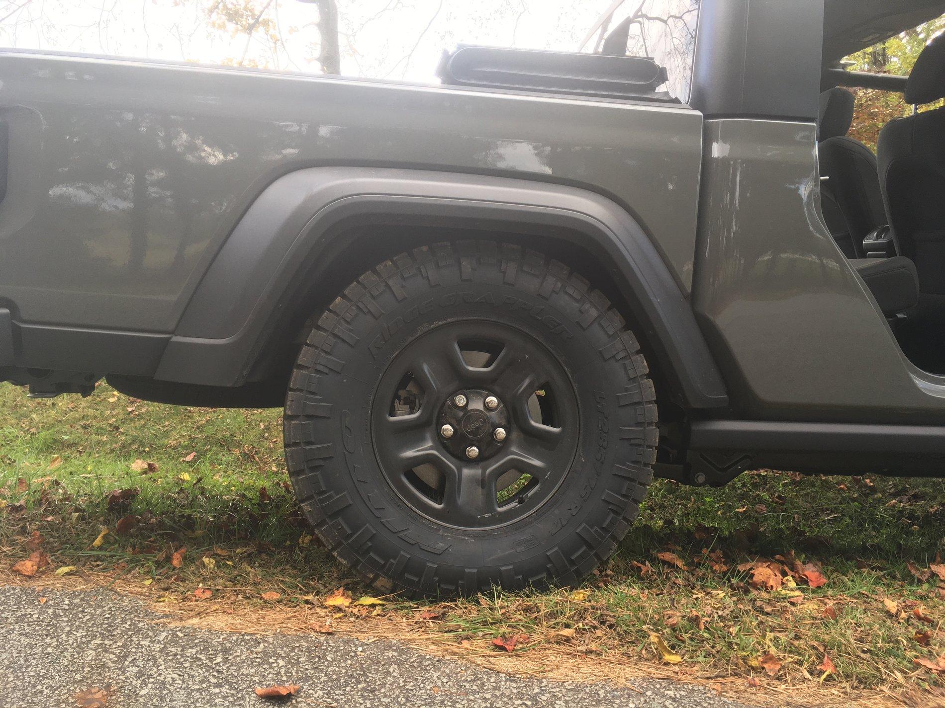

As for rubbing I'm not getting any. Rears have about 1.5" to the inner fender when on the bump stops...
Front was hard to get to the bump stops with the sway bar connected but it's about 1" from the bump stop and still has roughly 2.5" to the inner fender...
We'll see if I can flex it more than this on an upcoming trip but don't think it'll be a problem...
