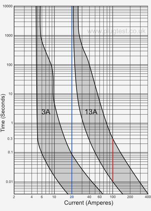

Fuses aren't necessarily designed to blow immediately. when there is a massive over-current draw they will blow very quickly but as you get closer to the fuse rating, the blow time takes will be longer. Here's an image of the blow curve for a 13amp and 3 amp fuse. Note that the higher the fault current, the faster the blow time, but for lower fault currents, it can take quite a bit longer.
