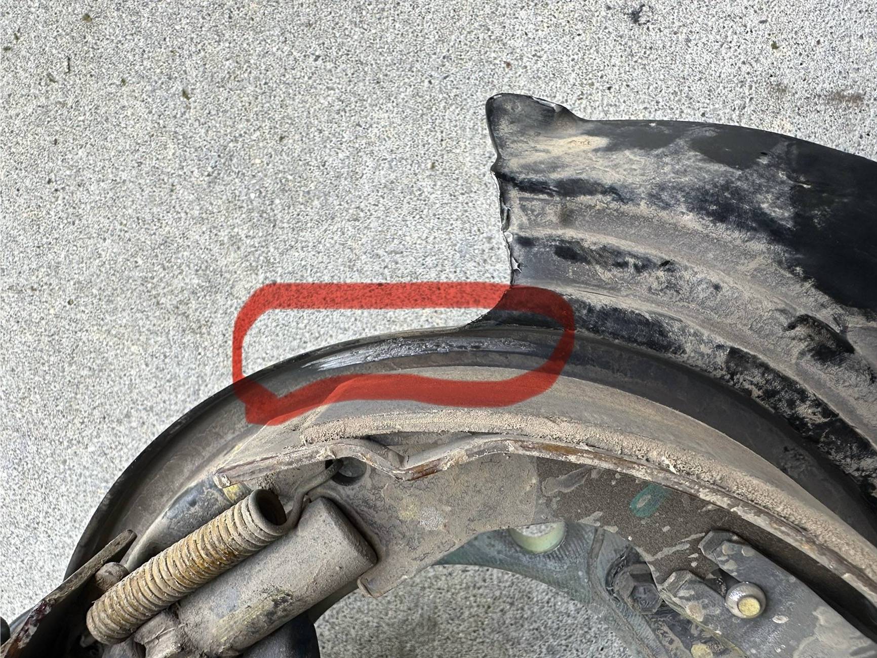

I had new gears installed this week, and while driving home there was a terrible squealing noise from the rear which we determined to be the braking system. Called the shop, and the owner drove two hours down to my house, and said that when they re-installed the brake calipers they must have bent the dust guard (?), a shield that protects the rotor. He said he bent it back into place and all was fine for a few miles and now it’s back to the loud squealing again, especially on right hand curves (which I don’t understand). I’m thinking the metal may be weakend from the bending, and maybe I should just replace these guards. Problem is, I have no idea what they’re really called so I don’t know how to order them. I’ve been looking for parts diagrams but haven’t been able to find any. Can anyone steer me in the right direction?

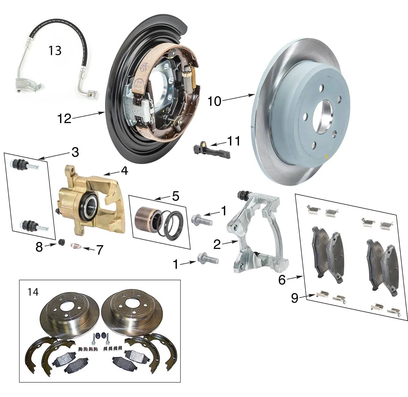

thank you for the reply. I’m not sure that’s it. It doesn’t look like that brake shoe shown in that diagram. It’s more like a flat piece of thin metal. I’ll have to take a picture when I pull the wheels off tomorrow. Thank you for the contact info for Benny.

I think I just found it. This is from Quadrtec’s website. It is part number 12 in this picture. Thanks again.

If it looks like the brake shield isn’t contacting the rotor but you still hear a noise, then I agree with @kevman65 it’s some other part of it rubbing that you just can’t see.
The inside of my assembly was rubbing after my FIRST time losing a caliper bolt.
I have a few pics of this if you search me.

Wow. Just looked at your pictures. I guess I can assume my rotor is gouged from the shield rubbing against it. I wonder what other damage I have. Looks like I’ll have an expensive repair bill.
I’m guessing your rotor will be fine, those things are pretty beefy. Mine was, and I couldn’t believe it based on the whole caliper jamming/breaking my wheel.
But I wouldn’t be surprised if there’s something off with the whole brake shield/parking brake assembly since the sheet metal that’s all mounted to is pretty flimsy.
