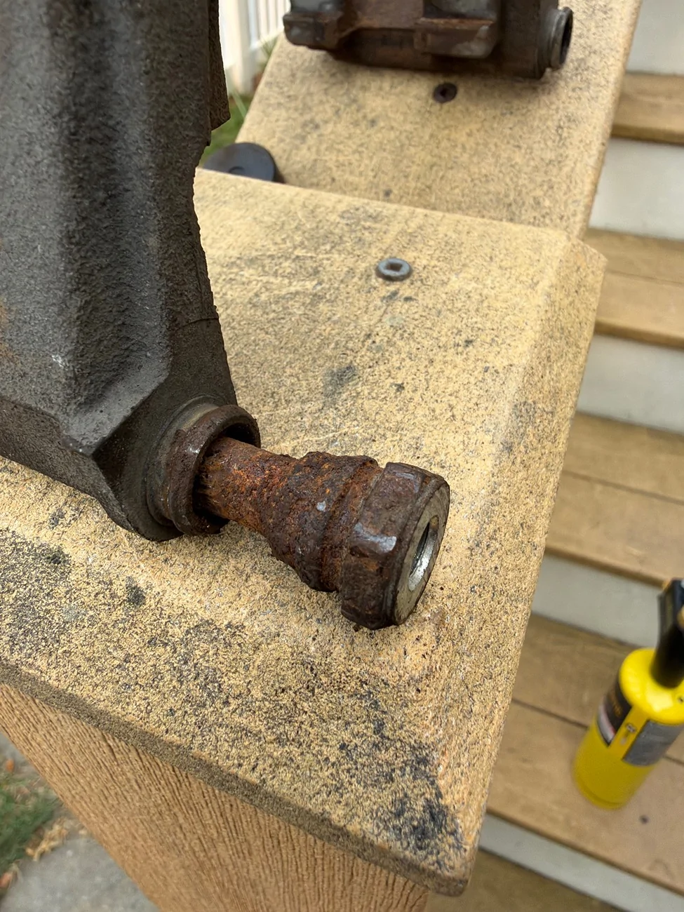

That’s the worst one I’ve heard of yet. I’ve had the slide pin problem on the rears as well though. I replaced the brackets. Got any pictures? I bet it was gnarly.
I wasn’t doing much with my phone while working, but I did snap this of one of the slide pins (not 100% sure how much torch/wire brushing I did at this point):

Holy crap. Did it accidentally get submerged in salt water?

I’m pretty confident it was never submerged, but living on the coast means a gutter puddle could be sea water—hard to say. For all I know, it went through a salt puddle and sat unused for extended periods during Covid and hasn’t worked since—who knows?

Sounds likely. I lived in Florida on the water for 19 years. I never saw anything like that on my vehicles.
What happened to the rubber boot that is supposed to protect the slide pin?
Was it like that when you found it?
I sliced it off before hitting it with the torch and wire brush.

So, it corroded that much with the rubber boot intact? Wow.
Yep. I wish I had done a video of the rotor puller doing it’s thing—it was like a small thunderclap followed by a cloud of rust and brake dust.
