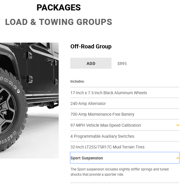

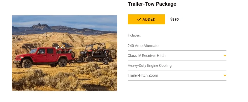

It has upgraded tires, limited slip, hitch, hd engine cooling, and different springs and shocks from the regular sport. By my count that’s 5 of the 8 features you listed and I said upfront it didn’t have the gears or axles.

It has the MT tires, limited slip, hitch, hd engine cooling, and different springs and shocks from the regular sport. By my count that’s 5 of the 8 features you listed and I said upfront it didn’t have the gears or axles.
Max tow has smaller, non-mud tires, lighter tires and wheels. Max tow doesn't have those heavy mud terrain tires with higher rolling resistance and weight.
Different sprigs don't count because those will be for off-road, not towing, so you'd have to take off your springs and put max tow springs and shocks under it and remove your off-road springs and shocks.
So take away your tires and wheels and shocks and springs and that leaves you 2 out of the 5 you are counting. (or 2 out of 8)
Max tow does not have MT tires- minus that - and max tow likely has lighter wheels.
Max tow doesn't have the off-road springs and shocks so minus that one.

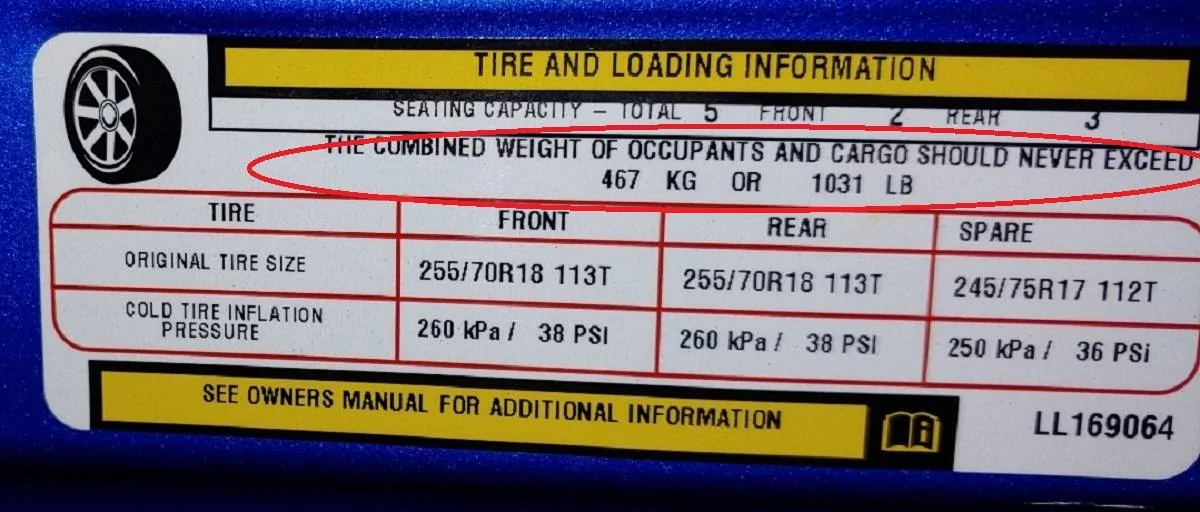

I'm curious - look at the door jamb sticker for your payload numbers - wonder what those are on that truck.

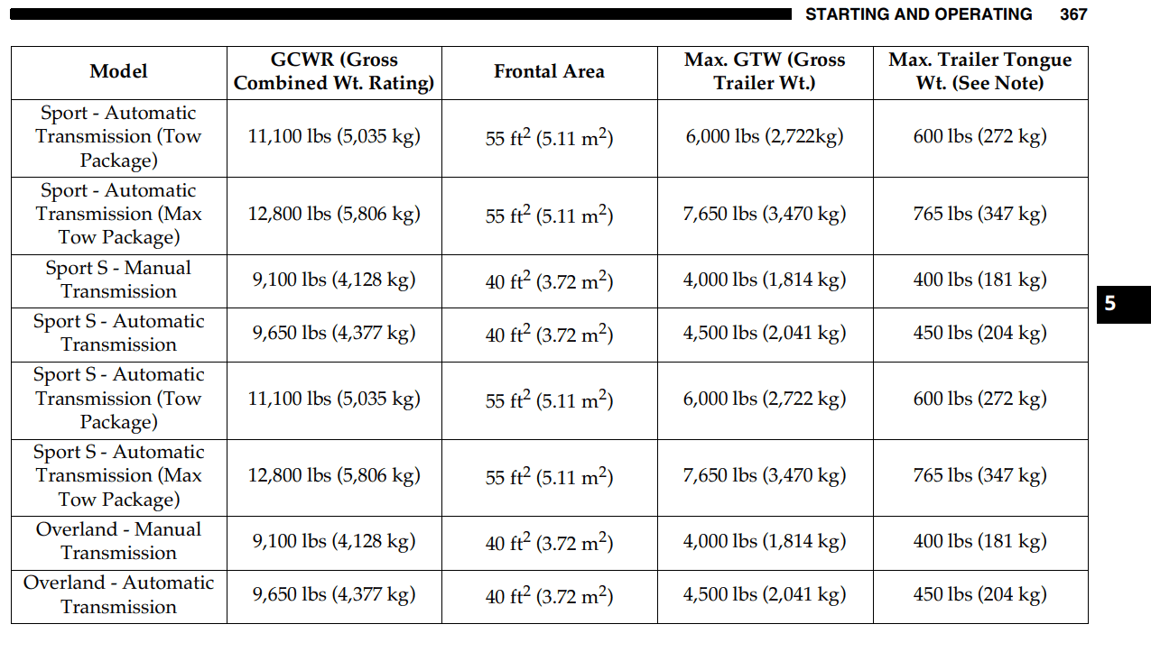

The tow rating will still be for a Sport with tow package - I believe that's 6,000 pounds.
Here's an example of what it may look like and where to look for payload ->
Jeep Gladiator Build sheet questions: "Off road group" on a 23 Sport payload-sticker

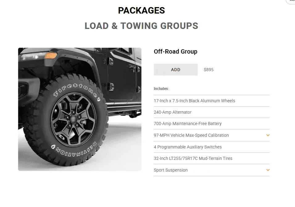

Comparing strictly Off Road Group to Max Tow, that does not appear to be the case. No mention is made of a limited slip, a hitch, different springs, or cooling in this package.
I did find a separate listing that shows 'sport' suspension, but 'sport' and 'Max Tow' are not the same function, and I'd bet not the same suspension. The suspension in the Max Tow is set up to have a higher GVW, specifically. Shadows Papa found that the Max Tow springs are actually shorter than at least the Overland but carry the weight better (IIRC).
https://www.jeepgladiatorforum.com/...ses-off-road-group-for-gladiator-sport.66525/

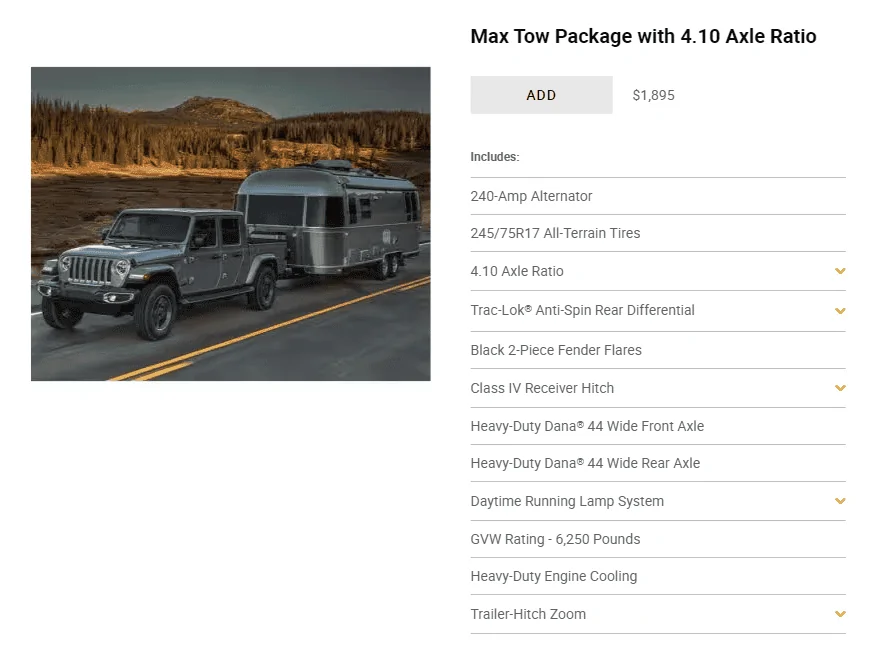

Now, if you buy a Sport and add Off Road Group AND the regular tow package, you'll gain the HD cooling, hitch, and hitch zoom. You will still be missing the most critical components (wide axles, 4.10 gears, limited slip, and a higher GVW) AND you'll be paying the same as just having bought a Max Tow but instead will get some loud ass tires, black wheels, and switches instead of a real benefit - better gears, wider axles, and a limited slip.
So - Max Tow and Off Road Group are not basically alike. The Off Road Group (even with base Tow Pack) is missing literally all of the critical components of a Max Tow.
Specs from 2020.
4000 manual
4500 auto with no tow pack
6000 auto with tow pack
7650 auto max tow (now 7700)
Slightly higher GVW with Max Tow as well

People keep missing the point that the max tow has small tires - small diameter. There's a reason - they wanted to keep engine RPM up, keep the load down. the small diameter tires coupled with the 4.10 gearing keeps the engine RPM up for better heat rejection numbers.
Start changing tires - you've just un-max tow'd it.

Specs from 2020.
4000 manual
Yeah, I was wondering what his final payload numbers were for that configuration without max tow.
Trailer weights are pretty easy since those are standards posted in "the book" but payload varies from truck to truck, although max tow's payload is higher from the start than other levels of the JT.
His towing will be the standard 6,000 pounds.

My Max Tow sits at 1,471. I hadn't had a chance to check any other regular Sports. Everyone around here only has Willys and Rubicons :LOL: And the one Rubi I checked was a full 400 pounds less.
