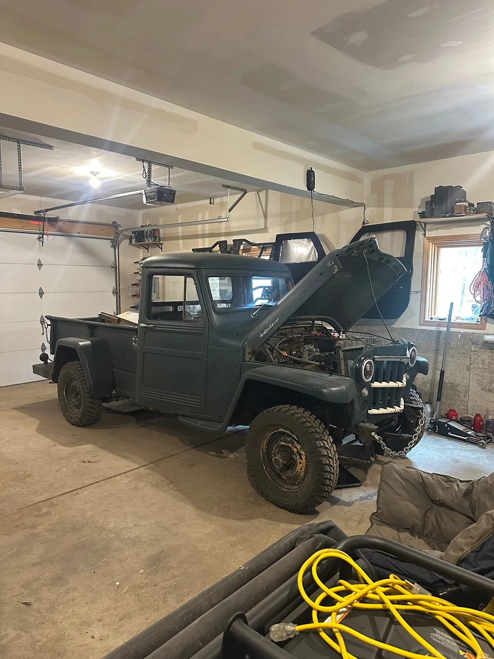

You have no idea how helpful this is. Thanks. My frame is a bit older as a 61. I’m working on engine and transmission builds first. The amc 401 is broken down and at the machine shop for machining and I’ll let them install the cam bearings. I need to rebuild the 4 speed I bought for it as well. I’m still on the fence between arms and coilovers, and custom leaf springs. Leafs would be simpler. I’ll probably run either skinny 35’s or 37’s absolute max. It’ll be mild on the trail and wild on the road.
Jeep Gladiator Built not bought or bought not built??? IMG_5594

With an old rig like that make sure to box the frame. if you are upgrading the engine. Weight and torque are not you friend with an old flexible frame.
If you go the leaf spring route, check out Deaver springs and look into slipper boxes for more actuation. Swap the front shackle to the rear for better ride.
If you go the Link and coils route it will be more work but the end result will be a fantastic ride and performance on and off the road.

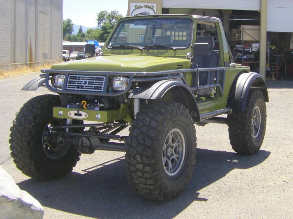

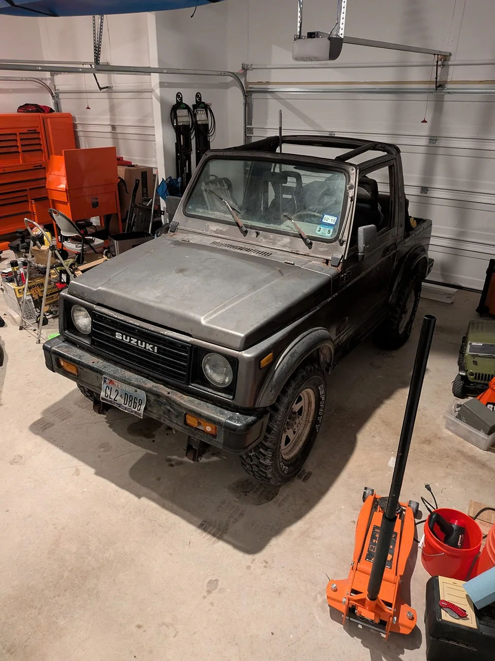

I can do most add-on stuff but haven't really got into fabrication, welding or anything like that. I have wanted to but never wanted to try on my daily. I have a always liked the Samurais and have had a few of them. I picked this one up to start learning on. Plan is to add the trail slayer Kit to it which stretches it to a 100inch wheelbase. We will see how it goes.
Trail Slayer’ Samurai Coil Suspension Kit
Jeep Gladiator Built not bought or bought not built??? PXL_20260421_150430198
End Goal
Jeep Gladiator Built not bought or bought not built??? 1776784986967-ss

I’m definitely boxing the frame. It will be my first one. The engine will be in the 500hp range, with at least as much torque, so I’d twist the open frame into a pretzel. I’ve been leaving it assembled (body on) until I have the new engine and tranny built. My thought was to do a test install of them to figure out clearances and mark motor mount locations before removing the body. Then I’ll try to do the frame, axles, and suspension without the body on. But this is all new to me, so learning as I go.
