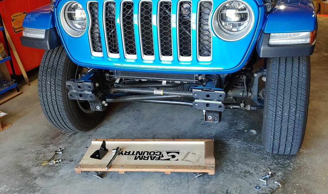

Original bumper off - like Matt said, cordless impact, extension, swivel, sockets, pretty easy.
Jeep Gladiator Bumper Installation 20201013_155355_HDR

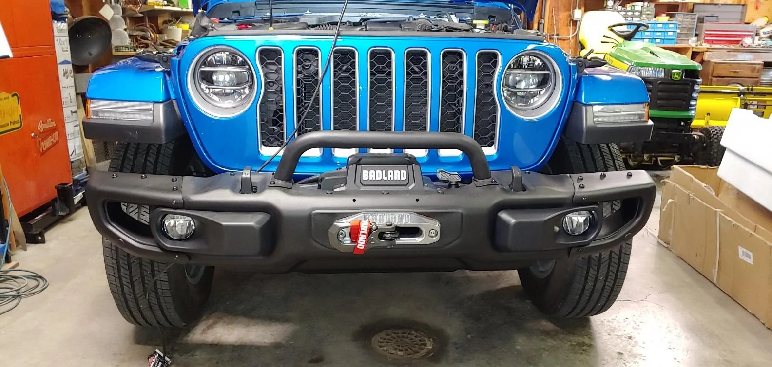

Finished -
Jeep Gladiator Bumper Installation 20201017_135829_HDR
