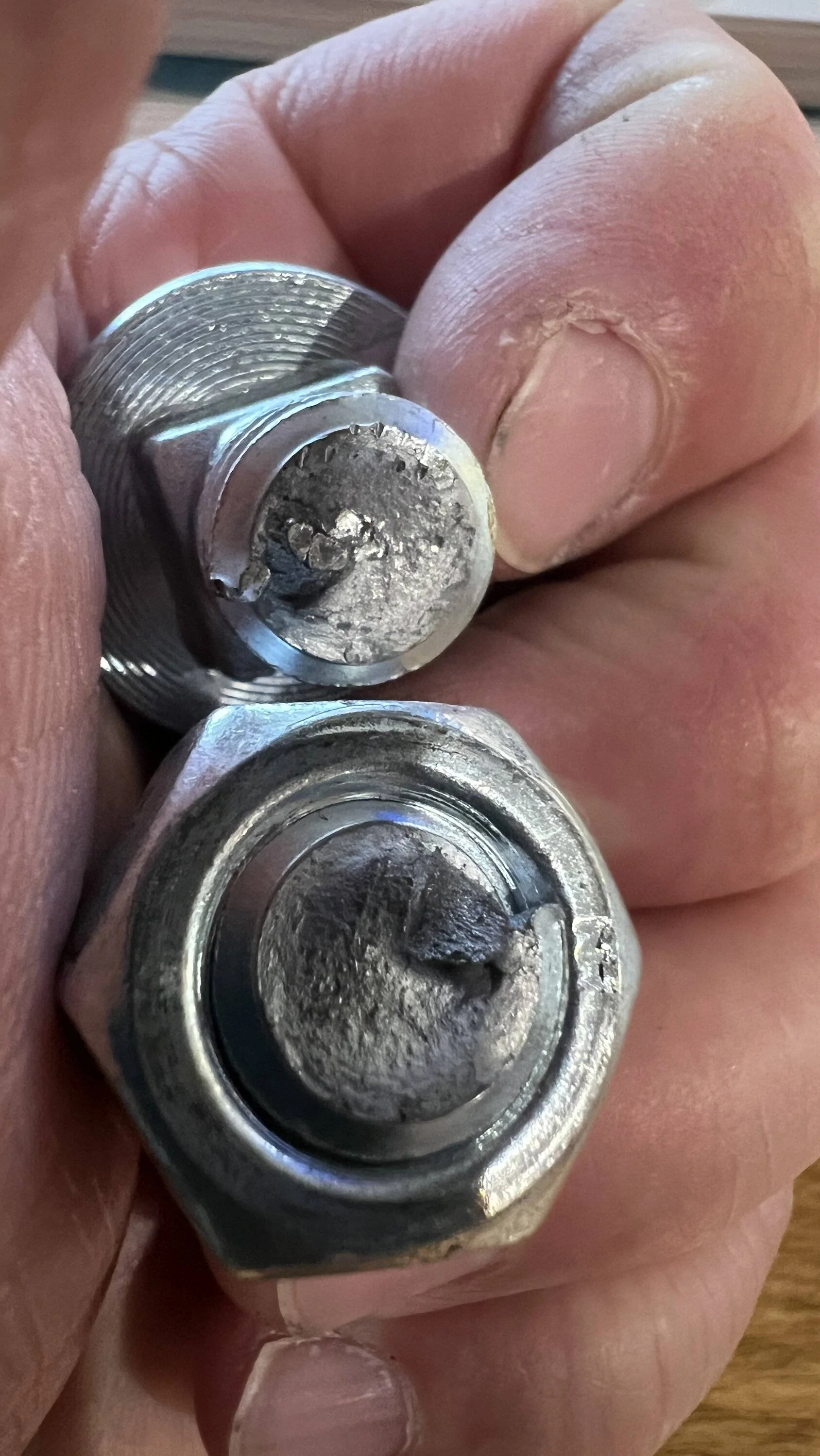

The brackets that tie into the bumper bottom and then into where the factory sway disco skid on the frame are also not bent correctly. They are also carriage bolts. So I will have to find a way to bend 1/4" steel to match the lines of everything. I'm expecting to break 4 more carriage bolts and probably will have to go back to the hardware store for more. I'll try and get that on later this week. I can't get grade 8 for those bolts because they have to be carriage, and the sore does not have grade 8 carriage bolts, and there is not accessibility. So well see how that goes. I was BARELY lucky to get a pair of small small adjustable wrench behind to hold the bolts while tightening the nut. Only went to 75 lb ft because even those just had that not so good feel to them.
Fortunately the bolts for the winch come from the winch manufacturer so I am hoping I just got a bad set of carriage bolts from Warn. Still... I'm blown away they do not use grade 8.

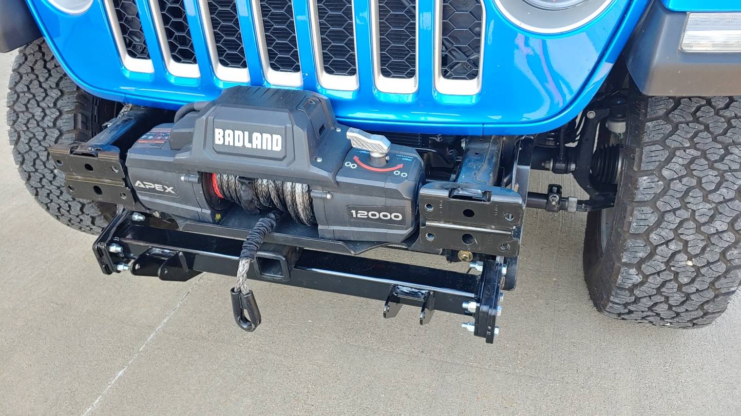

My winch plate bolts behind the frame's bumper mounting ears - no way it's going anywhere.
I'd likely pull the winch off the plate, first.
The winch plate is against the rear of the frame ears, then there's the sides of the plate that bolt to the sides of the frame using grade 8 bolts. No way that plate is ever going anywhere. It can't.
But - I suppose I could pull the winch off the plate?

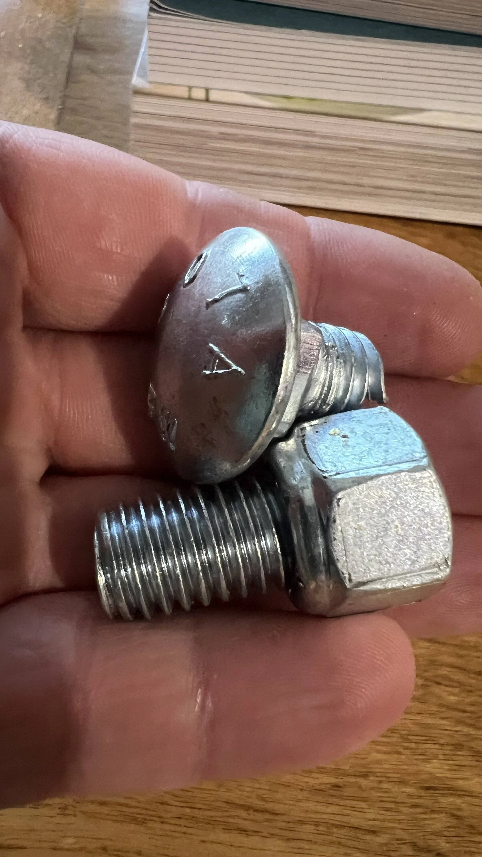

yeah. Im pretty frustrated by this quality issue.
these are the bolts that came with my winch
Jeep Gladiator Bumper retaining bolt torque 9E317010-488F-4B4C-AE8A-641697E7A379
Jeep Gladiator Bumper retaining bolt torque 78B7DF9B-42BB-4212-A1DC-3BA1FA238E6B
If you’re talking bolts for just the bumper, you should be fine with stock bolts. The end of Shadowsppa’s post…he was referring to the addition of a winch plate. Since the front of the winch plate ties into 4 of the 8 front mounting locations…at least for the Warn mounting plate…there are an additional 8 bolts tiring it all together. I think I was editing the post you quoted from me when you were responding…
I could have tried reusing the stock bolts but once those broke on me i wanted better. And the stock bolts might not have fit because theyre longer. I had a hard time getting the ones i bough in the holes and they were shorter than the ones that came with warn

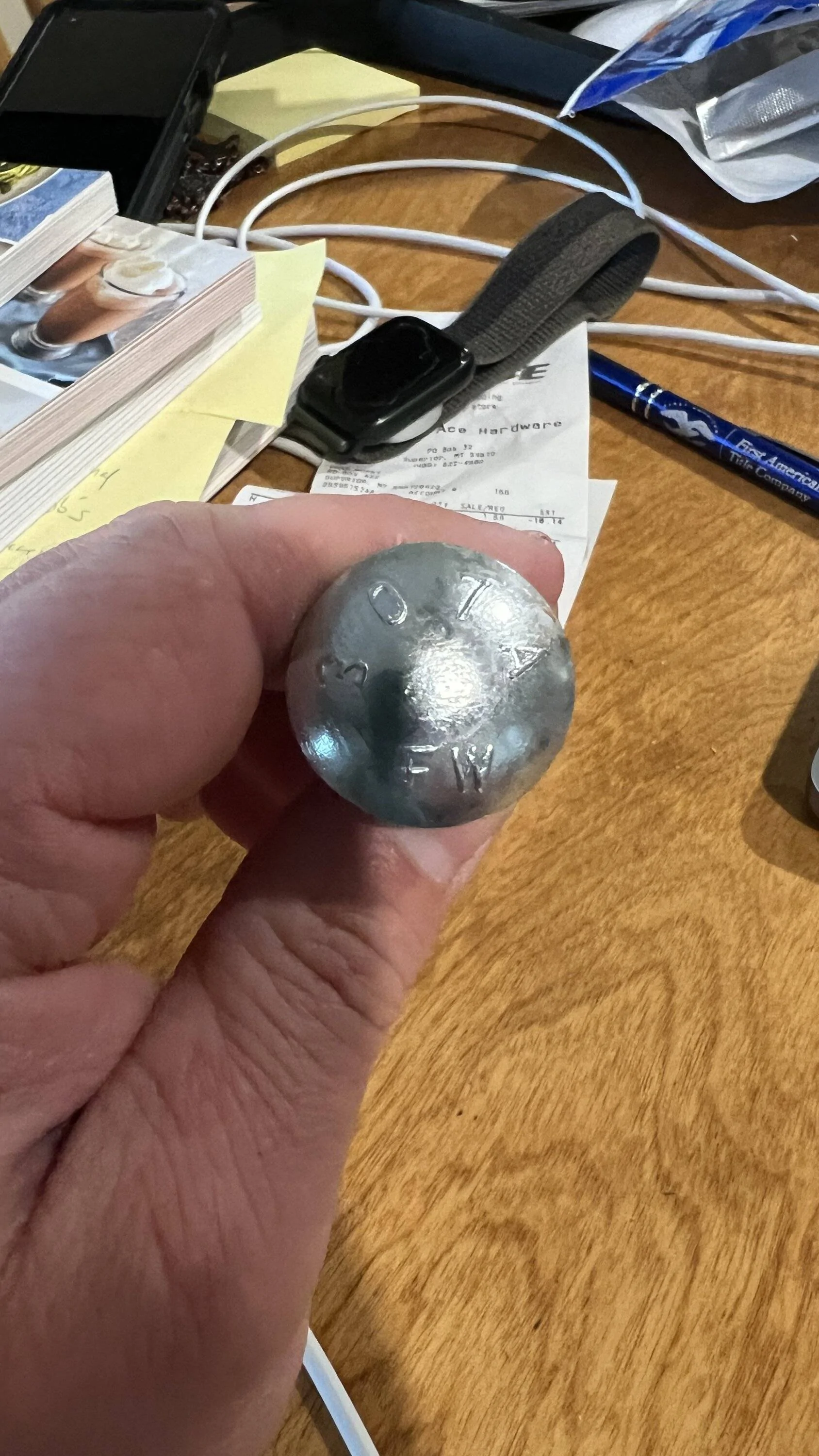

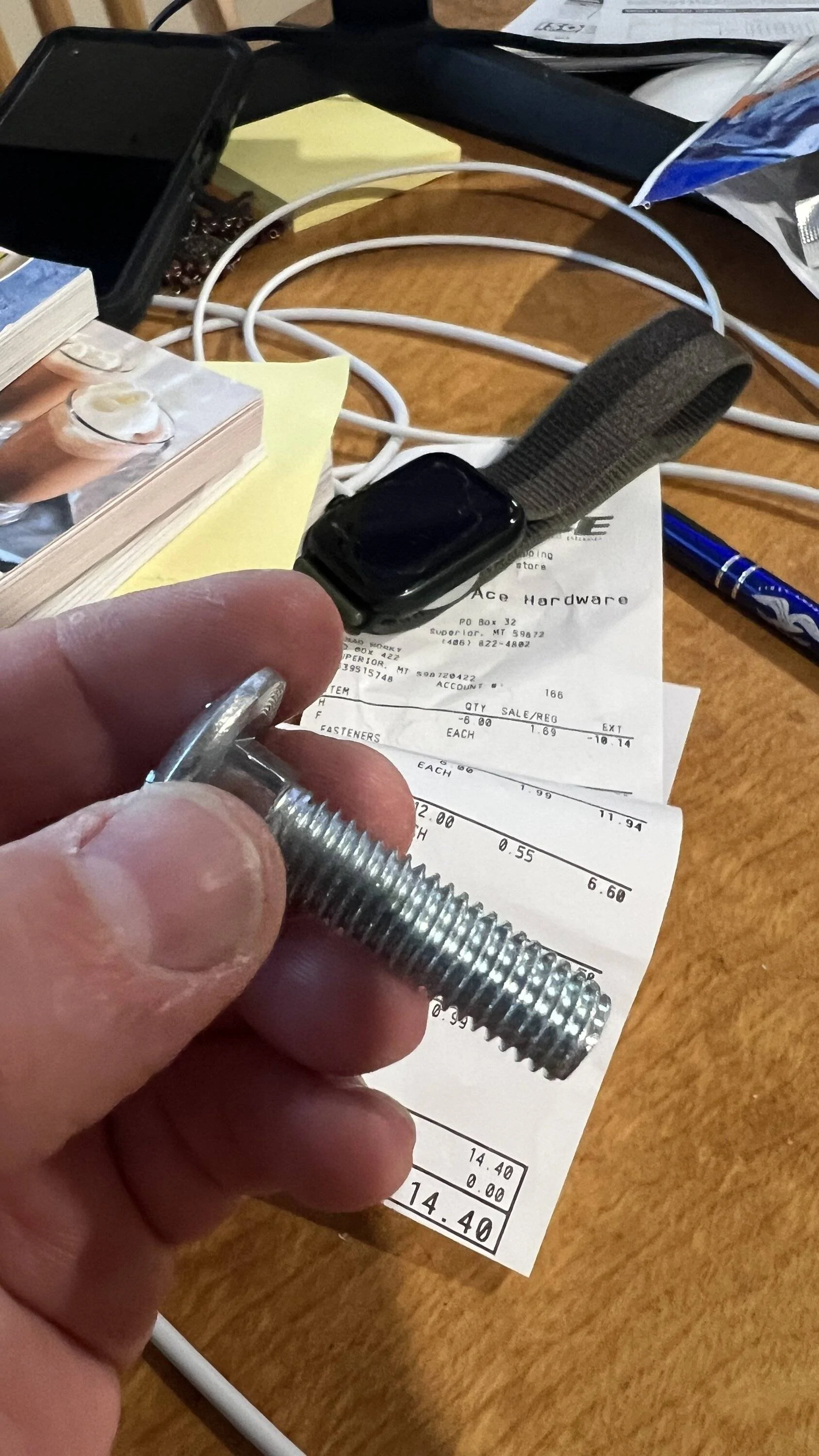

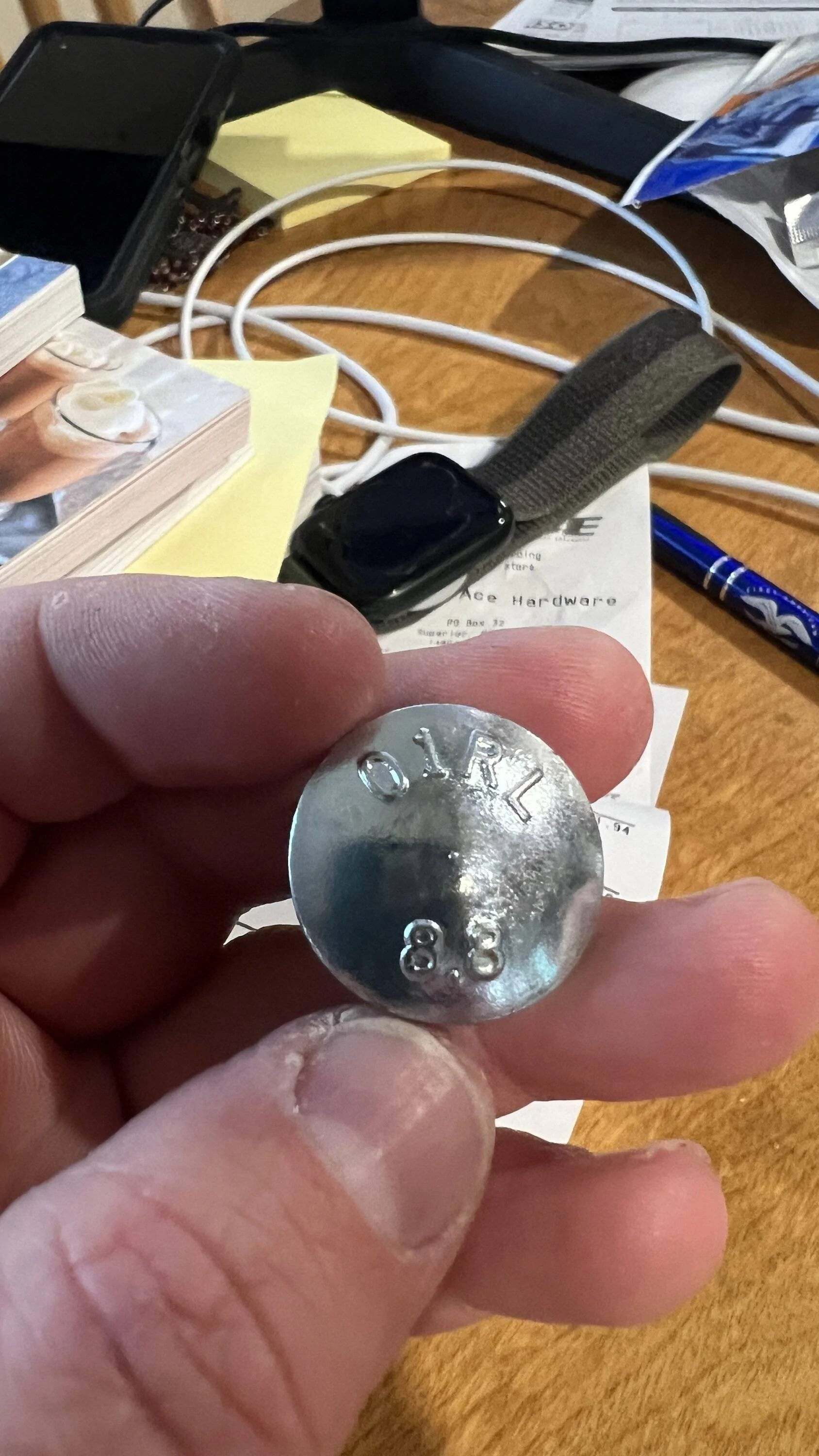

In case someone stumbles across this thread in the future and doesn't know.
this is what warn provided. No clue what these markings mean
Jeep Gladiator Bumper retaining bolt torque 77295538-E8DD-4FF4-8579-490EC92FEAD6
Jeep Gladiator Bumper retaining bolt torque 3192CC39-B2D6-4E04-9669-7A4B7498DFF8
Jeep Gladiator Bumper retaining bolt torque 5FF187B9-12DC-40A8-92FF-41A662FD3E76
it is interesting their other bolts that i didnt use are 8. I really am not certain what these ones are even fore. The instructions are pretty terrible. I think they are for the bottom brackets that tie into the frame. But since I had rivet-nuts in there I just re-used the factory hardware.

maybe I'm a tad confused? So the warn bumper only uses 6 main bolts to the frame. Not 8. They also say in the instructions to discard the two inner frame gussets - which I find odd, probably due to cutting the frame for those using the zeon series winches. On the bottom end, there are two bracket, each side, that tie into the frame. So 4 more bolts each side. So theres a total of 8 bolts there. for a grand total of 14 bolts. But I think the 4 carriage bolts on the bottom side are going to end up braking. Just a hunch since the brackets there dont line up well and will result in some metal bending as things tighten down.
Thats also the same spot where the bottom skid attaches too as well. So that is going to be a very difficult group of bolts to do a final torque on.

Those brackets are meant to bend a bit. Tighten the 6 main bumper bolts first, after just starting those 8 tying the winch plate to the frame horns. Those are meant to pull a bit, as they are what prevent any distortion when winching. They won’t break. They’re meant to be bracing connections.
