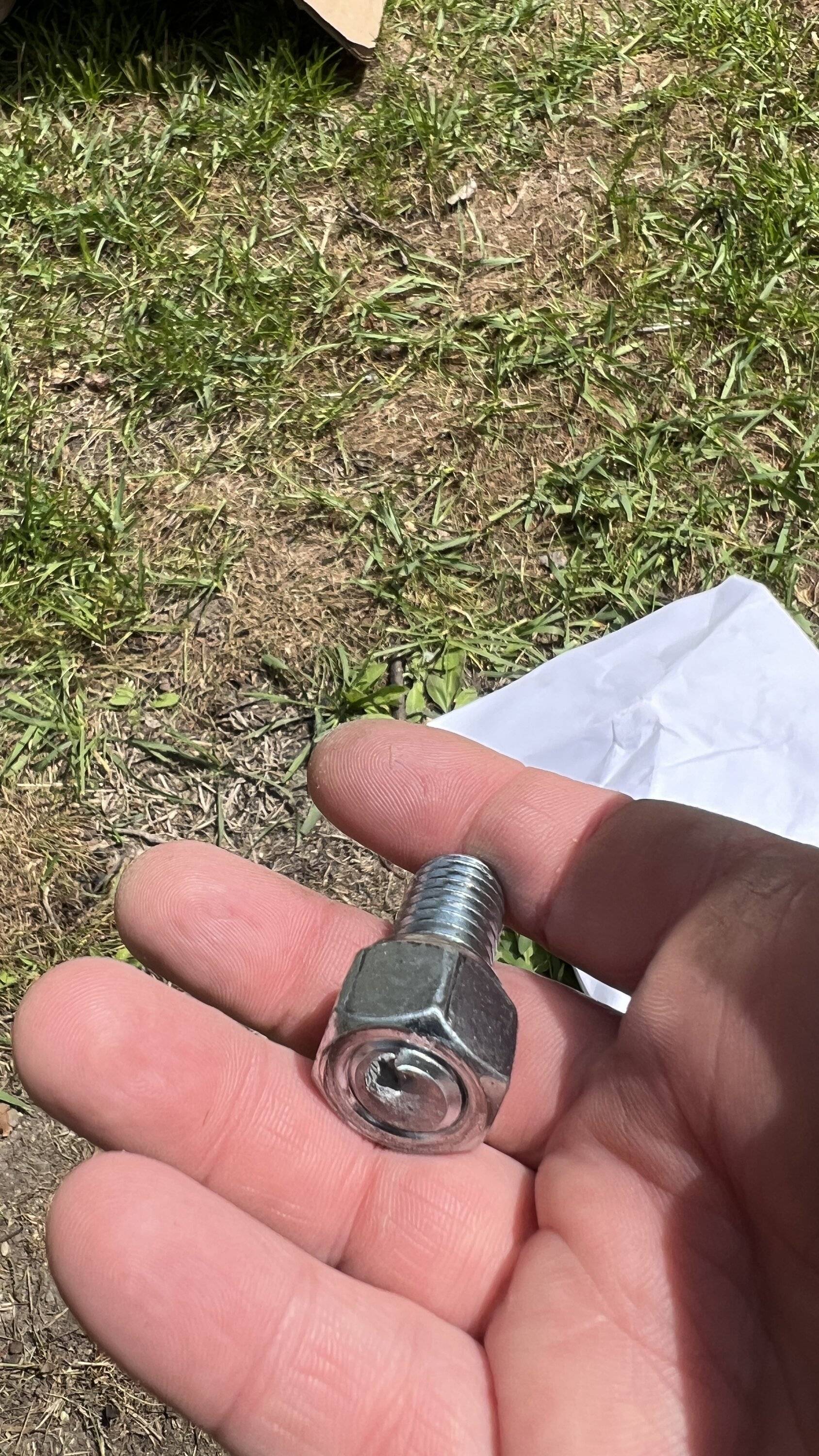

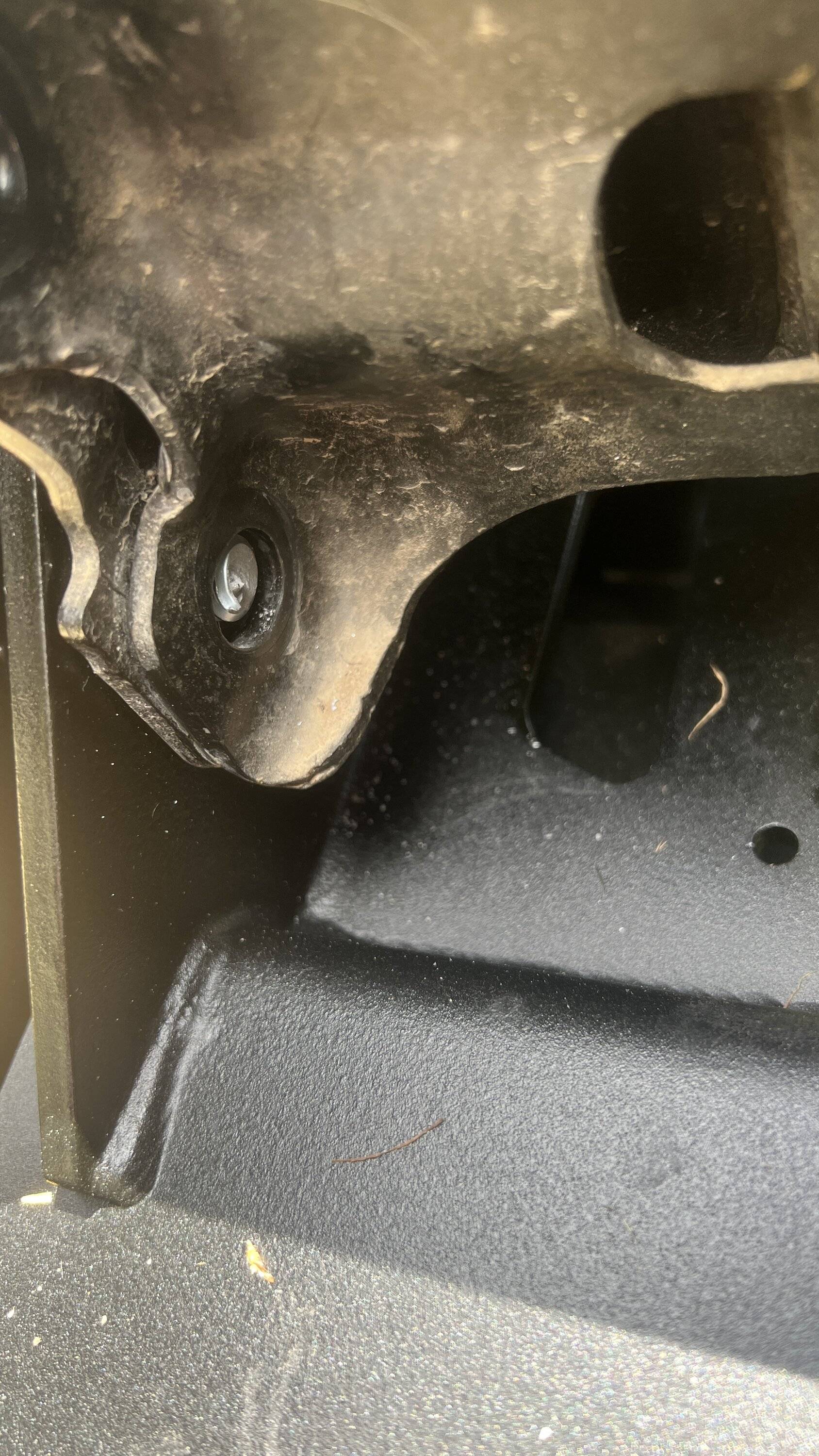

i broke a bolt. super not happy. I bet it didnt even get to 70lb ft. So the install is on hold. Annyone know the proper torque for the front bumper. Warn does not specify.

i can go to the store and try to find something that will work. Or wait for warn to ship replacements. But im worried that will take a couple weeks. Kinda need this thing operational this week
fourfa
Dec 12, 2021
781
980
CA
22 JTRD + ACCC
66 ft-lbs. Those bolts are beefy, I'm shocked that you could break it. Might be able to sneak it out past the front crush cans though, now that's it's broken, to bring along to the store to find a replacement. You'll have to get the bumper fully apart to get the full length replacement back in though
I don't think it'll be any uncommon metric thread, I know my local Ace would have these in grade 10.9

Yeah i think im gonna try and find replacements for all of them. For one to beake has me concerned about the others. Could be a bad batch.

So the guy at the hardware store said the cariage bolts are not grade 8. So i got some replacements but also got some grade8. Hopefully i can get a wrench on the back side of the bolt though. I doubt it. Will be giving warn a call tomorrow regardless. Pretty surprised the bolts in the kit are not grade 8 considering its rated for a 12K winch.

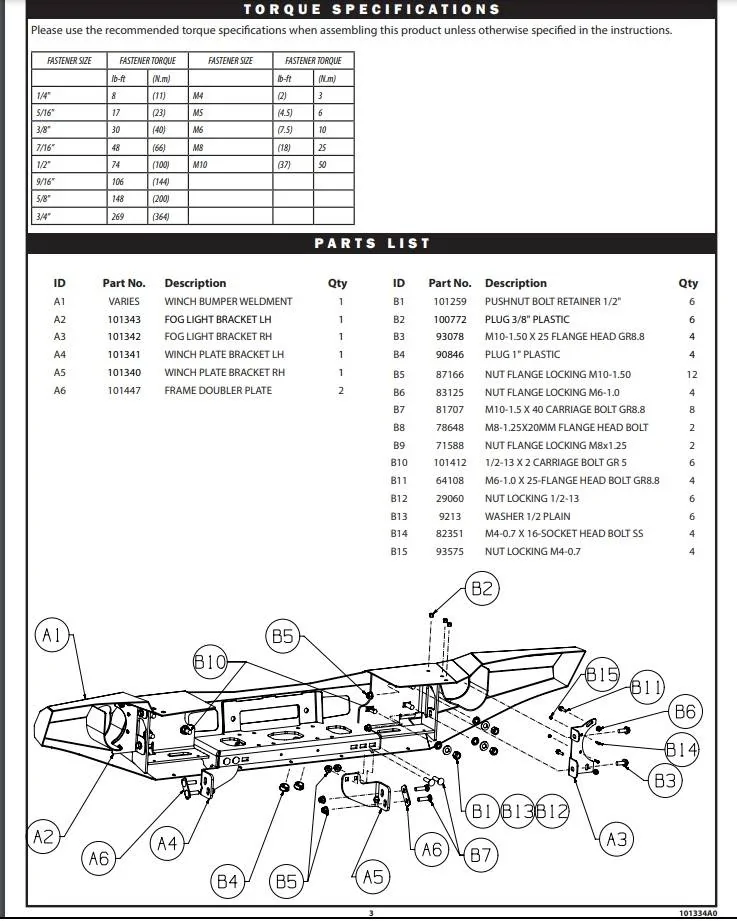

I seen your other post on the Warn bumper you received and below is what I think is the parts listing with the torque table up top.
Looks like a 1/2"-13 coarse thread Grade 5 bolt. The torque table listing on the parts page recommends 74 ft-lbs of torque. Searching for standard torque values for that type of zinc plated fastener has giving me anything from 55 ft-lbs and up to 90 ft-lbs.
They woefully put the wrong grade in that kit in my opinion.
Jeep Gladiator Bumper retaining bolt torque WARN
wow. Man thats insane. I will call them for sure. I would NOT trust grade 5 bolts on a bumper that supporsts 12k winches! crazy. Makes me want to redo my rear bumper now too and use grade 8. Hopefully i can get a wrench behind the bumper for the bolts i just bought

That's a real cheap-out on the bolts, IMO, for a bumper that IS the winch mount.
Thankfully, my winch isn't depending on such bolts although the factory bumper bolts are more than adequate.
The bumper shown is literally pulling against those bolts when using a winch.
