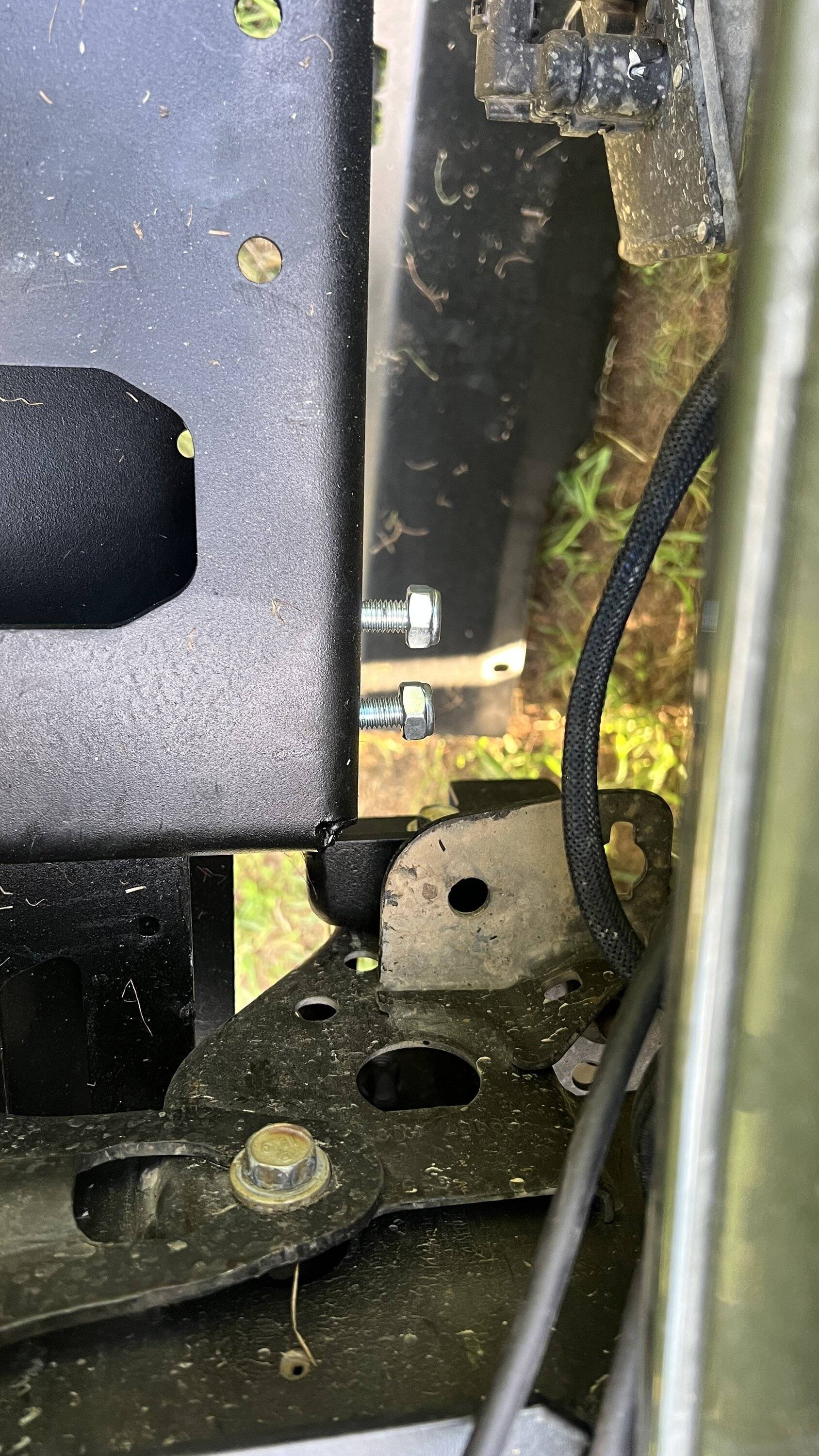

Those brackets are meant to bend a bit. Tighten the 6 main bumper bolts first, after just starting those 8 tying the winch plate to the frame horns. Those are meant to pull a bit, as they are what prevent any distortion when winching. They won’t break. They’re meant to be bracing connections.
So I have been staring at this pic all morning trying to figure out how to tighten the carriage bolts. I know you mention the brackets are made to bend (sounds weird) but the winch has to go on before the sway disco skid. And the sway disco skid has to go on before I can tighten these down. But with the skid and winch on I dont see how these are accessible at all. So, how in the heck did you do that!?

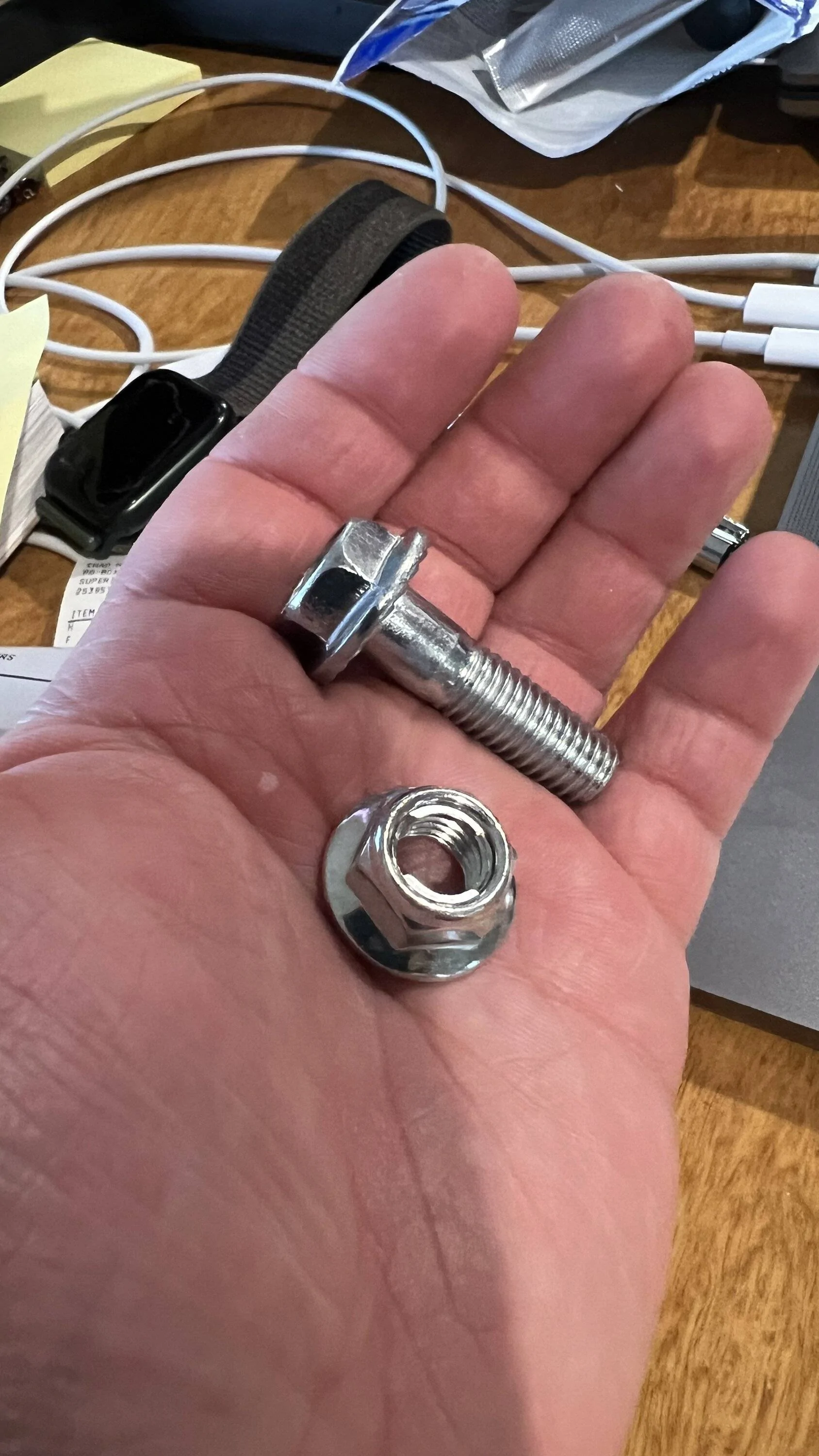

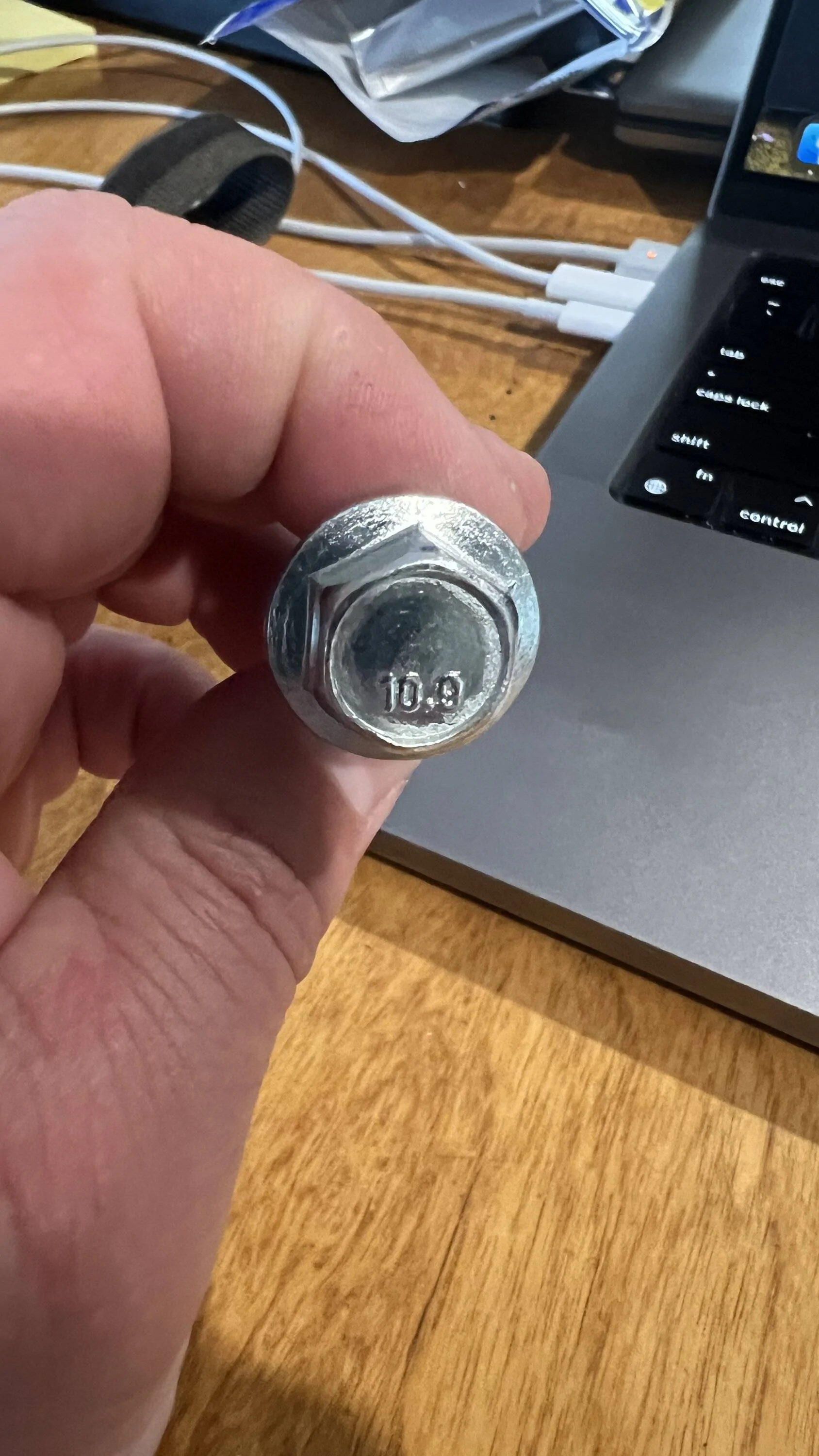

yeah. Im pretty frustrated by this quality issue.
these are the bolts that came with my winch
I could have tried reusing the stock bolts but once those broke on me i wanted better. And the stock bolts might not have fit because theyre longer. I had a hard time getting the ones i bough in the holes and they were shorter than the ones that came with warn
those class 10.9 with the shoulder are a good bolt. class 10.9 is about the same if not a touch stronger then grade 8. Now adays anything that I want a strong hold on i use a good high class # bolt with a nice solid shoulder. I hate having a hex head chewy up a finish while it's getting tightened or having a washer deform because the hole is not right.
The shoulder offers nice pull through resistance and good overlap for most holes. Plus it looks good.
I actually have mine removed at the moment. Call me tomorrow and I’ll look at it with you. But I tightened all bumper bolts before the skid went on. In order, all bolts loose, with spacer on one side. I didn’t need it on passenger for some reason. Tighten bolts for winch plate, then tighten main bumper bolts. Then install winch. Then install skid.

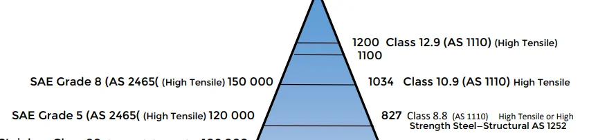

10.9 is generally considered to be not quite as "strong" as grade 8 in some resources, others say the difference is so small they are basically the same.
Grade 8 according to SAE J429 has a minimum ultimate tensile strength of 150 ksi, which is equivalent to 1040 MPa, which is the minimum ultimate tensile strength of 10.9 fasteners according to ISO 898-1.

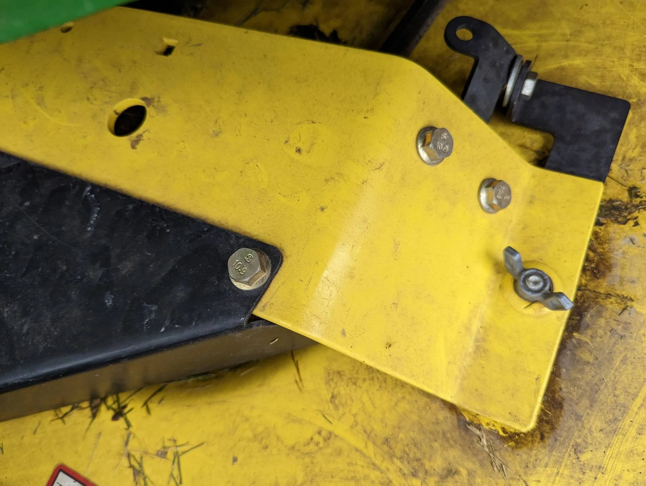

They must be good because John Deere uses 10.9 bolts for mower deck pulley guards! Gotta be great bolts!

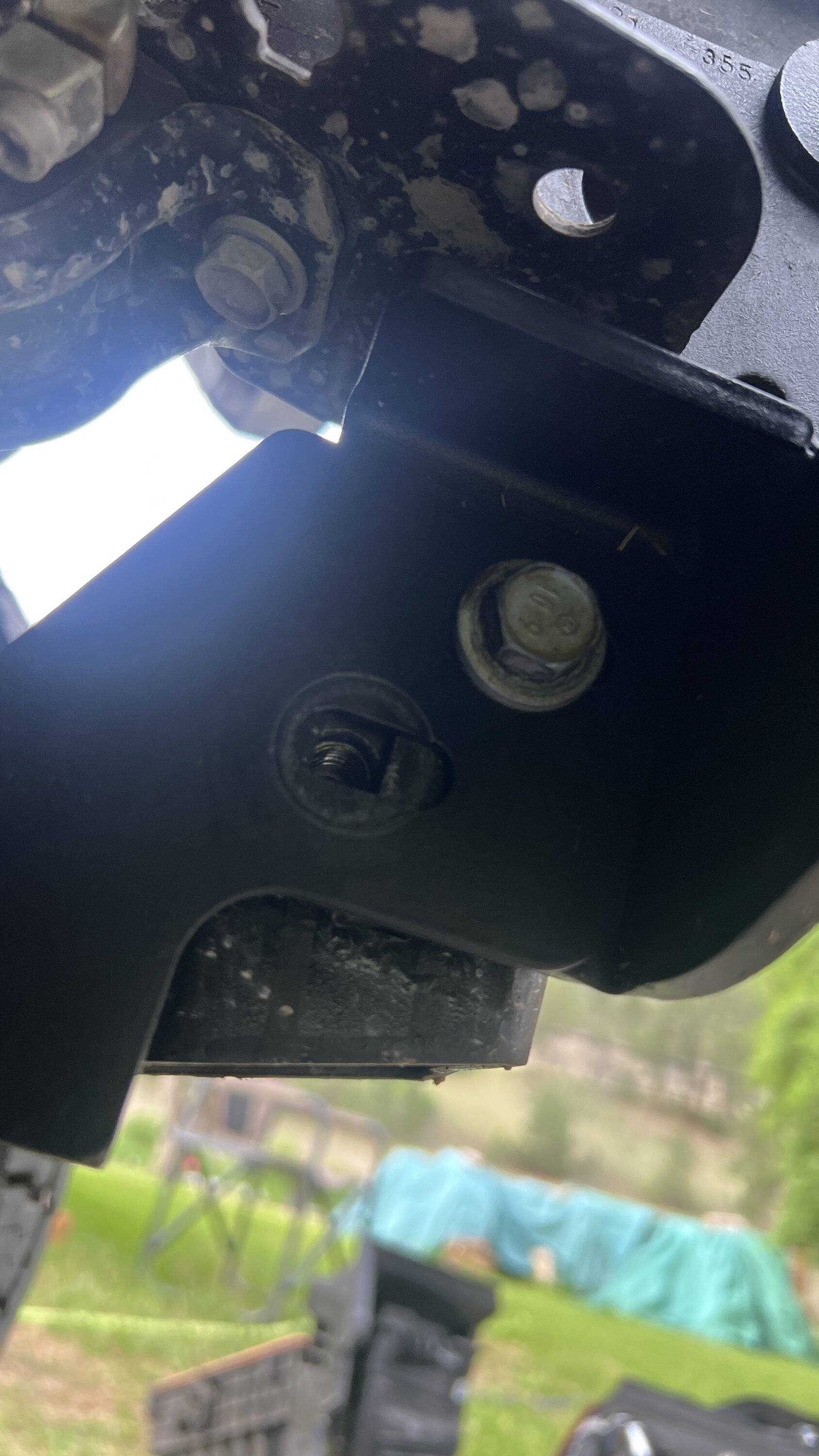

Well. Broke another one today. Well not the bolt but stripped the rivetnut. I must have that crazy old man strength or something. :LOL: Funny thing is according to Warn these rivetnuts dont even exist and your supposed to use more carriage bolts. I will be calling them. In the mean time I need to drill this out and mine as well replace it with a grade 8 since the local Ace has plenty of options available
Jeep Gladiator Bumper retaining bolt torque 1FCF5C6D-599B-4027-9426-BDF8D58AD44B
Did have a nice chat with @Summitdan to compare notes and we assembled ours differently despite the warn instructions. He didnt experience any of the issues I am. So well see if I can get this thing taken care of tomorrow or friday. Rear winch arrives Friday supposedly so hoping to get this wrapped up soon.
Are you sure you are not a high functioning Gorilla?
Only the Rubicon/Mojave models have rivnuts on those frame horns for the factory metal skid plate brackets. Other models they are not usually there.
