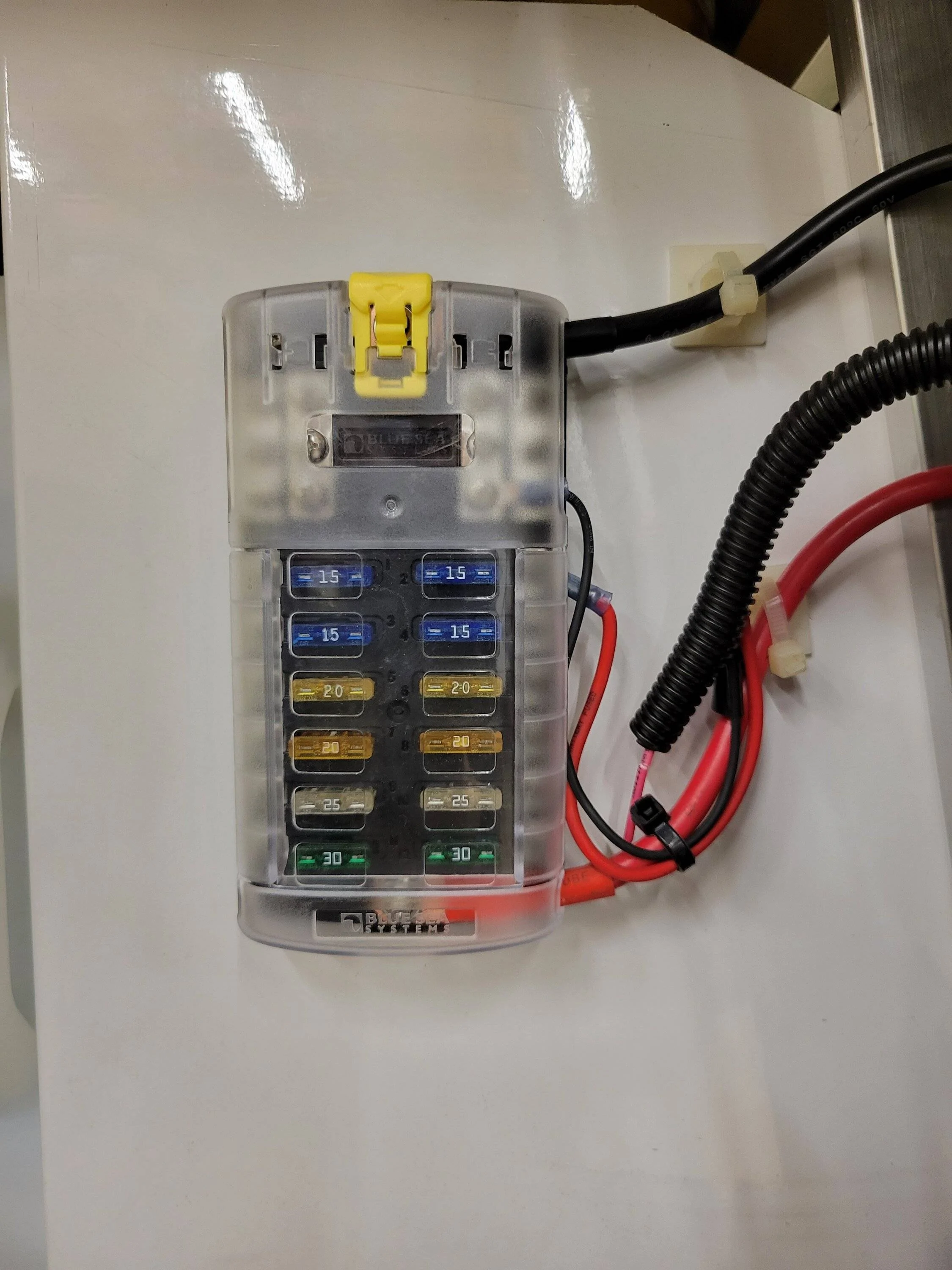

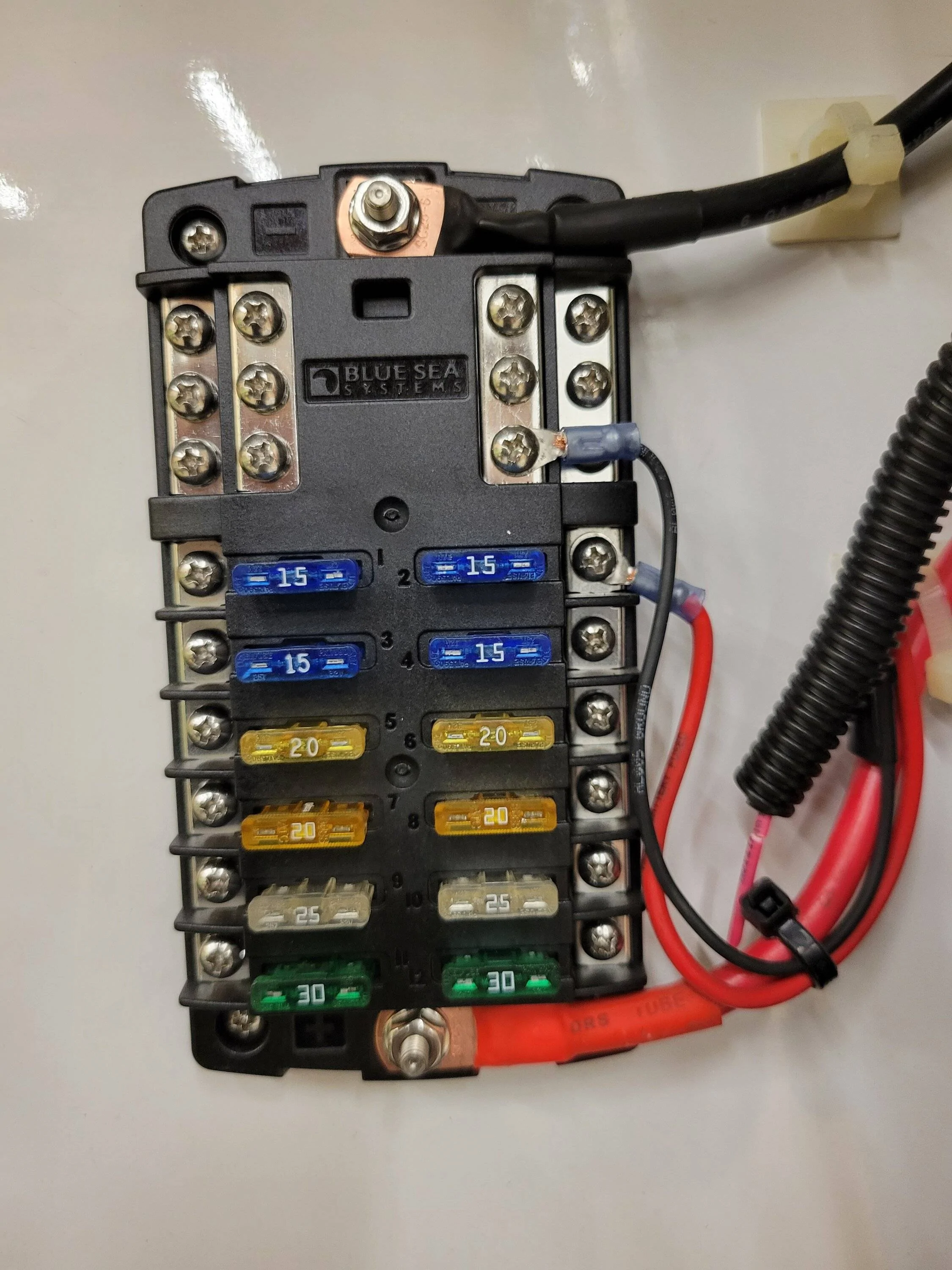

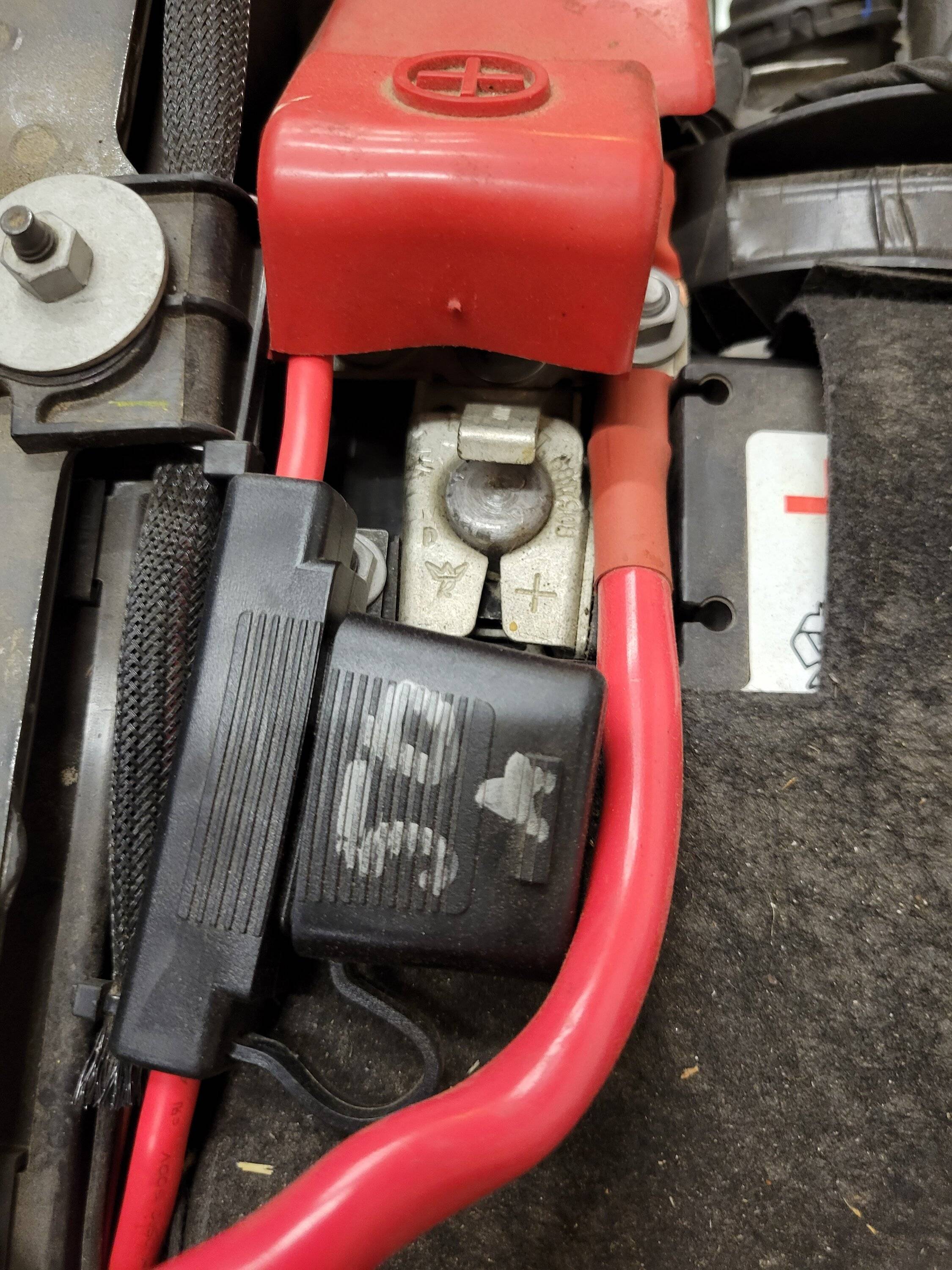

I have an ARE Cap with tool boxes built in and I installed a Blue Sea System power block. It has 12 taps and is fed by #2AWG from the battery and protected by a 50A inline fuse. Each of the 12 taps are fused. I fed the #2 wire underneath away from anything hot or moving and protected it with "snake Skin".

I installed a Blue Sea System on the back of my ARE Cap tool box passenger side fed with #2AWG wire from the battery and protected by a 50A inline fuse. The wire is run under the vehicle and protected by "Snake Skin". It has 12 fused connectors. So far one is used for the rear are bags and I plan one for my HAM radio and one to charge my Jackery. Hope this helps.
Jeep Gladiator Bus Bar in Bed 20230611_150051
Jeep Gladiator Bus Bar in Bed 20230611_150036
